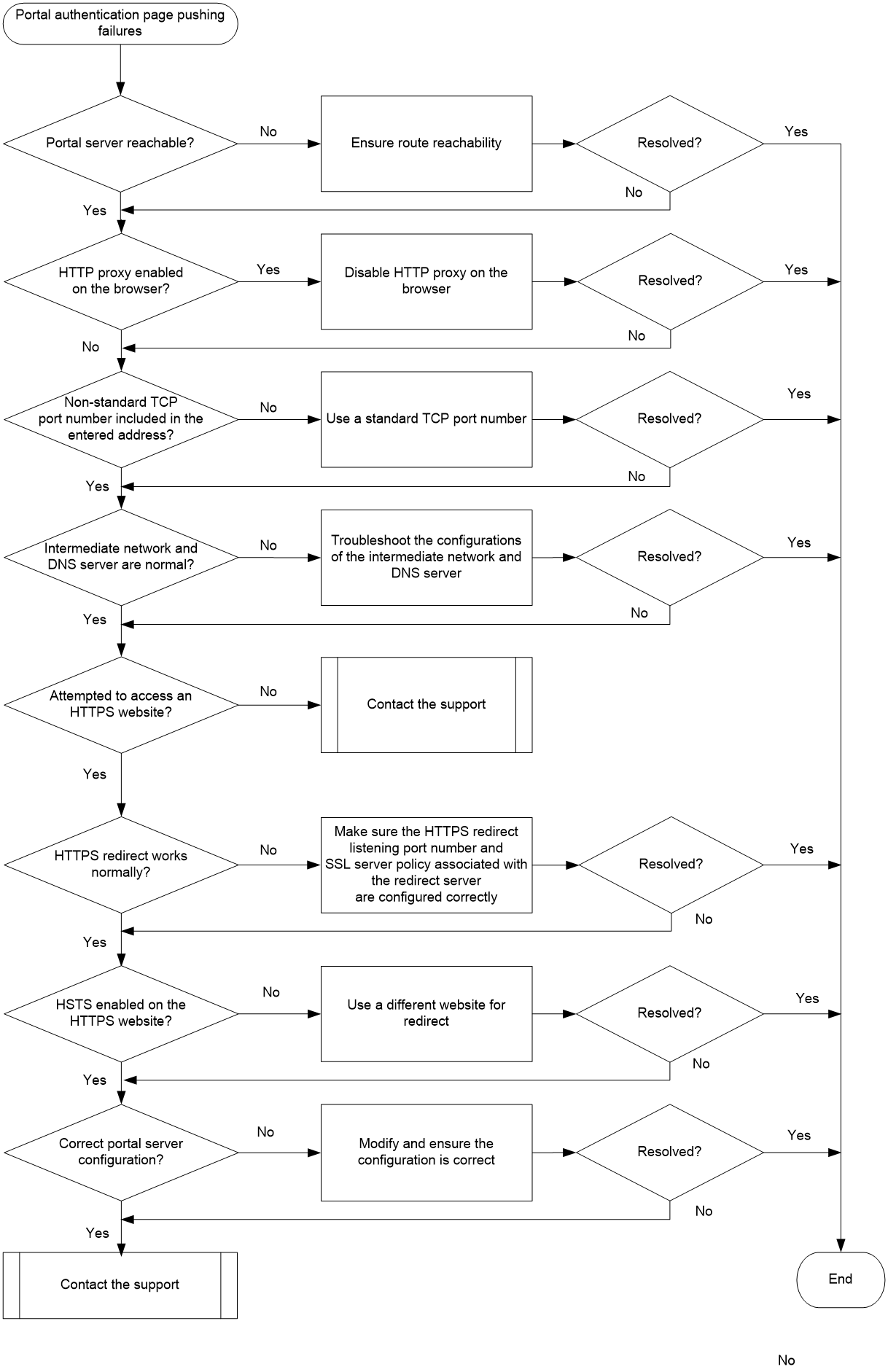

Troubleshooting flow
Figure 1 shows the troubleshooting flowchart.
Figure 1 Flowchart for troubleshooting portal authentication page pushing failures
Solution
1.     Verify that the route configuration on the client and portal server are correct.
After disabling the firewall on the client, use the ping command to check whether the portal server is reachable. If the server cannot be pinged, first check whether the route configurations on the client and the portal server are correct. Then proceed with the following steps:
¡     Check whether the return route from the portal server to the client is configured correctly.
¡     Whether multiple NICs are present on the client or the portal server.
If multiple NICs exist, some traffic between the client and the server might not pass through the network configured with portal authentication. Identify the NIC from which the user's Web access traffic is sent out. For example, if a Windows client is used, execute the route print command in the CMD window to view specific route information and identify the NIC.
Finally, use the ping command to test the connectivity for each pair of devices along the network path so as to locate the issue. First, ping the gateway from the client (for successful ping, you must disable authentication first), and then ping the server from the gateway.
2.     Whether HTTP proxy has been enabled on the browser of the client.
If HTTP proxy has been enabled on the browser, users might be unable to access the portal authentication page. You must disable HTTP proxy. For example, open the Windows Internet Explorer browser, click Tools, select Internet Options > Connections > LAN Settings, and then clear the Use a proxy server for your LAN option in the Proxy server area.
3.     Check whether the entered address includes a non-standard TCP port number.
Non-standard TCP port numbers refer to port numbers other than 80 or 443. If the webpage address entered by the user includes a non-standard TCP port number, the portal authentication page might be prevented from popping up. For example, http://10.1.1.1:18008. For HTTP addresses, use port 80. For HTTPS protocol addresses, use port 443.
4.     Check whether exceptions have occurred on the intermediate network or DNS server:
a.     Check whether the DNS server IP address is configured as a permitted address on the device.
b.     Check the connectivity of the intermediate network and troubleshoot DNS server issues. On the gateway, collect traffic statistics on the downlink interface connecting the client and the uplink interface connecting the DNS server, or mirror and capture the client's packets accessing the DNS server. Confirm whether the gateway has sent out DNS requests, but has not received responses.
5.     Check whether HTTPS redirect has been enabled:
a.     Check whether the user is accessing an HTTPS website. If so, portal needs to redirect the user's HTTPS requests. Do not specify a TCP port number used by any other service. To display TCP port numbers that have been used by services, use the display tcp command.
b.     Check whether the SSL server policy associated with the HTTPS redirect server exists. If not, complete the relevant configuration.
6.     Check whether HSTS has been enabled on the HTTPS website.
With HSTS enabled, an HTTPS website requires browsers to access it using HTTPS and the certificate must be valid. When the device redirects the user's browser through HTTPS, the device uses a self-signed certificate (because it does not have the target website's certificate) to impersonate the target website and establish an SSL connection with the browser. If the browser detects the certificate as untrusted, HTTPS redirect will fail, preventing the portal authentication page from popping up. This issue is related to the specific HSTS protocol enforcement requirements set by the website, and cannot be resolved. In this case, try other websites as a best practice.
7.     Check whether the portal server configuration is correct:
¡     Check whether an IP address group is configured on the portal server and whether the device is associated with an IP address group.
¡     Check whether the client IP address is within the range of the IP address group configured on the portal server.
8.     If the issue persists, collect the following information and contact Technical Support:

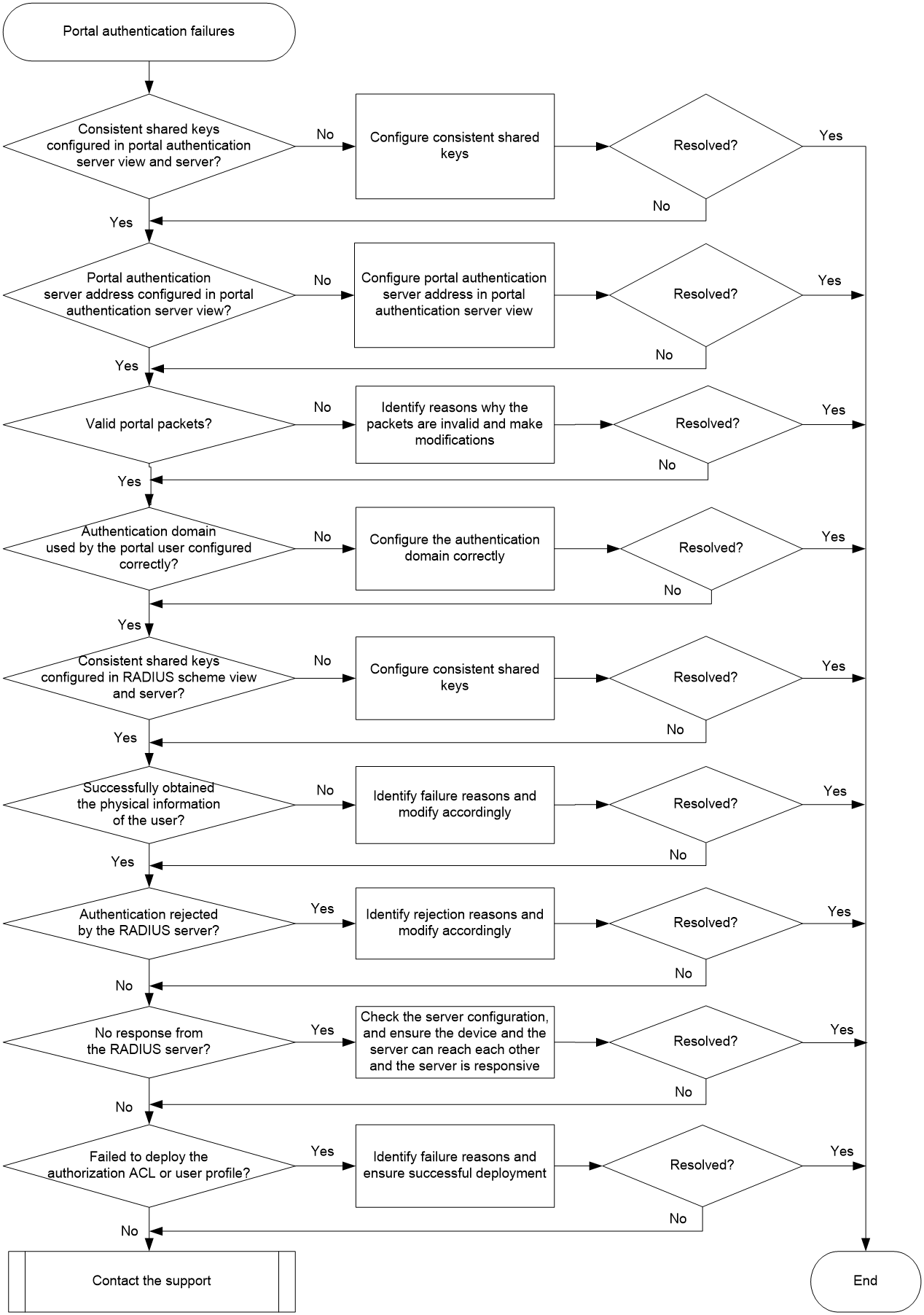

Figure 2 shows the troubleshooting flowchart.
Figure 2 Flowchart for troubleshooting portal authentication failures
Solution

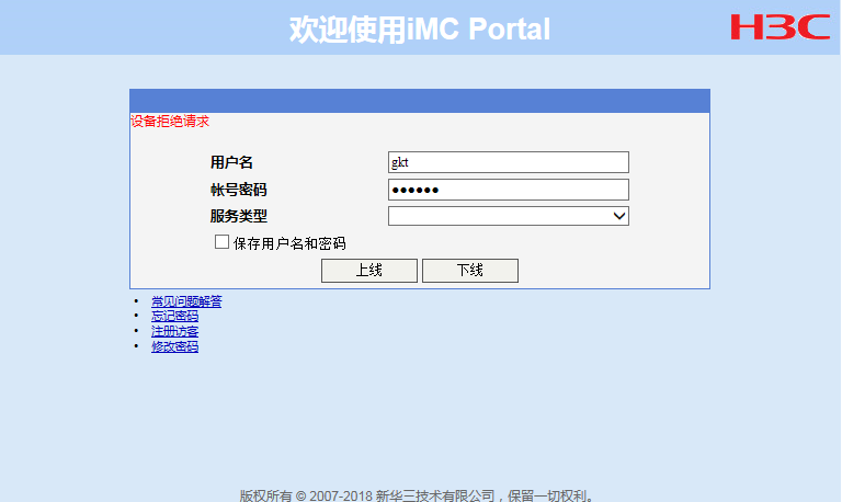

1.     Check whether shared key configured in portal authentication server view on the device is inconsistent with that configured on the portal authentication server.
As shown in Figure 3, if the IMC server is used, enter the username and password and then click Log In, check whether a message indicating the request to the device timed out is prompted. If so, this indicates that the shared key configured in portal authentication server view on the device might be inconsistent with that configured on the server.
Figure 3 Error message on the portal login page (1)
You can troubleshoot using the following methods:
¡     Execute the debugging portal error command on the device to enable portal error debugging. If the following information is displayed on the device, it indicates that the shared key configured on the device is inconsistent with that configured on the portal server.
*Jul 28 17:51:20:774 2021 Sysname PORTAL/7/ERROR: -MDC=1; Packet validity check failed due to invalid key.
¡     Execute the display portal auth-error-record command to check whether the following information is displayed in the Auth error reason field of the command output: Packet validity check failed due to invalid authenticator.
If the shared keys are inconsistent, modify the shared key configured in portal authentication server view on the device or on the portal authentication server to ensure consistency.

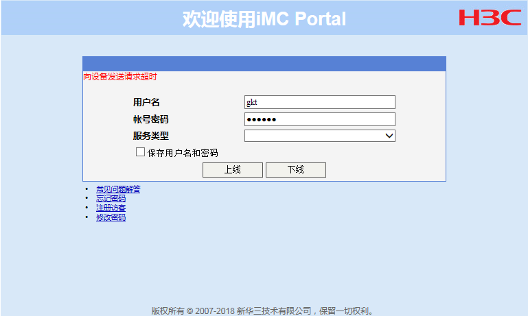

2.     Check whether the address of the portal authentication server configured in portal authentication server view on the device exists.
When the device receives an authentication packet sent by the portal server, it validates whether the source IP address of the packet is in the list of portal authentication server addresses configured on the device. If not, the device considers the authentication packet to be invalid and drops it.
As shown in Figure 4, if the IMC server is used, enter the username and password and then click Log In, check whether a message indicating the request to the device timed out is prompted. If so, this indicates that the authentication server address configured in portal server view on the device might not exist.
Figure 4 Error message on the portal login page (2)
You can troubleshoot using the following method:
¡     Execute the debugging portal error command on the device to enable portal error debugging. If the following information is displayed on the device, it indicates that the IP address of the portal authentication server configured on the device is incorrect.
*Jul 28 19:15:10:665 2021 Sysname PORTAL/7/ERROR: -MDC=1;Packet source unknown. Server IP:192.168.161.188, VRF Index:0.
¡     Execute the display portal auth-error-record command to check whether the following information is displayed in the Auth error reason field of the command output: Packet source unknown. Server IP:X.X.X.X, VRF index:0.
If the address is incorrect, execute the ip command to modify the portal server's IP address in portal authentication sever view on the device.

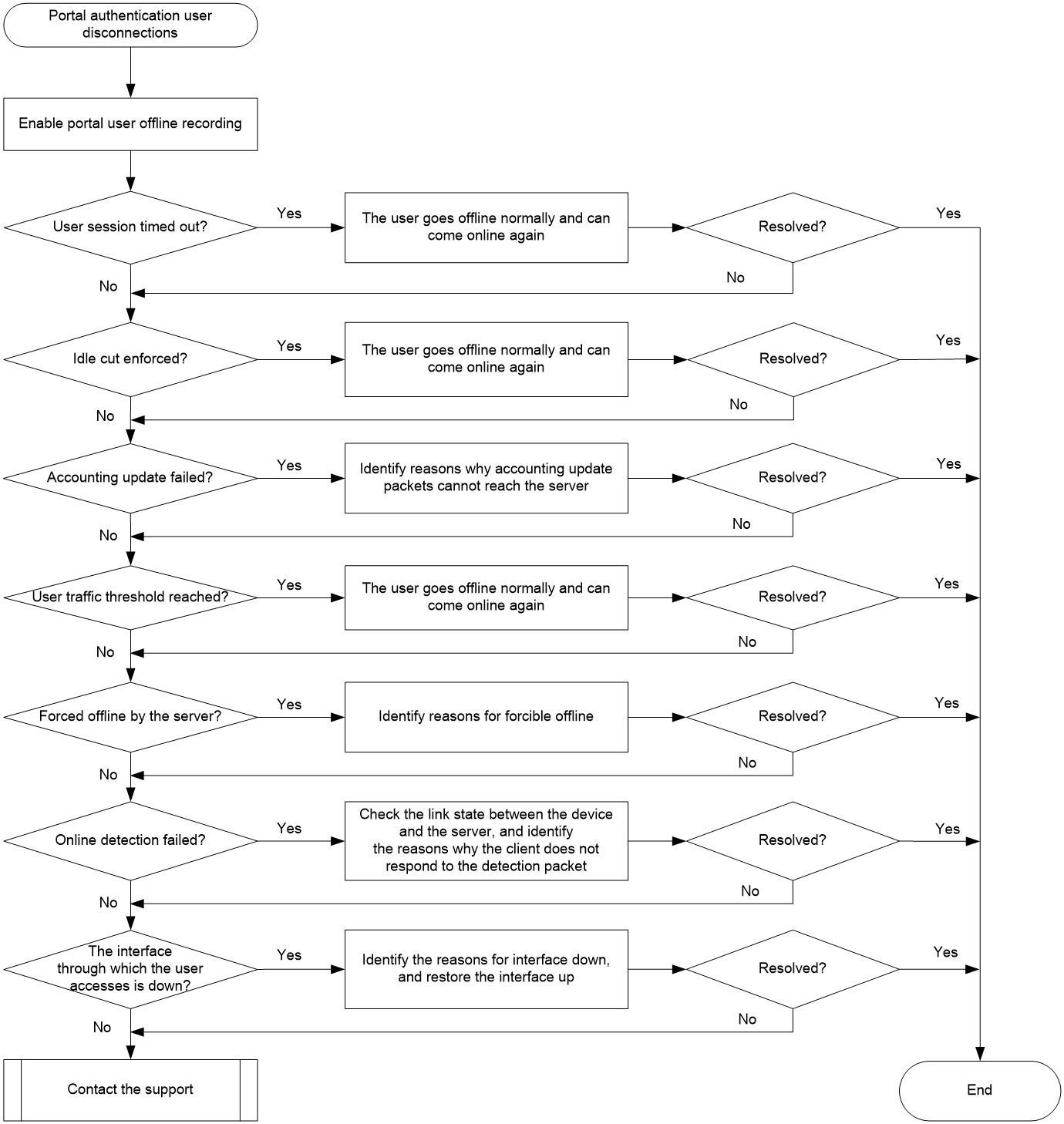

Portal authentication user disconnections
A portal user is disconnected after coming online for a period of time.
Common causes
The following are the common causes of this type of issue:
·     The user session has timed out.
·     User idle cut.
·     Accounting update failures.
·     User traffic reaches the threshold.
·     The server forces the user offline.
·     The user failed the online detection.
·     The interface where the user accesses is down.
Figure 7 shows the troubleshooting flowchart.
Figure 7 Flow chart for troubleshooting portal authentication user disconnections
Solution
