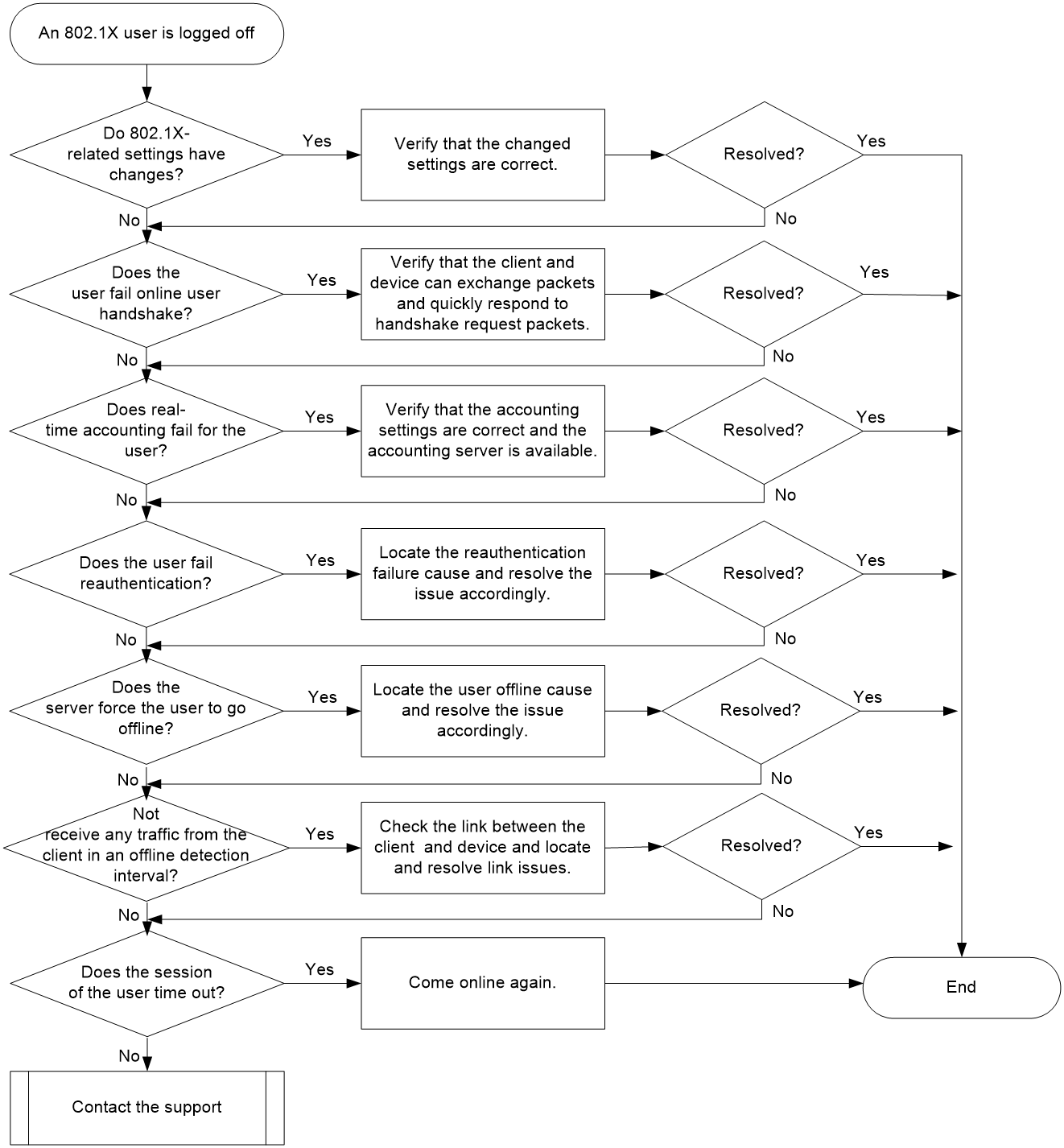

Troubleshooting flow
Figure 2 shows the troubleshooting flowchart.
Figure 2 Flowchart for troubleshooting 802.1X user logoff
Solution
IMPORTANT
IMPORTANT:
·     As a best practice, do not enable debugging when the device is running correctly. However, you can enable debugging when a fault occurs for troubleshooting purposes.
·     Save the results of the steps in this section in a timely manner, so that you can quickly collect and provide feedback if the fault cannot be resolved.
1.     Identify whether settings related to 802.1X authentication have changes on the device and verify that the changed settings are correct.
a.     Execute the display dot1x command to examine whether the 802.1X authentication settings on the device have changes, and verify that the changed settings are correct.
b.     Execute the display domain command to examine whether settings in the authentication domain used by the user have changes, and verify that the changed settings are correct.
2.     Identify whether the user fails online user handshake and troubleshoot the cause of the failure.
a.     Execute the display dot1x command to check the Handshake field to identify whether 802.1X online user handshake is enabled on the interface that the user accesses.
b.     Execute the debugging dot1x event command to enable 802.1X authentication event debugging. If the system generates debugging message Handshake interaction failure, the user has failed online user handshake. You can capture packets to identify whether the device and the client can correctly send and receive EAP data packets and analyze the captured packet file to locate and resolve the issue.
3.     Examine whether real-time accounting fails for the user and troubleshoot the cause of the failure.
Execute the debugging dot1x event command to enable 802.1X authentication event debugging. If the system generates debugging message Real-time accounting failure, real-time accounting has failed for the user. In this case, check the link between the device and the accounting server for connectivity issues, and identify whether settings related to accounting have changes on the device and the accounting server. Verify that the changed settings are correct.
4.     Identify whether the user is logged off due to a reauthentication failure and troubleshoot the cause of the failure.
a.     Execute the display dot1x command to check the Periodic reauth field for the enabling status of 802.1X periodic reauthentication on the interface that the user accesses.
b.     Execute the dot1x access-user log enable abnormal-logoff command to enable logging for exceptional logoffs of 802.1X users. Then, use the DOT1X_LOGOFF_ABNORMAL log to verify that the reason for the user exceptional logoff is reauthentication failure.
c.     To troubleshoot the cause of the reauthentication failure, use the method in "802.1X user authentication failure."
5.     Identify whether the user is logged off by the RADIUS server if RADIUS remote authentication is used.
Execute the debugging dot1x event command to enable 802.1X authentication event debugging. If the system generates debugging message The RADIUS server forcibly logged out the user, the user is logged off by the RADIUS server. You can contact the server administrator to identify the reason for the logoff.
6.     Identify whether the user is logged off because the device has not received any traffic from the user before the offline detection timer expires, and troubleshoot the issue.
a.     Execute the debugging dot1x event command to enable 802.1X authentication event debugging. If the system generates debugging message Offline detect timer expired, it indicates that the device has not received any traffic from the user on the interface within the offline detection interval. As a result, the device cuts off the user's connection, causing the user to go offline.
b.     Check the link between the client and the device for connectivity issues to troubleshoot the reason why the client did not send any packets.
7.     Examine whether the session of the user has timed out.
a.     Identify whether the session timeout time has been configured for the 802.1X user.
-     If RADIUS remote authentication is used, execute the debugging radius packet command to enable RADIUS packet debugging and check the debugging messages to identify whether the response packets sent from the server contain the Session-Timeout attribute.
-     If local authentication is used, execute the display local-user command to check for the existence of the Session-timeout field in the command output.
b.     Execute the debugging dot1x event command to enable 802.1X authentication event debugging. If the system generates debugging message User session timed out, the user goes offline due to session timeout.
c.     It is normal for a user to go offline due to session timeout, and the user can come online again.
8.     If the issue persists, collect the following information and contact Technical Support:
¡     Results of each step.
¡     The configuration file, log messages, and alarm messages.
¡     The offline reason displayed by executing the display aaa abnormal-offline-record or display aaa normal-offline-record command.
¡     The log messages collected by executing the dot1x access-user log enable command.
¡     The debugging messages collected by executing the debugging dot1x all and debugging radius all commands.
