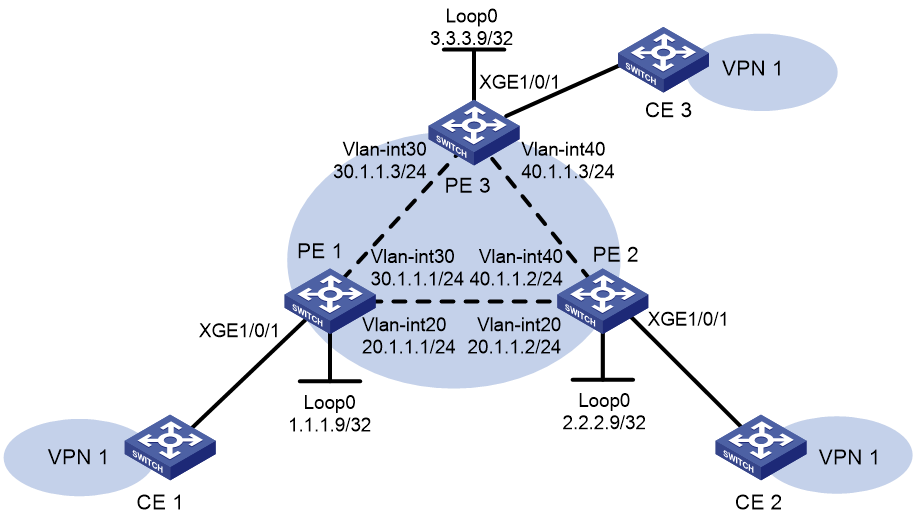

VPLS configuration examples
Example: Configuring static PWs
Configure a VSI on each PE, and establish static PWs between the PEs to interconnect the CEs.
Configure an Ethernet service instance on Ten-GigabitEthernet 1/0/1 to match packets with an outer VLAN ID of 100 on each PE. Bind the Ethernet service instance to the VSI to forward the matching packets through the VSI.
Figure 4 Network diagram
1.     Disable the spanning tree feature globally or map each VLAN to an MSTI. (Details not shown.)

# Create a VSI, specify the peer PEs, and establish static PWs to the peer PEs.
[PE1] vsi svc
[PE1-vsi-svc] pwsignaling static
[PE1-vsi-svc-static] peer 2.2.2.9 pw-id 3 in-label 100 out-label 100
[PE1-vsi-svc-static-2.2.2.9-3] quit
[PE1-vsi-svc-static] peer 3.3.3.9 pw-id 3 in-label 200 out-label 200
[PE1-vsi-svc-static-3.3.3.9-3] quit
[PE1-vsi-svc-static] quit
[PE1-vsi-svc] quit
# Create Ethernet service instance 10 on Ten-GigabitEthernet 1/0/1 to match packets with an outer VLAN ID of 100, and bind the Ethernet service instance to the VSI svc.
[PE1] interface ten-gigabitethernet 1/0/1
[PE1-Ten-GigabitEthernet1/0/1] service-instance 10
[PE1-Ten-GigabitEthernet1/0/1-srv10] encapsulation s-vid 100
[PE1-Ten-GigabitEthernet1/0/1-srv10] xconnect vsi svc
[PE3] vsi svc
[PE3-vsi-svc] pwsignaling static
[PE3-vsi-svc-static] peer 1.1.1.9 pw-id 3 in-label 200 out-label 200
[PE3-vsi-svc-static-1.1.1.9-3] quit
[PE3-vsi-svc-static] peer 2.2.2.9 pw-id 3 in-label 300 out-label 300
[PE3-vsi-svc-static-2.2.2.9-3] quit
[PE3-vsi-svc-static] quit
[PE3-vsi-svc] quit
[PE3] interface ten-gigabitethernet 1/0/1
[PE3-Ten-GigabitEthernet1/0/1] service-instance 10
[PE3-Ten-GigabitEthernet1/0/1-srv10] encapsulation s-vid 100
[PE3-Ten-GigabitEthernet1/0/1-srv10] xconnect vsi svc
# Verify that two static PWs in up state have been established on PE 1.
[PE1] display l2vpn pw verbose
VSI Name: svc
  Peer: 2.2.2.9          PW ID: 3
    Signaling Protocol  : Static
    Link ID             : 8          PW State : Up
    In Label            : 100        Out Label: 100
    MTU                 : 1500
    PW Attributes       : Main
    VCCV CC             : -
    VCCV BFD            : -
    Flow Label          : -
    Tunnel Group ID     : 0x160000001
    Tunnel NHLFE IDs    : 1027
    Admin PW            : -
  Peer: 3.3.3.9          PW ID: 3
    Link ID             : 9          PW State : Up
    In Label            : 200        Out Label: 200
    MTU                 : 1500
    VCCV CC             : -
    VCCV BFD            : -
    Flow Label          : -
    Tunnel Group ID     : 0x260000002
    Tunnel NHLFE IDs    : 1028
    Admin PW            : -

Example: Configuring BGP auto-discovery LDP PWs
Configure a VSI on each PE. Use BGP to discover remote PEs and use LDP to create PWs among PEs so CEs in different sites of VPN 1 can communicate with each other.
Figure 7 Network diagram
For more information, see spanning tree in Layer 2—LAN Switching Configuration Guide.
2.     Configure an IGP and public tunnels on each PE. (Details not shown.)
3.     Configure PE 1:
# Configure basic MPLS.
<PE1> system-view
[PE1] interface loopback 0
[PE1-LoopBack0] ip address 1.1.1.9 32
[PE1-LoopBack0] quit
[PE1] mpls lsr-id 1.1.1.9
[PE1] mpls ldp
[PE1-ldp] quit
# Establish IBGP connections to PE 1 and PE 2, and use BGP to advertise VPLS PE information.
[PE1] bgp 100
[PE1-bgp-default] peer 2.2.2.9 as-number 100
[PE1-bgp-default] peer 2.2.2.9 connect-interface loopback 0
[PE1-bgp-default] peer 3.3.3.9 as-number 100
[PE1-bgp-default] peer 3.3.3.9 connect-interface loopback 0
[PE1-bgp-default] address-family l2vpn
[PE1-bgp-default-l2vpn] peer 2.2.2.9 enable
[PE1-bgp-default-l2vpn] peer 3.3.3.9 enable
[PE1-bgp-default-l2vpn] quit
[PE1-bgp-default] quit
# Enable L2VPN.
[PE1] l2vpn enable
# Configure VSI aaa to use BGP to discover remote PEs and use LDP to establish LDP PWs to PE 2 and PE 3.
[PE1] vsi aaa
[PE1-vsi-aaa] auto-discovery bgp
[PE1-vsi-aaa-auto] route-distinguisher 1:1
[PE1-vsi-aaa-auto] vpn-target 1:1
[PE1-vsi-aaa-auto] signaling-protocol ldp
[PE1-vsi-aaa-auto-ldp] vpls-id 100:100
[PE1-vsi-aaa-auto-ldp] quit
[PE1-vsi-aaa-auto] quit
[PE1-vsi-aaa] quit
# Create Ethernet service instance 10 on Ten-GigabitEthernet 1/0/1 to match packets with an outer VLAN ID of 100, and bind the Ethernet service instance to the VSI aaa.
[PE1-Ten-GigabitEthernet1/0/1-srv10] xconnect vsi aaa
4.     Configure PE 2:
<PE2> system-view
[PE2] interface loopback 0
[PE2-LoopBack0] ip address 2.2.2.9 32
[PE2-LoopBack0] quit
[PE2] mpls lsr-id 2.2.2.9
[PE2] mpls ldp
[PE2-ldp] quit
# Establish IBGP connections to PE 1 and PE 3, and use BGP to advertise VPLS PE information.
[PE2] bgp 100
[PE2-bgp-default] peer 1.1.1.9 as-number 100
[PE2-bgp-default] peer 1.1.1.9 connect-interface loopback 0
[PE2-bgp-default] peer 3.3.3.9 as-number 100
[PE2-bgp-default] peer 3.3.3.9 connect-interface loopback 0
[PE2-bgp-default] address-family l2vpn
[PE2-bgp-default-l2vpn] peer 1.1.1.9 enable
[PE2-bgp-default-l2vpn] peer 3.3.3.9 enable
[PE2-bgp-default-l2vpn] quit
[PE2-bgp-default] quit
# Enable L2VPN.
[PE2] l2vpn enable
# Configure VSI aaa to use BGP to discover remote PEs and use LDP to establish LDP PWs to PE 1 and PE 3.
[PE2] vsi aaa
[PE2-vsi-aaa] auto-discovery bgp
[PE2-vsi-aaa-auto] route-distinguisher 1:1
[PE2-vsi-aaa-auto] vpn-target 1:1
[PE2-vsi-aaa-auto] signaling-protocol ldp
[PE2-vsi-aaa-auto-ldp] vpls-id 100:100
[PE2-vsi-aaa-auto-ldp] quit
[PE2-vsi-aaa-auto] quit
[PE2-vsi-aaa] quit
[PE2] interface ten-gigabitethernet 1/0/1
[PE2-Ten-GigabitEthernet1/0/1] service-instance 10
[PE2-Ten-GigabitEthernet1/0/1-srv10] encapsulation s-vid 100
[PE2-Ten-GigabitEthernet1/0/1-srv10] xconnect vsi aaa
5.     Configure PE 3:
<PE3> system-view
[PE3] interface loopback 0
[PE3-LoopBack0] ip address 3.3.3.9 32
[PE3-LoopBack0] quit
[PE3] mpls lsr-id 3.3.3.9
[PE3] mpls ldp
[PE3-ldp] quit
[PE3] bgp 100
[PE3-bgp-default] peer 1.1.1.9 as-number 100
[PE3-bgp-default] peer 1.1.1.9 connect-interface loopback 0
[PE3-bgp-default] peer 2.2.2.9 as-number 100
[PE3-bgp-default] peer 2.2.2.9 connect-interface loopback 0
[PE3-bgp-default] address-family l2vpn
[PE3-bgp-default-l2vpn] peer 1.1.1.9 enable
[PE3-bgp-default-l2vpn] peer 2.2.2.9 enable
[PE3-bgp-default-l2vpn] quit
[PE3-bgp-default] quit
# Enable L2VPN.
[PE3] l2vpn enable
# Configure VSI aaa to use BGP to discover remote PEs and use LDP to establish LDP PWs to PE 1 and PE 2.
[PE3] vsi aaa
[PE3-vsi-aaa] auto-discovery bgp
[PE3-vsi-aaa-auto] route-distinguisher 1:1
[PE3-vsi-aaa-auto] vpn-target 1:1
[PE3-vsi-aaa-auto] signaling-protocol ldp
[PE3-vsi-aaa-auto-ldp] vpls-id 100:100
[PE3-vsi-aaa-auto-ldp] quit
[PE3-vsi-aaa-auto] quit
[PE3-vsi-aaa] quit
[PE3-Ten-GigabitEthernet1/0/1-srv10] xconnect vsi aaa
# Verify that two PWs have been established on PE 1.
VSI Name: aaa
  Peer: 2.2.2.9          VPLS ID: 100:100
    Signaling Protocol  : LDP
    In Label            : 1555       Out Label: 1555
    MTU                 : 1500
    VCCV CC             : -
    VCCV BFD            : -
    Flow Label          : -
    Tunnel Group ID     : 0x800000060000000
    Tunnel NHLFE IDs    : 1029
    Admin PW            : -
  Peer: 3.3.3.9          VPLS ID: 100:100
    In Label            : 1554       Out Label: 1416
    MTU                 : 1500
    VCCV CC             : -
    VCCV BFD            : -
    Flow Label          : -
    Tunnel Group ID     : 0x800000160000001
    Tunnel NHLFE IDs    : 1030
    Admin PW            : -
# Display LDP PW label information on PE 1.
[PE1] display l2vpn ldp verbose
  VSI Name: aaa
  PW State: Up
  PW Status Communication: Notification method
  PW ID FEC (Local/Remote):
    Local AII   : (1.1.1.9, 2.2.2.9)
    Remote AII  : (2.2.2.9, 1.1.1.9)
    PW Type     : VLAN/VLAN
    Group ID    : 0/0
    Label       : 1555/1555
    Control Word: Disabled/Disabled
    VCCV CV Type: -/-
    VCCV CC Type: -/-
    MTU         : 1500/1500
    PW Status   : PW forwarding/PW forwarding
  VSI Name: aaa
  PW State: Up
    Local AII   : (1.1.1.9, 3.3.3.9)
    Remote AII  : (3.3.3.9, 1.1.1.9)
    PW Type     : VLAN/VLAN
    Group ID    : 0/0
    Label       : 1554/1416
    VCCV CV Type: -/-
    VCCV CC Type: -/-
    MTU         : 1500/1500
