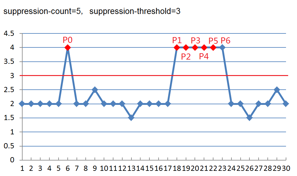

Use ptp time-offset to configure the PTP offset threshold and the number of times PTP time synchronization is suppressed.
Use undo ptp time-offset to restore the default.
Syntax
ptp time-offset { suppression-count suppression-count | suppression-threshold threshold-value } *
undo ptp time-offset { suppression-count | suppression-threshold } *
Default
The PTP offset threshold is 3000 nanoseconds, and PTP time synchronization is suppressed twice.
Views
System view
Predefined user roles
network-admin
Parameters
suppression-count suppression-count: Specifies the number of times PTP time synchronization is suppressed. The value is in the range of 2 to 80.
suppression-threshold threshold-value: Specifies the PTP time offset threshold, in nanoseconds. The value is in the range of 20 to 1000000.
Usage guidelines
Application scenarios
This command is used to prevent clock source jumps. With this mechanism, the device can ensure that time synchronization is restored after the clock source stabilizes, and avoid time synchronization errors caused by sudden clock changes.
Operating mechanism
After master-member relationships are established between the clock nodes, the master and member clock nodes exchange PTP messages and record the message transmit and receive time. Based on the timestamps, each member clock calculates the path delay and then gets the time offset between them and the master clock and adjusts their time accordingly for time synchronization with the master clock.
With this command configured, if the clock is in a stable synchronization state but the offset value at the current sampling point exceeds the PTP time offset threshold, the device will identify this as a clock source jump and stop the current PTP time synchronization. The device will then determine whether to synchronize subsequent clock signals based on the following rules:
·     If the offset for the next sampling point is smaller than or equal to the PTP time offset threshold, the device continues synchronization with the clock source.
·     If the offset is greater the PTP time offset threshold, the device performs PTP time synchronization only when the number of suppressions reaches the specified value. When the device receives the next clock signal, it performs PTP time synchronization no matter whether the offset value is greater than the PTP time offset threshold or not.
Assume that the values for suppression-count and threshold-value are set to 5 and 3, respectively. When the offset is less than or equal to 3, the device synchronizes its time with the clock source normally. When a sudden clock change causes the offset to exceed 3, the device stops synchronization with the clock signal until the value of suppression-count is reached. As shown in Figure 1, because the offset value is greater than 3 at sampling points P0 through P5, the device stops synchronization with the clock source. At sampling point P6, the device starts to synchronize with the clock source no matter whether the offset is greater than the PTP time offset threshold or not, because the number of suppressions has reached 5.
Figure 1 PTP clock source jump prevention
Specify a PTP profile, PTP clock node type, and PTP domain before you execute this command.
If you execute this command multiple times, the most recent configuration takes effect.
