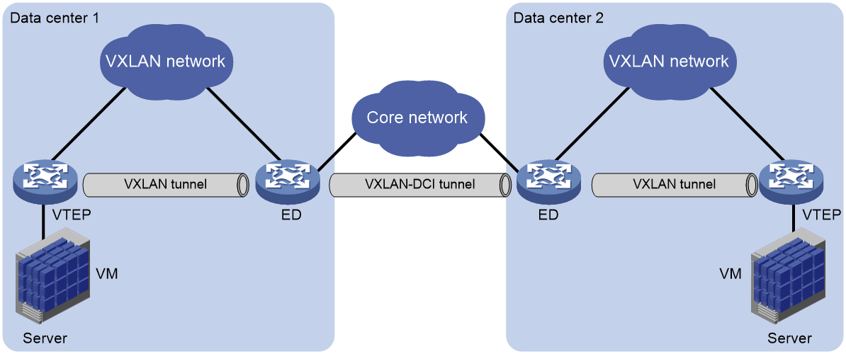

EVPN-DCI network model
As shown in Figure 1, the EVPN-DCI network contains VTEPs and edge devices (EDs) located at the edge of the transport network. A VXLAN tunnel is established between a VTEP and an ED, and a VXLAN-DCI tunnel is established between two EDs. VXLAN-DCI tunnels use VXLAN encapsulation. Each ED de-encapsulates incoming VXLAN packets and re-encapsulates them based on the destination before forwarding the packets through a VXLAN or VXLAN-DCI tunnel.
Figure 1 EVPN-DCI network model
Working mechanisms
In an EVPN-DCI network, BGP EVPN peer relationships are established between EDs and between EDs and VTEPs. When advertising routes to a VTEP or another ED, an ED replaces the routes' nexthop IP address and router MAC address with its IP address and router MAC address.
In an EVPN-DCI network, a VTEP and an ED use a VXLAN tunnel to send traffic, and two EDs use a VXLAN-DCI tunnel to send traffic. An ED de-encapsulates incoming VXLAN packets and re-encapsulates them before forwarding the packets through a VXLAN or VXLAN-DCI tunnel.

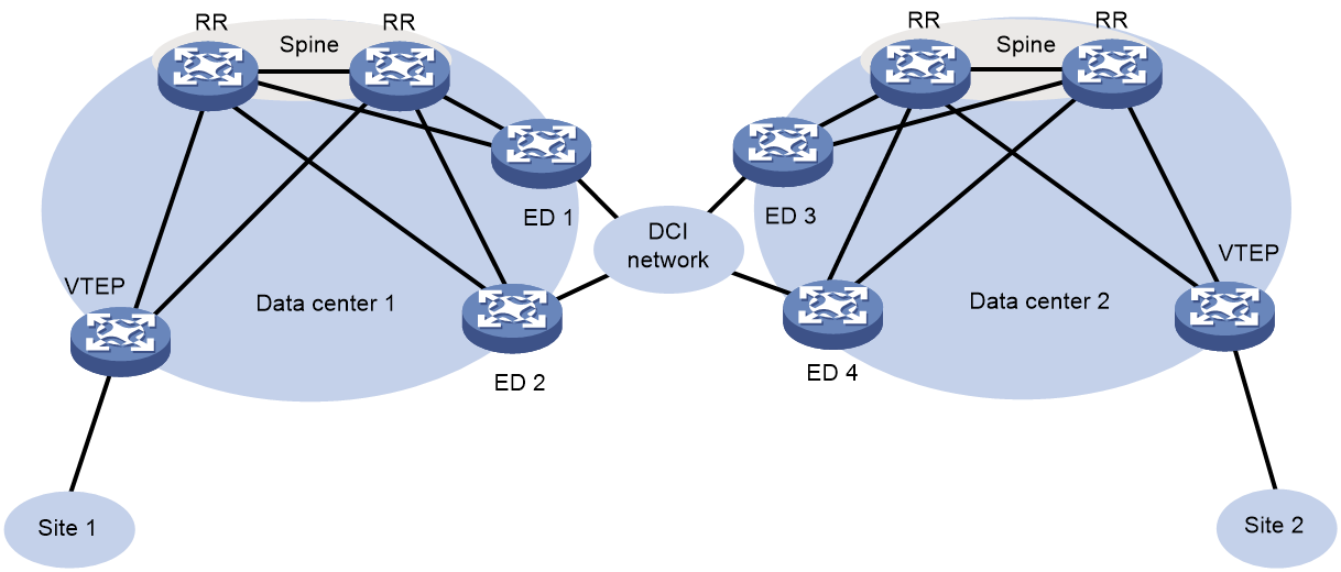

EVPN-DCI dualhoming
As shown in Figure 2, EVPN-DCI dualhoming allows you to deploy two EDs at a data center for high availability and load sharing. To virtualize the redundant EDs into one device, a virtual ED address is configured on them. The redundant EDs use the virtual ED address to establish tunnels with VTEPs and remote EDs.
Figure 2 EVPN-DCI dualhoming
The redundant EDs use their respective IP addresses as the BGP peer addresses to establish BGP EVPN neighbor relationships with VTEPs and remote EDs. The VTEPs and remote EDs send traffic destined for the virtual ED address to both of the redundant EDs through the ECMP routes provided by the underlay network.
The redundant EDs communicate with remote data centers through the transport network. Devices in the dualhomed data center are unaware of the transport network. When the transport-side link fails on one of the redundant EDs, traffic destined for remote data centers is still sent to that ED. To resolve this issue, EAA CLI-defined monitor policies and Track are used together with EVPN-DCI dualhoming.
On each redundant ED, the transport-facing physical interface is associated with the following loopback interfaces: The loopback interface that provides the IP address used for establishing BGP EVPN neighbor relationships and the loopback interface that provides the virtual ED address. If the transport-side link fails on a redundant ED, the loopback interfaces are placed in down state, and all traffic is forwarded by the other redundant ED. For more information about EAA, see Network Management and Monitoring Configuration Guide.
For link redundancy, deploy multiple RRs on the spine nodes in a data center, and connect each redundant ED to the transport network through multiple links.

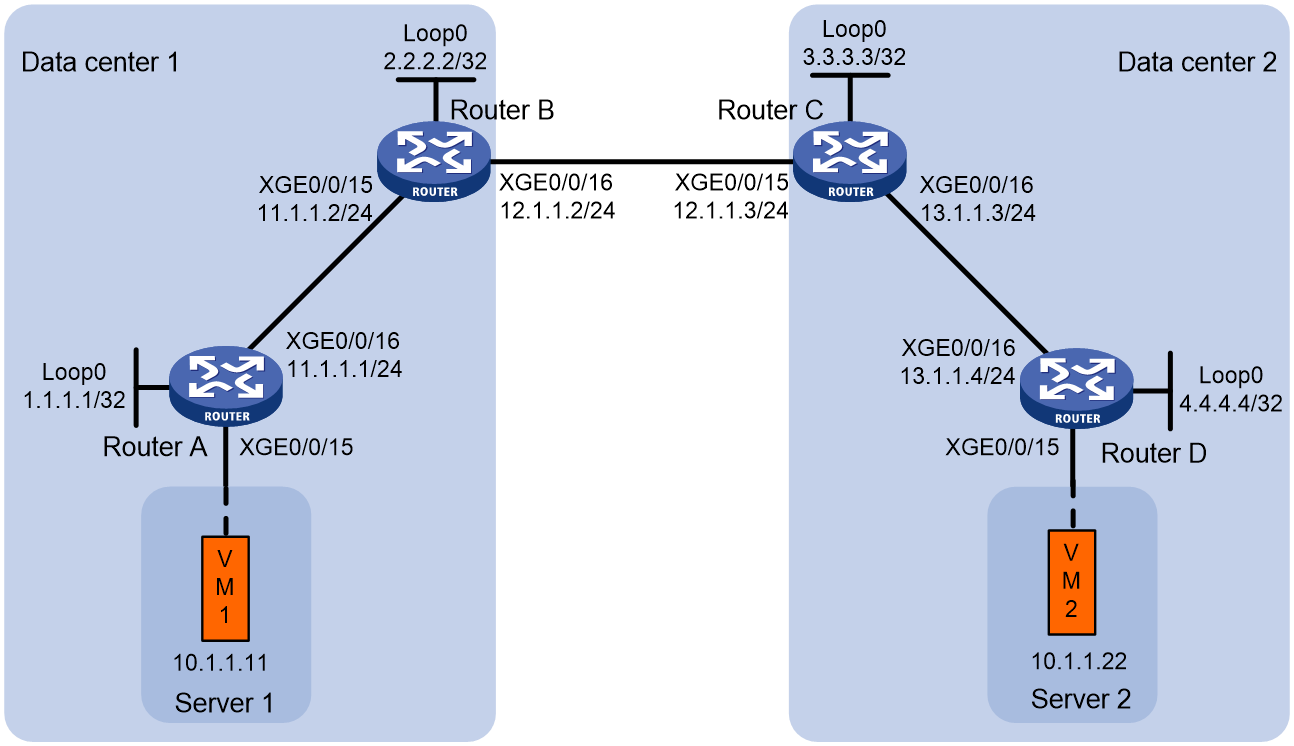

Example: Configuring a basic EVPN-DCI network
As shown in Figure 4:
·     Configure VXLAN 10 on Router A through Router D to provide connectivity for the VMs in the data centers.
·     Configure Router A and Router D as VTEPs, and configure Router B and Router C as EDs.
Figure 4 Network diagram
1.     Configure IP addresses and unicast routing settings:
# Assign IP addresses to the interfaces, as shown in Figure 4. (Details not shown.)
# Configure OSPF on the transport network for the routers to reach one another. (Details not shown.)

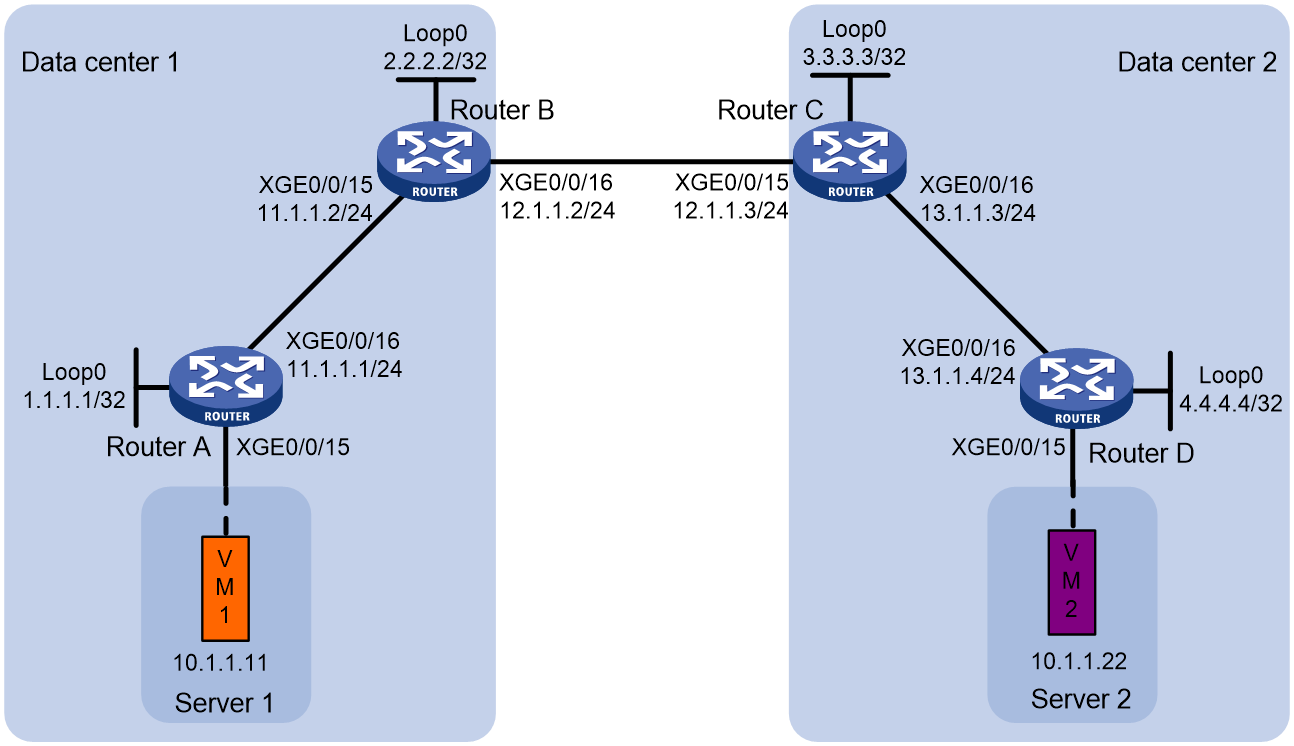

Example: Configuring EVPN-DCI intermediate VXLAN mapping
As shown in Figure 5:
·     Configure VXLAN 10 on VTEP Router A and ED Router B, and configure VXLAN 30 on VTEP Router D and ED Router C.
·     Configure intermediate VXLAN mapping for VXLAN 10 and VXLAN 30 to have Layer 2 connectivity:
¡     Map VXLAN 10 to intermediate VXLAN 500 on Router B.
¡     Map VXLAN 30 to intermediate VXLAN 500 on Router C.
Figure 5 Network diagram
# Assign IP addresses to the interfaces, as shown in Figure 5. (Details not shown.)
2.     Configure Router A:
# Enable L2VPN.
<RouterA> system-view
[RouterA] l2vpn enable
# Disable remote MAC address learning.
[RouterA] vxlan tunnel mac-learning disable
# Create VXLAN 10 on VSI vpna.
[RouterA] vsi vpna
[RouterA-vsi-vpna] vxlan 10
[RouterA-vsi-vpna-vxlan-10] quit
# Create an EVPN instance on VSI vpna. Configure the router to automatically generate an RD and a route target for the EVPN instance.
[RouterA-vsi-vpna] evpn encapsulation vxlan
[RouterA-vsi-vpna-evpn-vxlan] route-distinguisher auto
[RouterA-vsi-vpna-evpn-vxlan] vpn-target auto
[RouterA-vsi-vpna-evpn-vxlan] quit
[RouterA-vsi-vpna] quit
# Configure BGP to advertise BGP EVPN routes.
[RouterA] bgp 100
[RouterA-bgp-default] peer 2.2.2.2 as-number 100
[RouterA-bgp-default] peer 2.2.2.2 connect-interface loopback 0
[RouterA-bgp-default] address-family l2vpn evpn
[RouterA-bgp-default-evpn] peer 2.2.2.2 enable
[RouterA-bgp-default-evpn] quit
[RouterA-bgp-default] quit
# Map site-facing interface Ten-GigabitEthernet 0/0/15 to VSI vpna.
[RouterA] interface ten-gigabitethernet 0/0/15
[RouterA-Ten-GigabitEthernet0/0/15] xconnect vsi vpna
[RouterA-Ten-GigabitEthernet0/0/15] quit
3.     Configure Router B:
# Enable L2VPN.
<RouterB> system-view
[RouterB] l2vpn enable
[RouterB] vxlan tunnel mac-learning disable
# Enable DCI on the Layer 3 interface that connects Router B to Router C for the routers to establish a VXLAN-DCI tunnel.
[RouterB] interface ten-gigabitethernet 0/0/16
[RouterB-Ten-GigabitEthernet0/0/16] dci enable
[RouterB-Ten-GigabitEthernet0/0/16] quit
[RouterB] vsi vpna
[RouterB-vsi-vpna] vxlan 10
[RouterB-vsi-vpna-vxlan-10] quit
[RouterB-vsi-vpna] evpn encapsulation vxlan
[RouterB-vsi-vpna-evpn-vxlan] route-distinguisher auto
[RouterB-vsi-vpna-evpn-vxlan] vpn-target auto
# Map local VXLAN 10 to intermediate VXLAN 500.
[RouterB-vsi-vpna-evpn-vxlan] mapping vni 500
[RouterB-vsi-vpna-evpn-vxlan] quit
[RouterB-vsi-vpna] quit
# Create VXLAN 500 on VSI vpnb. The router will replace the VXLAN ID of VXLAN 10's traffic with VXLAN ID 500 when performing Layer 2 forwarding.
[RouterB] vsi vpnb
[RouterB-vsi-vpnb] vxlan 500
[RouterB-vsi-vpnb-vxlan-500] quit
# Create an EVPN instance on VSI vpnb. Configure the router to automatically generate an RD, and manually configure a route target for the EVPN instance.
[RouterB-vsi-vpnb] evpn encapsulation vxlan
[RouterB-vsi-vpnb-evpn-vxlan] route-distinguisher auto
[RouterB-vsi-vpnb-evpn-vxlan] vpn-target 123:456
[RouterB-vsi-vpnb-evpn-vxlan] quit
[RouterB-vsi-vpnb] quit
# Configure BGP to advertise BGP EVPN routes. Enable nexthop replacement for routes advertised to Router A, and enable router MAC replacement for routes advertised to and received from Router C.
[RouterB] bgp 100
[RouterB-bgp-default] peer 3.3.3.3 as-number 200
[RouterB-bgp-default] peer 3.3.3.3 connect-interface loopback 0
[RouterB-bgp-default] peer 3.3.3.3 ebgp-max-hop 64
[RouterB-bgp-default] peer 1.1.1.1 as-number 100
[RouterB-bgp-default] peer 1.1.1.1 connect-interface loopback 0
[RouterB-bgp-default] address-family l2vpn evpn
[RouterB-bgp-default-evpn] peer 3.3.3.3 enable
[RouterB-bgp-default-evpn] peer 3.3.3.3 router-mac-local
[RouterB-bgp-default-evpn] peer 1.1.1.1 enable
[RouterB-bgp-default-evpn] peer 1.1.1.1 next-hop-local
[RouterB-bgp-default-evpn] quit
[RouterB-bgp-default] quit
4.     Configure Router C:
# Enable L2VPN.
<RouterC> system-view
[RouterC] l2vpn enable
[RouterC] vxlan tunnel mac-learning disable
# Enable DCI on the Layer 3 interface that connects Router C to Router B for the routers to establish a VXLAN-DCI tunnel.
[RouterC] interface ten-gigabitethernet 0/0/15
[RouterC-Ten-GigabitEthernet0/0/15] dci enable
[RouterC-Ten-GigabitEthernet0/0/15] quit
# Create VXLAN 30 on VSI vpna.
[RouterC] vsi vpna
[RouterC-vsi-vpna] vxlan 30
[RouterC-vsi-vpna-vxlan-30] quit
[RouterC-vsi-vpna] evpn encapsulation vxlan
[RouterC-vsi-vpna-evpn-vxlan] route-distinguisher auto
[RouterC-vsi-vpna-evpn-vxlan] vpn-target auto
# Map local VXLAN 30 to intermediate VXLAN 500.
[RouterC-vsi-vpna-evpn-vxlan] mapping vni 500
[RouterC-vsi-vpna-evpn-vxlan] quit
[RouterC-vsi-vpna] quit
# Create VXLAN 500 on VSI vpnb. The router will replace the VXLAN ID of VXLAN 30's traffic with VXLAN ID 500 when performing Layer 2 forwarding.
[RouterC] vsi vpnb
[RouterC-vsi-vpnb] vxlan 500
[RouterC-vsi-vpnb-vxlan-500] quit
[RouterC-vsi-vpnb] evpn encapsulation vxlan
[RouterC-vsi-vpnb-evpn-vxlan] route-distinguisher auto
[RouterC-vsi-vpnb-evpn-vxlan] vpn-target 123:456
[RouterC-vsi-vpnb-evpn-vxlan] quit
[RouterC-vsi-vpnb] quit
# Configure BGP to advertise BGP EVPN routes. Enable nexthop replacement for routes advertised to Router D, and enable router MAC replacement for routes advertised to and received from Router B.
[RouterC] bgp 200
[RouterC-bgp-default] peer 2.2.2.2 as-number 100
[RouterC-bgp-default] peer 2.2.2.2 connect-interface loopback 0
[RouterC-bgp-default] peer 2.2.2.2 ebgp-max-hop 64
[RouterC-bgp-default] peer 4.4.4.4 as-number 200
[RouterC-bgp-default] peer 4.4.4.4 connect-interface loopback 0
[RouterC-bgp-default] address-family l2vpn evpn
[RouterC-bgp-default-evpn] peer 2.2.2.2 enable
[RouterC-bgp-default-evpn] peer 2.2.2.2 router-mac-local
[RouterC-bgp-default-evpn] peer 4.4.4.4 enable
[RouterC-bgp-default-evpn] peer 4.4.4.4 next-hop-local
[RouterC-bgp-default-evpn] quit
[RouterC-bgp-default] quit
5.     Configure Router D:
# Enable L2VPN.
<RouterD> system-view
[RouterD] l2vpn enable
[RouterD] vxlan tunnel mac-learning disable
[RouterD] vsi vpna
[RouterD-vsi-vpna] vxlan 30
[RouterD-vsi-vpna-vxlan-30] quit
[RouterD-vsi-vpna] evpn encapsulation vxlan
[RouterD-vsi-vpna-evpn-vxlan] route-distinguisher auto
[RouterD-vsi-vpna-evpn-vxlan] vpn-target auto
[RouterD-vsi-vpna-evpn-vxlan] quit
[RouterD-vsi-vpna] quit
[RouterD] bgp 200
[RouterD-bgp-default] peer 3.3.3.3 as-number 200
[RouterD-bgp-default] peer 3.3.3.3 connect-interface loopback 0
[RouterD-bgp-default] address-family l2vpn evpn
[RouterD-bgp-default-evpn] peer 3.3.3.3 enable
[RouterD-bgp-default-evpn] quit
[RouterD-bgp-default] quit
[RouterD] interface ten-gigabitethernet 0/0/15
[RouterD-Ten-GigabitEthernet0/0/15] xconnect vsi vpna
[RouterD-Ten-GigabitEthernet0/0/15] quit
1.     Verify the configuration on EDs. (This example uses Router B.)
# Verify that the ED has discovered Router A and Router C through IMET routes and has established VXLAN and VXLAN-DCI tunnels to the routers.
[RouterB] display evpn auto-discovery imet
Total number of automatically discovered peers: 2
VSI name: vpna
RD                    PE_address      Tunnel_address  Tunnel mode VXLAN ID
1:10                  1.1.1.1         1.1.1.1         VXLAN       10
1:500                 3.3.3.3         3.3.3.3         VXLAN-DCI   500
# Verify that the VXLAN and VXLAN-DCI tunnels on the ED are up.
[RouterB] display interface tunnel
Tunnel0
Interface index: 261
Current state: UP
Line protocol state: UP
Description: Tunnel0 Interface
Bandwidth: 64 kbps
Maximum transmission unit: 1464
Internet protocol processing: Disabled
Last clearing of counters: Never
Tunnel source 2.2.2.2, destination 1.1.1.1
Tunnel protocol/transport UDP_VXLAN/IP
Last 300 seconds input rate: 0 bytes/sec, 0 bits/sec, 0 packets/sec
Last 300 seconds output rate: 0 bytes/sec, 0 bits/sec, 0 packets/sec
Input: 0 packets, 0 bytes, 0 drops
Output: 0 packets, 0 bytes, 0 drops
Tunnel1
Interface index: 262
Current state: UP
Description: Tunnel1 Interface
Bandwidth: 64 kbps
Maximum transmission unit: 1500
Tunnel source 2.2.2.2, destination 3.3.3.3
Tunnel protocol/transport UDP_VXLAN-DCI/IP
# Verify that the VXLAN and VXLAN-DCI tunnels have been assigned to VXLAN 10, and that no tunnels are assigned to intermediate VXLAN 500.
[RouterB] display l2vpn vsi verbose
VSI Name: vpna
  VSI Index               : 0
  VSI State               : Up
  MTU                     : 1500
  Diffserv Mode           : -
  Bandwidth               : Unlimited
  Broadcast Restrain      : 5120 kbps
  Multicast Restrain      : 5120 kbps
  Unknown Unicast Restrain: 5120 kbps
  MAC Learning            : Enabled
  MAC Table Limit         : Unlimited
  MAC Learning rate       : -
  Local MAC aging time    : 300 sec
  Remote MAC aging time   : 300 sec
  Drop Unknown            : Disabled
  PW Redundancy Mode      : Slave
  DSCP                    : -
  Service Class           : -
  Flooding                : Enabled
  ESI                     : 0000.0000.0000.0000.0000
  Redundancy Mode         : All-active
  Straight-fwd PW-to-AC   : Disabled
  Statistics              : Disabled
  VXLAN ID                : 10
  Tunnel Statistics       : Disabled
  Tunnels:
    Tunnel Name          Link ID    State    Type        Flood proxy
    Tunnel0              0x5000000  UP       Auto        Disabled
    Tunnel1              0x5000001  UP       Auto        Disabled
VSI Name: vpnb
  VSI Index               : 1
  VSI State               : Up
  MTU                     : 1500
  Diffserv Mode           : -
  DSCP                    : -
  Service Class           : -
  Flooding                : Enabled
  VXLAN ID                : 500
# Verify that the ED has generated EVPN MAC address entries for the VMs, and the remote MAC address entry has the M flag.
[RouterB] display evpn route mac
Flags: D - Dynamic   B - BGP   G - Gateway   L - Local active   M - Mapping
VSI name: vpna
MAC address     Link ID/Name   Flags   Encap           Next hop
0001-0001-0011  Tunnel0         B      VXLAN           1.1.1.1
0001-0001-0033  Tunnel1         BM     VXLAN           3.3.3.3
2.     Verify that VM 1 and VM 2 can communicate. (Details not shown.)

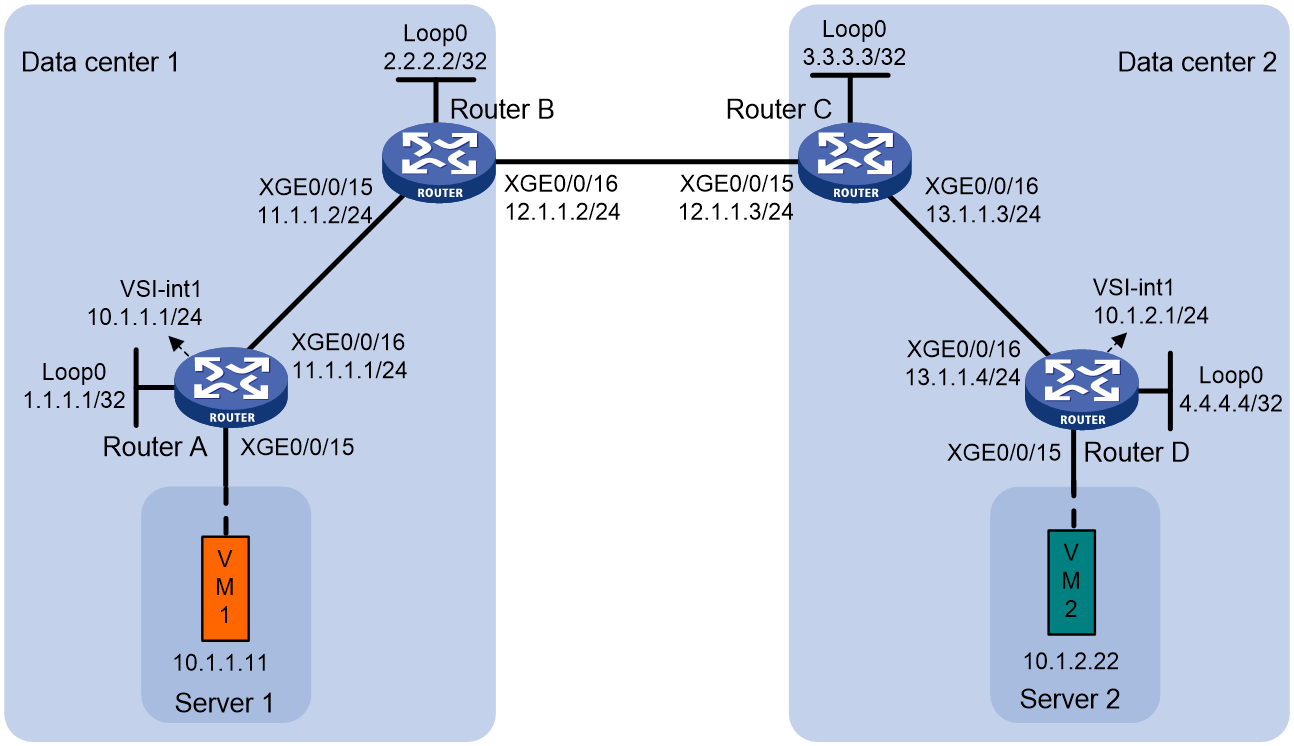

Example: Configuring EVPN-DCI IPv4 Layer 3 communication
As shown in Figure 6:
·     Configure VXLAN 10 for data center 1, and configure VXLAN 20 for data center 2.
·     Configure Router A and Router D as distributed EVPN gateways to perform Layer 3 forwarding between VXLAN 10 and VXLAN 20.
·     Configure Router B and Router C as EDs.
Figure 6 Network diagram
# On VM 1, specify 10.1.1.1 as the gateway address. On VM 2, specify 10.1.2.1 as the gateway address. (Details not shown.)
# Assign IP addresses to the interfaces, as shown in Figure 6. (Details not shown.)
# Enable L2VPN.
# Disable remote MAC address learning and remote ARP learning.
[RouterA] vxlan tunnel arp-learning disable
[RouterA] vsi vpna
[RouterA] bgp 100
# Configure RD and route target settings for VPN instance vpn1.
[RouterA] ip vpn-instance vpn1
[RouterA-vpn-instance-vpn1] route-distinguisher 1:1
[RouterA-vpn-instance-vpn1] address-family ipv4
[RouterA-vpn-ipv4-vpn1] vpn-target 2:2
[RouterA-vpn-ipv4-vpn1] quit
[RouterA-vpn-instance-vpn1] address-family evpn
[RouterA-vpn-evpn-vpn1] vpn-target 1:1
[RouterA-vpn-evpn-vpn1] quit
[RouterA-vpn-instance-vpn1] quit
# Configure VSI-interface 1 as a distributed gateway.
[RouterA] interface vsi-interface 1
[RouterA-Vsi-interface1] ip binding vpn-instance vpn1
[RouterA-Vsi-interface1] ip address 10.1.1.1 255.255.255.0
[RouterA-Vsi-interface1] mac-address 1-1-1
[RouterA-Vsi-interface1] distributed-gateway local
[RouterA-Vsi-interface1] quit
# Create VSI-interface 2. Associate VSI-interface 2 with VPN instance vpn1, and configure the L3 VXLAN ID as 1000 for the VPN instance.
[RouterA] interface vsi-interface 2
[RouterA-Vsi-interface2] ip binding vpn-instance vpn1
[RouterA-Vsi-interface2] l3-vni 1000
[RouterA-Vsi-interface2] quit
# Specify VSI-interface 1 as the gateway interface for VSI vpna.
[RouterA] vsi vpna
[RouterA-vsi-vpna] gateway vsi-interface 1
# Enable L2VPN.
[RouterB] vxlan tunnel arp-learning disable
[RouterB] bgp 100
[RouterB] ip vpn-instance vpn1
[RouterB-vpn-instance-vpn1] route-distinguisher 1:2
[RouterB-vpn-instance-vpn1] address-family ipv4
[RouterB-vpn-ipv4-vpn1] vpn-target 2:2
[RouterB-vpn-ipv4-vpn1] quit
[RouterB-vpn-instance-vpn1] address-family evpn
[RouterB-vpn-evpn-vpn1] vpn-target 1:1
[RouterB-vpn-evpn-vpn1] quit
[RouterB-vpn-instance-vpn1] quit
[RouterB] interface vsi-interface 2
[RouterB-Vsi-interface2] ip binding vpn-instance vpn1
[RouterB-Vsi-interface2] l3-vni 1000
[RouterB-Vsi-interface2] quit
# Enable L2VPN.
[RouterC] vxlan tunnel arp-learning disable
# Enable DCI on the Layer 3 interface that connects Router C to Router B For the routers to establish a VXLAN-DCI tunnel.
[RouterC] bgp 200
[RouterC] ip vpn-instance vpn1
[RouterC-vpn-instance-vpn1] route-distinguisher 1:3
[RouterC-vpn-instance-vpn1] address-family ipv4
[RouterC-vpn-ipv4-vpn1] vpn-target 2:2
[RouterC-vpn-ipv4-vpn1] quit
[RouterC-vpn-instance-vpn1] address-family evpn
[RouterC-vpn-evpn-vpn1] vpn-target 1:1
[RouterC-vpn-evpn-vpn1] quit
[RouterC-vpn-instance-vpn1] quit
[RouterC] interface vsi-interface 2
[RouterC-Vsi-interface2] ip binding vpn-instance vpn1
[RouterC-Vsi-interface2] l3-vni 1000
[RouterC-Vsi-interface2] quit
# Enable L2VPN.

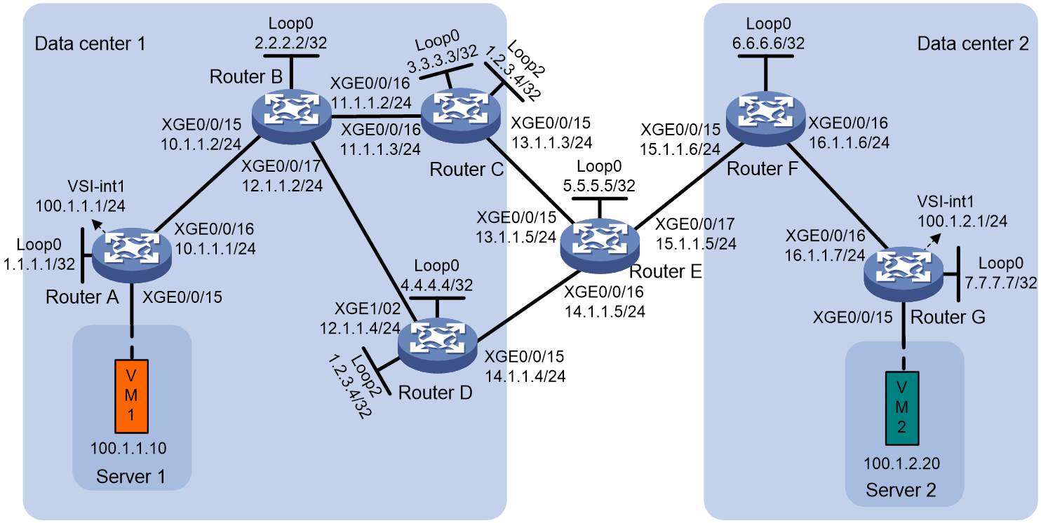

Example: Configuring EVPN-DCI dualhoming
As shown in Figure 7:
·     Configure Router A and Router G as distributed EVPN gateways to perform Layer 3 forwarding between VXLAN 10 and VXLAN 20.
·     Configure Router C and Router D as EDs of data center 1, and configure Router F as the ED of data center 2.
·     Configure Router B as an RR.
Figure 7 Network diagram
# On VM 1, specify 100.1.1.1 as the gateway address. On VM 2, specify 100.1.2.1 as the gateway address. (Details not shown.)
# Assign IP addresses to the interfaces, as shown in Figure 7. (Details not shown.)
# Configure OSPF for the routers to reach one another. (Details not shown.)
# Enable L2VPN.
[RouterA] vsi vpna
[RouterA] bgp 100
# Map Ten-GigabitEthernet 0/0/15 to VSI vpna.
[RouterA-Vsi-interface1] ip address 100.1.1.1 255.255.255.0
[RouterA] vsi vpna
3.     Configure Router B as an RR.
[RouterB] bgp 100
[RouterB-bgp-default] group evpn internal
[RouterB-bgp-default] peer evpn connect-interface loopback 0
[RouterB-bgp-default] peer 1.1.1.1 group evpn
[RouterB-bgp-default] peer 3.3.3.3 group evpn
[RouterB-bgp-default] peer 4.4.4.4 group evpn
[RouterB-bgp-default-evpn] undo policy vpn-target
[RouterB-bgp-default-evpn] peer evpn enable
[RouterB-bgp-default-evpn] peer evpn reflect-client
# Enable L2VPN.
# Enable DCI on the Layer 3 interface that connects Router C to Router E for automatic VXLAN-DCI tunnel establishment.
# Configure BGP to advertise BGP EVPN routes. Enable nexthop replacement for routes advertised to Router B, and enable router MAC replacement for routes advertised to and received from Router F.
[RouterC] bgp 100
[RouterC-bgp-default] peer 6.6.6.6 as-number 200
[RouterC-bgp-default] peer 6.6.6.6 connect-interface loopback 0
[RouterC-bgp-default] peer 6.6.6.6 ebgp-max-hop 64
[RouterC-bgp-default-evpn] peer 6.6.6.6 enable
[RouterC-bgp-default-evpn] peer 6.6.6.6 router-mac-local
[RouterC-bgp-default-evpn] peer 2.2.2.2 next-hop-local
[RouterC-vpn-instance-vpn1] route-distinguisher 1:2
[RouterC-Vsi-interface2] mac-address 1-2-3
# Configure 1.2.3.4 as the virtual ED address, and assign the IP address to Loopback 2. Configure OSPF to advertise the virtual ED address.
[RouterC] evpn edge group 1.2.3.4
[RouterC] interface loopback 2
[RouterC-LoopBack2] ip address 1.2.3.4 32
[RouterC-LoopBack2] quit
[RouterC] ospf
[RouterC-ospf-1] area 0
[RouterC-ospf-1-area-0.0.0.0] network 1.2.3.4 0.0.0.0
[RouterC-ospf-1-area-0.0.0.0] quit
[RouterC-ospf-1] quit
# Associate Ten-GigabitEthernet 0/0/15 with track entry 1.
[RouterC] track 1 interface Ten-GigabitEthernet0/0/15
[RouterC-track-1] quit
# Configure CLI-defined monitor policy 1 to associate Ten-GigabitEthernet 0/0/15 with Loopback 2.
[RouterC] rtm cli-policy policy1
[RouterC-rtm-policy1] event track 1 state negative
[RouterC-rtm-policy1] user-role network-admin
[RouterC-rtm-policy1] commit
[RouterC-rtm-policy1] quit
[RouterC-rtm-policy1] action 0 cli system-view
[RouterC-rtm-policy1] action 1 cli interface loopback 2
[RouterC-rtm-policy1] action 2 cli shutdown
# Enable L2VPN.
[RouterD] vxlan tunnel arp-learning disable
# Enable DCI on the Layer 3 interface that connects Router D to Router E for automatic VXLAN-DCI tunnel establishment.
[RouterD-Ten-GigabitEthernet0/0/15] dci enable
[RouterD] bgp 100
[RouterD-bgp-default] peer 6.6.6.6 as-number 200
[RouterD-bgp-default] peer 6.6.6.6 connect-interface loopback 0
[RouterD-bgp-default] peer 6.6.6.6 ebgp-max-hop 64
[RouterD-bgp-default] peer 2.2.2.2 as-number 100
[RouterD-bgp-default] peer 2.2.2.2 connect-interface loopback 0
[RouterD-bgp-default-evpn] peer 6.6.6.6 enable
[RouterD-bgp-default-evpn] peer 6.6.6.6 router-mac-local
[RouterD-bgp-default-evpn] peer 2.2.2.2 enable
[RouterD-bgp-default-evpn] peer 2.2.2.2 next-hop-local
[RouterD] ip vpn-instance vpn1
[RouterD-vpn-instance-vpn1] route-distinguisher 1:2
[RouterD-vpn-instance-vpn1] address-family ipv4
[RouterD-vpn-ipv4-vpn1] vpn-target 2:2
[RouterD-vpn-ipv4-vpn1] quit
[RouterD-vpn-instance-vpn1] address-family evpn
[RouterD-vpn-evpn-vpn1] vpn-target 1:1
[RouterD-vpn-evpn-vpn1] quit
[RouterD-vpn-instance-vpn1] quit
[RouterD] interface vsi-interface 2
[RouterD-Vsi-interface2] ip binding vpn-instance vpn1
[RouterD-Vsi-interface2] l3-vni 1000
[RouterD-Vsi-interface2] mac-address 1-2-3
[RouterD-Vsi-interface2] quit
[RouterD] evpn edge group 1.2.3.4
[RouterD] interface loopback 2
[RouterD-LoopBack2] ip address 1.2.3.4 32
[RouterD-LoopBack2] quit
[RouterD] ospf
[RouterD-ospf-1] area 0
[RouterD-ospf-1-area-0.0.0.0] network 1.2.3.4 0.0.0.0
[RouterD-ospf-1-area-0.0.0.0] quit
[RouterD-ospf-1] quit
[RouterD] track 1 interface Ten-GigabitEthernet0/0/15
[RouterD-track-1] quit
[RouterD] rtm cli-policy policy1
[RouterD-rtm-policy1] event track 1 state negative
[RouterD-rtm-policy1] user-role network-admin
[RouterD-rtm-policy1] commit
[RouterD-rtm-policy1] quit
[RouterD-rtm-policy1] action 0 cli system-view
[RouterD-rtm-policy1] action 1 cli interface loopback 2
[RouterD-rtm-policy1] action 2 cli shutdown
6.     Configure Router F:
# Enable L2VPN.
<RouterF> system-view
[RouterF] l2vpn enable
[RouterF] vxlan tunnel mac-learning disable
[RouterF] vxlan tunnel arp-learning disable
# Enable DCI on the Layer 3 interface that connects Router F to Router E for automatic VXLAN-DCI tunnel establishment.
[RouterF] interface ten-gigabitethernet 0/0/15
[RouterF-Ten-GigabitEthernet0/0/15] dci enable
[RouterF-Ten-GigabitEthernet0/0/15] quit
# Configure BGP to advertise BGP EVPN routes. Enable nexthop replacement for routes advertised to Router G, and enable router MAC replacement for routes advertised to and received from Router C and Router D.
[RouterF] bgp 200
[RouterF-bgp-default] peer 3.3.3.3 as-number 100
[RouterF-bgp-default] peer 3.3.3.3 connect-interface loopback 0
[RouterF-bgp-default] peer 3.3.3.3 ebgp-max-hop 64
[RouterF-bgp-default] peer 4.4.4.4 as-number 100
[RouterF-bgp-default] peer 4.4.4.4 connect-interface loopback 0
[RouterF-bgp-default] peer 4.4.4.4 ebgp-max-hop 64
[RouterF-bgp-default] peer 7.7.7.7 as-number 200
[RouterF-bgp-default] peer 7.7.7.7 connect-interface loopback 0
[RouterF-bgp-default] address-family l2vpn evpn
[RouterF-bgp-default-evpn] peer 3.3.3.3 enable
[RouterF-bgp-default-evpn] peer 3.3.3.3 router-mac-local
[RouterF-bgp-default-evpn] peer 4.4.4.4 enable
[RouterF-bgp-default-evpn] peer 4.4.4.4 router-mac-local
[RouterF-bgp-default-evpn] peer 7.7.7.7 enable
[RouterF-bgp-default-evpn] peer 7.7.7.7 next-hop-local
[RouterF-bgp-default-evpn] quit
[RouterF-bgp-default] quit
[RouterF] ip vpn-instance vpn1
[RouterF-vpn-instance-vpn1] route-distinguisher 1:4
[RouterF-vpn-instance-vpn1] address-family ipv4
[RouterF-vpn-ipv4-vpn1] vpn-target 2:2
[RouterF-vpn-ipv4-vpn1] quit
[RouterF-vpn-instance-vpn1] address-family evpn
[RouterF-vpn-evpn-vpn1] vpn-target 1:1
[RouterF-vpn-evpn-vpn1] quit
[RouterF-vpn-instance-vpn1] quit
[RouterF] interface vsi-interface 2
[RouterF-Vsi-interface2] ip binding vpn-instance vpn1
[RouterF-Vsi-interface2] l3-vni 1000
[RouterF-Vsi-interface2] quit
7.     Configure Router G:
# Enable L2VPN.
<RouterG> system-view
[RouterG] l2vpn enable
[RouterG] vxlan tunnel mac-learning disable
[RouterG] vxlan tunnel arp-learning disable
# Create VXLAN 20 on VSI vpnb.
[RouterG] vsi vpnb
[RouterG-vsi-vpnb] vxlan 20
[RouterG-vsi-vpnb-vxlan-20] quit
# Create an EVPN instance on VSI vpnb. Configure the router to automatically generate an RD and a route target for the EVPN instance.
[RouterG-vsi-vpnb] evpn encapsulation vxlan
[RouterG-vsi-vpnb-evpn-vxlan] route-distinguisher auto
[RouterG-vsi-vpnb-evpn-vxlan] vpn-target auto
[RouterG-vsi-vpnb-evpn-vxlan] quit
[RouterG-vsi-vpnb] quit
[RouterG] bgp 200
[RouterG-bgp-default] peer 6.6.6.6 as-number 200
[RouterG-bgp-default] peer 6.6.6.6 connect-interface loopback 0
[RouterG-bgp-default] address-family l2vpn evpn
[RouterG-bgp-default-evpn] peer 6.6.6.6 enable
[RouterG-bgp-default-evpn] quit
[RouterG-bgp-default] quit
# Map Ten-GigabitEthernet 0/0/15 to VSI vpnb.
[RouterG] interface ten-gigabitethernet 0/0/15
[RouterG-Ten-GigabitEthernet0/0/15] xconnect vsi vpnb
[RouterG-Ten-GigabitEthernet0/0/15] quit
[RouterG] ip vpn-instance vpn1
[RouterG-vpn-instance-vpn1] route-distinguisher 1:4
[RouterG-vpn-instance-vpn1] address-family ipv4
[RouterG-vpn-ipv4-vpn1] vpn-target 2:2
[RouterG-vpn-ipv4-vpn1] quit
[RouterG-vpn-instance-vpn1] address-family evpn
[RouterG-vpn-evpn-vpn1] vpn-target 1:1
[RouterG-vpn-evpn-vpn1] quit
[RouterG-vpn-instance-vpn1] quit
[RouterG] interface vsi-interface 1
[RouterG-Vsi-interface1] ip binding vpn-instance vpn1
[RouterG-Vsi-interface1] ip address 100.1.2.1 255.255.255.0
[RouterG-Vsi-interface1] mac-address 2-2-2
[RouterG-Vsi-interface1] distributed-gateway local
[RouterG-Vsi-interface1] quit
[RouterG] interface vsi-interface 2
[RouterG-Vsi-interface2] ip binding vpn-instance vpn1
[RouterG-Vsi-interface2] l3-vni 1000
[RouterG-Vsi-interface2] quit
# Specify VSI-interface 1 as the gateway interface for VSI vpnb.
[RouterG] vsi vpnb
[RouterG-vsi-vpnb] gateway vsi-interface 1
1.     Verify the configuration on EDs. (This example uses Router C.)
# Verify that the ED has discovered Router A and Router F through MAC/IP advertisement routes and IP prefix advertisement routes, and has established VXLAN and VXLAN-DCI tunnels to the routers.
[RouterC] display evpn auto-discovery macip-prefix
Destination IP  Source IP       L3VNI           Tunnel mode OutInterface
1.1.1.1         1.2.3.4         1000            VXLAN       Vsi-interface2
6.6.6.6         1.2.3.4         1000            VXLAN-DCI   Vsi-interface2
[RouterC] display interface tunnel
Tunnel0
Current state: UP
Bandwidth: 64 kbps
Tunnel source 1.2.3.4, destination 1.1.1.1
Tunnel1
Current state: UP
Bandwidth: 64 kbps
Tunnel source 1.2.3.4, destination 6.6.6.6
# Verify that the ED has ARP entries and routes for the VMs.
[RouterC] display arp vpn-instance vpn1
  Type: S  Type: S-Static   D-Dynamic   O-Openflow   R-Rule   M-Multiport  I-Invalid
IP address      MAC address    VLAN/VSI name Interface                Aging Type
1.1.1.1         0031-1900-0000 0             Tunnel0                  --    R
6.6.6.6         0031-3900-0000 0             Tunnel1                  --    R
[RouterC] display ip routing-table vpn-instance vpn1
Destinations : 4        Routes : 4
Destination/Mask   Proto   Pre Cost        NextHop         Interface
100.1.1.0/24       BGP     255 0           1.1.1.1         Vsi2
100.1.1.10/32      BGP     255 0           1.1.1.1         Vsi2
100.1.2.0/24       BGP     255 0           6.6.6.6         Vsi2
100.1.2.20/32      BGP     255 0           6.6.6.6         Vsi2
2.     Verify the configuration on Router A:
# Verify that the router has discovered the virtual ED through MAC/IP advertisement routes and IP prefix advertisement routes, and has established a VXLAN tunnel to the virtual ED.
[RouterA] display evpn auto-discovery macip-prefix
1.2.3.4         1.1.1.1         1000            VXLAN       Vsi-interface2
# Verify that the VXLAN tunnel on the router is up.
[RouterA] display interface tunnel
Tunnel0
Current state: UP
Bandwidth: 64 kbps
Tunnel source 1.1.1.1, destination 1.2.3.4
# Verify that the router has ARP entries and routes for the VMs.
[RouterA] display arp vpn-instance vpn1
1.2.3.4         0031-1900-0001 0             Tunnel0                  --    R
[RouterA] display ip routing-table vpn-instance vpn1
Destinations : 2        Routes : 2
100.1.2.0/24       BGP     255 0           1.2.3.4         Vsi2
100.1.2.10/32      BGP     255 0           1.2.3.4         Vsi2
3.     Verify that VM 1 and VM 2 can communicate when both Router C and Router D are working correctly and when Router C or Router D fails. (Details not shown.)
