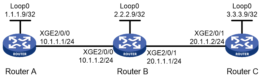

Example: Configuring BFD for LSP
Use LDP to establish an LSP from 1.1.1.9/32 to 3.3.3.9/32 and an LSP from 3.3.3.9/32 to 1.1.1.9/32. Use BFD to verify LSP connectivity.
Figure 1 Network diagram
1.     Configure IP addresses for interfaces. (Details not shown.)
2.     Configure OSPF to ensure IP connectivity between the routers:
# Configure Router A.
<RouterA> system-view
[RouterA] ospf
[RouterA-ospf-1] area 0
[RouterA-ospf-1-area-0.0.0.0] network 1.1.1.9 0.0.0.0
[RouterA-ospf-1-area-0.0.0.0] network 10.1.1.0 0.0.0.255
[RouterA-ospf-1-area-0.0.0.0] quit
[RouterA-ospf-1] quit
# Configure Router B.
<RouterB> system-view
[RouterB] ospf
[RouterB-ospf-1] area 0
[RouterB-ospf-1-area-0.0.0.0] network 2.2.2.9 0.0.0.0
[RouterB-ospf-1-area-0.0.0.0] network 10.1.1.0 0.0.0.255
[RouterB-ospf-1-area-0.0.0.0] network 20.1.1.0 0.0.0.255
[RouterB-ospf-1-area-0.0.0.0] quit
[RouterB-ospf-1] quit
# Configure Router C.
<RouterC> system-view
[RouterC] ospf
[RouterC-ospf-1] area 0
[RouterC-ospf-1-area-0.0.0.0] network 3.3.3.9 0.0.0.0
[RouterC-ospf-1-area-0.0.0.0] network 20.1.1.0 0.0.0.255
[RouterC-ospf-1-area-0.0.0.0] quit
[RouterC-ospf-1] quit
3.     Enable MPLS and LDP:
[RouterA] mpls lsr-id 1.1.1.9
[RouterA] mpls ldp
[RouterA-ldp] quit
[RouterA] interface ten-gigabitethernet 2/0/0
[RouterA-Ten-GigabitEthernet2/0/0] mpls enable
[RouterA-Ten-GigabitEthernet2/0/0] mpls ldp enable
[RouterA-Ten-GigabitEthernet2/0/0] quit
[RouterB] mpls lsr-id 2.2.2.9
[RouterB] mpls ldp
[RouterB-ldp] quit
[RouterB] interface ten-gigabitethernet 2/0/0
[RouterB-Ten-GigabitEthernet2/0/0] mpls enable
[RouterB-Ten-GigabitEthernet2/0/0] mpls ldp enable
[RouterB-Ten-GigabitEthernet2/0/0] quit
[RouterB] interface ten-gigabitethernet 2/0/1
[RouterB-Ten-GigabitEthernet2/0/1] mpls enable
[RouterB-Ten-GigabitEthernet2/0/1] mpls ldp enable
[RouterB-Ten-GigabitEthernet2/0/1] quit
[RouterC] mpls lsr-id 3.3.3.9
[RouterC] mpls ldp
[RouterC-ldp] quit
[RouterC] interface ten-gigabitethernet 2/0/1
[RouterC-Ten-GigabitEthernet2/0/1] mpls enable
[RouterC-Ten-GigabitEthernet2/0/1] mpls ldp enable
[RouterC-Ten-GigabitEthernet2/0/1] quit
4.     Enable BFD for MPLS, and configure BFD to verify LSP connectivity:
[RouterA] mpls bfd enable
[RouterA] mpls bfd 3.3.3.9 32
[RouterC] mpls bfd enable
[RouterC] mpls bfd 1.1.1.9 32
# Display BFD information for LSPs on Router A and Router C, for example, on Router A.
[RouterA] display mpls bfd
 Total number of sessions: 2, 2 up, 0 down, 0 init
 FEC Type: LSP
 FEC Info:
   Destination: 1.1.1.9
   Mask Length: 32
 NHLFE ID: -
 Local Discr: 513                    Remote Discr: 513
 Source IP: 1.1.1.9                  Destination IP: 3.3.3.9
 Session State: Up                   Session Role: Active
 Template Name: -
 FEC Type: LSP
 FEC Info:
   Destination: 3.3.3.9
   Mask Length: 32
 NHLFE ID: 1042
 Local Discr: 514                    Remote Discr: 514
 Source IP: 1.1.1.9                  Destination IP: 127.0.0.1
 Session State: Up                   Session Role: Passive
 Template Name: -
The output shows that two BFD sessions have been established between Router A and Router C. One session verifies the connectivity of the LSP from 3.3.3.9/32 to 1.1.1.9/32, and the other session verifies the connectivity of the LSP from 1.1.1.9/32 to 3.3.3.9/32.
