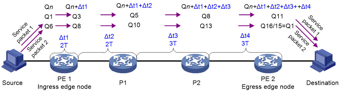

Bounded jitter
Due to the instability of IP networks, the latency of packets in the same service flow varies, resulting in the latency jitter. Bounded jitter means controlling the latency jitter within an acceptable range. For example, if the latency jitter can be controlled in the range of 0 to Δt , the latency is within the range of [T-Δt/2, T+Δt/2].
Figure 2 Bounded jitter

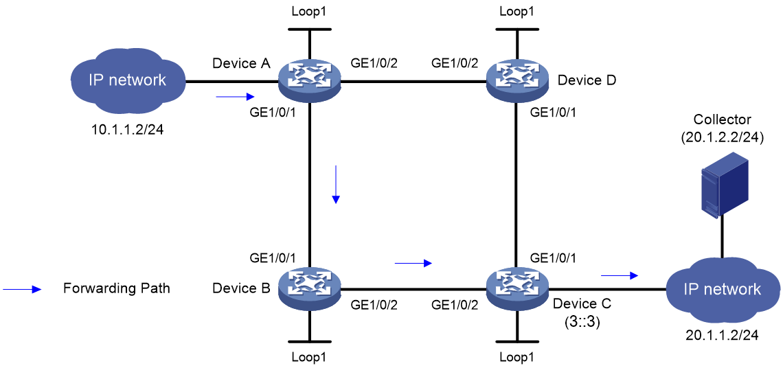

Deterministic IP networking
Deterministic IP networking is a Layer-3 networking architecture that adopts deterministic IP technology and can implement bounded latency and bounded jitter.

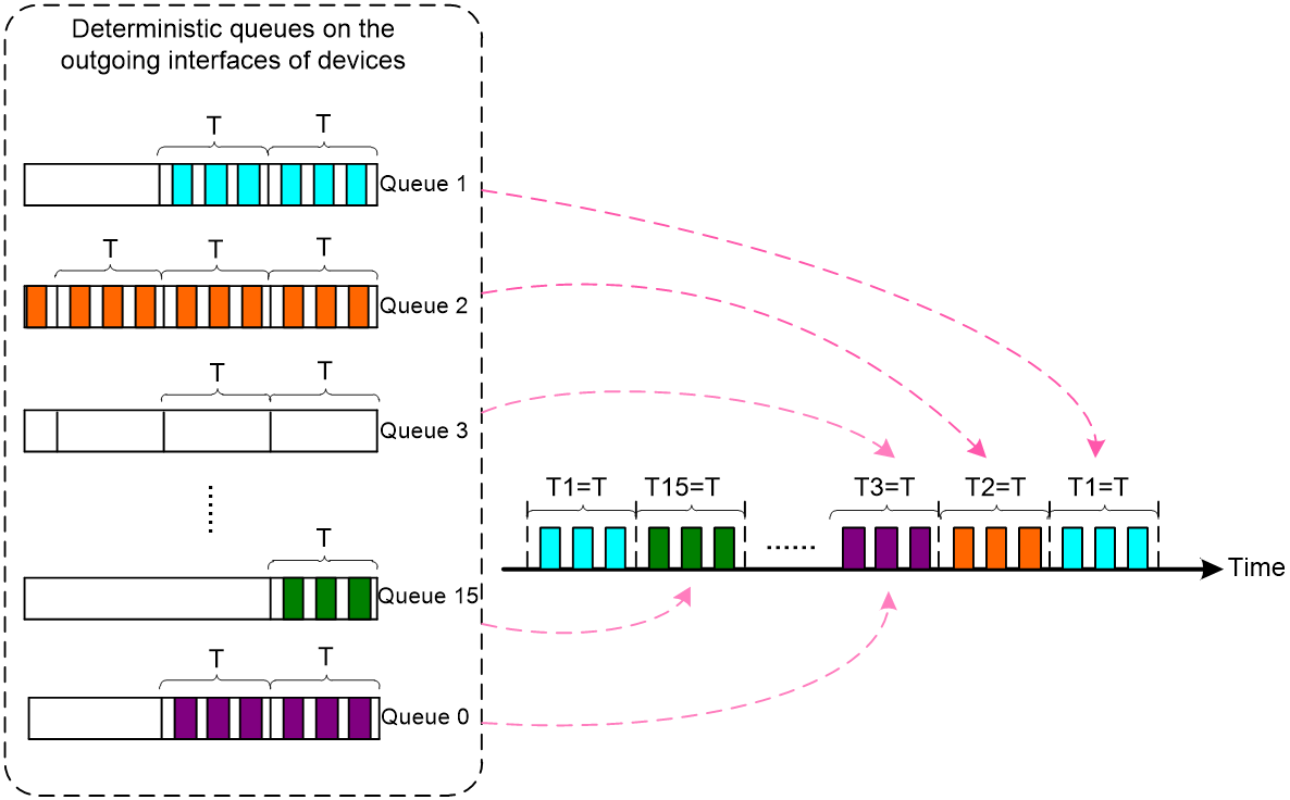

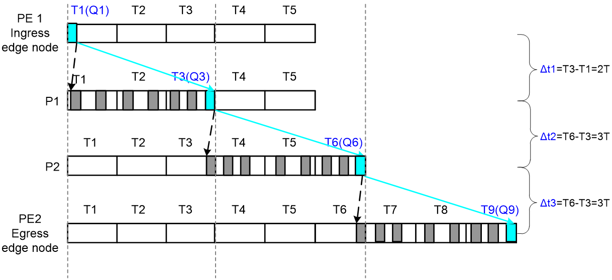

Deterministic queuing
Deterministic queuing is a forwarding mechanism designed to achieve bounded latency and bounded jitter.
The device divides a memory slice on the forwarding chip into 16 queues.
·     Queues 1 to 15 are used to forward packets with deterministic transmission requirements.
·     Queue 0 is used to forward packets that do not require deterministic transmission.
Each queue take turns to forward packets within its corresponding timeslot (also known as a forwarding cycle). The length of a timeslot is defined in the factory settings. In the current software version, a timeslot is 10 us. If all packets in a queue have been sent before the corresponding timeslot expires, the remaining time in the timeslot will be used to send non-deterministic packets in queue 0. When a timeslot expires, deterministic packets in the next queue will be sent.
As shown in Figure 3, queue 1 corresponds to timeslot T1, queue 2 corresponds to timeslot T2, and so on, with queue 15 corresponding to timeslot T15. Queue 0 is used to send non-deterministic packets. The forwarding chip sends packets in queue 1 to queue 15 in order, with each queue sending packets for a duration of T. As no deterministic packets are sent in queue 3, the device uses the timeslot of queue 3 to send packets from queue 0. After queue 15 sends its packets, queue 1 sends its packets.
Figure 3 Deterministic queues

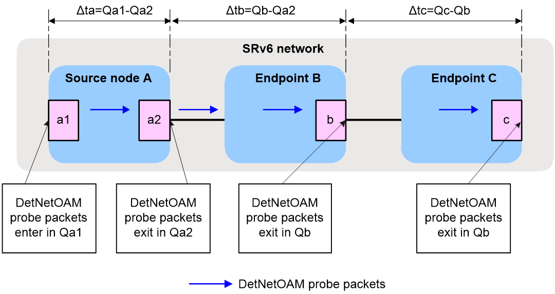

Timeslot deviation
The core function of DetNetOAM is to measure timeslot deviation. Each transit node maps the timeslot deviation to the queues on its output interface to guide packet forwarding.
As shown in Figure 4:
·     For an SRv6 source node, DetNetOAM timeslot deviation = incoming queue number for DetNetOAM probe packets to enter the device - outgoing queue number for DetNetOAM probe packets to exit the device.
·     For an SRv6 endpoint, DetNetOAM timeslot deviation = outgoing queue number for DetNetOAM probe packets to exit the device - outgoing queue number for DetNetOAM probe packets to exit the upstream device.
Figure 4 DetNetOAM timeslot deviation
Deterministic IP networking structure

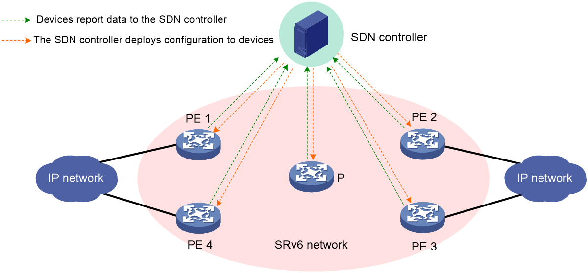

The deterministic IP networking structure mainly includes DetNet devices and the SDN controller, as shown in Figure 5.
·     DetNet devices are devices that support DetNet. They will report topology information, bandwidth, latency measurement results, and DetNetOAM probe results to the SDN controller.
·     The SDN controller is the control center of the entire deterministic IP network. The controller mainly has the following functions:
¡     Collect network topology and latency information and select paths that meet end-to-end latency requirements for applications.
¡     Collect DetNetOAM probe results and generate a timeslot deviation list in the order based on the position of each device on the SRv6 path.
¡     Summarize the collected results and send them to the source node for route selection and packet encapsulation, thus achieving deterministic forwarding.
Figure 5 Deterministic IP networking structure

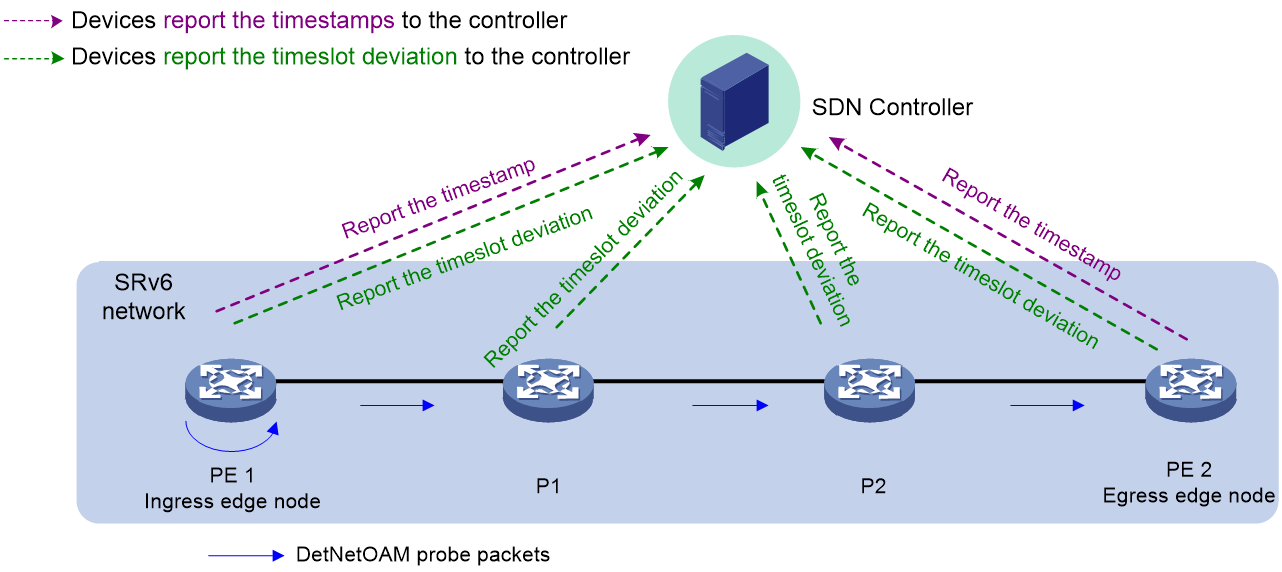

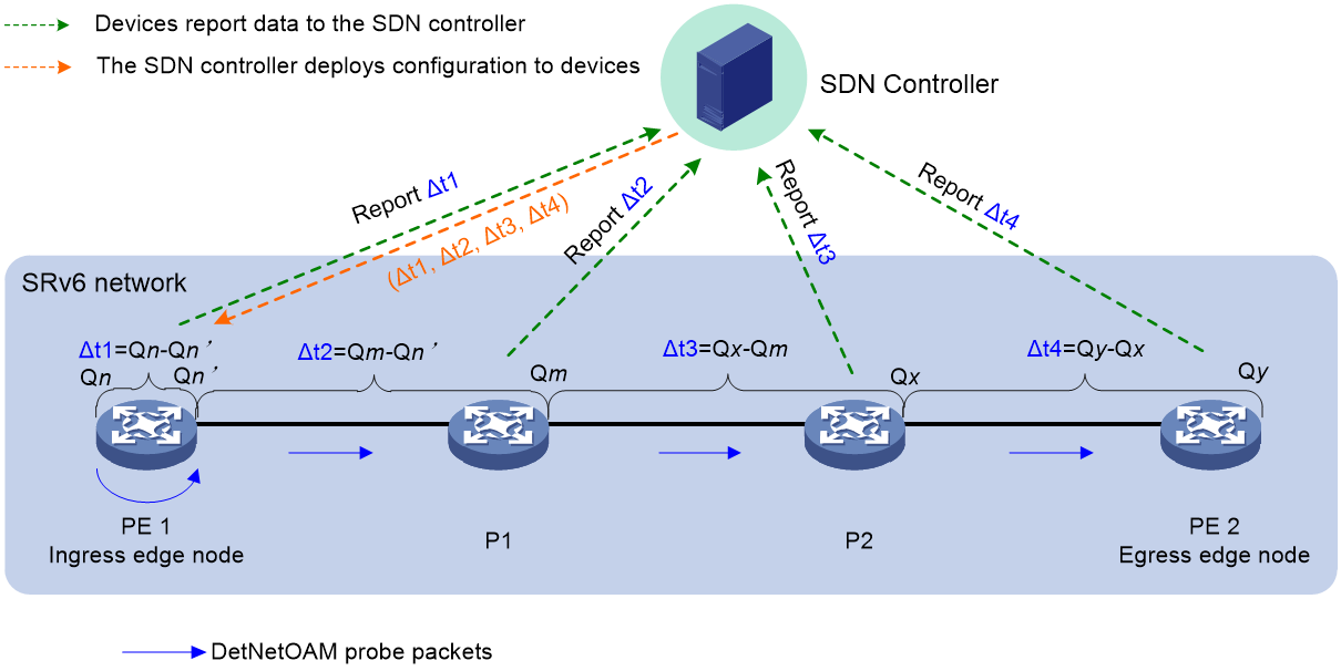

The ingress edge node of an SRv6 path simulates the service flow and constructs DetNetOAM probe packets at the probe interval. The probe interval can be configured by using the period command. Within each interval, DetNetOAM probing is performed for 10 times, and the probe packets are forwarded along the Segment List. Each node on the Segment List calculates the timeslot deviation (Δt1, Δt2, Δt3, and Δt4 in the following figure) between itself and the upstream node, and sends the maximum, minimum, and average values of the timeslot deviation to the controller. The controller takes the maximum value of the timeslot deviation in the probe interval and generates a timeslot deviation list (Δt1, Δt2, Δt3, Δt4) for all nodes on the SRv6 path, and sends the timeslot deviation list to the ingress edge node. The ingress edge node encapsulates the timeslot deviation list in the SRv6 packet header to guide packet forwarding.
DetNetOAM mechanism
Deterministic networking uses the maximum timeslot deviation to guide forwarding and ultimately achieve deterministic latency jitter. DetNetOAM is used to measure the maximum timeslot deviation between adjacent nodes on a forwarding path.
The process of DetNetOAM probing is as follows:
1.     The ingress edge node of an SRv6 path simulates the service flow and constructs DetNetOAM probe packets at the configured probe interval. Within each interval, DetNetOAM probing is performed for 10 times, and the probe packets are forwarded along the Segment List.
2.     The ingress edge node calculates the timeslot deviation (Δt1 in the following figure) between the incoming interface queue and the outgoing interface queue for probe packets. Each transit node on the Segment List calculates the timeslot deviation (Δt2, Δt3, and Δt4 in the following figure) between itself and the upstream node, and sends the maximum, minimum, and average values of the timeslot deviation to the controller.
3.     The controller takes the maximum value of the timeslot deviation in the probe interval and generates a timeslot deviation list (Δt1, Δt2, Δt3, Δt4) for all nodes on the SRv6 path, and sends the timeslot deviation list to the ingress edge node.
4.     The ingress edge node encapsulates the timeslot deviation list in the SRv6 packet header to guide packet forwarding.
Figure 7 DetNetOAM mechanism
DetNetOAM probing process
As shown in Figure 7, DetNetOAM probing is performed as follows:
1.     On the ingress edge node PE1:
a.     The ingress edge node generates DetNetOAM probe packets based on the characteristics of the service flow to simulate the service flow.
b.     DetNetOAM probe packets enter the device through the specified incoming interface (which can be configured through the CLI) in a random queue assumed to be Qn.
c.     The ingress edge node forwards DetNetOAM probe packets along the specified SRv6 path (which can be configured through the CLI). The probe packets exit in a random queue assumed to be Qn’.
d.     The ingress edge node calculates the timeslot deviation Δt1 calculated as Qn’ minus Qn.
e.     The ingress edge node encapsulates the outgoing interface queue number Qn’ into DetNetOAM probe packets and sends them to the next node P1.
2.     On P1:
a.     P1 matches DetNetOAM probe packets based on the configured flow characteristics.
b.     P1 decapsulates the DetNetOAM probe packets and obtains the outgoing interface queue Qn’ of the upstream node. Then, it forwards the DetNetOAM probe packets following the SRv6 forwarding process in a random queue assumed to be Qm.
c.     P1 calculate the timeslot deviation Δt2 = Qm-Qn’.
d.     P1 encapsulates its outgoing interface queue number Qm into the DetNetOAM probe packets and sends them to the next node P2.
3.     P2 and PE2 process DetNetOAM probe packets in the same way as P1 does.
As the egress edge node, PE2 reports the DetNetOAM probe results to the controller, and then discards the DetNetOAM probe packets.
4.     To simulate service packets and provide accurate probe results, the ingress edge node performs DetNetOAM probing at the specified probe interval. The ingress edge node generates 10 DetNetOAM probe packets and performs DetNetOAM probing for 10 times within each probe interval.
All nodes forward each DetNetOAM probe packet in the same way as a service packet is forwarded and obtains the timeslot deviation. Based on the probe results of 10 probe packets, each node calculates the minimum, maximum, and average values of the timeslot deviation for the node within a probe interval, and reports the timeslot deviation values, interval ID, and node index on the SRv6 path to the controller with Telemetry packets.
The controller generates a timeslot deviation list for nodes in the order specified in the Segment List based on the received probe results, and send the timeslot deviation list to the ingress edge node. The ingress edge node uses the timeslot offset list issued by the controller to calculate the outgoing queue for service packets on each node and guide packet forwarding.

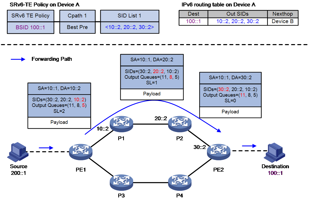

As shown in Figure 9, DetNetOAM probing obtains a maximum timeslot deviation of 2T on the ingress edge node and from PE1 to P1, and a maximum timeslot deviation of 3T from P1 to P2 and from P2 to PE2. The controller issues a timeslot deviation list (2T, 2T, 3T, 3T) to the ingress edge node. Service packets of the deterministic network are forwarded as follows:
1.     The administrator completes the configuration of SRv6, SRv6 TE policy, DetNet, and DetNetOAM.
2.     The SRv6 TE policy selects an optimal path and use it as the forwarding path for the service packets.
3.     The ingress edge node receives a service packet and looks up the routing table based on the destination address to perform SRv6 forwarding using the optimal path.
4.     If service packet 1 enters the SRv6 network in queue Q1 of the ingress edge node PE1.
a.     According to the timeslot deviation list (2T, 2T, 3T, 3T), PE1 calculates queues Q3, Q5, Q8, and Q11 for the packet to exit PE1, P1, P2, and PE2, respectively.
b.     PE1 generates the outgoing queue list corresponding to the Segment List (11, 8, 5) and encapsulates the outgoing queue list in the SRv6 packet header of the service packet, as shown in Figure 9.
c.     PE1 puts the service packet in queue Q3 for sending it to P1.
5.     P1 obtains the queue number for the service packet to exit P1 from the SRv6 packet header and puts the packet in queue Q5 for sending it to P2, as shown in Figure 9.
6.     P2 obtains the queue number for the service packet to exit P2 from the SRv6 packet header and puts the packet in queue Q8 for sending it to PE2, as shown in Figure 9.
7.     PE2 obtains the queue number for the service packet to exit PE2 from the SRv6 packet header and puts the packet in queue Q11 for sending it to the destination end, as shown in Figure 9.
If service packet 2 enters the SRv6 network in queue Q6 of the ingress edge node PE1, according to the timeslot deviation list (2T, 2T, 3T, 3T), the queues for the packet to exit PE1, P1, P2, and PE2 are Q8, Q10, Q13, and Q1, respectively. A total of 15 deterministic queues exist, thus the queue 3 timeslots after Q13 is Q1.
Figure 9 Srv6 packet encapsulation and forwarding in the DetNet network
