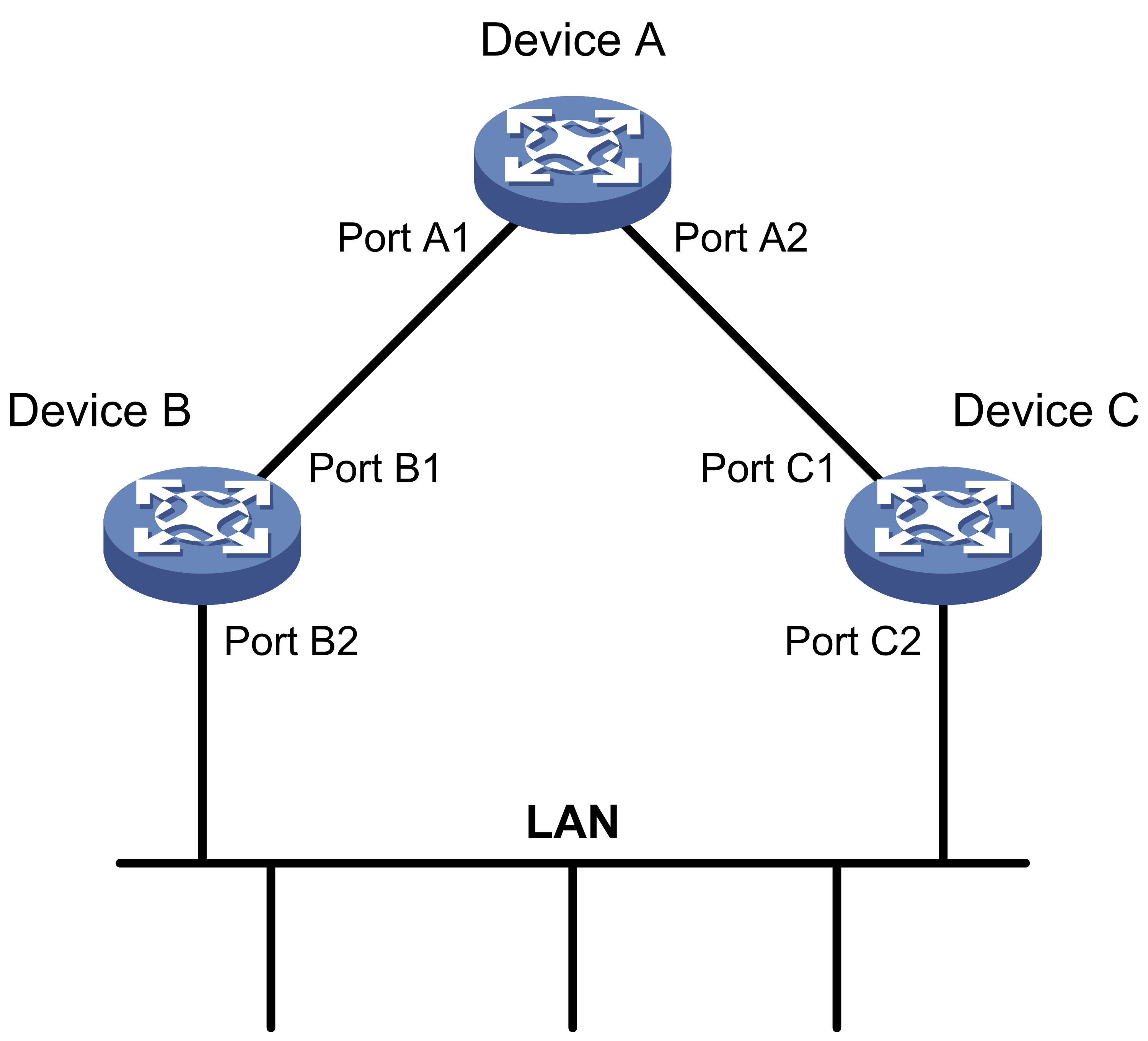

As shown in Figure 3, Device B and Device C are directly connected to a LAN.
If Device A forwards BPDUs to Device B through port A1, the designated bridge and designated port are as follows:
·     The designated bridge for Device B is Device A.
·     The designated port for Device B is port A1 on Device A.
If Device B forwards BPDUs to the LAN, the designated bridge and designated port are as follows:
·     The designated bridge for the LAN is Device B.
·     The designated port for the LAN is port B2 on Device B.
Figure 3 Designated bridges and designated ports

Figure 4 provides an example showing how the STP algorithm works.
Figure 4 The STP algorithm
As shown in Figure 4, the priority values of Device A, Device B, and Device C are 0, 1, and 2, respectively. The path costs of links among the three devices are 5, 10, and 4.

Configuration BPDUs comparison on each device
In Table 4, each configuration BPDU contains the following fields: root bridge ID, root path cost, designated bridge ID, and designated port ID.
Table 4 Comparison process and result on each device
Device
Comparison process
Configuration BPDU on ports after comparison
Device A
Port A1 performs the following operations:
1.     Receives the configuration BPDU of Port B1 {1, 0, 1, Port B1}.
2.     Determines that its existing configuration BPDU {0, 0, 0, Port A1} is superior to the received configuration BPDU.
3.     Discards the received one.
Port A2 performs the following operations:
1.     Receives the configuration BPDU of Port C1 {2, 0, 2, Port C1}.
2.     Determines that its existing configuration BPDU {0, 0, 0, Port A2} is superior to the received configuration BPDU.
Device A determines that it is both the root bridge and designated bridge in the configuration BPDUs of all its ports. It considers itself as the root bridge. It does not change the configuration BPDU of any port and starts to periodically send configuration BPDUs.
·     Port A1: {0, 0, 0, Port A1}
·     Port A2: {0, 0, 0, Port A2}
Device B
Port B1 performs the following operations:
4.     Receives the configuration BPDU of Port A1 {0, 0, 0, Port A1}.
5.     Determines that the received configuration BPDU is superior to its existing configuration BPDU {1, 0, 1, Port B1}.
6.     Updates its configuration BPDU.
Port B2 performs the following operations:
1.     Receives the configuration BPDU of Port C2 {2, 0, 2, Port C2}.
2.     Determines that its existing configuration BPDU {1, 0, 1, Port B2} is superior to the received configuration BPDU.
3.     Discards the received BPDU.
·     Port B1: {0, 0, 0, Port A1}
·     Port B2: {1, 0, 1, Port B2}
Device B performs the following operations:
1.     Compares the configuration BPDUs of all its ports.
2.     Decides that the configuration BPDU of Port B1 is the optimum.
3.     Selects Port B1 as the root port with the configuration BPDU unchanged.
Based on the configuration BPDU and path cost of the root port, Device B calculates a designated port configuration BPDU for Port B2 {0, 5, 1, Port B2}. Device B compares it with the existing configuration BPDU of Port B2 {1, 0, 1, Port B2}. Device B determines that the calculated one is superior, and determines that Port B2 is the designated port. It replaces the configuration BPDU on Port B2 with the calculated one, and periodically sends the calculated configuration BPDU.
·     Root port (Port B1): {0, 0, 0, Port A1}
·     Designated port (Port B2): {0, 5, 1, Port B2}
Device C
Port C1 performs the following operations:
1.     Receives the configuration BPDU of Port A2 {0, 0, 0, Port A2}.
2.     Determines that the received configuration BPDU is superior to its existing configuration BPDU {2, 0, 2, Port C1}.
3.     Updates its configuration BPDU.
Port C2 performs the following operations:
1.     Receives the original configuration BPDU of Port B2 {1, 0, 1, Port B2}.
2.     Determines that the received configuration BPDU is superior to the existing configuration BPDU {2, 0, 2, Port C2}.
·     Port C1: {0, 0, 0, Port A2}
·     Port C2: {1, 0, 1, Port B2}
Device C performs the following operations:
2.     Decides that the configuration BPDU of Port C1 is the optimum.
3.     Selects Port C1 as the root port with the configuration BPDU unchanged.
Based on the configuration BPDU and path cost of the root port, Device C calculates the configuration BPDU of Port C2 {0, 10, 2, Port C2}. Device C compares it with the existing configuration BPDU of Port C2 {1, 0, 1, Port B2}. Device C determines that the calculated configuration BPDU is superior to the existing one, selects Port C2 as the designated port, and replaces the configuration BPDU of Port C2 with the calculated one.
·     Root port (Port C1): {0, 0, 0, Port A2}
·     Designated port (Port C2): {0, 10, 2, Port C2}
1.     Receives the updated configuration BPDU of Port B2 {0, 5, 1, Port B2}.
2.     Determines that the received configuration BPDU is superior to its existing configuration BPDU {0, 10, 2, Port C2}.
1.     Receives a periodic configuration BPDU {0, 0, 0, Port A2} from Port A2.
2.     Determines that it is the same as the existing configuration BPDU.
·     Port C2: {0, 5, 1, Port B2}
Device C determines that the root path cost of Port C1 is larger than that of Port C2. The root path cost of Port C1 is 10, root path cost of the received configuration BPDU (0) plus path cost of Port C1 (10). The root path cost of Port C2 is 9, root path cost of the received configuration BPDU (5) plus path cost of Port C2 (4). Device C determines that the configuration BPDU of Port C2 is the optimum, and selects Port C2 as the root port with the configuration BPDU unchanged.
Based on the configuration BPDU and path cost of the root port, Device C performs the following operations:
1.     Calculates a designated port configuration BPDU for Port C1 {0, 9, 2, Port C1}.
2.     Compares it with the existing configuration BPDU of Port C1 {0, 0, 0, Port A2}.
3.     Determines that the existing configuration BPDU is superior to the calculated one and blocks Port C1 with the configuration BPDU unchanged.
Port C1 does not forward data until a new event triggers a spanning tree calculation process: for example, the link between Device B and Device C is down.
·     Blocked port (Port C1): {0, 0, 0, Port A2}
·     Root port (Port C2): {0, 5, 1, Port B2}
Final calculated spanning tree
After the comparison processes described in Table 4, a spanning tree with Device A as the root bridge is established, as shown in Figure 5.
Figure 5 The final calculated spanning tree

As shown in Figure 12, Port C3 is an edge port connected to a host. When a network topology change occurs, the port can immediately transit from the blocking state to the forwarding state because no loop will be caused.
Because a device cannot determine whether a port is directly connected to a terminal, you must manually configure the port as an edge port.
Figure 12 Edge port rapid transition
Root port rapid transition
When a root port is blocked, the bridge will elect the alternate port with the highest priority as the new root port. If the new root port's peer is in the forwarding state, the new root port immediately transits to the forwarding state.
As shown in Figure 13, Port C2 on Device C is a root port and Port C1 is an alternate port. When Port C2 transits to the blocking state, Port C1 is elected as the root port and immediately transits to the forwarding state.
Figure 13 Root port rapid transition

In RSTP and MSTP, the following types of messages are used for rapid state transition on designated ports:
·     Proposal—Sent by designated ports to request rapid transition
·     Agreement—Used to acknowledge rapid transition requests
Both RSTP and MSTP devices can perform rapid transition on a designated port only when the port receives an agreement packet from the downstream device. RSTP and MSTP devices have the following differences:
·     For MSTP, the root port of the downstream device sends an agreement packet only after it receives an agreement packet from the upstream device.
·     For RSTP, the downstream device sends an agreement packet whether or not an agreement packet from the upstream device is received.
Figure 16 Rapid state transition of an MSTP designated port
Figure 17 Rapid state transition of an RSTP designated port
If the upstream device is a third-party device, the rapid state transition implementation might be limited as follows:
·     The upstream device uses a rapid transition mechanism similar to that of RSTP.
·     The downstream device runs MSTP and does not operate in RSTP mode.

About dispute guard
Dispute guard is enabled by default. You do not need to manually configure this feature.
Dispute guard can be triggered by unidirectional link failures. If an upstream port receives inferior BPDUs from a downstream designated port in forwarding or learning state because of a unidirectional link failure, a loop appears. Dispute guard blocks the upstream designated port to prevent the loop.
As shown in Figure 19, in normal conditions, the spanning tree calculation result is as follows:
·     Device A is the root bridge, and Port A1 is a designated port.
·     Port B1 is blocked.
When the link between Port A1 and Port B1 fails in the direction of Port A1 to Port B1 and becomes unidirectional, the following events occur:
1.     Port A1 can only receive BPDUs and cannot send BPDUs to Port B1.
2.     Port B1 does not receive BPDUs from Port A1 for a certain period of time.
3.     Device B determines itself as the root bridge.
4.     Port B1 sends its BPDUs to Port A1.
5.     Port A1 determines the received BPDUs are inferior to its own BPDUs. A dispute is detected.
6.     Dispute guard is triggered and blocks Port A1 to prevent a loop.
Figure 19 Dispute guard triggering scenario
