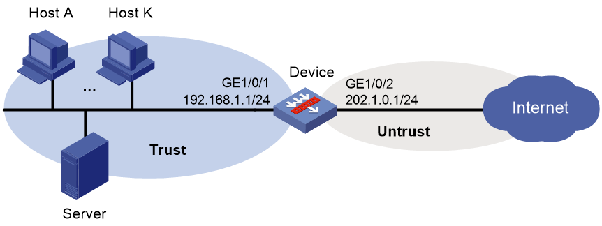

As shown in Figure 2, several hosts and servers are deployed in a company's internal network, and Device is deployed at the network egress as a security gateway to protect the internal network.
Configure the device to scan and audit the internal network assets of the company at 14:00 every Friday to regularly detect the possible security risks on the network assets.
Figure 2 Network diagram
