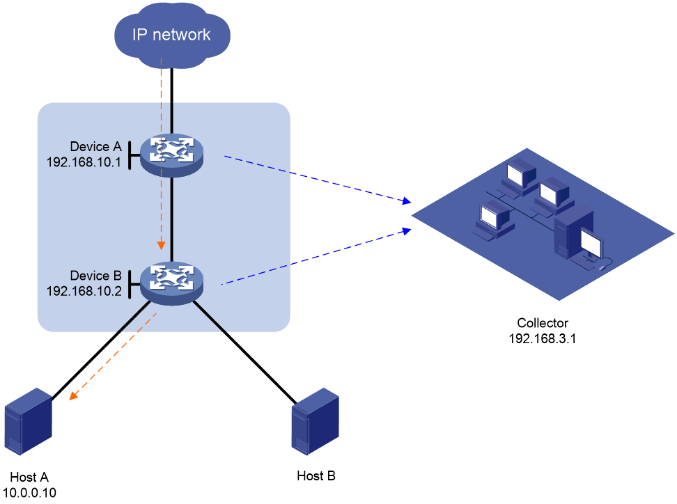

Example: Configuring MOD to send packets through UDP
As shown in Figure 1, Host A and Host B access the external network through Device A and Device B. Some packets from the external network are missing on Host A. Configure MOD on the access device and aggregation device to identify whether packets are dropped during the forwarding process on the two devices.
Figure 1 Network diagram
Configure IP addresses for devices, and make sure they can reach each other at Layer 3.
Procedures

Example: Configuring MOD to send packets through gRPC
As shown in Figure 2, Host A and Host B access the external network through Device A and Device B. Some packets from the external network are missing on Host A. Configure MOD on the access device and aggregation device to identify whether packets are dropped during the forwarding process on the two devices.
Figure 2 Network diagram
Procedures
