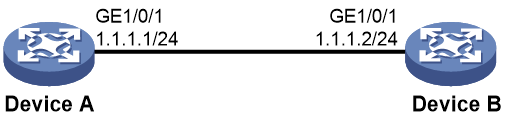

As show in Figure 3, you can Telnet to Device B from Device A. Configure TCP connection trace on Device A to trace the TCP connection between Device A and Device B. When the connection is abnormally closed, you can use the trace information to locate disconnection reasons. Enable persistence for TCP connection trace configuration so that the configuration can survive Device A reboot.
Figure 3 Network diagram
·     Configure Device B as a Telnet server. For more information, see login management configuration in Fundamentals Configuration Guide.
·     Assign an IP address to each interface as shown in Figure 3. (Details not shown.)

Example: Tracing IPv6 TCP connections
As show in Figure 4, you can Telnet to Device B from Device A. Configure TCP connection trace on Device A to trace the IPv6 TCP connection between Device A and Device B. When the connection is abnormally closed, you can use the trace information to locate disconnection reasons. Enable persistence for TCP connection trace configuration so that the configuration can survive Device A reboot.
Figure 4 Network diagram
·     Assign an IPv6 address to each interface as shown in Figure 4. (Details not shown.)
# Allow the TCP connection trace feature to trace a maximum of 600 data packets per TCP connection.

1.     Telnet to Device B from Device A.
<DeviceA> telnet ipv6 1::2
2.     Display TCP connection information when you can correctly log in to Device B from Device A through Telnet.
# Display information about all disconnected IPv6 TCP connections that have been recorded.
<DeviceA> display tcp trace cache-connection ipv6 slot 1

3.     Shut down GigabitEthernet 1/0/1 on Device B.
<DeviceB> system-view
[DeviceB-GigabitEthernet1/0/1] shutdown
After you shut down GigabitEthernet 1/0/1, the Telnet connection is terminated. Display TCP connection information on Device A after a period of time.

The output shows that:
¡     The TCP connection between Device A and Device B has been closed.
¡     The disconnection reason is retransmission timeout. The client determines retransmission timeout because it does not receive any ACK packet from the server.
To resolve the issue, verify that the TCP server operates correctly and the link between the TCP client and server is connected.
