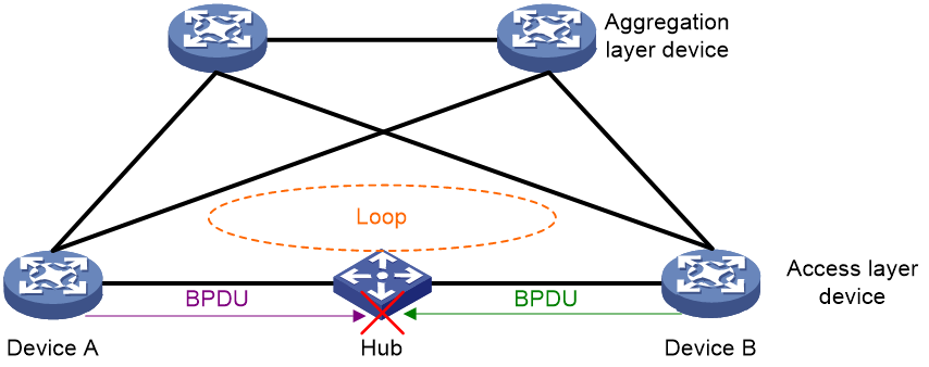

Spanning tree protocol overview
Spanning tree protocols eliminate loops in a physical link-redundant network by selectively blocking redundant links and putting them in a standby state.

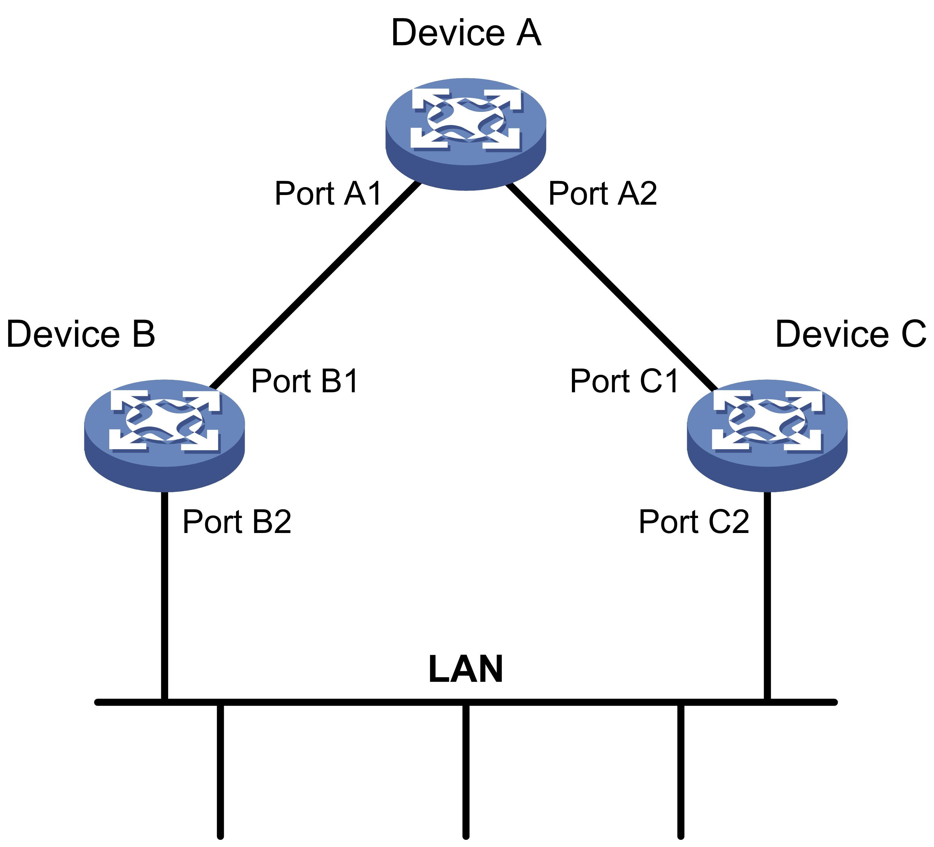

As shown in Figure 3, Device B and Device C are directly connected to a LAN.
If Device A forwards BPDUs to Device B through port A1, the designated bridge and designated port are as follows:
·     The designated bridge for Device B is Device A.
·     The designated port for Device B is port A1 on Device A.
If Device B forwards BPDUs to the LAN, the designated bridge and designated port are as follows:
·     The designated bridge for the LAN is Device B.
·     The designated port for the LAN is port B2 on Device B.

Figure 4 provides an example showing how the STP algorithm works.
Figure 4 The STP algorithm
As shown in Figure 4, the priority values of Device A, Device B, and Device C are 0, 1, and 2, respectively. The path costs of links among the three devices are 5, 10, and 4.

Final calculated spanning tree
After the comparison processes described in Table 4, a spanning tree with Device A as the root bridge is established, as shown in Figure 5.
Figure 5 The final calculated spanning tree

As shown in Figure 6, Device A is the root bridge. The priority of Device B is higher than the priority of Device C. Port C2 on Device C is blocked.
When the link between Device A and Device B fails, the following events occur:
1.     Device B sends an RSTP BPDU with itself as the root bridge to Device C.
2.     Device C compares the RSTP BPDU with its own BPDU.
3.     Because the RSTP BPDU from Device B has a lower priority, Device C sends its own BPDU to Device B.
4.     Device B considers that Port B2 is the root port and stops sending RSTP BPDUs to Device C.
Figure 6 BPDU processing in RSTP

In RSTP and MSTP, the following types of messages are used for rapid state transition on designated ports:
·     Proposal—Sent by designated ports to request rapid transition
·     Agreement—Used to acknowledge rapid transition requests
Both RSTP and MSTP devices can perform rapid transition on a designated port only when the port receives an agreement packet from the downstream device. RSTP and MSTP devices have the following differences:
·     For MSTP, the root port of the downstream device sends an agreement packet only after it receives an agreement packet from the upstream device.
·     For RSTP, the downstream device sends an agreement packet whether or not an agreement packet from the upstream device is received.
Figure 16 Rapid state transition of an MSTP designated port
Figure 17 Rapid state transition of an RSTP designated port
If the upstream device is a third-party device, the rapid state transition implementation might be limited as follows:
·     The upstream device uses a rapid transition mechanism similar to that of RSTP.
·     The downstream device runs MSTP and does not operate in RSTP mode.
In this case, the following occurs:
1.     The root port on the downstream device receives no agreement from the upstream device.
2.     It sends no agreement to the upstream device.
As a result, the designated port of the upstream device can transit to the forwarding state only after a period twice the forward delay.
To enable the designated port of the upstream device to transit its state rapidly, enable No Agreement Check on the downstream device's port.

Configuring TC Snooping
As shown in Figure 18, an IRF fabric connects to two user networks through double links.
·     Device A and Device B form the IRF fabric.
·     The spanning tree feature is disabled on Device A and Device B and enabled on all devices in user network 1 and user network 2.
·     The IRF fabric transparently transmits BPDUs for both user networks and is not involved in the calculation of spanning trees.
When the network topology changes, it takes time for the IRF fabric to update its MAC address table and ARP table. During this period, traffic in the network might be interrupted.
Figure 18 TC Snooping application scenario
image14.emf
To avoid traffic interruption, you can enable TC Snooping on the IRF fabric. After receiving a TC-BPDU through a port, the IRF fabric updates MAC address table and ARP table entries associated with the port's VLAN. In this way, TC Snooping prevents topology change from interrupting traffic forwarding in the network. For more information about the MAC address table and the ARP table, see "Configuring the MAC address table" and Layer 3—IP Services Configuration Guide.

Disabling dispute guard
Dispute guard can be triggered by unidirectional link failures. If an upstream port receives inferior BPDUs from a downstream designated port in forwarding or learning state because of a unidirectional link failure, a loop appears. Dispute guard blocks the upstream designated port to prevent the loop.
As shown in Figure 19, in normal conditions, the spanning tree calculation result is as follows:
·     Device A is the root bridge, and Port A1 is a designated port.
·     Port B1 is blocked.
When the link between Port A1 and Port B1 fails in the direction of Port A1 to Port B1 and becomes unidirectional, the following events occur:
1.     Port A1 can only receive BPDUs and cannot send BPDUs to Port B1.
2.     Port B1 does not receive BPDUs from Port A1 for a certain period of time.
3.     Device B determines itself as the root bridge.
4.     Port B1 sends its BPDUs to Port A1.
5.     Port A1 determines the received BPDUs are inferior to its own BPDUs. A dispute is detected.
6.     Dispute guard is triggered and blocks Port A1 to prevent a loop.
Figure 19 Dispute guard triggering scenario (on a designated port)
As shown in Figure 20, in normal conditions, Device A is the root bridge, and Port B1 and Port C1 are root ports. When the links between Device A and Device B become unidirectional (the links fail in the direction of Port A1 to Port B1), the following events occur:
1.     Device B cannot receive BPDUs from Device A.
2.     Device B determines itself as the root bridge.
3.     Port B1 sends BPDUs in which the root bridge is Device B to Port C1.
4.     Port C1 receives BPDUs from two root bridges, Device A and Device B. A dispute is detected.
5.     Dispute guard is triggered and blocks Port C1 to avoid a loop.
Figure 20 Dispute guard triggering scenario (on a root port)
However, dispute guard might disrupt the network connectivity. You can disable dispute guard to avoid connectivity loss in VLAN networks. As shown in Figure 21, the spanning tree feature is disabled on Device B and enabled on Device A and device C. Device B transparently transmits BPDUs.
Device C cannot receive superior BPDUs of VLAN 1 from Device A because Port B1 of Device B is configured to deny packets of VLAN 1. Device C determines itself as the root bridge after a certain period of time. Then, Port C1 sends an inferior BPDU of VLAN 100 to Device A.
When Device A receives the inferior BPDU, dispute guard blocks Port A1, which causes traffic interruption. To ensure service continuity, you can disable dispute guard on Device A to prevent the link from being blocked.
Figure 21 Disabling dispute guard application scenario
You can disable dispute guard if the network does not have unidirectional link failures.

Based on the output, you can draw each MSTI mapped to each VLAN, as shown in Figure 24.
Figure 24 MSTIs mapped to different VLANs

Based on the output, you can draw a topology for each VLAN spanning tree, as shown in Figure 26.
Figure 26 VLAN spanning tree topologies
