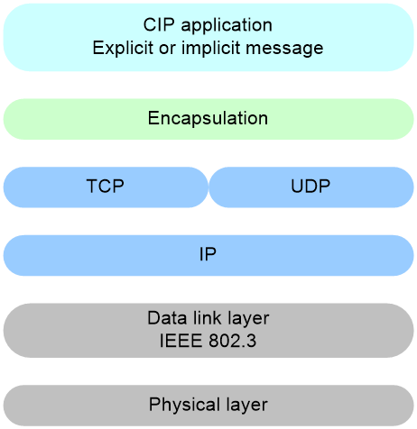

Network model
As shown in Table 1, EtherNet/IP uses the same physical layer, data link layer, and transport layer as standard Ethernet and adds an encapsulation layer above the transport layer. This encapsulation layer is used to package the CIP data coming from the application layer into a standard format.
Figure 1 EtherNet/IP network model

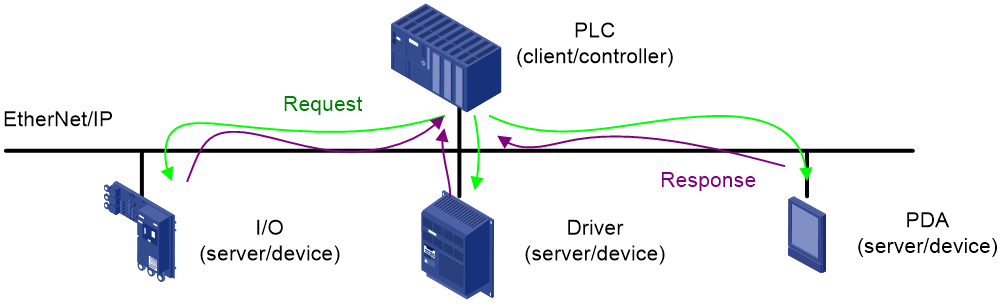

Explicit communication
EtherNet/IP explicit communication uses a client/server model in which the industrial control device (controller) acts as the client, and peripheral I/O sensors, valves, industrial switches, or other measuring devices (devices) act as servers. The communication is initiated by the client, which sends a request to the servers. The servers respond accordingly after receiving the request.
Figure 2 EtherNet/IP explicit communication model

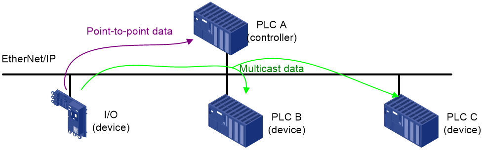

Implicit communication
EtherNet/IP implicit communication uses a producer/consumer model. In this model, the devices act as data producers. They send their data onto the network all at once, allowing the controller to selectively read the data they require. This greatly enhances the communication efficiency of the entire EtherNet/IP network system.
Figure 3 EtherNet/IP implicit communication model

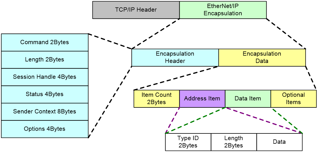

Explicit communication message format
In explicit communication mode, EtherNet/IP encapsulates the CIP protocol data in the following format.
Figure 4 Explicit communication message format
The EtherNet/IP explicit encapsulation package includes an encapsulation header and encapsulation data. The encapsulation header contains the following fields:
·     Command: EtherNet/IP command that describes the function and purpose of the message, in 2 bytes.
·     Length: Length of the data following the encapsulation header, in 2 bytes.
·     Session Handle: TCP session handle, in 4 bytes.
·     Status: Execution status of the EtherNet/IP command, in 4 bytes.
·     Sender Context: Description of sender information, in 8 bytes.
·     Options: Optional field, a maximum of 4 bytes.
The encapsulating data contains the following fields:
·     Item Count: Total number of items in the packaged data.
·     Address Item: Destination address information, including the address type, address length, and specific address.
·     Data Item: CIP protocol data information, including the data type, data length, and specific data. The specific data includes the CIP command and request path.

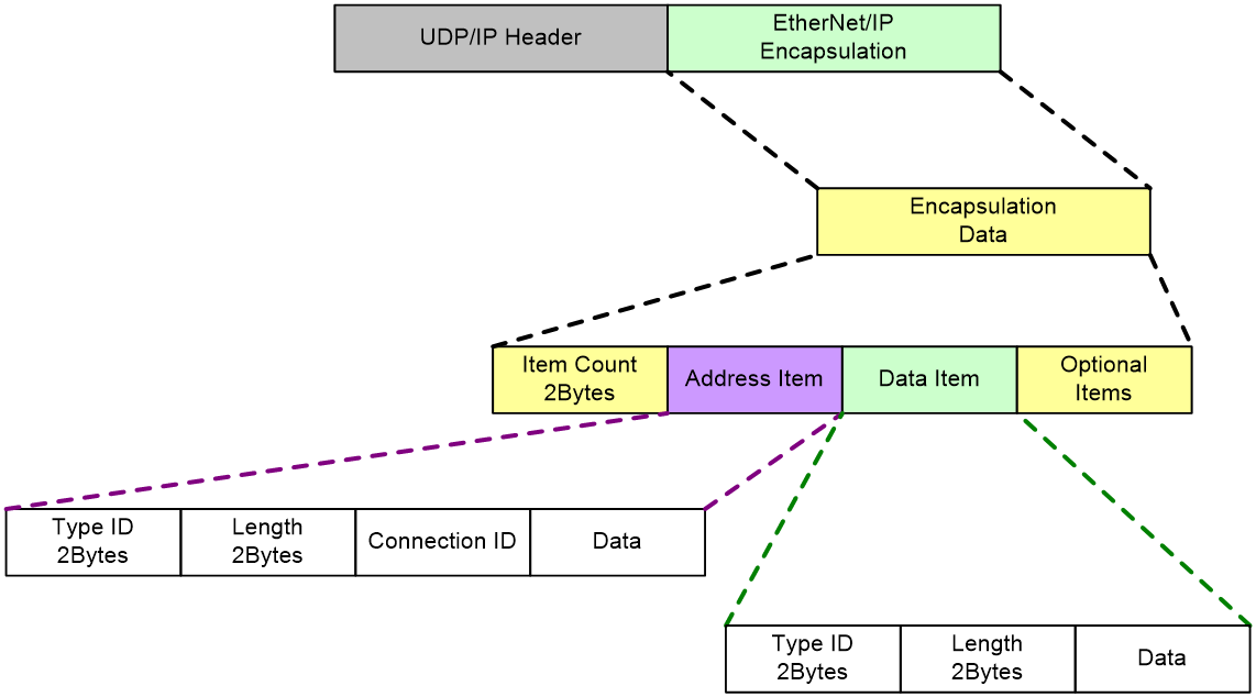

Implicit communication message format
In implicit communication mode, EtherNet/IP encapsulates the CIP protocol data in the following format.
Figure 5 Implicit communication message format
The EtherNet/IP explicit encapsulation package includes only the encapsulation data, which contains the following fields:
·     Address Item: Destination address information, including the address type, address length, CIP connection ID, and specific address. In implicit communication mode, EtherNet/IP determines the target by the connection ID.

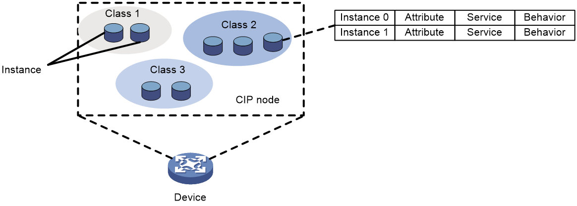

CIP object model
Each CIP node is a set of objects, and the targets of CIP communication are these specific objects. For EtherNet/IP communication, you can define specific components on a device as different objects.
Objects use a three-dimensional structure with classes, instances, and attributes. Multiple classes can exist on a CIP node, each class can have multiple instances, and each instance can have multiple attributes, as shown in Figure 6.
Figure 6 CIP object model diagram
