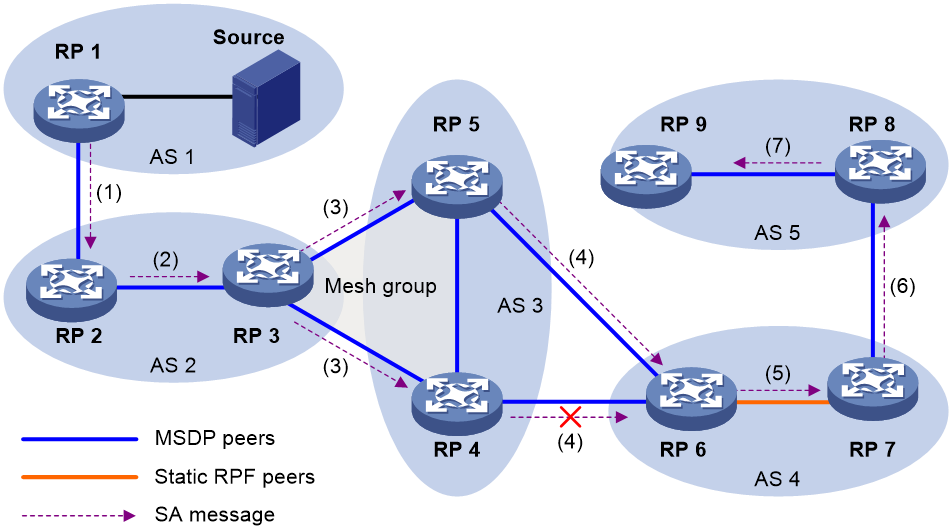

MSDP peer-RPF forwarding
The MSDP peer-RPF check is used for forwarding SA messages on a network that runs MSDP. If the peer-RPF check succeeds, the SA message is accepted and forwarded. Otherwise, the SA message is discarded.
As shown in Figure 3:
·     There are five ASs on the network. IGP runs within each AS, and BGP or MBGP runs between these ASs.
·     Each AS contains a minimum of one PIM-SM domain, and each PIM-SM domain contains a minimum of one RP.
·     MSDP peering relationship has been established among these RPs.
RP 3, RP 4, and RP 5 are in the same MSDP mesh group.
RP 6 is configured as the static RPF peer of RP 7.
Figure 3 MSDP peer-RPF forwarding
The process of peer-RPF forwarding is as follows:
1.     RP 1 creates an SA message and forwards it to its peer RP 2.
2.     RP 2 determines that RP 1 is the RP that creates the SA message because the RP address in the SA message is the same as that of RP 1. Then, RP 2 accepts and forwards the SA message.
3.     RP 3 accepts and forwards the SA message, because RP 2 and RP 3 reside in the same AS and RP 2 is the next hop of RP 3 to RP 1.
4.     RP 4 and RP 5 accept the SA message, because RP 3 is in the same mesh group with them. Then, RP 4 and RP 5 forward the SA message to their peer RP 6 rather than other members of the mesh group.
5.     RP 4 and RP 5 reside in the closest AS in the route to RP 1. However, RP 6 accepts and forwards only the SA message from RP 5, because the IP address of RP 5 is higher than that of RP 4.
6.     RP 7 accepts and forwards the SA message, because RP 6 is its static RPF peer.
7.     RP 8 accepts and forwards the SA message, because RP 7 is the EBGP or MBGP next hop of the peer-RPF route to RP 1.
8.     RP 9 accepts the SA message, because RP 8 is the only RP of RP 9.

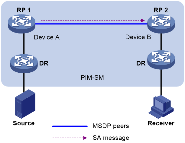

Anycast RP through MSDP
PIM-SM requires only one active RP to serve each multicast group. If the active RP fails, the multicast traffic might be interrupted. The Anycast RP mechanism enables redundancy backup between two or more RPs by configuring multiple RPs with the same IP address for one multicast group. A multicast source registers with the closest RP or a receiver joins the closest RP to implement source information synchronization.
For Anycast RP implemented through MSDP, all member RPs in the Anycast RP set have the same IP address, and MSDP peering connections are established between the RPs.
As shown in Figure 4, within a PIM-SM domain, a multicast source sends multicast data to multicast group G, and the receiver joins the multicast group. To implement Anycast RP through MSDP, complete the following tasks:
1.     Assign the same IP address (known as Anycast RP address, typically a private address) to an interface on Device A and Device B.
2.     Configure the interfaces as C-RPs.
3.     Establish an MSDP peering relationship between Device A and Device B.
Figure 4 Anycast RP through MSDP
The following describes how Anycast RP through MSDP is implemented:
1.     After receiving the multicast data from Source, the source-side DR registers with the closest RP (RP 1 in this example).
2.     After receiving the IGMP report message from the receiver, the receiver-side DR sends a join message toward the closest RP (RP 2 in this example). An RPT rooted at this RP is established.
3.     The RPs share the registered multicast source information through SA messages. After obtaining the multicast source information, RP 2 sends an (S, G) source-specific join message toward the source to create an SPT.
4.     When the multicast data reaches RP 2 along the SPT, the RP forwards the data along the RPT to the receiver. After receiving the multicast data, the receiver-side DR determines whether to initiate an RPT-to-SPT switchover process based on its configuration.

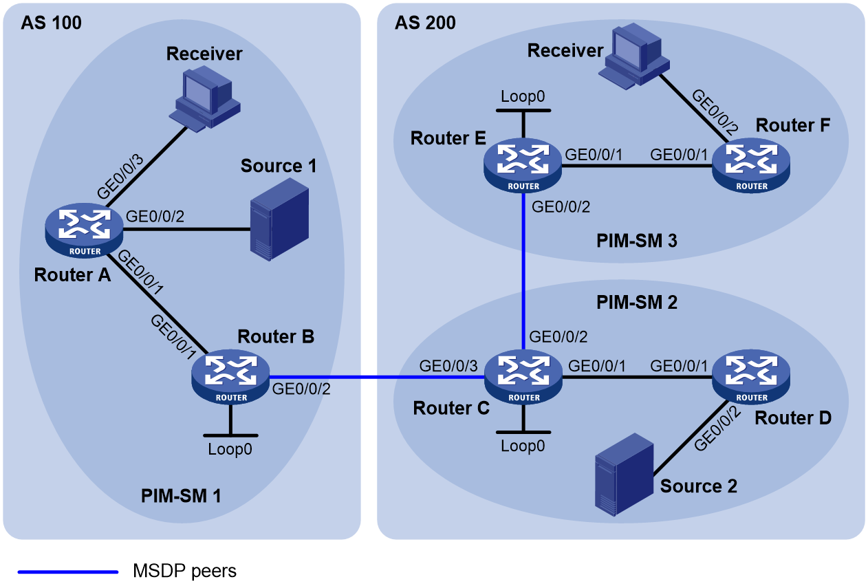

As shown in Figure 5:
·     OSPF runs within AS 100 and AS 200. BGP runs between the two ASs.
·     Each PIM-SM domain has a minimum of one multicast source or receiver.
Set up MSDP peering relationships between the RPs in the PIM-SM domains to share multicast source information among the PIM-SM domains.
Figure 5 Network diagram
Device
Interface
IP address
Device
Interface
IP address
Router A
GE0/0/1
10.110.1.2/24
Router D
GE0/0/1
10.110.4.2/24
Router A
GE0/0/2
10.110.2.1/24
Router D
GE0/0/2
10.110.5.1/24
Router A
GE0/0/3
10.110.3.1/24
Router E
GE0/0/1
10.110.6.1/24
Router B
GE0/0/1
10.110.1.1/24
Router E
GE0/0/2
192.168.3.2/24
Router B
GE0/0/2
192.168.1.1/24
Router E
Loop0
3.3.3.3/32
Router B
Loop0
1.1.1.1/32
Router F
GE0/0/1
10.110.6.2/24
Router C
GE0/0/1
10.110.4.1/24
Router F
GE0/0/2
10.110.7.1/24
Router C
GE0/0/2
192.168.3.1/24
Source 1
10.110.2.100/24
Router C
GE0/0/3
192.168.1.2/24
Source 2
10.110.5.100/24
Router C
Loop0
2.2.2.2/32
1.     Assign an IP address and subnet mask to each interface according to Figure 5. (Details not shown.)
2.     Configure OSPF on the routers in the ASs. (Details not shown.)
3.     Enable IP multicast routing, enable PIM-SM and IGMP, and configure a PIM-SM domain border:
# On Router A, enable IP multicast routing.
<RouterA> system-view
[RouterA] multicast routing
[RouterA-mrib] quit
# Enable PIM-SM on GigabitEthernet 0/0/1 and GigabitEthernet 0/0/2.
[RouterA] interface gigabitethernet 0/0/1
[RouterA-GigabitEthernet0/0/1] pim sm
[RouterA-GigabitEthernet0/0/1] quit
[RouterA] interface gigabitethernet 0/0/2
[RouterA-GigabitEthernet0/0/2] pim sm
[RouterA-GigabitEthernet0/0/2] quit
# Enable IGMP on the receiver-side interface (GigabitEthernet 0/0/3).
[RouterA] interface gigabitethernet 0/0/3
[RouterA-GigabitEthernet0/0/3] igmp enable
[RouterA-GigabitEthernet0/0/3] quit
# Enable IP multicast routing, PIM-SM, and IGMP on Router B, Router C, Router D, Router E, and Router F in the same way Router A is configured. (Details not shown.)
# Configure a PIM domain border on Router B.
[RouterB] interface gigabitethernet 0/0/2
[RouterB-GigabitEthernet0/0/2] pim bsr-boundary
[RouterB-GigabitEthernet0/0/2] quit
# Configure a PIM domain border separately on Router C and Router E in the same way Router B is configured. (Details not shown.)
4.     Configure C-BSRs and C-RPs:
# Configure Loopback 0 on Router B as a C-BSR and a C-RP.
[RouterB] pim
[RouterB-pim] c-bsr 1.1.1.1
[RouterB-pim] c-rp 1.1.1.1
[RouterB-pim] quit
# Configure C-BSRs and C-RPs on Router C and Router E in the same way Router B is configured. (Details not shown.)
5.     Configure BGP for mutual route redistribution between BGP and OSPF:
# On Router B, configure an EBGP peer and redistribute OSPF routes.
[RouterB] bgp 100
[RouterB-bgp] router-id 1.1.1.1
[RouterB-bgp] peer 192.168.1.2 as-number 200
[RouterB-bgp] address-family ipv4
[RouterB-bgp-ipv4] import-route ospf 1
[RouterB-bgp-ipv4] peer 192.168.1.2 enable
[RouterB-bgp-ipv4] quit
[RouterB-bgp] quit
# On Router C, configure an EBGP peer and redistribute OSPF routes.
[RouterC] bgp 200
[RouterC-bgp] router-id 2.2.2.2
[RouterC-bgp] peer 192.168.1.1 as-number 100
[RouterC-bgp] address-family ipv4
[RouterC-bgp-ipv4] import-route ospf 1
[RouterB-bgp-ipv4] peer 192.168.1.1 enable
[RouterC-bgp-ipv4] quit
[RouterC-bgp] quit
# Redistribute BGP routing information into OSPF on Router B.
[RouterB] ospf 1
[RouterB-ospf-1] import-route bgp
[RouterB-ospf-1] quit
# Redistribute BGP routing information into OSPF on Router C.
[RouterC] ospf 1
[RouterC-ospf-1] import-route bgp
[RouterC-ospf-1] quit
6.     Configure MSDP peers:
# Configure an MSDP peer on Router B.
[RouterB] msdp
[RouterB-msdp] peer 192.168.1.2 connect-interface gigabitethernet 0/0/2
[RouterB-msdp] quit
# Configure MSDP peers on Router C.
[RouterC] msdp
[RouterC-msdp] peer 192.168.1.1 connect-interface gigabitethernet 0/0/3
[RouterC-msdp] peer 192.168.3.2 connect-interface gigabitethernet 0/0/2
[RouterC-msdp] quit
# Configure an MSDP peer on Router E.
[RouterE] msdp
[RouterE-msdp] peer 192.168.3.1 connect-interface gigabitethernet 0/0/2
[RouterE-msdp] quit
# Display information about BGP IPv4 unicast peers or peer groups on Router B.
[RouterB] display bgp peer ipv4
 BGP local router ID: 1.1.1.1
 Local AS number: 100
 Total number of peers: 1                  Peers in established state: 1
  Peer                    AS  MsgRcvd  MsgSent OutQ PrefRcv Up/Down  State
  192.168.1.2            200       24       21    0       6 00:13:09 Established
# Display information about BGP IPv4 unicast peers or peer groups on Router C.
[RouterC] display bgp peer ipv4
 BGP local router ID: 2.2.2.2
 Local AS number: 200
  192.168.1.1            100       18       16    0       1 00:12:04 Established
# Display the BGP IPv4 unicast routing table on Router C.
[RouterC] display bgp routing-table ipv4
Total number of routes: 5
 BGP local router ID is 2.2.2.2
 Status codes: * - valid, > - best, d - dampened, h - history,
               s - suppressed, S - stale, i - internal, e - external
               Origin: i - IGP, e - EGP, ? - incomplete
     Network            NextHop         MED        LocPrf     PrefVal Path/Ogn
* >  1.1.1.1/32         192.168.1.1     0                     0       100?
* >i 2.2.2.2/32         0.0.0.0         0                     0       ?
* >  192.168.1.0        0.0.0.0         0                     0       ?
* >  192.168.1.1/32     0.0.0.0         0                     0       ?
* >  192.168.1.2/32     0.0.0.0         0                     0       ?
# Verify that hosts in PIM-SM 1 and PIM-SM 3 can receive the multicast data from Source 1 and Source 2. (Details not shown.)
# Display brief information about MSDP peer groups on Router B.
[RouterB] display msdp brief
Configured   Established  Listen       Connect      Shutdown     Disabled
1            1            0            0            0            0
Peer address    State       Up/Down time    AS         SA count   Reset count
192.168.1.2     Established 00:12:19        200        13         0
# Display brief information about MSDP peer groups on Router C.
[RouterC] display msdp brief
2            2            0            0            0            0
192.168.3.2     Established 00:15:19        200        8          0
192.168.1.1     Established 00:06:11        100        13         0
# Display brief information about MSDP peer groups on Router E.
[RouterE] display msdp brief
1            1            0            0            0            0
192.168.3.1     Established 01:12:19        200        8          0
# Display detailed MSDP peer information on Router B.
[RouterB] display msdp peer-status
MSDP Peer 192.168.1.2; AS 200
 Description:
 Information about connection status:
   State: Established
   Up/down time: 00:15:47
   Resets: 0
   Connection interface: GigabitEthernet0/0/2 (192.168.1.1)
   Received/sent messages: 16/16
   Discarded input messages: 0
   Discarded output messages: 0
   Elapsed time since last connection or counters clear: 00:17:40
   Mesh group peer joined: momo
   Last disconnect reason: Hold timer expired with truncated message
   Truncated packet: 5 bytes in buffer, type: 1, length: 20, without packet time: 75s
 Information about (Source, Group)-based SA filtering policy:
   Import policy: None
   Export policy: None
 Information about SA-Requests:
   Policy to accept SA-Requests: None
   Sending SA-Requests status: Disable
 Minimum TTL to forward SA with encapsulated data: 0
 SAs learned from this peer: 0, SA cache maximum for the peer: 4294967295
 Input queue size: 0, Output queue size: 0
 Counters for MSDP messages:
   RPF check failure: 0
   Incoming/outgoing SA: 0/0
   Incoming/outgoing SA-Request: 0/0
   Incoming/outgoing SA-Response: 0/0
   Incoming/outgoing Keepalive: 867/867
   Incoming/outgoing Notification: 0/0
   Incoming/outgoing Traceroutes in progress: 0/0
   Incoming/outgoing Traceroute reply: 0/0
   Incoming/outgoing Unknown: 0/0
   Incoming/outgoing data packet: 0/0

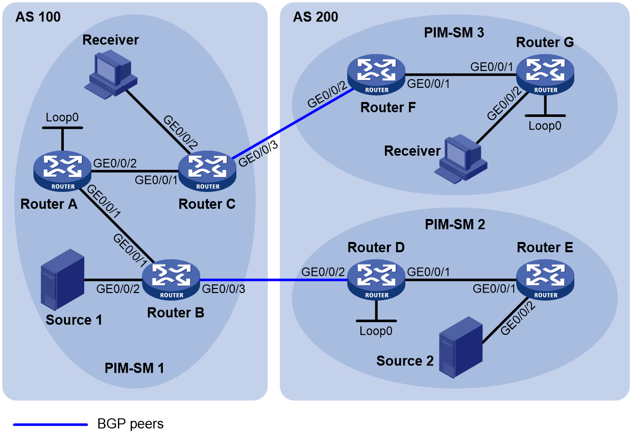

·     The network has two ASs: AS 100 and AS 200. OSPF runs within each AS. BGP runs between the two ASs.
·     PIM-SM 1 belongs to AS 100, and PIM-SM 2 and PIM-SM 3 belong to AS 200. Each PIM-SM domain has a minimum of one multicast source or receiver.
Configure inter-AS multicast as follows:
·     Configure Loopback 0 as the C-BSR and C-RP of the related PIM-SM domain on Router A, Router D and Router G.
·     According to the peer-RPF forwarding rule, the routers accept SA messages that pass the filtering policy from its static RPF peers. To share multicast source information among PIM-SM domains without changing the unicast topology structure, configure MSDP peering relationships for the RPs of the PIM-SM domains and configure the static RPF peering relationships.
Figure 6 Network diagram
Device
Interface
IP address
Device
Interface
IP address
Source 1
192.168.1.100/24
Router D
GE0/0/1
10.110.5.1/24
Source 2
192.168.3.100/24
Router D
GE0/0/2
10.110.3.2/24
Router A
GE0/0/1
10.110.1.1/24
Router D
Loop0
2.2.2.2/32
Router A
GE0/0/2
10.110.2.1/24
Router E
GE0/0/1
10.110.5.2/24
Router A
Loop0
1.1.1.1/32
Router E
GE0/0/2
192.168.3.1/24
Router B
GE0/0/1
10.110.1.2/24
Router F
GE0/0/1
10.110.6.1/24
Router B
GE0/0/2
192.168.1.1/24
Router F
GE0/0/2
10.110.4.2/24
Router B
GE0/0/3
10.110.3.1/24
Router G
GE0/0/1
10.110.6.2/24
Router C
GE0/0/1
10.110.2.2/24
Router G
GE0/0/2
192.168.4.1/24
Router C
GE0/0/2
192.168.2.1/24
Router G
Loop0
3.3.3.3/32
Router C
GE0/0/3
10.110.4.1/24
1.     Assign an IP address and subnet mask to each interface according to Table 2. (Details not shown.)
3.     Enable IP multicast routing, PIM-SM, and IGMP, and configure PIM-SM domain borders:
# On Router C, enable IP multicast routing.
<RouterC> system-view
[RouterC] multicast routing
[RouterC-mrib] quit
# Enable PIM-SM on each interface, and enable IGMP on the receiver-side interface (GigabitEthernet 0/0/2).
[RouterC] interface gigabitethernet 0/0/1
[RouterC-GigabitEthernet0/0/1] pim sm
[RouterC-GigabitEthernet0/0/1] quit
[RouterC] interface gigabitethernet 0/0/2
[RouterC-GigabitEthernet0/0/2] igmp enable
[RouterC-GigabitEthernet0/0/2] quit
[RouterC] interface gigabitethernet 0/0/3
[RouterC-GigabitEthernet0/0/3] pim sm
[RouterC-GigabitEthernet0/0/3] quit
# Configure Router A, Router B, Router D, Router E, Router F, and Router G in the same way Router C is configured. (Details not shown.)
# On Router B, configure the PIM domain borders.
[RouterB] interface gigabitethernet 0/0/3
[RouterB-GigabitEthernet0/0/3] pim bsr-boundary
[RouterB-GigabitEthernet0/0/3] quit
# Configure the PIM domain borders on Router C, Router D, and Router F in the same way Router B is configured. (Details not shown.)
# On Router A, configure Loopback 0 as a C-BSR and a C-RP.
[RouterA] pim
[RouterA-pim] c-bsr 1.1.1.1
[RouterA-pim] c-rp 1.1.1.1
[RouterA-pim] quit
# Configure C-BSRs and C-RPs on Router D and Router G in the same way Router A is configured. (Details not shown.)
5.     Configure BGP, and redistribute BGP routing information into OSPF and OSPF routing information into BGP:
# On Router B, configure an EBGP peer, and redistribute OSPF routing information.
[RouterB] bgp 100
[RouterB-bgp] router-id 1.1.1.2
[RouterB-bgp] peer 10.110.3.2 as-number 200
[RouterB-bgp] address-family ipv4 unicast
[RouterB-bgp-ipv4] peer 10.110.3.2 enable
[RouterB-bgp] quit
# On Router D, configure an EBGP peer, and redistribute OSPF routing information.
[RouterD] bgp 200
[RouterD-bgp] router-id 2.2.2.2
[RouterD-bgp] peer 10.110.3.1 as-number 100
[RouterD-bgp] address-family ipv4 unicast
[RouterD-bgp-ipv4] peer 10.110.3.1 enable
[RouterD-bgp-ipv4] import-route ospf 1
[RouterD-bgp-ipv4] quit
[RouterD-bgp] quit
# On Router C, configure an EBGP peer, and redistribute OSPF routing information.
[RouterC] bgp 100
[RouterC-bgp] router-id 1.1.1.3
[RouterC-bgp] peer 10.110.4.2 as-number 200
[RouterC-bgp] address-family ipv4 unicast
[RouterC-bgp-ipv4] peer 10.110.4.2 enable
[RouterC-bgp] quit
# On Router F, configure an EBGP peer, and redistribute OSPF routing information.
[RouterF] bgp 200
[RouterF-bgp] router-id 3.3.3.1
[RouterF-bgp] peer 10.110.4.1 as-number 100
[RouterF-bgp] address-family ipv4 unicast
[RouterF-bgp-ipv4] peer 10.110.4.1 enable
[RouterF-bgp-ipv4] import-route ospf 1
[RouterF-bgp-ipv4] quit
[RouterF-bgp] quit
# On Router B, redistribute BGP routing information into OSPF.
[RouterB] ospf 1
# On Router D, redistribute BGP routing information into OSPF.
[RouterD] ospf 1
[RouterD-ospf-1] import-route bgp
[RouterD-ospf-1] quit
# On Router C, redistribute BGP routing information into OSPF.
[RouterC] ospf 1
# On Router F, redistribute BGP routing information into OSPF.
[RouterF] ospf 1
[RouterF-ospf-1] import-route bgp
[RouterF-ospf-1] quit
6.     Configure MSDP peers and static RPF peers:
# On Router A, configure Router D and Router G as the MSDP peers and static RPF peers.
[RouterA] ip prefix-list list-dg permit 10.110.0.0 16 greater-equal 16 less-equal 32
[RouterA] msdp
[RouterA-msdp] peer 10.110.3.2 connect-interface gigabitethernet 0/0/1
[RouterA-msdp] peer 10.110.6.2 connect-interface gigabitethernet 0/0/2
[RouterA-msdp] static-rpf-peer 10.110.3.2 rp-policy list-dg
[RouterA-msdp] static-rpf-peer 10.110.6.2 rp-policy list-dg
[RouterA-msdp] quit
# On Router D, configure Router A as the MSDP peer and static RPF peer.
[RouterD] ip prefix-list list-a permit 10.110.0.0 16 greater-equal 16 less-equal 32
[RouterD] msdp
[RouterD-msdp] peer 10.110.1.1 connect-interface gigabitethernet 0/0/2
[RouterD-msdp] static-rpf-peer 10.110.1.1 rp-policy list-a
[RouterD-msdp] quit
# On Router G, configure Router A as the MSDP peer and static RPF peer.
[RouterG] ip prefix-list list-a permit 10.110.0.0 16 greater-equal 16 less-equal 32
[RouterG] msdp
[RouterG-msdp] peer 10.110.2.1 connect-interface gigabitethernet 0/0/1
[RouterG-msdp] static-rpf-peer 10.110.2.1 rp-policy list-a
[RouterG-msdp] quit
# Display the BGP peering relationships on Router A.
[RouterA] display bgp peer
No information is output, because no BGP peering relationship has been established between Router A and Router D, or between Router A and Router G. This means that the unicast topology is not changed.
# Display brief information about MSDP peers on Router A.
[RouterA] display msdp brief
2            2            0            0            0            0
10.110.3.2      Established 01:07:08        ?          8          0
10.110.6.2      Established 00:16:39        ?          13         0
# Display brief information about MSDP peers on Router D.
[RouterD] display msdp brief
1            1            0            0            0            0
10.110.1.1      Established 01:07:09        ?          8          0
# Display brief information about MSDP peers on Router G.
[RouterG] display msdp brief
1            1            0            0            0            0
10.110.2.1      Established 00:16:40        ?          13         0
# Verify that receivers in PIM-SM 1 and PIM-SM 3 can receive the multicast data from Source 1 and Source 2 to a multicast group. (Details not shown.)

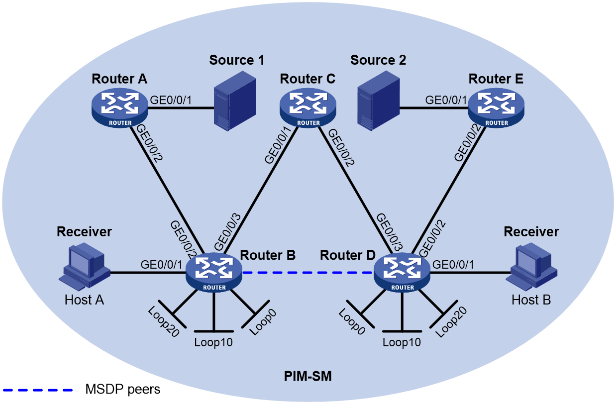

Example: Configuring Anycast RP
As shown in Figure 7, OSPF runs within the domain to provide unicast routes.
Configure the Anycast RP application so that the receiver-side DRs and the source-side DRs can initiate a join process to their respective RPs that are topologically closest to them.
Configure the router IDs of Router B and Router D as 1.1.1.1 and 2.2.2.2, respectively. Set up an MSDP peering relationship between Router B and Router D.
Figure 7 Network diagram
Table 3 Interface and IP address assignment
Device
Interface
IP address
Device
Interface
IP address
Source 1
10.110.5.100/24
Router C
GE0/0/1
192.168.1.2/24
Source 2
10.110.6.100/24
Router C
GE0/0/2
192.168.2.2/24
Router A
GE0/0/1
10.110.5.1/24
Router D
GE0/0/1
10.110.3.1/24
Router A
GE0/0/2
10.110.2.2/24
Router D
GE0/0/2
10.110.4.1/24
Router B
GE0/0/1
10.110.1.1/24
Router D
GE0/0/3
192.168.2.1/24
Router B
GE0/0/2
10.110.2.1/24
Router D
Loop0
2.2.2.2/32
Router B
GE0/0/3
192.168.1.1/24
Router D
Loop10
4.4.4.4/32
Router B
Loop0
1.1.1.1/32
Router D
Loop20
10.1.1.1/32
Router B
Loop10
3.3.3.3/32
Router E
GE0/0/1
10.110.6.1/24
Router B
Loop20
10.1.1.1/32
Router E
GE0/0/2
10.110.4.2/24
1.     Assign an IP address and subnet mask to each interface according to Figure 7. (Details not shown.)
2.     Configure OSPF on the routers in the PIM-SM domain. (Details not shown.)
3.     Enable IP multicast routing, IGMP, and PIM-SM:
# On Router B, enable IP multicast routing.
<RouterB> system-view
[RouterB] multicast routing
[RouterB-mrib] quit
# Enable IGMP on the receiver-side interface (GigabitEthernet 0/0/1).
[RouterB] interface gigabitethernet 0/0/1
[RouterB-GigabitEthernet0/0/1] igmp enable
[RouterB-GigabitEthernet0/0/1] quit
# Enable PIM-SM on the other interfaces.
[RouterB-GigabitEthernet0/0/2] pim sm
[RouterB-GigabitEthernet0/0/3] pim sm
[RouterB] interface loopback 0
[RouterB-LoopBack0] pim sm
[RouterB-LoopBack0] quit
[RouterB] interface loopback 10
[RouterB-LoopBack10] pim sm
[RouterB-LoopBack10] quit
[RouterB] interface loopback 20
[RouterB-LoopBack20] pim sm
[RouterB-LoopBack20] quit
# Enable IP multicast routing, IGMP, and PIM-SM on Router A, Router C, Router D, and Router E in the same way Router B is configured. (Details not shown.)
# On Router B, configure Loopback 10 as a C-BSR and configure Loopback 20 as a C-RP.
[RouterB] pim
[RouterB-pim] c-bsr 3.3.3.3
[RouterB-pim] c-rp 10.1.1.1
[RouterB-pim] quit
# Configure a C-BSR and a C-RP on Router D in the same way Router B is configured. (Details not shown.)
5.     Configure MSDP peers:
# Configure an MSDP peer on Loopback 0 of Router B.
[RouterB] msdp
[RouterB-msdp] originating-rp loopback 0
[RouterB-msdp] peer 2.2.2.2 connect-interface loopback 0
[RouterB-msdp] quit
# Configure an MSDP peer on Loopback 0 of Router D.
[RouterD] msdp
[RouterD-msdp] originating-rp loopback 0
[RouterD-msdp] peer 1.1.1.1 connect-interface loopback 0
[RouterD-msdp] quit
# Display brief information about MSDP peers on Router B.
1          1          0         0         0         0
2.2.2.2         Established 00:00:13        ?          0          0
1            1            0            0            0            0
1.1.1.1         Established 00:00:13        ?          0          0
# Send an IGMP report from Host A to join the multicast group 225.1.1.1. (Details not shown.)
# Send multicast data from Source 1 10.110.5.100/24 to the multicast group 225.1.1.1. (Details not shown.)
# Display the PIM routing table on Router D.
[RouterD] display pim routing-table
No information is output on Router D.
# Display the PIM routing table on Router B.
[RouterB] display pim routing-table
 Total 1 (*, G) entry; 1 (S, G) entry
 (*, 225.1.1.1)
     RP: 10.1.1.1 (local)
     Protocol: pim-sm, Flag: WC
     UpTime: 00:15:04
     Upstream interface: Register
         Upstream neighbor: NULL
         RPF prime neighbor: NULL
     Downstream interface(s) information:
     Total number of downstreams: 1
         1: GigabitEthernet0/0/1
             Protocol: igmp, UpTime: 00:15:04, Expires: -
 (10.110.5.100, 225.1.1.1)
     Protocol: pim-sm, Flag: SPT 2MSDP ACT
     UpTime: 00:46:28
     Upstream interface: GigabitEthernet0/0/2
         Upstream neighbor: 10.110.2.2
         RPF prime neighbor: 10.110.2.2
             Protocol: pim-sm, UpTime:  - , Expires:  -
The output shows that Router B now acts as the RP for Source 1 and Host A.
# Send an IGMP leave message from Host A to leave multicast group 225.1.1.1. (Details not shown.),
# Send an IGMP report from Host B to join multicast group 225.1.1.1. (Details not shown.)
# Send multicast data from Source 2 to multicast group 225.1.1.1. (Details not shown.)
No information is output on Router B.
# Display PIM routing information on Router D.
 (*, 225.1.1.1)
     UpTime: 00:12:07

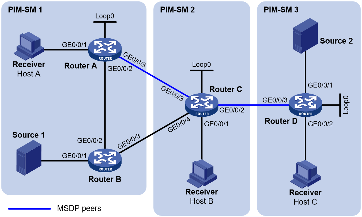

Example: Configuring SA message filtering
As shown in Figure 8:
·     OSPF runs within and among the PIM-SM domains to provide unicast routing.
·     Set up an MSDP peering relationship between Router A and Router C and between Router C and Router D.
·     Source 1 sends multicast data to multicast groups 225.1.1.0/30 and 226.1.1.0/30. Source 2 sends multicast data to the multicast group 227.1.1.0/30.
Configure SA message policies to meet the following requirements:
·     Host A and Host B receive the multicast data only addressed to multicast groups 225.1.1.0/30 and 226.1.1.0/30.
·     Host C receives the multicast data only addressed to multicast groups 226.1.1.0/30 and 227.1.1.0/30.
Figure 8 Network diagram
Table 4 Interface and IP address assignment
Device
Interface
IP address
Device
Interface
IP address
Source 1
10.110.3.100/24
Router C
GE0/0/1
10.110.4.1/24
Source 2
10.110.6.100/24
Router C
GE0/0/2
10.110.5.1/24
Router A
GE0/0/1
10.110.1.1/24
Router C
GE0/0/3
192.168.1.2/24
Router A
GE0/0/2
10.110.2.1/24
Router C
GE0/0/4
192.168.2.2/24
Router A
GE0/0/3
192.168.1.1/24
Router C
Loop0
2.2.2.2/32
Router A
Loop0
1.1.1.1/32
Router D
GE0/0/1
10.110.6.1/24
Router B
GE0/0/1
10.110.3.1/24
Router D
GE0/0/2
10.110.7.1/24
Router B
GE0/0/2
10.110.2.2/24
Router D
GE0/0/3
10.110.5.2/24
Router B
GE0/0/3
192.168.2.1/24
Router D
Loop0
3.3.3.3/32
1.     Assign an IP address and subnet mask to each interface according to Figure 8. (Details not shown.)
2.     Configure OSPF on the routers in the PIM-SM domains. (Details not shown.)
3.     Enable IP multicast routing, IGMP, and PIM-SM, and configure a PIM domain border:
[RouterA-mrib] quit
[RouterA-GigabitEthernet0/0/1] igmp enable
[RouterA-GigabitEthernet0/0/3] pim sm
[RouterA] interface loopback 0
[RouterA-LoopBack0] pim sm
[RouterA-LoopBack0] quit
# Enable IP multicast routing, IGMP, and PIM-SM on Router B, Router C, and Router D in the same way Router A is configured. (Details not shown.)
# Configure PIM domain borders on Router C.
[RouterC-GigabitEthernet0/0/2] pim bsr-boundary
[RouterC-GigabitEthernet0/0/3] pim bsr-boundary
[RouterC] interface gigabitethernet 0/0/4
[RouterC-GigabitEthernet0/0/4] pim bsr-boundary
[RouterC-GigabitEthernet0/0/4] quit
# Configure PIM domain borders on Router A, Router B, and Router D in the same way Router C is configured. (Details not shown.)
# Configure Loopback 0 on Router A as a C-BSR and a C-RP.
[RouterA] pim
[RouterA-pim] quit
# Configure C-BSRs and C-RPs on Router C and Router D in the same way Router A is configured. (Details not shown.)
# Configure an MSDP peer on Router A.
[RouterA] msdp
[RouterA-msdp] peer 192.168.1.2 connect-interface gigabitethernet 0/0/3
[RouterA-msdp] quit
[RouterC] msdp
[RouterC-msdp] peer 10.110.5.2 connect-interface gigabitethernet 0/0/2
[RouterC-msdp] quit
# Configure an MSDP peer on Router D.
[RouterD] msdp
[RouterD-msdp] peer 10.110.5.1 connect-interface gigabitethernet 0/0/3
[RouterD-msdp] quit
6.     Configure SA message policies:
# Configure an SA accepting and forwarding policy on Router C so that Router C will not forward SA messages for (Source 1, 225.1.1.0/30) to Router D.
[RouterC] acl advanced 3001
[RouterC-acl-ipv4-adv-3001] rule deny ip source 10.110.3.100 0 destination 225.1.1.0 0.0.0.3
[RouterC-acl-ipv4-adv-3001] rule permit ip source any destination any
[RouterC-acl-ipv4-adv-3001] quit
[RouterC] msdp
[RouterC-msdp] peer 10.110.5.2 sa-policy export acl 3001
[RouterC-msdp] quit
# Configure an SA creation policy on Router D so that Router D will not create SA messages for Source 2.
[RouterD] acl basic 2001
[RouterD-acl-ipv4-basic-2001] rule deny source 10.110.6.100 0
[RouterD-acl-ipv4-basic-2001] quit
[RouterD] msdp
[RouterD-msdp] import-source acl 2001
[RouterD-msdp] quit
# Display the (S, G) entries in the SA message cache on Router C.
[RouterC] display msdp sa-cache
 MSDP Total Source-Active Cache - 8 entries
 Matched 8 entries
Source          Group           Origin RP       Pro  AS     Uptime   Expires
10.110.3.100    225.1.1.0       1.1.1.1         ?    ?      02:03:30 00:05:31
10.110.3.100    225.1.1.1       1.1.1.1         ?    ?      02:03:30 00:05:31
10.110.3.100    225.1.1.2       1.1.1.1         ?    ?      02:03:30 00:05:31
10.110.3.100    225.1.1.3       1.1.1.1         ?    ?      02:03:30 00:05:31
10.110.3.100    226.1.1.0       1.1.1.1         ?    ?      02:03:30 00:05:31
10.110.3.100    226.1.1.1       1.1.1.1         ?    ?      02:03:30 00:05:31
10.110.3.100    226.1.1.2       1.1.1.1         ?    ?      02:03:30 00:05:31
10.110.3.100    226.1.1.3       1.1.1.1         ?    ?      02:03:30 00:05:31
# Display the (S, G) entries in the SA message cache on Router D.
[RouterD] display msdp sa-cache
 MSDP Total Source-Active Cache - 4 entries
 Matched 4 entries
10.110.3.100    226.1.1.0       1.1.1.1         ?    ?      00:32:53 00:05:07
10.110.3.100    226.1.1.1       1.1.1.1         ?    ?      00:32:53 00:05:07
10.110.3.100    226.1.1.2       1.1.1.1         ?    ?      00:32:53 00:05:07
10.110.3.100    226.1.1.3       1.1.1.1         ?    ?      00:32:53 00:05:07
