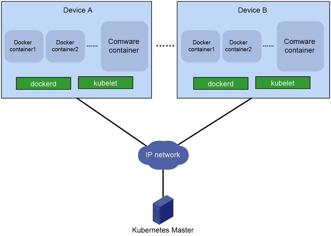

Comware 9 integrates Docker and kubelet. You can use Docker or Kubernetes to deploy container applications on the device.
·     Comware supports native Docker client commands. When using the docker command to create a container, you can assign the container namespaces and resources (cgroups) to implement container isolation. You can also save containers to the flash memory on the device so the device restores the containers after a reboot.
·     When kubelet is running on the device, the device is a Kubernetes node. You can use the Kubernetes master to orchestrate and manage open applications on the device.

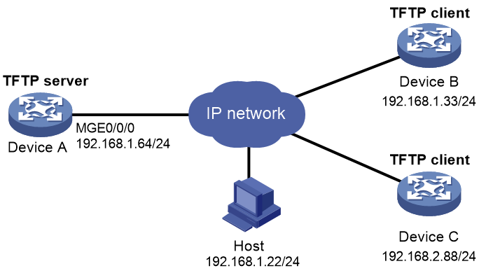

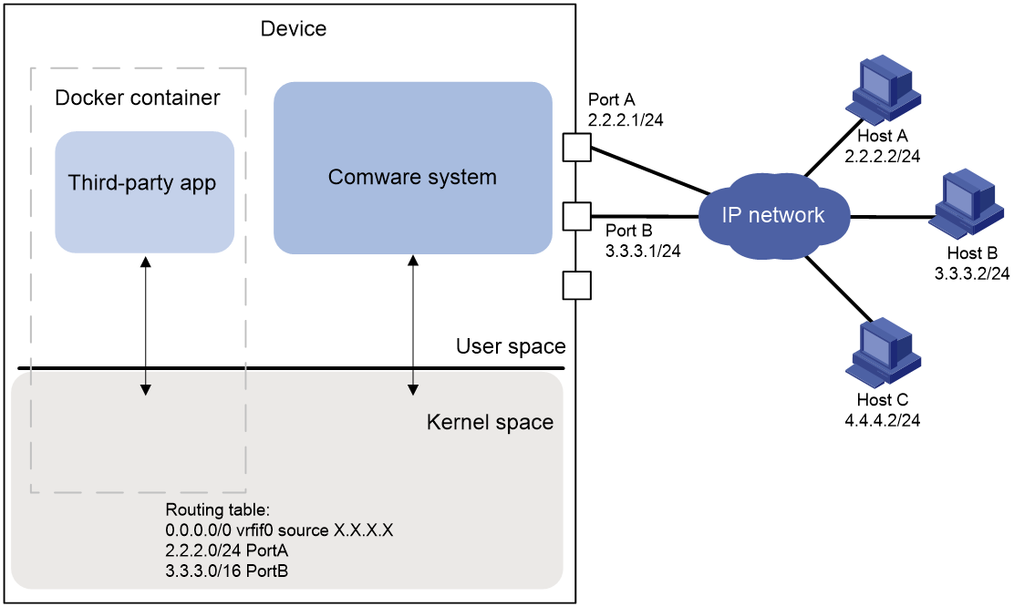

Network communication of containers that share the network namespace of Comware
An open application in a container that shares the network namespace of Comware uses the network parameters of Comware, including the interfaces, IP addresses, IP routing table, and port numbers.
·     For the application to communicate with a host that resides on the same network as the device, you do not need to configure additional network parameters. The application uses the IP address of the device to communicate with the host.
·     For the application to communicate with a host that resides on a different network than the device, you must configure a source IP address for the application. You must also make sure that a connection is available between the source IP address and the remote host. The application uses the source IP address to communicate with the remote host.
For example, if you configure the Docker container in Figure 2 to use the same network namespace as Comware, the system kernel creates a default route and one direct route for each interface in up state. Because Host A and Port A reside on the same subnet, Host A can use IP address 2.2.2.1 to communicate with the open application. The similar is true for Host B. Because Host C resides on a different subnet than the device, Host C must use the source IP address specified for the application to communicate with the application.

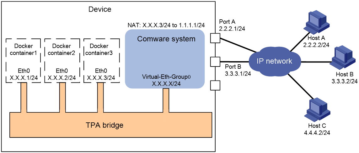

For open applications in containers that use a different network namespace than Comware to communicate with hosts on indirectly connected networks, you must create interface Virtual-Eth-Group 0. When creating interface Virtual-Eth-Group 0, Comware also creates an open bridge. The open applications use the bridge to communicate with hosts on indirectly connected networks.
As shown in Figure 3, after you create interface Virtual-Eth-Group 0 and assign it an IP address, an open bridge is created. When you create a Docker container that uses a different network namespace than Comware, Comware performs the following operations:
1.     Creates virtual interface Eth 0 for the container.
2.     Assigns the interface a free IP address that is on the subnet where Virtual-Eth-Group 0 resides, for example, X.X.X.1/24, X.X.X.2/24, and X.X.X.3/24.
3.     Set the default gateway IP address to the IP address of interface Virtual-Eth-Group 0.
The open applications in the containers on the same device belong to the same subnet and can communicate with each other directly.
When an open application in a container needs to communicate with a host on an indirectly connected network, the application sends its packets to interface Virtual-Eth-Group 0. The host can communicate with the open application as long as a network connection is available between the host and interface Virtual-Eth-Group 0.
The applications in container 1, container 2, and container 3 uses X.X.X.1/24, X.X.X.2/24 and X.X.X.3/24, respectively, to communicate with Host A, Host B, and Host C.

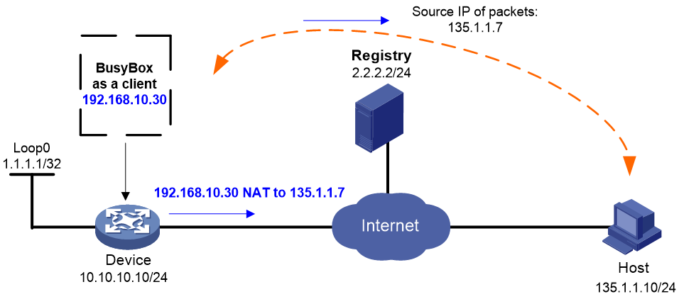

As shown in Figure 4, after you create interface Virtual-Eth-Group 0 and assign it an IP address, an open bridge is created. When you create a Docker container that uses a different network namespace than Comware, Comware performs the following operations:
For security purposes, the device provides NAT services for open applications. You can configure NAT to hide the true IP addresses of open applications. As shown in Figure 4, you can configure a NAT rule on the device to translate the IP address of container 3 (X.X.X.3) to 1.1.1.1. Then, the application in container 3 uses 1.1.1.1 to communicate with Host A, Host B, and Host C.

Configuring interface Virtual-Eth-Group 0
Open applications in containers that do not share the network namespace of Comware uses interface Virtual-Eth-Group 0 to communicate with indirectly connected networks.
2.     Create interface Virtual-Eth-Group 0 and enter its view.
interface virtual-eth-group 0
3.     Assign an IP address to the interface.
ip address ip-address { mask-length | mask } [ sub ]
By default, the interface does not have an IP address.
Enabling the kubelet service
After you enable the kubelet service on the device, the device becomes a Kubernetes node. You can use the Kubernetes master to orchestrate and manage open applications on the device.
The device is installed with kubelet when shipped. The Comware upgrade package contains the upgrade image for kubelet. When you upgrade the Comware system on the device, kubelet is also upgraded. You do not need to install or upgrade kubelet separately.
When you enable the kubelet service, the system automatically synchronize the files listed in Table 1 to the file system in memory. To enable the kubelet service successfully, make sure the files exist in the specified directory.

Example: Deploying a container application that uses the same network namespace as Comware
As shown in Figure 5, Device A is on the same subnet as Device B but is on a different subnet as Device C.
Deploy a containerized TFTP server application on Device A. On Device B and Device C, use 192.168.1.64 as the IP address of the TFTP server to upload the configuration files to the TFTP server.
Figure 5 Network diagram
Analysis
IP address 192.168.1.64 belongs to Device A. For the containerized TFTP server application to use the same IP address as Device A, you must configure the container to use the same network namespace as Comware.

# Access the CLI of the containerized TFTP server application.
[DeviceA] docker exec -it tftpserver sh
# Display the routing table.
/ # ip route
default dev vrfif0 scope link  src 192.168.1.64
127.0.0.0/8 dev InLoop0 scope link  src 127.0.0.1
127.1.1.0/30 dev eth0 scope link  src 127.1.1.2
192.168.1.0/24 dev MGE1_0_0_0 scope link  src 192.168.1.64
// The command output shows that there is a default route and there are three direct routes. The source IP address of the default route is 192.168.1.64.

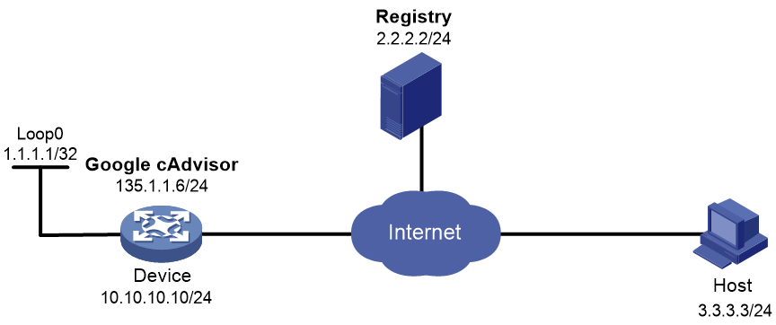

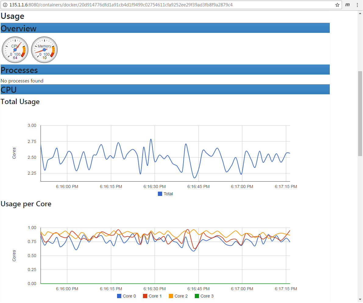

Example: Deploying a container application (separate network namespace and no NAT)
As shown in Figure 6, the Google cAdvisor image file is saved in the registry.
Pull and deploy Google cAdvisor on the device to monitor resource usage on the device. Use Host to view the resource usage information collected by cAdvisor.
Figure 6 Network diagram
Analysis
For cAdvisor to use a fixed IP address that is not the IP address of the device, you must configure the container to use a different network namespace than Comware.
Make sure that network connections are available between the following items:
·     Registry and IP address 1.1.1.1.
·     Host and IP address 10.10.10.10.
·     Host and IP address 135.1.1.6.
# On Host, modify Docker daemon configuration file daemon.json. Set the registry IP address to 2.2.2.2.
    "insecure-registries":["2.2.2.2"]
# On Device, create directory flash:/third-party/autocopy/docker and download file daemon.json to the directory.
<Device> mkdir flash:/third-party/autocopy/docker/
<Device> tftp 3.3.3.3 get daemon.json flash:/third-party/autocopy/docker/daemon.json
# Reload daemon.json.
<Device> system-view
[Device] docker-config reload
Reloading docker configuration...
Done.
# Assign IP address 1.1.1.1/32 to interface Loopback 0. Device will use Loopback 0 to pull an image.
[Device] interface loopback 0
[Device-LoopBack0] ip address 1.1.1.1 32
[Device-LoopBack0] quit
# Pull image google/cadvisor from the registry.
[Device] docker pull google/cadvisor
# List images.
[Device] docker images
REPOSITORY          TAG                 IMAGE ID            CREATED             SIZE
google/cadvisor     latest              75f88e3ec333        10 months ago       62.2MB
comware             MPU                 9b5091ba7bd0        17 years ago        33B
# Create a container named cadvisor that uses a different network namespace than Comware in the background, and run the cAdvisor image in the container.
[Device] docker run -v /:/rootfs:ro -v /var/run:/var/run:ro -v /sys:/sys:ro -v /var/lib/docker:/var/lib/docker:ro -v /dev/disk:/dev/disk:ro --detach --name cadvisor --ip 135.1.1.6 --network tpa google/cadvisor
4260ca77cec7b47649db94b9e63da7f57e06dcdb3d1c330707869f3818afcbbb
# List containers.
[Device] docker ps
CONTAINER ID        IMAGE               COMMAND                  CREATED             STATUS
             PORTS               NAMES
4260ca77cec7        google/cadvisor     "/usr/bin/cadvisor -…"   14 seconds ago      Up 13 seconds       8080/tcp            cadvisor
bd84340b76a1        comware:MPU         "/bin/v9.sh"             18 years ago        Up 18 years                             comware
# Create interface Virtual-Eth-Group 0 and assign IP address 135.1.1.1/24 to the interface. Google cAdvisor will use this interface to communicate with indirectly connected networks.
[Device] interface virtual-eth-group 0
[Device-Virtual-Eth-Group0] ip address 135.1.1.1 24
[Device-Virtual-Eth-Group0] quit
# On Host, launch a Web browser and enter http://135.1.1.6:8080 in the address bar to connect to cAdvisor. Verify that the monitoring information on cAdvisor is displayed.
Example: Deploying a container application (separate network namespace and source address translation)
As shown in Figure 7, the BusyBox image file is saved in the registry. The IP addresses for BusyBox is private IP address 192.168.10.30/24 and public IP address 135.1.1.7.
Pull and deploy BusyBox on the device. Make sure BusyBox can access Host.
Figure 7 Network diagram
Analysis
For BusyBox to use a private IP address, which is not the IP address of the device, you must perform the following tasks:
·     Configure the container to use a different network namespace than Comware.
·     Configure source address translation on Device to translate IP address 192.168.10.30 to 135.1.1.7.

# Create interface Virtual-Eth-Group 0 and assign IP address 192.168.10.1/24 to the interface. BusyBox will use this interface to communicate with indirectly connected networks.
[Device-Virtual-Eth-Group0] ip address 192.168.10.1 24
# Create a NAT address group numbered 0. Add public address 135.1.1.7 to the group.
[Device] nat address-group 0
[Device-nat-address-group-0] address 135.1.1.7
[Device-nat-address-group-0] quit
# Configure ACL 2900 to permit only users on 192.168.10.0/24 to access the Internet.
[Device] acl number 2900
[Device-acl-basic-2900] rule permit source 192.168.10.0 0.0.0.255
[Device-acl-basic-2900] rule deny
[Device-acl-basic-2900] quit
# Configure an inbound PAT rule on interface Virtual-Eth-Group 0 to translate the source addresses of incoming packets into the addresses in address group 0.
[Device-Virtual-Eth-Group0] nat inbound 2900 address-group 0
# Because public address 135.1.1.7 does not belong to the device, configure a route to the address so BusyBox can receive packets.
[Device] ip route-static 135.1.1.0 24 virtual-eth-group0 192.168.10.30

# Access the CLI of BusyBox, display the routing table, and ping Host.
[Device] docker exec -it busybox sh
/ # ip route
default via 192.168.10.1 dev eth0
192.168.10.0/24 dev eth0 scope link src 192.168.10.30
/ # ping 3.3.3.3
PING 3.3.3.3 (3.3.3.3): 56 data bytes
64 bytes from 3.3.3.3: seq=0 ttl=126 time=1.784 ms
64 bytes from 3.3.3.3: seq=1 ttl=126 time=1.079 ms
64 bytes from 3.3.3.3: seq=2 ttl=126 time=0.927 ms
^C
--- 3.3.3.3 ping statistics ---
10 packets transmitted, 10 packets received, 0% packet loss
round-trip min/avg/max = 0.888/1.647/6.009 ms
/ # exit
[Device]
