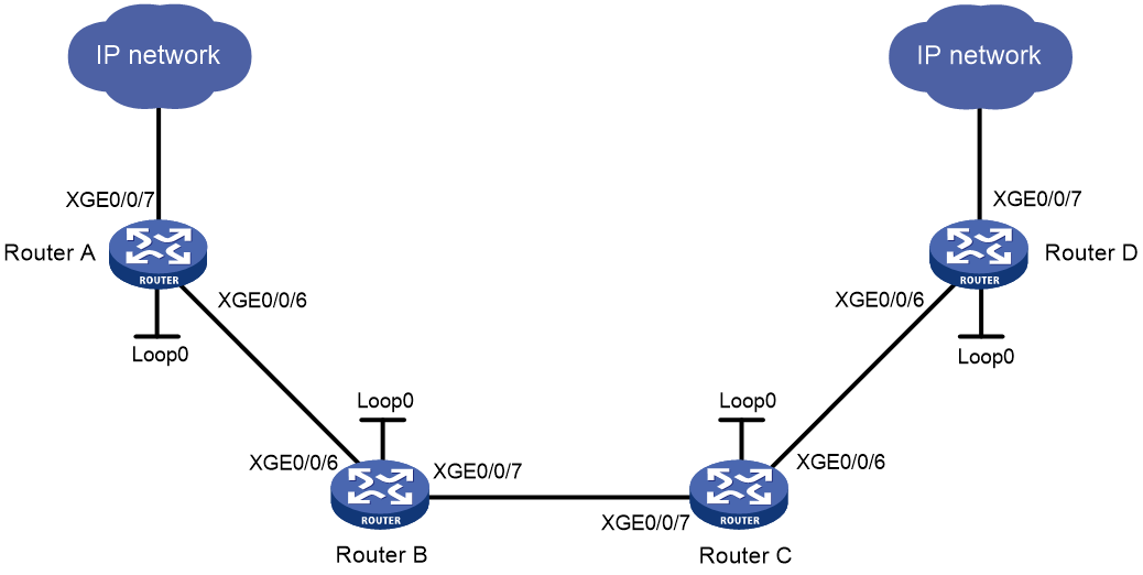

CRLSP setup procedure
As shown in Figure 1, a CRLSP is set up by using the following steps:
1.     The ingress LSR generates a Path message that carries LABEL_REQUEST, and then forwards the message along the path calculated by CSPF hop-by-hop towards the egress LSR.
2.     After receiving the Path message, the egress LSR generates a Resv message carrying the reservation information and the LABEL object. It forwards the Resv message to the ingress LSR along the reverse direction of the path that the Path message traveled.
The Resv message advertises labels, reserves resources, and creates a reserve state on each LSR it passes, so QoS can be guaranteed for services transmitted on the CRLSP.
3.     When the ingress LSR receives the Resv message, the CRLSP is established.
Figure 1 Setting up a CRLSP

Example: Establishing an MPLS TE tunnel with RSVP-TE
Router A, Router B, Router C, and Router D run IS-IS and all of them are Layer 2 routers.
Use RSVP-TE to establish an MPLS TE tunnel from Router A to Router D to transmit data between the two IP networks. The MPLS TE tunnel requires a bandwidth of 2000 kbps.
The maximum bandwidth of the link that the tunnel traverses is 10000 kbps and the maximum reservable bandwidth of the link is 5000 kbps.
Figure 2 Network diagram
Device
Interface
IP address
Device
Interface
IP address
Router A
Loop0
1.1.1.9/32
Router C
Loop0
3.3.3.9/32
XGE0/0/6
10.1.1.1/24
XGE0/0/6
30.1.1.1/24
XGE0/0/7
100.1.1.1/24
XGE0/0/7
20.1.1.2/24
Router B
Loop0
2.2.2.9/32
Router D
Loop0
4.4.4.9/32
XGE0/0/6
10.1.1.2/24
XGE0/0/6
30.1.1.2/24
XGE0/0/7
20.1.1.1/24
XGE0/0/7
100.1.2.1/24

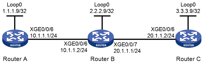

Example: Configuring RSVP GR
Router A, Router B, and Router C run IS-IS, and all of them are Layer 2 devices.
Use RSVP-TE to establish a TE tunnel from Router A to Router C.
Configure RSVP GR on the routers to ensure continuous forwarding when a router reboots.
Figure 3 Network diagram
1.     Configure IP addresses and masks for interfaces. (Details not shown.)
2.     Configure IS-IS to advertise interface addresses, including the loopback interface address. (Details not shown.)
3.     Configure an LSR ID, enable MPLS, MPLS TE, RSVP, and RSVP hello:
# Configure Router A.
<RouterA> system-view
[RouterA] mpls lsr-id 1.1.1.9
[RouterA] mpls te
[RouterA-te] quit
[RouterA] rsvp
[RouterA-rsvp] quit
[RouterA] interface ten-gigabitethernet 0/0/6
[RouterA-Ten-GigabitEthernet0/0/6] mpls enable
[RouterA-Ten-GigabitEthernet0/0/6] mpls te enable
[RouterA-Ten-GigabitEthernet0/0/6] rsvp enable
[RouterA-Ten-GigabitEthernet0/0/6] rsvp hello enable
[RouterA-Ten-GigabitEthernet0/0/6] quit
# Configure Router B.
<RouterB> system-view
[RouterB] mpls lsr-id 2.2.2.9
[RouterB] mpls te
[RouterB-te] quit
[RouterB] rsvp
[RouterB] quit
[RouterB] interface ten-gigabitethernet 0/0/6
[RouterB-Ten-GigabitEthernet0/0/6] mpls enable
[RouterB-Ten-GigabitEthernet0/0/6] mpls te enable
[RouterB-Ten-GigabitEthernet0/0/6] rsvp enable
[RouterB-Ten-GigabitEthernet0/0/6] rsvp hello enable
[RouterB-Ten-GigabitEthernet0/0/6] quit
[RouterB] interface ten-gigabitethernet 0/0/7
[RouterB-Ten-GigabitEthernet0/0/7] mpls enable
[RouterB-Ten-GigabitEthernet0/0/7] mpls te enable
[RouterB-Ten-GigabitEthernet0/0/7] rsvp enable
[RouterB-Ten-GigabitEthernet0/0/7] rsvp hello enable
[RouterB-Ten-GigabitEthernet0/0/7] quit
# Configure Router C.
<RouterC> system-view
[RouterC] mpls lsr-id 3.3.3.9
[RouterC] mpls te
[RouterC-te] quit
[RouterC] rsvp
[RouterC-rsvp] rsvp
[RouterC-mpls] interface ten-gigabitethernet 0/0/6
[RouterC-Ten-GigabitEthernet0/0/6] mpls enable
[RouterC-Ten-GigabitEthernet0/0/6] mpls te enable
[RouterC-Ten-GigabitEthernet0/0/6] rsvp enable
[RouterC-Ten-GigabitEthernet0/0/6] rsvp hello enable
[RouterC-Ten-GigabitEthernet0/0/6] quit
4.     Configure IS-IS TE. (Details not shown.)
5.     Configure an MPLS TE tunnel. (Details not shown.)
6.     Configure RSVP GR:
[RouterA] rsvp
[RouterA-rsvp] graceful-restart enable
[RouterB] rsvp
[RouterB-rsvp] graceful-restart enable
[RouterC] rsvp
[RouterC-rsvp] graceful-restart enable
After a tunnel is established from Router A to Router C, display detailed RSVP neighbor information on Router A.
<RouterA> display rsvp peer verbose
Peer: 10.1.1.2                            Interface: XGE0/0/6
Hello state: Up                           Hello type: Active
P2P PSB count: 0                          P2P RSB count: 1
P2MP PSB count: 0                         P2MP RSB count: 0
Src instance: 0x1f08                      Dst instance: 0x22
Summary refresh: Disabled                 Graceful Restart state: Ready
Peer GR restart time: 120000 ms           Peer GR recovery time: 0 ms
The output shows that the neighbor's GR state is Ready.
