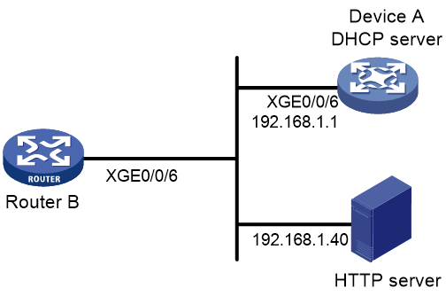

As shown in Figure 1, server-based automatic configuration requires the following servers:
·     DHCP server.
·     File server (TFTP or HTTP server).
·     (Optional.) DNS server.
Figure 1 Server-based automatic configuration network diagram

Example: Using an HTTP server and Tcl scripts for automatic configuration
As shown in Figure 3, Router B does not have a configuration file.
Configure the servers so Router B can obtain a Tcl script to complete the following configuration tasks:
·     Enable the administrator to Telnet to Router B to manage Router B.
·     Require the administrator to enter the correct username and password at login.
Figure 3 Network diagram
1.     Configure the DHCP server:
# Enable DHCP.
<RouterA> system-view
[RouterA] dhcp enable
# Configure address pool 1 to assign IP addresses on the 192.168.1.0/24 subnet to clients.
[RouterA] dhcp server ip-pool 1
[RouterA-dhcp-pool-1] network 192.168.1.0 24
# Specify the URL of the script file for the clients.
[RouterA-dhcp-pool-1] bootfile-name http://192.168.1.40/device.tcl
2.     Configure the HTTP server:
# Create a configuration file named device.tcl on the HTTP server.
telnet server enable
local-user user
password simple abc12345678
authorization-attribute user-role network-admin
service-type telnet
user-interface vty 0 63
authentication-mode scheme
interface ten-gigabitethernet 0/0/6
port link-mode route
ip address dhcp-alloc
return
# Start HTTP service software and enable HTTP service. (Details not shown.)
1.     Power on Router B.
2.     After Router B starts up, display assigned IP addresses on Router A.
<RouterA> display dhcp server ip-in-use
IP address       Client identifier/    Lease expiration      Type
                 Hardware address
192.168.1.2      0030-3030-632e-3239-  Jan 12 17:41:15 2020  Auto(C)
                 3035-2e36-3736-622d-
                 4574-6830-2f30-2f32
3.     Telnet to 192.168.1.2 from Router A.
<RouterA> telnet 192.168.1.2

Example: Using an HTTP server and Python scripts for automatic configuration
As shown in Figure 4, Router B does not have a configuration file.
Configure the servers so Router B can obtain a Python script to complete the following configuration tasks:
Figure 4 Network diagram
# Enable DHCP.
[RouterA-dhcp-pool-1] bootfile-name http://192.168.1.40/device.py
# Create a configuration file named device.py on the HTTP server.
#!usr/bin/python
import comware
comware.CLI(‘system-view ;telnet server enable ;local-user user ;password simple abc12345678 ;authorization-attribute user-role network-admin ;service-type telnet ;quit ;user-interface vty 0 63 ;authentication-mode scheme ;user-role network-admin ;quit ;interface ten-gigabitethernet 0/0/6 ;port link-mode route ;ip address dhcp-alloc ;return’)
                 Hardware address
                 4574-6830-2f30-2f32
4.     Enter username user and password abc12345678 as prompted. (Details not shown.)
You are logged in to Router B.
