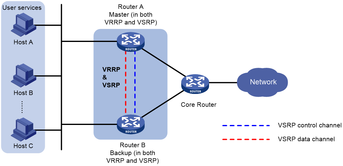

VRRP collaboration
As shown in Figure 1, VSRP determines the roles of the peer devices in the VSRP group in consistent with their roles in the VRRP group. The master forwards traffic and backs up the services to the backup device either at a regular interval or when traffic reaches the specified threshold. When the master in the VSRP group fails, the backup takes over to ensure service continuity. For more information about VRRP, see "Configuring VRRP."

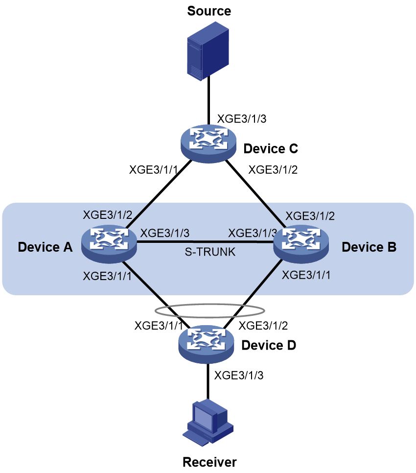

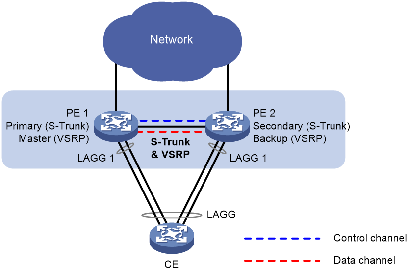

S-Trunk collaboration
To use S-Trunk together with VSRP, you must configure the same smart trunk on the peers in a VSRP group. As shown in Figure 2, VSRP determines the roles of the peer devices in the VSRP group based on their roles in the S-Trunk system. The VSRP master is the primary S-Trunk member device, and the VSRP backup is the secondary S-Trunk member device. The master forwards traffic and backs up the services to the backup device. When the master in the VSRP group fails, the backup takes over to ensure service continuity. For more information about S-Trunk, see "Configuring S-Trunk."
Figure 2 VSRP-S-Trunk collaboration

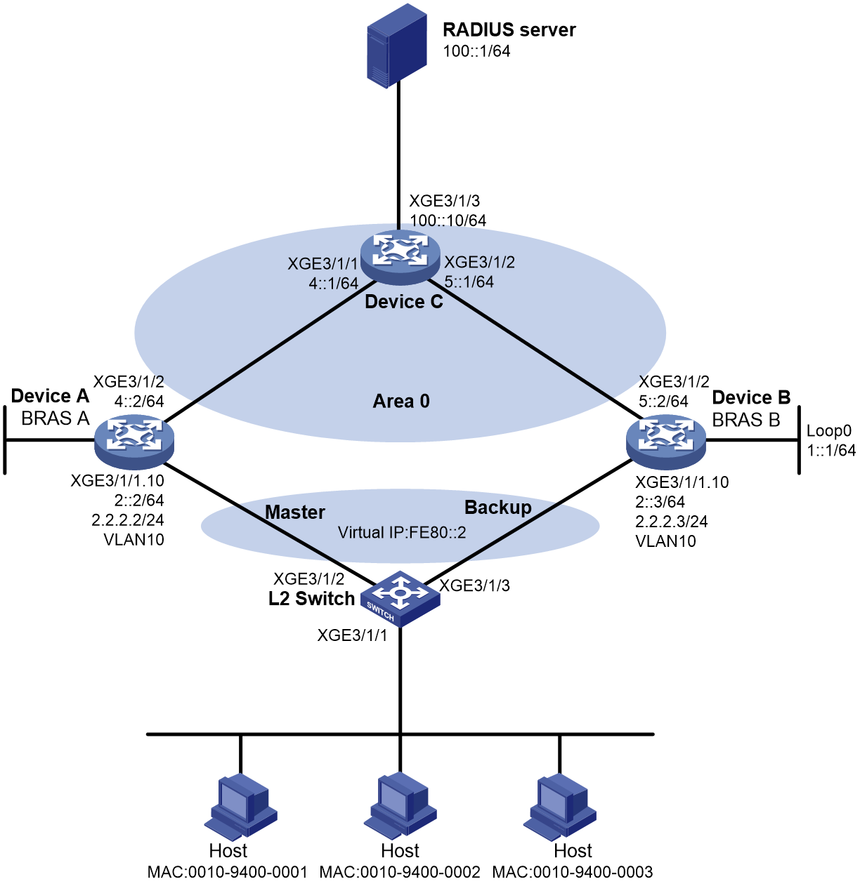

Example: Configuring VSRP for IPoE (IPv4 address pool)
As shown in Figure 3, the hosts use IPoE to access the BRAS devices (Device A and Device B). The two BRAS devices are in a VSRP group. IPv4 address pool 1 is enabled on the BRAS devices. The hosts obtain IP addresses through DHCP from the master. Perform the following tasks:
·     Enable IPoE and enable the DHCPv4 user on Ten-GigabitEthernet 3/1/1 of both Device A and Device B.
·     Create VRRP group 1 on Ten-GigabitEthernet 3/1/1.10, and configure the subinterface to terminate VLAN-tagged packets whose outermost VLAN ID is 10.
·     Enable OSPF on Device A and Device B to ensure that they can learn and advertise routes on their uplinks.

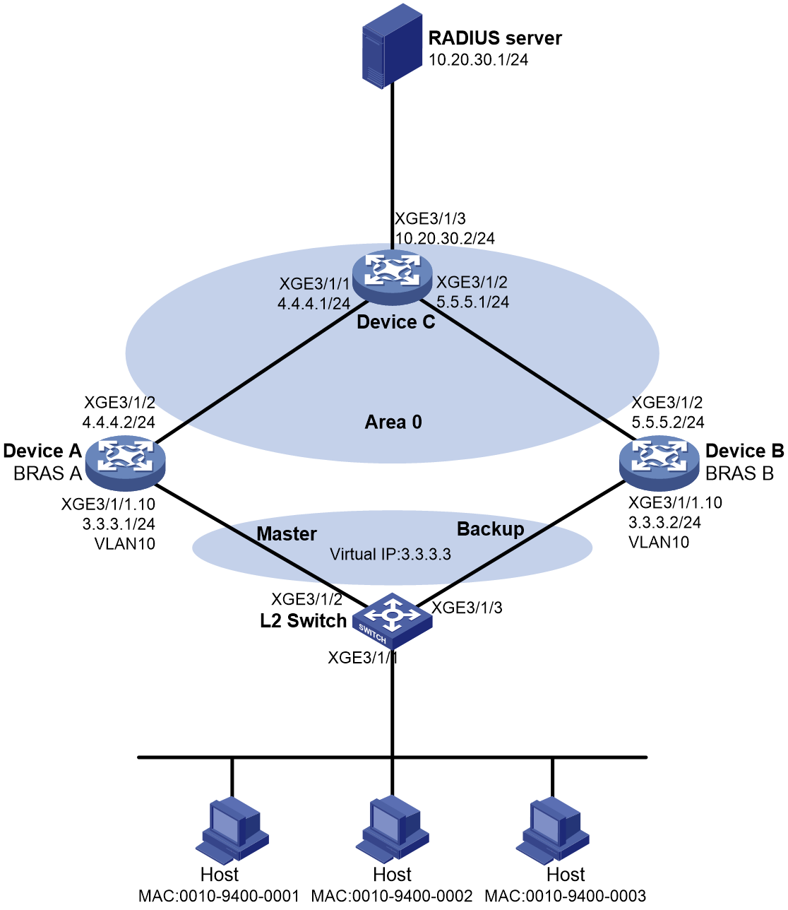

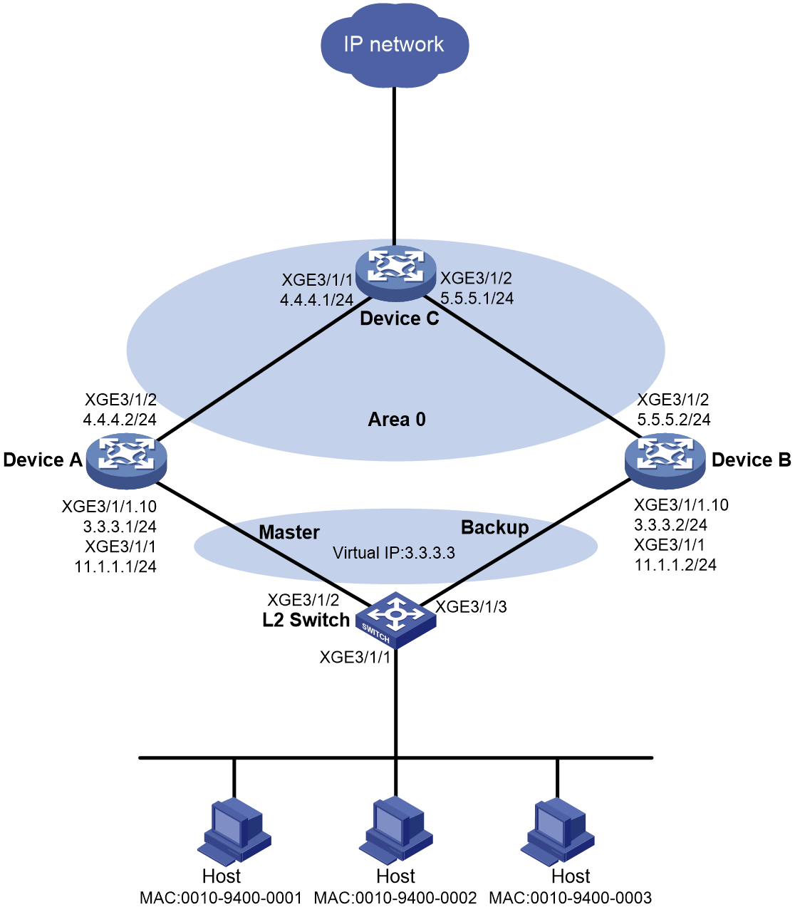

·     Enable VSRP for IPoE to back up IPoE sessions in real time.
·     Use the RADIUS server for authentication, authorization, and accounting of IPoE users.
Figure 3 Network diagram
1.     Assign IP addresses to interfaces, as shown in Figure 3. (Details not shown.)
2.     Configure the RADIUS server (this example uses a FreeRADIUS server that runs on Linux):
# Add the NAS IP address and shared key configuration to the clients.conf configuration file. (The NAS IP addresses for the two clients are 4.4.4.2 and 5.5.5.2, respectively, and the shared key is radius.)
client 3.3.3.3/32 {
ipaddr = 3.3.3.3
netmask=32
secret=radius
# Add the IPoE user configuration to the users file. (The MAC addresses of the three IPoE users are 0010-9400-0001, 0010-9400-0002, and 0010-9400-0003. The password is radius, and the name of the authorized address pool is 1.)
001094000001  Cleartext-Password :="radius"
              Framed-Pool = 1
001094000002  Cleartext-Password :="radius"
              Framed-Pool = 1
001094000003  Cleartext-Password :="radius"
              Framed-Pool = 1
3.     Configure Device A:
a.     Configure a VRRP group:
# Enter Ten-GigabitEthernet 3/1/1.10 interface view.
<DeviceA> system-view
[DeviceA] interface ten-gigabitethernet 3/1/1.10
# Create VRRP group 1 and set its virtual IP address to 3.3.3.3.
[DeviceA–Ten-GigabitEthernet3/1/1.10] vrrp vrid 1 virtual-ip 3.3.3.3
# Configure Ten-GigabitEthernet 3/1/1.10 to terminate VLAN 10.
[DeviceA-Ten-GigabitEthernet3/1/1.10] vlan-type dot1q vid 10
# Set the priority of Device A to 250 in VRRP group 1 on Ten-GigabitEthernet 3/1/1.10. Device A is assigned a higher priority than Device B in VRRP group 1, so Device A can become the master.
[DeviceA-Ten-GigabitEthernet3/1/1.10] vrrp vrid 1 priority 250
# Configure Device A to operate in preemptive mode, and set the preemption delay to 90000 centiseconds (15 minutes). When the original master recovers, it has 15 minutes to synchronize data from the new master before switch-back to ensure stability and data consistency of the VRRP group.
[DeviceA–Ten-GigabitEthernet3/1/1.10] vrrp vrid 1 preempt-mode delay 90000
[DeviceA–Ten-GigabitEthernet3/1/1.10] quit
# Create track entry 1 to monitor the link status of uplink interface Ten-GigabitEthernet 3/1/2. When the uplink fails, the track entry transits to Negative state.
[DeviceA] track 1 interface ten-gigabitethernet 3/1/2
# Associate VRRP group 1 on Ten-GigabitEthernet 3/1/1.10 with track entry 1, and decrease the device priority by 200 when the state of track entry 1 changes to Negative.
[DeviceA-Ten-GigabitEthernet3/1/1.10] vrrp vrid 1 track 1 priority reduced 200
[DeviceA-Ten-GigabitEthernet3/1/1.10] quit
b.     Configure VSRP instance vs1:
# Create VSRP group pr1 and enter VSRP peer view.
[DeviceA] vsrp peer pr1
# Specify the local IP address as 4.4.4.2 and the peer IP address as 5.5.5.2 for VSRP to establish VSRP channels. The default TCP port number for the control channel is used.
[DeviceA-vsrp-peer-pr1] peer 5.5.5.2 local 4.4.4.2
[DeviceA-vsrp-peer-pr1] quit
# Create VSRP instance vs1 and enter its view.
[DeviceA] vsrp instance vs1
# Associate VSRP instance vs1 with VSRP group pr1 and set its backup ID to 1.
[DeviceA-vsrp-instance-vs1] backup id 1 peer pr1
# Bind VSRP instance vs1 to VRRP group 1 on Ten-GigabitEthernet 3/1/1.10.
[DeviceA-vsrp-instance-vs1] bind vrrp vrid 1 interface ten-gigabitethernet 3/1/1.10
# Specify the logical NAS IP address as 3.3.3.3.
[DeviceA-vsrp-instance-vs1] nas ip 3.3.3.3
# Specify the logical interface as Ten-GigabitEthernet 3/1/2.
[DeviceA-vsrp-instance-vs1] nas port ten-gigabitethernet 3/1/2
[DeviceA-vsrp-instance-vs1] quit
c.     Configure a RADIUS scheme:
# Create a RADIUS scheme named rs1 and enter RADIUS scheme view.
[DeviceA] radius scheme rs1
# Specify the primary authentication server and primary accounting server.
[DeviceA-radius-rs1] primary authentication 10.20.30.1
[DeviceA-radius-rs1] primary accounting 10.20.30.1
# Set the shared key for secure RADIUS authentication and accounting communication.
[DeviceA-radius-rs1] key authentication simple radius
[DeviceA-radius-rs1] key accounting simple radius
# Configure Device A to remove the domain name in the username sent to the RADIUS servers for RADIUS scheme rs1.
[DeviceA-radius-rs1] user-name-format without-domain
# Specify the source IP address as 3.3.3.3 (the gateway address for the hosts) for outgoing RADIUS packets.
[DeviceA-radius-rs1] nas-ip 3.3.3.3
[DeviceA-radius-rs1] quit
# Enable the session-control feature.
[DeviceA] radius session-control enable
d.     Configure an authentication domain:
# Create ISP domain dm1 and enter ISP domain view.
[DeviceA] domain name dm1
# Configure the domain to use RADIUS scheme rs1 for authentication, authorization, and accounting for IPoE users.
[DeviceA-isp-dm1] authentication ipoe radius-scheme rs1
[DeviceA-isp-dm1] authorization ipoe radius-scheme rs1
[DeviceA-isp-dm1] accounting ipoe radius-scheme rs1
[DeviceA-isp-dm1] quit
e.     Configure the DHCP server:
# Enable DHCP.
[DeviceA] dhcp enable
[DeviceA] dhcp server request-ip-address check
# Create IPv4 address pool 1 and associate the pool with VSRP instance vs1.
[DeviceA] ip pool 1
[DeviceA-ip-pool-1] vsrp-instance vs1
# Assign gateway address 3.3.3.3 to the hosts, and export the host route destined for the hosts and the route destined for 3.3.3.0/24.
[DeviceA-ip-pool-1] network 3.3.3.0 mask 255.255.255.0 export-route
[DeviceA-ip-pool-1] gateway-list 3.3.3.3 export-route
# Exclude addresses from dynamic allocation.
[DeviceA-ip-pool-1] forbidden-ip 3.3.3.1 3.3.3.2 3.3.3.3
[DeviceA-ip-pool-1] quit
f.     Configure IPoE authentication on Ten-GigabitEthernet 3/1/1:
# Enter Ten-GigabitEthernet 3/1/1 interface view.
# Enable IPoE and specify Layer 2 access mode.
[DeviceA–Ten-GigabitEthernet3/1/1] ip subscriber l2-connected enable
# Configure ISP domain dm1 for DHCPv4 users.
[DeviceA–Ten-GigabitEthernet3/1/1] ip subscriber dhcp domain dm1
# Set the password to radius in plain text for the dynamic IPoE users.
[DeviceA–Ten-GigabitEthernet3/1/1] ip subscriber password plaintext radius
# Associate Ten-GigabitEthernet 3/1/1 with VSRP instance vs1.
[DeviceA–Ten-GigabitEthernet3/1/1] bras vsrp-instance vs1
[DeviceA–Ten-GigabitEthernet3/1/1] dhcp vsrp-instance vs1
[DeviceA–Ten-GigabitEthernet3/1/1] quit
# Enable unclassified-IPv4 packet initiation.
[DeviceA–Ten-GigabitEthernet3/1/1] ip subscriber initiator unclassified-ip enable matching-user
# Enable ARP packet initiation.
[DeviceA–Ten-GigabitEthernet3/1/1] ip subscriber initiator arp enable
# Specify TCP port 1025 for VSRP to establish data channels for IPoE session backup (not required if the default port is used).
[DeviceA] bras vsrp-port 1025
g.     Configure OSPF:
# Enable OSPF process 1 and set its router ID to 4.4.4.2 (the IP address of Ten-GigabitEthernet 3/1/2).
[DeviceA] ospf 1 router-id 4.4.4.2
# Configure OSPF to redistribute the user network route filtered by routing policy 1. Device A then advertises the user network route destined for the subnet where the hosts reside to Device C. In this way, Device C can select the route to a host based on the state of Device A and Device B in the VSRP instance.
[DeviceA-ospf-1] import-route unr inherit-cost route-policy 1
[DeviceA-ospf-1] quit
# Configure routing policy 1 to permit routes destined for network 3.3.3.0/24.
[DeviceA] ip prefix-list 1 permit 3.3.3.0 24
[DeviceA] route-policy 1 permit node 1
[DeviceA-route-policy-1-1] if-match ip address prefix-list 1
[DeviceA-route-policy-1-1] quit
# Create Area 0 and specify Ten-GigabitEthernet 3/1/2 whose IP address is on network 4.4.4.0/24 to run OSPF in Area 0.
[DeviceA] ospf
[DeviceA-ospf-1] area 0.0.0.0
[DeviceA-ospf-1-area-0.0.0.0] network 4.4.4.0 0.0.0.255
4.     Configure Device B:
<DeviceB> system-view
[DeviceB] interface ten-gigabitethernet 3/1/1.10
[DeviceB–Ten-GigabitEthernet3/1/1.10] vrrp vrid 1 virtual-ip 3.3.3.3
[DeviceB-Ten-GigabitEthernet3/1/1.10] vlan-type dot1q vid 10
# Set the priority of Device B to 200 in VRRP group 1 on Ten-GigabitEthernet 3/1/1.10. Device B is assigned a lower priority than Device A in VRRP group 1, so Device A can become the master.
[DeviceB-Ten-GigabitEthernet3/1/1.10] vrrp vrid 1 priority 200
# Configure Device B to operate in preemptive mode without setting the preemption delay. When the priority of the master decreases in the VRRP group, the backup can immediately take over as the new master for service continuity.
[DeviceB–Ten-GigabitEthernet3/1/1.10] vrrp vrid 1 preempt-mode
[DeviceB–Ten-GigabitEthernet3/1/1.10] quit
[DeviceB] vsrp peer pr1
# Specify the local IP address as 5.5.5.2 and the peer IP address as 4.4.4.2 for VSRP to establish VSRP channels. The default TCP port number for the control channel is used.
[DeviceB-vsrp-peer-pr1] peer 4.4.4.2 local 5.5.5.2
[DeviceB-vsrp-peer-pr1] quit
[DeviceB] vsrp instance vs1
[DeviceB-vsrp-instance-vs1] backup id 1 peer pr1
[DeviceB-vsrp-instance-vs1] bind vrrp vrid 1 interface ten-gigabitethernet 3/1/1.10
[DeviceB-vsrp-instance-vs1] nas ip 3.3.3.3
[DeviceB-vsrp-instance-vs1] nas port ten-gigabitethernet 3/1/2
[DeviceB-vsrp-instance-vs1] quit
[DeviceB] radius scheme rs1
[DeviceB-radius-rs1] primary authentication 10.20.30.1
[DeviceB-radius-rs1] primary accounting 10.20.30.1
[DeviceB-radius-rs1] key authentication simple radius
[DeviceB-radius-rs1] key accounting simple radius
# Configure Device B to remove the domain name in the username sent to the RADIUS servers for RADIUS scheme rs1.
[DeviceB-radius-rs1] user-name-format without-domain
[DeviceB-radius-rs1] nas-ip 3.3.3.3
[DeviceB-radius-rs1] quit
[DeviceB] radius session-control enable
[DeviceB] domain name dm1
[DeviceB-isp-dm1] authentication ipoe radius-scheme rs1
[DeviceB-isp-dm1] authorization ipoe radius-scheme rs1
[DeviceB-isp-dm1] accounting ipoe radius-scheme rs1
[DeviceB-isp-dm1] quit
# Enable DHCP.
[DeviceB] dhcp enable
[DeviceB] dhcp server request-ip-address check
[DeviceB] ip pool 1
[DeviceB-ip-pool-1] vsrp-instance vs1
[DeviceB-ip-pool-1] network 3.3.3.0 mask 255.255.255.0 export-route
[DeviceB-ip-pool-1] gateway-list 3.3.3.3 export-route
[DeviceB-ip-pool-1] forbidden-ip 3.3.3.1 3.3.3.2 3.3.3.3
[DeviceB-ip-pool-1] quit
[DeviceB–Ten-GigabitEthernet3/1/1] ip subscriber l2-connected enable
[DeviceB–Ten-GigabitEthernet3/1/1] ip subscriber dhcp domain dm1
[DeviceB–Ten-GigabitEthernet3/1/1] ip subscriber password plaintext radius
[DeviceB–Ten-GigabitEthernet3/1/1] bras vsrp-instance vs1
[DeviceB–Ten-GigabitEthernet3/1/1] dhcp vsrp-instance vs1
[DeviceB–Ten-GigabitEthernet3/1/1] quit
[DeviceB–GigabitEthernet1/0/1] ip subscriber initiator unclassified-ip enable matching-user
[DeviceB–GigabitEthernet1/0/1] ip subscriber initiator arp enable
[DeviceB–GigabitEthernet1/0/1] quit
# Specify TCP port number 1025 for VSRP to establish data channels for IPoE session backup (not required if the default port is used).
[DeviceB] bras vsrp-port 1025
g.     Configure OSPF:
# Enable OSPF process 1 and set its router ID to 5.5.5.2 (the IP address of Ten-GigabitEthernet 3/1/2).
[DeviceB] ospf 1 router-id 5.5.5.2
# Configure OSPF to redistribute the user network route filtered by routing policy 1. Device B then advertises the user network route destined for the subnet where the hosts reside to Device C. In this way, Device C can select the route to a host based on the state of Device A and Device B in the VSRP instance.
[DeviceB-ospf-1] import-route unr inherit-cost route-policy 1
[DeviceB-ospf-1] quit
[DeviceB] ip prefix-list 1 permit 3.3.3.0 24
[DeviceB] route-policy 1 permit node 1
[DeviceB-route-policy-1-1] if-match ip address prefix-list 1
[DeviceB-route-policy-1-1] quit
# Create Area 0 and specify Ten-GigabitEthernet 3/1/2 whose IP address is on network 5.5.5.0/24 to run OSPF in Area 0.
[DeviceB] ospf
[DeviceB-ospf-1] area 0.0.0.0
[DeviceB-ospf-1-area-0.0.0.0] network 5.5.5.0 0.0.0.255
5.     Configure Device C:
# Enable OSPF process 1 and set its router ID to 4.4.4.1 (the IP address of Ten-GigabitEthernet 3/1/1).
<DeviceC> system-view
[DeviceC] ospf 1 router-id 4.4.4.1
# Configure OSPF Area 0.
[DeviceC-ospf-1] area 0.0.0.0
[DeviceC-ospf-1-area-0.0.0.0] network 4.4.4.0 0.0.0.255
[DeviceC-ospf-1-area-0.0.0.0] network 5.5.5.0 0.0.0.255
[DeviceC-ospf-1-area-0.0.0.0] quit
[DeviceC-ospf-1] quit
6.     Configure the L2 Switch:
a.     Create VLAN 10.
<L2Switch> system-view
[L2Switch] vlan 10
[L2Switch-vlan10] quit
b.     Configure VLAN settings on the interfaces that connect to Device A and Device B:
# Assign Ten-GigabitEthernet 3/1/2 to VLAN 10.
[L2Switch] interface ten-gigabitethernet 3/1/2
[L2Switch-Ten-GigabitEthernet3/1/2] port link-type trunk
[L2Switch-Ten-GigabitEthernet3/1/2] port trunk permit vlan 10
[L2Switch-Ten-GigabitEthernet3/1/2] quit
# Assign Ten-GigabitEthernet 3/1/3 to VLAN 10.

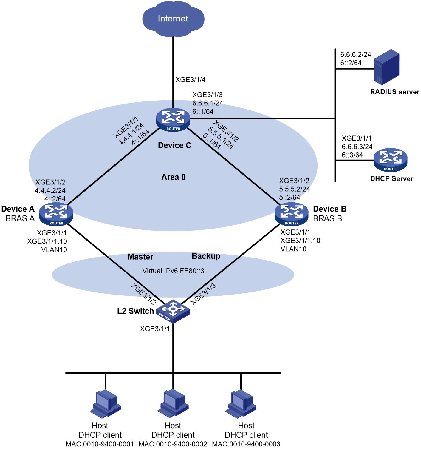

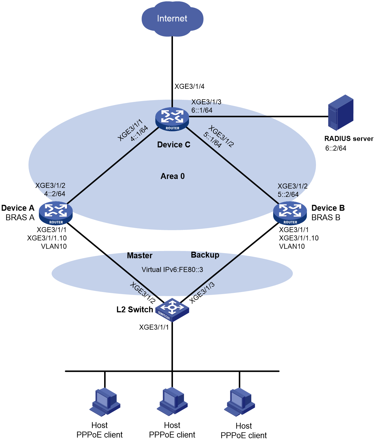

Example: Configuring VSRP for IPoE (IPv6 address pool)
As shown in Figure 4, the hosts use IPoE to access the BRAS devices (Device A and Device B). The two BRAS devices are in a VSRP group. IPv6 address pool 1 is enabled on the BRAS devices. The hosts obtain IP addresses through DHCP from the master. Perform the following tasks:
·     Enable IPoE and enable the DHCPv6 user on Ten-GigabitEthernet 3/1/1 of both Device A and Device B.
Figure 4 Network diagram
1.     Assign IPv6 addresses to interfaces, as shown in Figure 4. (Details not shown.)
# Add the NAS IP address and shared key configuration to the clients.conf configuration file. (The NAS IP address for the client is 1::1/128, and the shared key is radius.)
client 1::1/128 {
ipaddr = 1::1
netmask=128
secret=radius
              Framed-IPV6-Pool = 1
[DeviceA–Ten-GigabitEthernet3/1/1.10] vlan-type dot1q vid 10
# Create IPv6 VRRP group 1 and set its virtual IP address to fe80::2.
[DeviceA–Ten-GigabitEthernet3/1/1.10] vrrp ipv6 vrid 1 virtual-ip fe80::2 link-local
# Configure Ten-GigabitEthernet 3/1/1.10 to automatically generate a link-local address.
[DeviceA–Ten-GigabitEthernet3/1/1.10] ipv6 address auto link-local
[DeviceA-Ten-GigabitEthernet3/1/1.10] vrrp ipv6 vrid 1 priority 250
[DeviceA–Ten-GigabitEthernet3/1/1.10] vrrp ipv6 vrid 1 preempt-mode delay 90000
# Associate VRRP group 1 on Ten-GigabitEthernet 3/1/1.10 with track entry 1 and decrease the device priority by 200 when the state of track entry 1 changes to Negative.
[DeviceA-Ten-GigabitEthernet3/1/1.10] vrrp ipv6 vrid 1 track 1 priority reduced 200
# Specify the local IP address as 4::2 and the peer IP address as 5::2 for VSRP to establish VSRP channels. The default TCP port number for the control channel is used.
[DeviceA-vsrp-peer-pr1] peer ipv6 5::2 local 4::2
# Bind VSRP instance vs1 to IPv6 VRRP group 1 on Ten-GigabitEthernet 3/1/1.10.
[DeviceA-vsrp-instance-vs1] bind vrrp ipv6 vrid 1 interface ten-gigabitethernet 3/1/1.10
# Specify the logical host name as abc.
[DeviceA-vsrp-instance-vs1] nas id abc
[DeviceA-radius-rs1] primary authentication ipv6 100::1
[DeviceA-radius-rs1] primary accounting ipv6 100::1
# Specify the source IPv6 address as 1::1 for outgoing RADIUS packets.
[DeviceA-radius-rs1] nas-ip ipv6 1::1
# Configure authentication, authorization, and accounting methods for IPoE users.
e.     Configure a loopback interface:
# Create track entry 10 and associate it with IPv6 VRRP group 1.
[DeviceA] track 10 vrrp ipv6 interface gigabitethernet1/0/1.10 vrid 1
# Enable OSPFv3 process 1 and specify Area 0 on Loopback 0.
[DeviceA] interface loopback 0
[DeviceA-LoopBack0] ip addres 1::1/128
[DeviceA-LoopBack0] ipv6 route-direct track 10 degrade-cost 90
[DeviceA-LoopBack0] quit
f.     Configure the DHCPv6 server:
# Enable DHCP.
# Enable DHCPv6 server on Ten-GigabitEthernet 3/1/1.
[DeviceA–Ten-GigabitEthernet3/1/1] ipv6 dhcp select server
# Disable RA message suppression on Ten-GigabitEthernet 3/1/1.
[DeviceA–Ten-GigabitEthernet3/1/1] undo ipv6 nd ra halt
# Set the M flag to 1 and the O flag to 1 in RA advertisements to be sent. The receiving hosts can obtain IPv6 addresses and other configuration information from the DHCPv6 server.
[DeviceA–Ten-GigabitEthernet3/1/1] ipv6 nd autoconfig managed-address-flag
[DeviceA–Ten-GigabitEthernet3/1/1] ipv6 nd autoconfig other-flag
# Create address pool 1.
[DeviceA] ipv6 pool 1
# Specify subnet 3::/64 in address pool 1 and advertise the subnet.
[DeviceA-ipv6-pool-1] network 3::/64 export-route
[DeviceA-ipv6-pool-1] gateway-list 3::1
# Associate IPv6 address pool 1 with VSRP instance vs1.
[DeviceA-ipv6-pool-1] vsrp-instance vs1
# Configure IPv6 address pool 1 to use the virtual DUID generated based on enterprise number 2 and identifier ff.
[DeviceA-ipv6-pool-1] virtual-duid enterprise-number 2 identifier ff
[DeviceA-ipv6-pool-1] quit
# Exclude IPv6 address 3::1 from dynamic allocation.
[DeviceA-ipv6-pool-1] forbidden-address 3::1
g.     Specify a virtual IPv6 address for Ten-GigabitEthernet 3/1/1:
# Specify a virtual IPv6 address of fe80::100 for Ten-GigabitEthernet 3/1/1, and bind it to VSRP instance vs1.
[DeviceA–Ten-GigabitEthernet3/1/1] ipv6 virtual-address fe80::100 vsrp vs1
h.     Configure IPoE authentication on Ten-GigabitEthernet 3/1/1:
# Configure ISP domain dm1 for DHCPv6 users.
[DeviceA–Ten-GigabitEthernet3/1/1] ipv6 dhcp vsrp-instance vs1
# Enable unclassified-IPv6 packet initiation.
[DeviceA–Ten-GigabitEthernet3/1/1] subscriber initiator unclassified-ipv6 enable matching-user
# Specify TCP port 1026 for VSRP to establish data channels for IPoE session backup (not required if the default port is used).
[DeviceA] bras vsrp-port 1026
i.     Configure OSPFv3:
# Enable OSPFv3 process 1 and set its router ID to 1.1.1.1.
[DeviceA] ospfv3
[DeviceA-ospfv3-1]router-id 1.1.1.1
# Configure OSPFv3 to redistribute direct routes and use the original cost of redistributed routes.
[DeviceA-ospfv3-1] import-route direct inherit-cost
# Configure OSPFv3 to redistribute the user network route filtered by routing policy 1. Device A then advertises the user network route destined for the subnet where the hosts reside to Device C. In this way, Device C can select the route to a host based on the state of Device A and Device B in the VSRP instance.
[DeviceA-ospfv3-1] import-route unr inherit-cost route-policy 1
[DeviceA-ospfv3-1] quit
# Configure routing policy 1 to permit routes destined for network 3::/64.
[DeviceA] ipv6 prefix-list 1 permit 3:: 64
[DeviceA-route-policy-1-1] if-match ipv6 address prefix-list 1
# Enable OSPFv3 and specify Area 0 on Ten-GigabitEthernet 3/1/2.
[DeviceA] interface ten-gigabitethernet 3/1/2
[DeviceA–Ten-GigabitEthernet3/1/2] ospfv3 1 area 0
[DeviceA–Ten-GigabitEthernet3/1/2] quit
[DeviceB–Ten-GigabitEthernet3/1/1.10] vlan-type dot1q vid 10
[DeviceB–Ten-GigabitEthernet3/1/1.10] ipv6 address auto link-local
[DeviceB–Ten-GigabitEthernet3/1/1.10] vrrp ipv6 vrid 1 virtual-ip fe80::2 link-local
[DeviceB-Ten-GigabitEthernet3/1/1.10] vrrp ipv6 vrid 1 priority 200
[DeviceB–Ten-GigabitEthernet3/1/1.10] vrrp ipv6 vrid 1 preempt-mode
# Specify the local IP address as 5::2 and the peer IP address as 4::2 for VSRP to establish VSRP channels. The default TCP port number for the control channel is used.
[DeviceB-vsrp-peer-pr1] peer ipv6 4::2 local 5::2
[DeviceB-vsrp-instance-vs1] bind vrrp ipv6 vrid 1 interface ten-gigabitethernet 3/1/1.10
[DeviceB-vsrp-instance-vs1] nas id abc
[DeviceB-radius-rs1] primary authentication ipv6 100::1
[DeviceB-radius-rs1] primary accounting ipv6 100::1
[DeviceB] track 10 vrrp ipv6 interface gigabitethernet1/0/1.10 vrid 1

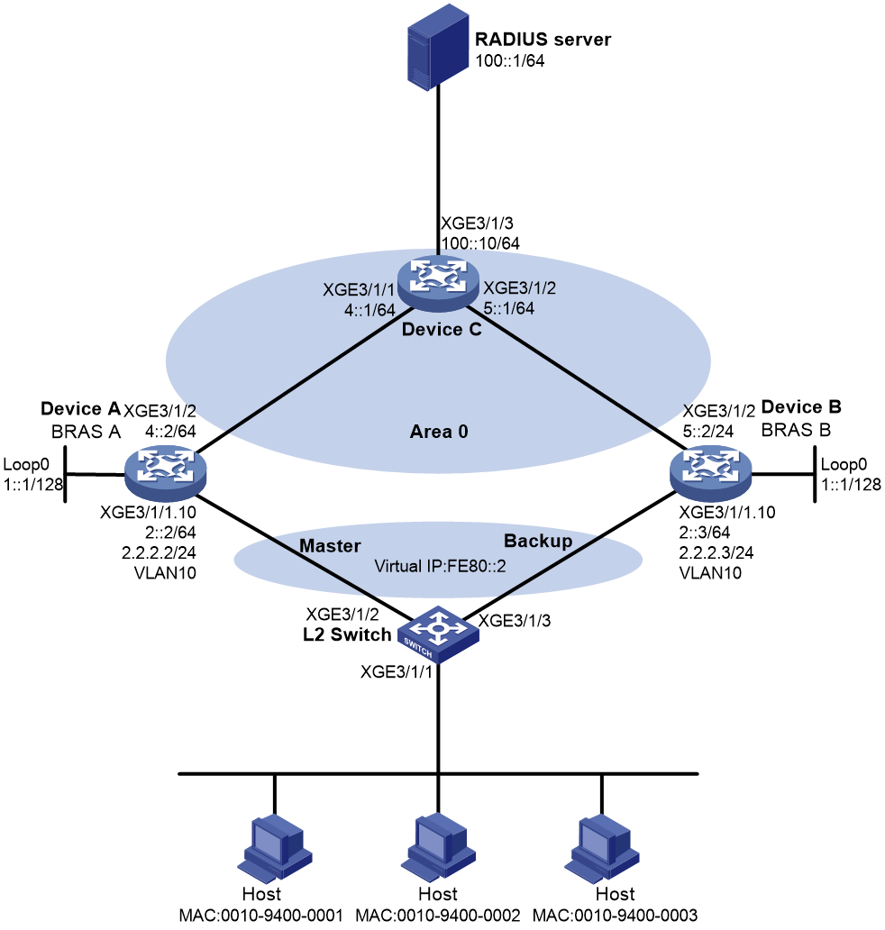

[DeviceB] interface loopback 0
[DeviceB-LoopBack0] ip addres 1::1/128
[DeviceB-LoopBack0] ipv6 route-direct track 10 degrade-cost 90
[DeviceB-LoopBack0] quit
[DeviceB] ospfv3 1
[DeviceB-ospfv3-1] import-route direct inherit-cost
[DeviceB-ospfv3-1] quit
# Enable DHCP.
[DeviceB–Ten-GigabitEthernet3/1/1] ipv6 dhcp select server
[DeviceB–Ten-GigabitEthernet3/1/1] undo ipv6 nd ra halt
[DeviceB–Ten-GigabitEthernet3/1/1] ipv6 nd autoconfig managed-address-flag
[DeviceB–Ten-GigabitEthernet3/1/1] ipv6 nd autoconfig other-flag
[DeviceB] ipv6 pool 1
[DeviceB-ipv6-pool-1] network 3::/64 export-route
[DeviceB-ipv6-pool-1] gateway-list 3::1
[DeviceB-ipv6-pool-1] vsrp-instance vs1
[DeviceB-ipv6-pool-1] virtual-duid enterprise-number 2 identifier ff
[DeviceB-ipv6-pool-1] quit
[DeviceB-ipv6-pool-1] forbidden-address 3::1
g.     Specify a virtual IPv6 address on Ten-GigabitEthernet 3/1/1:
[DeviceB–Ten-GigabitEthernet3/1/1] ipv6 virtual-address fe80::100 vsrp vs1
[DeviceB–Ten-GigabitEthernet3/1/1] ipv6 dhcp vsrp-instance vs1
[DeviceB–Ten-GigabitEthernet3/1/1] subscriber initiator unclassified-ipv6 enable matching-user
[DeviceB–Ten-GigabitEthernet3/1/1] ip subscriber initiator arp enable
[DeviceB] bras vsrp-port 1026
# Enable OSPFv3 process 1 and set its router ID to 2.2.2.2.
[DeviceB] ospfv3
[DeviceB-ospfv3-1]router-id 2.2.2.2
# Configure OSPFv3 to redistribute the user network route filtered by routing policy 1. Device B then advertises the user network route destined for the subnet where the hosts reside to Device C. In this way, Device C can select the route to a host based on the state of Device A and Device B in the VSRP instance.
[DeviceB-ospfv3-1] import-route unr inherit-cost route-policy 1
# Configure routing policy 1 to permit routes destined for network 3::/32.
[DeviceB] ipv6 prefix-list 1 permit 3:: 32
[DeviceB-route-policy-1-1] if-match ipv6 address prefix-list 1
[DeviceB] interface ten-gigabitethernet 3/1/2
[DeviceB–Ten-GigabitEthernet3/1/2] ospfv3 1 area 0
[DeviceB–Ten-GigabitEthernet3/1/2] quit
# Enable OSPFv3 process 1 and set its router ID to 3.3.3.3.
[DeviceC] ospfv3
[DeviceC-ospfv3-1] router-id 3.3.3.3
# Enable OSPFv3 process 1 and specify Area 0 on Ten-GigabitEthernet 3/1/3.
[DeviceC] interface ten-gigabitethernet 3/1/3
[DeviceC-Ten-GigabitEthernet3/1/3] ospfv3 1 area 0
[DeviceC-Ten-GigabitEthernet3/1/3] quit
# Enable OSPFv3 process 1 and specify Area 0 on Ten-GigabitEthernet 3/1/1.
[DeviceC] interface ten-gigabitethernet 3/1/1
[DeviceC–Ten-GigabitEthernet3/1/1] ospfv3 1 area 0
[DeviceC–Ten-GigabitEthernet3/1/1] quit
# Enable OSPFv3 process 1 and specify Area 0 on Ten-GigabitEthernet 3/1/2.
[DeviceC] interface ten-gigabitethernet 3/1/2
[DeviceC–Ten-GigabitEthernet3/1/2] ospfv1 1 area 0
[DeviceC–Ten-GigabitEthernet3/1/2] quit
a.     Create VLAN 10.
[L2Switch] vlan 10
[L2Switch] interface Ten-GigabitEthernet 3/1/3
[L2Switch-Ten-GigabitEthernet3/1/3] port link-type trunk
[L2Switch-Ten-GigabitEthernet3/1/3] port trunk permit vlan 10
[L2Switch-Ten-GigabitEthernet3/1/3] quit
# Verify that Device A and Device B have the same IPoE user information about authenticated IPoE users.
·     On the master:
[DeviceA] display access-user
UserID   Interface                IP address          MAC address    S-/C-VLAN
         Username                 Access type
         IPv6 address
0x1      XGE3/1/1                 -                   0010-9400-0001  -/-
         001094000001             L2 IPoE dynamic(-/D)
         3::1
0x2      XGE3/1/1                 -                   0010-9400-0002  -/-
         001094000002             L2 IPoE dynamic(-/D)
         3::2
0x3      XGE3/1/1                 -                   0010-9400-0003  -/-
         001094000003             L2 IPoE dynamic(-/D)
         3::3
·     On the backup:
[DeviceB] display access-user
         IPv6 address
         3::1
         3::2
         3::3

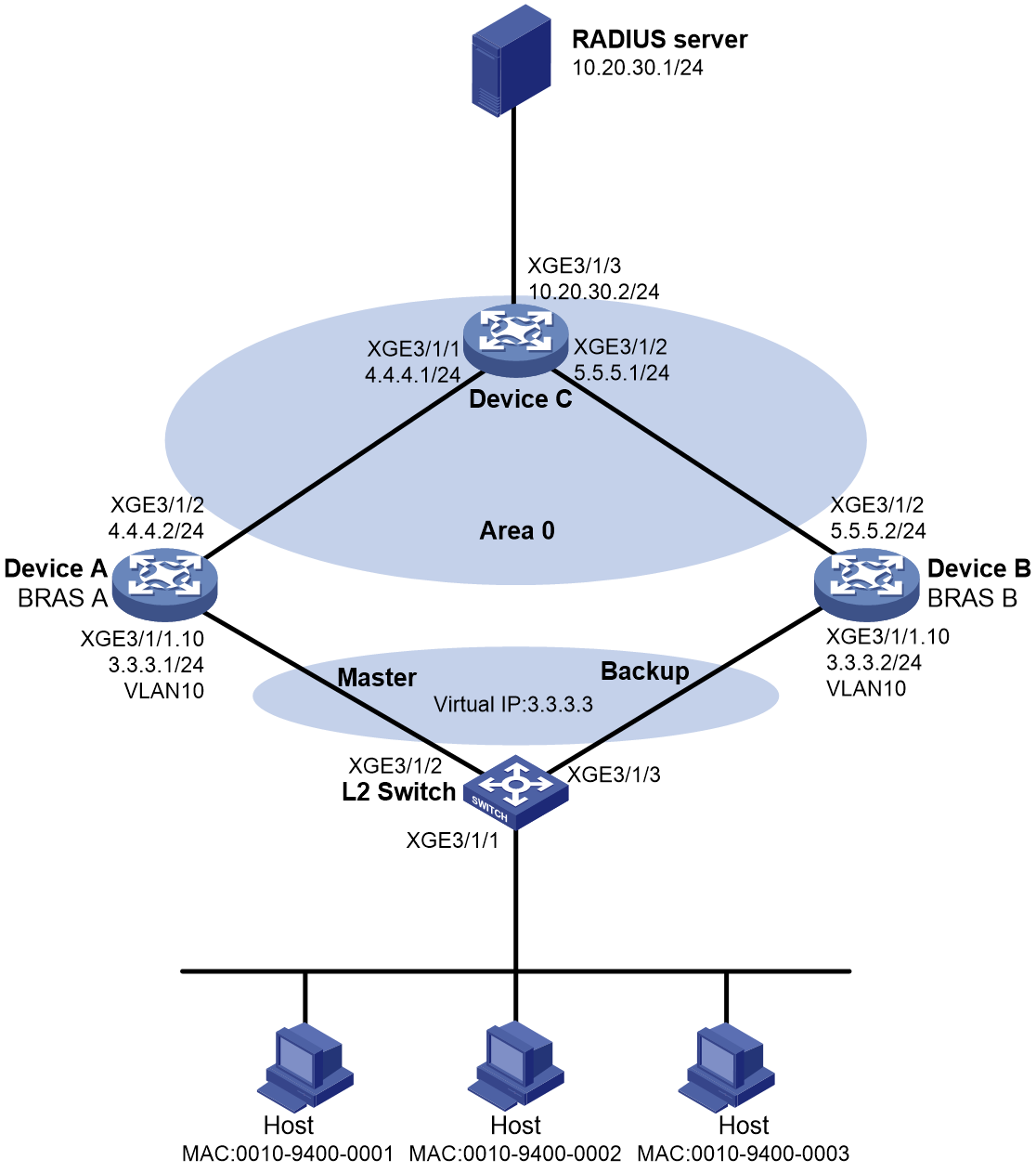

Example: Configuring VSRP for dual-stack IPoE (IPv4 and IPv6 address pools)
As shown in Figure 5, the hosts use IPoE to access BRAS A and BRAS B. The two BRAS devices are in a VSRP group. The hosts obtain IP addresses through DHCP from the master. Perform the following tasks:
·     Enable IPoE on Ten-GigabitEthernet 3/1/1 of both BRAS A and BRAS B.
·     Configure an IPv4 address pool and an IPv6 address pool on the BRAS devices.
·     Enable OSPF on BRAS A and BRAS B to ensure that they can learn and advertise routes on their uplinks.
Figure 5 Network diagram
1.     Assign IP addresses to interfaces, as shown in Figure 5. (Details not shown.)
2.     Configure the RADIUS server:
This example uses a FreeRADIUS server that runs on Linux.
# Add the NAS IP address and shared key configuration to the clients.conf configuration file. (The NAS IP address for the client is 3.3.3.3, and the shared key is 123456.)
client 3.3.3.3/32 {
ipaddr = 3.3.3.3
netmask=32
secret=123456
# Add the IPoE user configuration to the users file. (The MAC addresses of the three IPoE users are 0010-9400-0001, 0010-9400-0002, and 0010-9400-0003. The password is 123456.)
001094000001  Cleartext-Password :="123456"
001094000002  Cleartext-Password :="123456"
001094000003  Cleartext-Password :="123456"
3.     Configure the DHCP server:
This example uses a network device as the DHCP server. As a best practice, use a dedicated DHCP server.
a.     Configure the DHCPv4 server:
# Enable DHCP.
<DHCP> system-view
[DHCP] dhcp enable
# Enable the DHCP server to return a DHCP-NAK message if the client notions of their IP addresses are incorrect.
[DHCP] dhcp server request-ip-address check
# Create IPv4 address pool ipoev4 and enter its view.
[DHCP] ip pool ipoev4
# Assign subnet 3.3.3.0/24 to the hosts, and specify the gateway address and DNS server address.
[DHCP-ip-pool-ipoev4] network 3.3.3.0 24
[DHCP-ip-pool-ipoev4] gateway-list 3.3.3.3
[DHCP-ip-pool-ipoev4] dns-list 8.8.8.8
# Exclude the gateway address and the IP addresses of host-facing interfaces on the BRAS devices from dynamic allocation.
[DHCP-ip-pool-ipoev4] forbidden-ip 3.3.3.1
[DHCP-ip-pool-ipoev4] forbidden-ip 3.3.3.2
[DHCP-ip-pool-ipoev4] forbidden-ip 3.3.3.3
[DHCP-ip-pool-ipoev4] quit
# Configure a static route for the DHCPv4 server to reach the BRAS devices.
[DHCP] ip route-static 0.0.0.0 0 6.6.6.1
b.     Configure the DHCPv6 server:
[DHCP] interface ten-gigabitethernet 3/1/1
[DHCP–Ten-GigabitEthernet3/1/1] ipv6 dhcp select server
[DHCP–Ten-GigabitEthernet3/1/1] quit
# Create IPv6 address pool ipoev6 and enter its view.
[DHCP] ipv6 pool ipoev6
# Assign subnet 3::/64 to the hosts and specify DNS server address.
[DHCP-ipv6-pool-ipoev6] network 3::/64
[DHCP-ipv6-pool-ipoev6] dns-server 8::8
[DHCP-ipv6-pool-ipoev6] quit
[DHCP] ipv6 dhcp server forbidden-address 3::1
[DHCP] ipv6 dhcp server forbidden-address 3::2
[DHCP] ipv6 dhcp server forbidden-address 3::3
# Configure a static route for the DHCPv6 server to reach the BRAS devices.
[DHCP] ipv6 route-static 0::0 0 6::1
4.     Configure BRAS A:
a.     Configure an IPv6 VRRP group:
# Enter the view of Ten-GigabitEthernet 3/1/1.10.
<BRASA> system-view
[BRASA] interface ten-gigabitethernet 3/1/1.10
# Create IPv6 VRRP group 1 and set its virtual IP address to fe80::3.
[BRASA–Ten-GigabitEthernet3/1/1.10] vrrp ipv6 vrid 1 virtual-ip fe80::3 link-local
[BRASA–Ten-GigabitEthernet3/1/1.10] ipv6 address auto link-local
# Set the priority of BRAS A to 250 in VRRP group 1 on Ten-GigabitEthernet 3/1/1.10. BRAS A is assigned a higher priority than BRAS B in VRRP group 1, so BRAS A can become the master.
[BRASA-Ten-GigabitEthernet3/1/1.10] vrrp ipv6 vrid 1 priority 250
# Configure BRAS A to operate in preemptive mode, and set the preemption delay to 90000 centiseconds (15 minutes). When the original master recovers, it has 15 minutes to synchronize data from the new master before switch-back to ensure stability and data consistency of the VRRP group.
[BRASA–Ten-GigabitEthernet3/1/1.10] vrrp ipv6 vrid 1 preempt-mode delay 90000
[BRASA–Ten-GigabitEthernet3/1/1.10] quit
[BRASA] track 1 interface ten-gigabitethernet 3/1/2
[BRASA-track-1] quit
[BRASA-Ten-GigabitEthernet3/1/1.10] vrrp ipv6 vrid 1 track 1 priority reduced 200
[BRASA-Ten-GigabitEthernet3/1/1.10] vlan-type dot1q vid 10
[BRASA-Ten-GigabitEthernet3/1/1.10] quit
b.     Configure a VSRP instance:
When VSRP is enabled for IPoE, IPv4 and IPv6 users share a data backup channel. You can configure an IPv4 or IPv6 data backup channel for dual-stack IPoE. This example creates an IPv6 data backup channel.
[BRASA] vsrp peer pr1
[BRASA-vsrp-peer-pr1] peer ipv6 5::2 local 4::2
[BRASA-vsrp-peer-pr1] quit
[BRASA] vsrp instance vs1
[BRASA-vsrp-instance-vs1] backup id 1 peer pr1
[BRASA-vsrp-instance-vs1] bind vrrp ipv6 vrid 1 interface ten-gigabitethernet 3/1/1.10
[BRASA-vsrp-instance-vs1] nas id abc
[BRASA-vsrp-instance-vs1] nas port ten-gigabitethernet 3/1/2
# Enable route advertisement for the backup. Set the route costs for the master and the back to 20 and 30, respectively.
[BRASA-vsrp-instance-vs1] backup route-advertise master-cost 20 backup-cost 30
[BRASA-vsrp-instance-vs1] quit
[BRASA] radius scheme rs1
[BRASA-radius-rs1] primary authentication 6.6.6.2
[BRASA-radius-rs1] primary accounting 6.6.6.2
[BRASA-radius-rs1] key authentication simple 123456
[BRASA-radius-rs1] key accounting simple 123456
[BRASA-radius-rs1] nas-ip 3.3.3.3
[BRASA-radius-rs1] quit
d.     Configure DHCPv4 relay agent:
# Enable DHCP.
[BRASA] dhcp enable
# Configure remote BAS IPv4 address pool ipoev4 and associate the pool with VSRP instance vs1.
[BRASA] ip pool ipoev4 bas remote
[BRASA-ip-pool-ipoev4] gateway 3.3.3.3 24
[BRASA-ip-pool-ipoev4] forbidden-ip 3.3.3.3
[BRASA-ip-pool-ipoev4] remote-server 6.6.6.3
[BRASA-ip-pool-ipoev4] vsrp-instance vs1
[BRASA-ip-pool-ipoev4] quit
# Configure BRASA acting as the VSRP master device to export the user network route (UNR) of subnet 3.3.3.0/24 to the routing table, so that it can use OSPF to redistribute the UNR and advertise it to uplink Device C. Device C can then distribute all traffic destined for the subnet to the master BRAS device.
·     By default, in a VSRP environment, the master and backup BRAS devices both require configuring the gateway 3.3.3.0 24 command. Only the master device exports the corresponding subnet route. When the master devices changes to backup device, the exported subnet route will be deleted.
·     The BRAS device in this example also acts as a DHCPv4 relay agent. Configuring the gateway 3.3.3.0 24 command is only for exporting user subnet route 3.3.3.0/24 to the routing table for implementing traffic distribution through OSPF. The configuration is not for address allocation purposes.
[BRASA-Ten-GigabitEthernet3/1/1] dhcp vsrp-instance vs1
e.     Configure DHCPv6 relay agent:
# Disable RA message suppression on Ten-GigabitEthernet 3/1/1. Set the managed address configuration flag (M) to 1 and set the other stateful configuration flag (O) to 1 in RA advertisements to be sent.
[BRASA–Ten-GigabitEthernet3/1/1] undo ipv6 nd ra halt
[BRASA–Ten-GigabitEthernet3/1/1] ipv6 nd autoconfig managed-address-flag
[BRASA–Ten-GigabitEthernet3/1/1] ipv6 nd autoconfig other-flag
# Enable the DHCPv6 relay agent on Ten-GigabitEthernet 3/1/1.
[BRASA–Ten-GigabitEthernet3/1/1] ipv6 dhcp select relay
# Configure remote IPv6 address pool ipoev6 and associate the pool with VSRP instance vs1.
[BRASA] ipv6 pool ipoev6
[BRASA-ipv6-pool-ipoev6] gateway 3::3 24
[BRASA-ipv6-pool-ipoev6] forbidden-ip 3.3.3.3
[BRASA-ipv6-pool-ipoev6] remote-server 6::3
[BRASA-ipv6-pool-ipoev6] vsrp-instance vs1
[BRASA-ipv6-pool-ipoev6] quit
# Configure BRASB acting as the VSRP master device to export the UNR of subnet 3::/24 to the routing table, so that it can use OSPFv3 to redistribute the UNR and advertise it to uplink Device C. Device C can then distribute all traffic destined for the subnet to the master BRAS device.
·     By default, in a VSRP environment, the master and backup BRAS devices both require configuring the network 3::/24 export-route command. Only the master device exports the corresponding subnet route. When the master devices changes to backup device, the exported subnet route will be deleted.
·     The BRAS device in this example also acts as a DHCPv6 relay agent. Configuring the network 3::/64 export-route command is only for exporting user subnet route 3::/64 to the routing table for implementing traffic distribution through OSPFv3. The configuration is not for address allocation purposes.
[BRASB-ipv6-pool-ipoev6] network 3::/64 export-route
[BRASB-ipv6-pool-ipoev6] quit
[BRASA–Ten-GigabitEthernet3/1/1] ipv6 dhcp vsrp-instance vs1
[BRASA–Ten-GigabitEthernet3/1/1] quit
f.     Configure an authentication domain:
[BRASA] domain name dm1
[BRASA-isp-dm1] authentication ipoe radius-scheme rs1
[BRASA-isp-dm1] authorization ipoe radius-scheme rs1
[BRASA-isp-dm1] accounting ipoe radius-scheme rs1
# Configure an IPv4 address pool and an IPv6 address pool for users in the ISP domain.
[BRASA-isp-dm1] authorization-attribute ip-pool ipoev4
[BRASA-isp-dm1] authorization-attribute ipv6-pool ipoev6
[BRASA-isp-dm1] quit
g.     Configure OSPF:
# Enable OSPF process 1 and specify its router ID as 3.3.3.1 (the IP address of Ten-GigabitEthernet 3/1/1.10).
[BRASA] ospf 1 router-id 3.3.3.1
# Configure OSPF to redistribute the user network route filtered by routing policy 1. When BRAS A acts as the master and assigns an IP address to a host, it advertises the user network route destined for the subnet where the host resides to Device C. In this way, Device C can select the route to the host based on the state of BRAS A and BRAS B in the VSRP instance.
[BRASA-ospf-1] import-route unr inherit-cost inherit-cost route-policy 1
[BRASA-ospf-1] quit
# Configure routing policy 1 to permit routes destined for 3.3.3.0/24.
[BRASA] ip prefix-list 1 permit 3.3.3.0 24
[BRASA] route-policy 1 permit node 1
[BRASA-route-policy-1-1] if-match ip address prefix-list 1
[BRASA-route-policy-1-1] quit
# Configure Area 0.
[BRASA] ospf
[BRASA-ospf-1] area 0.0.0.0
[BRASA-ospf-1-area-0.0.0.0] network 4.4.4.0 0.0.0.255
[BRASA-ospf-1-area-0.0.0.0] quit
[BRASA-ospf-1] quit
h.     Configure OSPFv3:
# Enable OSPFv3 process 1 and specify its router ID as 3.3.3.1.
[BRASA] ospfv3
[BRASA-ospfv3-1] router-id 3.3.3.1
# Configure OSPFv3 to redistribute the user network route filtered by routing policy 1. BRAS A then advertises the user network route destined for the subnet where the host resides to Device C. In this way, Device C can select the route to the host based on the state of BRAS A and BRAS B in the VSRP instance.
[BRASA-ospfv3-1] import-route unr inherit-cost inherit-cost route-policy 1
[BRASA-ospfv3-1] quit
# Configure routing policy 1 to permit routes destined for 3::/64.
[BRASA] ipv6 prefix-list 1 permit 3:: 64
[BRASA-route-policy-1-1] if-match ipv6 address prefix-list 1
# Configure Area 0 on Ten-GigabitEthernet 3/1/2.
[BRASA] interface ten-gigabitethernet 3/1/2
[BRASA–Ten-GigabitEthernet3/1/2] ospfv3 1 area 0
[BRASA–Ten-GigabitEthernet3/1/2] quit
i.     Specify a virtual IPv6 address on Ten-GigabitEthernet 3/1/1:
# Specify a virtual IPv6 address of fe80::100 for Ten-GigabitEthernet 3/1/1, and bind it to VSRP instance vs1:.
[BRASA–Ten-GigabitEthernet3/1/1] ipv6 virtual-address fe80::100 vsrp vs1
j.     Configure IPoE authentication on Ten-GigabitEthernet 3/1/1:
[BRASA–Ten-GigabitEthernet3/1/1] ip subscriber l2-connected enable
# Configure ISP domain dm1 for DHCP users.
[BRASA–Ten-GigabitEthernet3/1/1] ip subscriber dhcp domain dm1
# Configure the source MAC addresses as authentication usernames for DHCP users.
[BRASA–Ten-GigabitEthernet3/1/1] ip subscriber dhcp username include source-mac
# Set the password to 123456 in plain text for the dynamic IPoE users.
[BRASA–Ten-GigabitEthernet3/1/1] ip subscriber password plaintext 123456
[BRASA–Ten-GigabitEthernet3/1/1] bras vsrp-instance vs1
5.     Configure BRAS B:
<BRASB> system-view
[BRASB] interface ten-gigabitethernet 3/1/1.10
[BRASB–Ten-GigabitEthernet3/1/1.10] vrrp ipv6 vrid 1 virtual-ip fe80::3 link-local
[BRASB–Ten-GigabitEthernet3/1/1.10] ipv6 address auto link-local
# Set the priority of BRAS B to 200 in VRRP group 1 on Ten-GigabitEthernet 3/1/1.10. BRAS A is assigned a higher priority than BRAS B in VRRP group 1, so BRAS A can become the master.
[BRASB-Ten-GigabitEthernet3/1/1.10] vrrp ipv6 vrid 1 priority 200
# Configure BRAS B to operate in preemptive mode without setting the preemption delay. When the priority of the master decreases in the VRRP group, the backup can immediately take over as the new master for service continuity.
[BRASB–Ten-GigabitEthernet3/1/1.10] vrrp ipv6 vrid 1 preempt-mode
[BRASB-Ten-GigabitEthernet3/1/1.10] vlan-type dot1q vid 10
[BRASB–Ten-GigabitEthernet3/1/1.10] quit
b.     Configure the track entry associated with the BFD session on Ten-GigabitEthernet 3/1/1.10:
# Create track entry 2 and associate it with a BFD session.
[BRASB] track 2 bfd echo interface ten-gigabitethernet 3/1/1.10 remote ip 3.3.3.1 local ip 3.3.3.2
[BRASB-track-2] quit
# Associate VRRP group 1 on Ten-GigabitEthernet 3/1/1.10 with track entry 2 and switch the master and the backup when the state of track entry 2 changes to Negative.
[BRASB–Ten-GigabitEthernet3/1/1.10] vrrp ipv6 vrid 1 track 2 switchover
c.     Configure a VSRP instance:
[BRASB] vsrp peer pr1
[BRASB-vsrp-peer-pr1] peer ipv6 4::2 local 5::2
[BRASB-vsrp-peer-pr1] quit
[BRASB] vsrp instance vs1
[BRASB-vsrp-instance-vs1] backup id 1 peer pr1
[BRASB-vsrp-instance-vs1] bind vrrp ipv6 vrid 1 interface ten-gigabitethernet 3/1/1.10
[BRASB-vsrp-instance-vs1] nas id abc
[BRASB-vsrp-instance-vs1] nas port ten-gigabitethernet 3/1/2
[BRASB-vsrp-instance-vs1] backup route-advertise master-cost 20 backup-cost 30
[BRASB-vsrp-instance-vs1] quit
d.     Configure a RADIUS scheme:
[BRASB] radius scheme rs1
[BRASB-radius-rs1] primary authentication 6.6.6.2
[BRASB-radius-rs1] primary accounting 6.6.6.2
[BRASB-radius-rs1] key authentication simple 123456
[BRASB-radius-rs1] key accounting simple 123456
# Specify the source IP address as 3.3.3.3 (the gateway address for hosts) for outgoing RADIUS packets.
[BRASB-radius-rs1] nas-ip 3.3.3.3
[BRASB-radius-rs1] quit
e.     Configure DHCPv4 relay agent:
# Enable DHCP.
[BRASB] dhcp enable
[BRASB] ip pool ipoev4 bas remote
[BRASB-ip-pool-ipoev4] gateway 3.3.3.3 24
[BRASB-ip-pool-ipoev4] forbidden-ip 3.3.3.3
[BRASB-ip-pool-ipoev4] remote-server 6.6.6.3
[BRASB-ip-pool-ipoev4] vsrp-instance vs1
[BRASB-ip-pool-ipoev4] quit
# Configure BRASB acting as the VSRP master device to export the UNR of subnet 3.3.3.0/24 to the routing table, so that it can use OSPF to redistribute the UNR and advertise it to uplink Device C. Device C can then distribute all traffic destined for the subnet to the master BRAS device.
[BRASB-Ten-GigabitEthernet3/1/1] dhcp relay vsrp-instance vs1
f.     Configure DHCPv6 relay agent:
[BRASB–Ten-GigabitEthernet3/1/1] undo ipv6 nd ra halt
[BRASB–Ten-GigabitEthernet3/1/1] ipv6 nd autoconfig managed-address-flag
[BRASB–Ten-GigabitEthernet3/1/1] ipv6 nd autoconfig other-flag
[BRASB–Ten-GigabitEthernet3/1/1] ipv6 dhcp select relay
[BRASB–Ten-GigabitEthernet3/1/1] quit
[BRASB] ipv6 pool ipoev6 bas remote
[BRASB-ipv6-pool-ipoev6] gateway-list 3::3
[BRASB-ipv6-pool-ipoev6] remote-server 6::3
[BRASB-ipv6-pool-ipoev6] vsrp-instance vs1
[BRASB-ipv6-pool-ipoev6] virtual-duid enterprise-number 2 identifier ff
[BRASB–Ten-GigabitEthernet3/1/1] ipv6 dhcp relay vsrp-instance vs1
g.     Configure an authentication domain:
[BRASB] domain name dm1
[BRASB-isp-dm1] authentication ipoe radius-scheme rs1
[BRASB-isp-dm1] authorization ipoe radius-scheme rs1
[BRASB-isp-dm1] accounting ipoe radius-scheme rs1
[BRASB-isp-dm1] authorization-attribute ip-pool ipoev4
[BRASB-isp-dm1] authorization-attribute ipv6-pool ipoev6
[BRASB-isp-dm1] quit
h.     Configure OSPF:
# Enable OSPF process 1 and specify its router ID as 3.3.3.2 (the IP address of Ten-GigabitEthernet 3/1/1.10).
[BRASB] ospf 1 router-id 3.3.3.2
# Configure OSPF to redistribute the user network route filtered by routing policy 1. When BRAS B acts as the master and assigns an IP address to a host, it advertises the user network route destined for the subnet where the host resides to Device C. In this way, Device C can select the route to the host based on the state of BRAS A and BRAS B in the VSRP instance.
[BRASB-ospf-1] import-route unr inherit-cost inherit-cost route-policy 1
[BRASB-ospf-1] quit
[BRASB] ip prefix-list 1 permit 3.3.3.0 24
[BRASB] route-policy 1 permit node 1
[BRASB-route-policy-1-1] if-match ip address prefix-list 1
[BRASB-route-policy-1-1] quit
# Configure Area 0.
[BRASB] ospf
[BRASB-ospf-1] area 0.0.0.0
[BRASB-ospf-1-area-0.0.0.0] network 5.5.5.0 0.0.0.255
[BRASB-ospf-1-area-0.0.0.0] quit
[BRASB-ospf-1] quit
# Enable OSPFv3 process 1 and specify its router ID as 3.3.3.2.
[BRASB] ospfv3
[BRASB-ospfv3-1] router-id 3.3.3.2
# Configure OSPFv3 to redistribute the user network route filtered by routing policy 1. BRAS B then advertises the user network route destined for the subnet where the host resides to Device C. In this way, Device C can select the route to the host based on the state of BRAS A and BRAS B in the VSRP instance.
[BRASB-ospfv3-1] import-route unr inherit-cost route-policy 1
[BRASB-ospfv3-1] quit
# Configure routing policy 1 to permit routes destined for 3::/32.
[BRASB] ipv6 prefix-list 1 permit 3:: 32
[BRASB-route-policy-1-1] if-match ipv6 address prefix-list 1
[BRASB] interface ten-gigabitethernet 3/1/2
[BRASB–Ten-GigabitEthernet3/1/2] ospfv3 1 area 0
[BRASB–Ten-GigabitEthernet3/1/2] quit
j.     Specify a virtual IPv6 address on Ten-GigabitEthernet 3/1/1:

Example: Configuring VSRP for PPPoE (NDRA one prefix per user)
As shown in Figure 6, the hosts run PPPoE client dialup software. To ensure service availability, enable VSRP for PPPoE on BRAS A (the master PPPoE server) and BRAS B (the backup PPPoE server). When BRAS A fails, BRAS B takes over the PPPoE services to avoid service interruption. Perform the following tasks:
·     Configure NDRA for IPv6 address assignment on the BRAS devices. With NDRA configured, a host obtains an IPv6 prefix in an RA message. The host then generates an IPv6 global unicast address by combining the IPv6 prefix and the negotiated IPv6 interface identifier. The IPv6 prefix in the RA message is from a prefix pool.
·     Enable VSRP for PPPoE to back up PPPoE sessions in real time.
·     Use the RADIUS server for authentication, authorization, and accounting of PPPoE users.
Figure 6 Network diagram
1.     Assign IP addresses to interfaces, as shown in Figure 6. (Details not shown.)
# Add the NAS IP address and shared key configuration to the clients.conf configuration file. (The NAS IP addresses for the two clients are 4::2, and 5::2, respectively, and the shared key is 123456.)
client 3::3/64 {
ipaddr = 3::3
netmask=64
secret=123456
client 4::2/64 {
ipaddr = 4::2
netmask=64
secret=123456
client 5::2/64 {
ipaddr = 5::2
netmask=64
secret=123456
# Add the PPPoE client configuration to the users file. (The usernames of the three PPPoE clients are user1, user2, and user3. The password is 123456.)
user1  Cleartext-Password :="123456"
user2  Cleartext-Password :="123456"
user3  Cleartext-Password :="123456"

[BRASB-isp-dm1] authentication ppp radius-scheme rs1
[BRASB-isp-dm1] authorization ppp radius-scheme rs1
[BRASB-isp-dm1] accounting ppp radius-scheme rs1
# Specify the prefix pool and primary and secondary DNS server addresses for users in the ISP domain.
[BRASB-isp-dm1] authorization-attribute ipv6-nd-prefix-pool pppoev6
[BRASB-isp-dm1] authorization-attribute primary-dns ipv6 8::8
[BRASB-isp-dm1] authorization-attribute secondary-dns ipv6 8::9
d.     Configure an IPv6 subnet route for PPP:
·     By default, in a VSRP environment, the master and backup BRAS devices both require configuring the ppp ipv6 route 3::/32 vsrp-instance vs1 command. Only the master device generates the static route for subnet 3::/32. When the master devices changes to backup device, the generated static route will be deleted.
·     The master device uses OSPFv3 to redistribute the static route generated by the ppp ipv6 route 3::/32 vsrp-instance vs1 configuration, and advertise the route to uplink Device C.  Device C can then distribute all traffic destined for the subnet to the master BRAS device.
# Configure PPP to add IPv6 subnet route 3::/32, and bind it to VSRP instance vs1.
[BRASB] ppp ipv6 route 3::/32 vsrp-instance vs1
e.     Configure OSPFv3:
[BRASB] interface loopback 0
[BRASB-LoopBack0] ospfv3 1 area 0
# Set the OSPFv3 cost to 30 for Loopback 0 for the RADIUS server to choose the route to Loopback 0 based on the cost.
[BRASB-LoopBack0] ospfv3 cost 30
[BRASB-LoopBack0] quit
[BRASB] ospfv3
f.     Configure an IPv6 VRRP group:
g.     Configure a VSRP instance:
[BRASB-vsrp-instance-vs1] bind vrrp ipv6 vrid 1 interface Ten-GigabitEthernet3/1/1.10
h.     Configure PPPoE:
# Create interface Virtual-Template 1.
[BRASB] interface virtual-template 1
# Enable PAP authentication on Virtual-Template 1.
[BRASB-Virtual-Template1] ppp authentication-mode pap domain dm1
[BRASB-Virtual-Template1] quit
# Enable a PPPoE server on Ten-GigabitEthernet 3/1/1, and bind the interface to Virtual-Template 1.
[BRASB-Ten-GigabitEthernet3/1/1] pppoe-server bind virtual-template 1
[BRASB-Ten-GigabitEthernet3/1/1] bras vsrp-instance vs1
# Configure Ten-GigabitEthernet 3/1/1 to automatically generate a link-local address, and disable RA message suppression.
[BRASB-Ten-GigabitEthernet3/1/1] ipv6 address auto link-local
[BRASB-Ten-GigabitEthernet3/1/1] undo ipv6 nd ra halt
# Specify a virtual IPv6 address of fe80::fffe for the interface, and bind it to VSRP instance vs1.
[BRASB–Ten-GigabitEthernet3/1/1] ipv6 virtual-address fe80::fffe vsrp vs1
# Enable DHCPv6 server, and associate the interface with VSRP instance vs1.
[BRASB-Ten-GigabitEthernet3/1/1] ipv6 dhcp select server
[BRASB-Ten-GigabitEthernet3/1/1] ipv6 dhcp vsrp-instance vs1
[BRASB-GigabitEthernet1/0/1] quit
# Enable OSPFv3 process 1 and set its router ID to 6.6.6.1.
[DeviceC] ospfv3
[DeviceC-ospfv3-1] router-id 6.6.6.1
[DeviceC-ospfv3-1] quit
# Configure Area 0.
6.     Configure L2 Switch:
# Create VLAN 10.
[L2Switch] vlan 10
[L2Switch] interface ten-gigabitethernet 3/1/3
1.     Enter username user1 and password 123456 on the PPPoE client software to initiate a connection request to the PPPoE server.
2.     Verify that BRAS A (the master) and BRAS B (the backup) have the same access user information after the client accesses the network.
# Display access user information synchronized by VSRP instances on BRAS A.
[BRASA] display access-user
         IPv6 address
0x1      XGE3/1/1                 -                   001b-21a8-0949  -/-
         user1                    PPPoE users
         3::4C0B:9D77:3D96:F2B
# Display access user information synchronized by VSRP instances on BRAS B.
[BRASB] display access-user
         IPv6 address
         user1                    PPPoE users
3.     Verify that BRAS B becomes the master and takes over the PPPoE services when BRAS A fails (for example, Ten-GigabitEthernet 3/1/2 is down).
         IPv6 address
         user1                    PPPoE users
Example: Configuring VSRP for dual-stack PPPoE (IPv4 address pool and NDRA one prefix per user)
As shown in Figure 7, the hosts run PPPoE client dialup software. To ensure service availability, enable VSRP for PPPoE on BRAS A (the master PPPoE server) and BRAS B (the backup PPPoE server). When BRAS A fails, BRAS B takes over the PPPoE services to avoid service interruption. Perform the following tasks:
·     Configure an IPv4 address pool for IPv4 address assignment on the BRAS devices.
·     Create VRRP group 1 on Ten-GigabitEthernet 3/1/1.10, and configure the subinterface to terminate VLAN-tagged packets whose outermost VLAN ID is 10. (In a dual-stack network scenario, you can deploy either an IPv4 VRRP group or an IPv6 VRRP group. You only need to configure one of them, but make sure the configuration is consistent with the VSRP channel, that is, either IPv4 or IPv6 configuration.)
Figure 7 Network diagram
1.     Assign IP addresses to interfaces, as shown in Figure 7. (Details not shown.)
# Add the NAS IP address and shared key configuration to the clients.conf configuration file. (The NAS IP addresses for the two clients are 4.4.4.2, and 5.5.5.2, respectively, and the shared key is 123456.)
client 3.3.3.3/32 {
ipaddr = 3.3.3.3
netmask=32
secret=123456
client 4.4.4.2/32 {
ipaddr = 4.4.4.2
netmask=32
secret=123456
client 5.5.5.2/32 {
ipaddr = 5.5.5.2
netmask=24
secret=123456
3.     Configure the DHCPv4 server:
This example uses a network device as the DHCPv4 server. As a best practice, use a dedicated DHCPv4 server.
# Enable DHCP.
<DHCP> system-view
[DHCP] dhcp enable
# Create IPv4 address pool pppoev4 and enter its view.
[DHCP] ip pool pppoev4
[DHCP-ip-pool-pppoev4] network 3.3.3.0 24
[DHCP-ip-pool-pppoev4] gateway-list 3.3.3.3
[DHCP-ip-pool-pppoev4] dns-list 8.8.8.8
[DHCP-ip-pool-pppoev4] forbidden-ip 3.3.3.1
[DHCP-ip-pool-pppoev4] forbidden-ip 3.3.3.2
[DHCP-ip-pool-pppoev4] forbidden-ip 3.3.3.3
[DHCP-ip-pool-pppoev4] quit
a.     Configure a RADIUS scheme:
<BRASA> system-view
b.     Configure a remote BAS IPv4 address pool:
# Enable DHCP.
[BRASA] dhcp enable
# Configure remote BAS IPv4 address pool pppoev4 and associate the pool with VSRP instance vs1.
[BRASA] ip pool pppoev4 bas remote
[BRASA-ip-pool-pppoev4] gateway 3.3.3.3 24
[BRASA-ip-pool-pppoev4] forbidden-ip 3.3.3.3
[BRASA-ip-pool-pppoev4] remote-server 6.6.6.3
[BRASA-ip-pool-pppoev4] vsrp-instance vs1
# Configure BRASA acting as the VSRP master device to export the UNR of subnet 3.3.3.0/24 to the routing table, so that it can use OSPF to redistribute the UNR and advertise it to uplink Device C. Device C can then distribute all traffic destined for the subnet to the master BRAS device.
·     By default, in a VSRP environment, the master and backup BRAS devices both require configuring the network 3.3.3.0 24 export-route command. Only the master device exports the corresponding subnet route. When the master devices changes to backup device, the exported subnet route will be deleted.
·     The BRAS device in this example also acts as a DHCPv4 relay agent. Configuring the network 3.3.3.0 24 export-route command is only for exporting user subnet route 3.3.3.0/24 to the routing table for implementing traffic distribution through OSPF. The configuration is not for address allocation purposes.
[BRASA-ip-pool-pppoev4] network 3.3.3.0 24 export-route
[BRASA-ip-pool-pppoev4] quit
c.     Configure a prefix pool:
# Create prefix pool 1, and specify the prefix 3::/32 with the assigned prefix length 64. Prefix pool 1 contains 4294967296 prefixes from 3::/64 to 3:0:FFFF:FFFF::/64.
[BRASA] ipv6 dhcp prefix-pool 1 prefix 3::/32 assign-len 64
# Create IPv6 address pool pppoev6.
[BRASA] ipv6 pool pppoev6
# Apply prefix pool 1 to IPv6 address pool pppoev6.
[BRASA-ipv6-pool-pppoev6] prefix-pool 1 export-route
# Associate IPv6 address pool pppoev6 with VSRP instance vs1.
[BRASA-ipv6-pool-pppoev6] vsrp-instance vs1
[BRASA-ipv6-pool-pppoev6] quit
# Configure the domain to use RADIUS scheme rs1 for authentication, authorization, and accounting for PPP users.
[BRASA-isp-dm1] authentication ppp radius-scheme rs1
[BRASA-isp-dm1] authorization ppp radius-scheme rs1
[BRASA-isp-dm1] accounting ppp radius-scheme rs1
# Specify the IPv4 address pool, prefix pool, and primary and secondary DNS server addresses for users in the ISP domain.
[BRASA-isp-dm1] authorization-attribute ip-pool pppoev4
[BRASA-isp-dm1] authorization-attribute ipv6-nd-prefix-pool pppoev6
[BRASA-isp-dm1] authorization-attribute primary-dns ipv6 8::8
[BRASA-isp-dm1] authorization-attribute secondary-dns ipv6 8::9
e.     Configure OSPF:
[BRASA-ospf-1] import-route unr route-policy 1
[BRASA-ospf-1] quit
# Configure Area 0.
[BRASA] ospf
[BRASA-ospf-1] quit
f.     Configure an IPv6 subnet route for PPP:
[BRASA] ppp ipv6 route 3::/32 vsrp-instance vs1
g.     Configure OSPFv3:
[BRASA] ospfv3
[BRASA-ospfv3-1] import-route unr inherit-cost route-policy 1
[BRASA] ipv6 prefix-list 1 permit 3:: 32
h.     Configure an IPv6 VRRP group:
# Set the delay time for the IPv6 VRRP group to transition from Initialize to Master or Backup state to 50 seconds.
[BRASA–Ten-GigabitEthernet3/1/1.10] vrrp ipv6 state-transition-delay 50
i.     Configure a VSRP instance:
When VSRP is enabled for PPPoE, IPv4 and IPv6 users share a data backup channel. You can configure an IPv4 or IPv6 data backup channel for dual-stack PPPoE. This example creates an IPv6 data backup channel.
j.     Configure PPPoE:
[BRASA] interface virtual-template 1
[BRASA-Virtual-Template1] ppp authentication-mode pap domain default enable dm1
[BRASA-Virtual-Template1] quit
[BRASA-Ten-GigabitEthernet3/1/1] pppoe-server bind virtual-template 1
[BRASA-Ten-GigabitEthernet3/1/1] bras vsrp-instance vs1
[BRASA-Ten-GigabitEthernet3/1/1] ipv6 address auto link-local
[BRASA-Ten-GigabitEthernet3/1/1] undo ipv6 nd ra halt
[BRASA-Ten-GigabitEthernet3/1/1] ipv6 virtual-address fe80::fffe vsrp vs1
[BRASA-Ten-GigabitEthernet3/1/1] ipv6 dhcp select server
[BRASA-Ten-GigabitEthernet3/1/1] ipv6 dhcp vsrp-instance vs1
[BRASA-Ten-GigabitEthernet3/1/1] quit
<BRASB> system-view
# Enable DHCP.
[BRASB] dhcp enable
[BRASB] ip pool pppoev4 bas remote
[BRASB-ip-pool-pppoev4] gateway 3.3.3.3 24
[BRASB-ip-pool-pppoev4] forbidden-ip 3.3.3.3
[BRASB-ip-pool-pppoev4] remote-server 6.6.6.3
[BRASB-ip-pool-pppoev4] vsrp-instance vs1
[BRASB-ip-pool-pppoev4] network 3.3.3.0 24 export-route
[BRASB-ip-pool-pppoev4] quit
[BRASB] ipv6 dhcp prefix-pool 1 prefix 3::/32 assign-len 64
[BRASB] ipv6 pool pppoev6
[BRASB-ipv6-pool-pppoev6] prefix-pool 1 export-route
[BRASB-ipv6-pool-pppoev6] vsrp-instance vs1
[BRASB-ipv6-pool-pppoev6] quit
[BRASB-isp-dm1] authorization-attribute ip-pool pppoev4
e.     Configure OSPF:
# Configure OSPF to redistribute the user network route filtered by routing policy 1. BRAS B then advertises the user network route destined for the subnet where the host resides to Device C. In this way, Device C can select the route to the host based on the state of BRAS A and BRAS B in the VSRP instance.
[BRASB-ospf-1] import-route unr inherit-cost route-policy 1
[BRASB-ospf-1] quit
# Configure Area 0.
[BRASB] ospf
[BRASB-ospf-1] quit
[BRASB] ospfv3
i.     Configure the track entry associated with the BFD session on Ten-GigabitEthernet 3/1/1.10:
j.     Configure a VSRP instance:
k.     Configure PPPoE:
[BRASB-Virtual-Template1] ppp authentication-mode pap domain  default enable dm1
[BRASB-Ten-GigabitEthernet3/1/1] ipv6 virtual-address fe80::fffe vsrp vs1

6.     Configure Device C:
a.     Configure OSPF:
# Enable OSPF process 1 and set its router ID to 6.6.6.1 (the IP address of Ten-GigabitEthernet 3/1/3).
[DeviceC] ospf 1 router-id 6.6.6.1
# Configure Area 0.
b.     Configure OSPFv3:
[DeviceC] ospfv3
# Configure Area 0.
7.     Configure L2 Switch:
# Create VLAN 10.
[L2Switch] vlan 10
2.     Verify that BRAS A (the master) and BRAS B (the backup) have the same PPP and PPPoE sessions after the client accesses the network.
# Display PPP sessions synchronized by VSRP instances on BRAS A.
         IPv6 address
0x1      XGE3/1/1                 3.3.3.6             001b-21a8-0949  -/-
         user1                    PPPoE users
# Display PPP sessions synchronized by VSRP instances on BRAS B.
         IPv6 address
         user1                    3::4C0B:9D77:3D96:F PPPoE users
                                  2B
3.     Verify that BRAS B becomes the master and takes over the PPPoE services when BRAS A fails (for example, Ten-GigabitEthernet 3/1/1 is down).
         IPv6 address
         user1                    PPPoE users

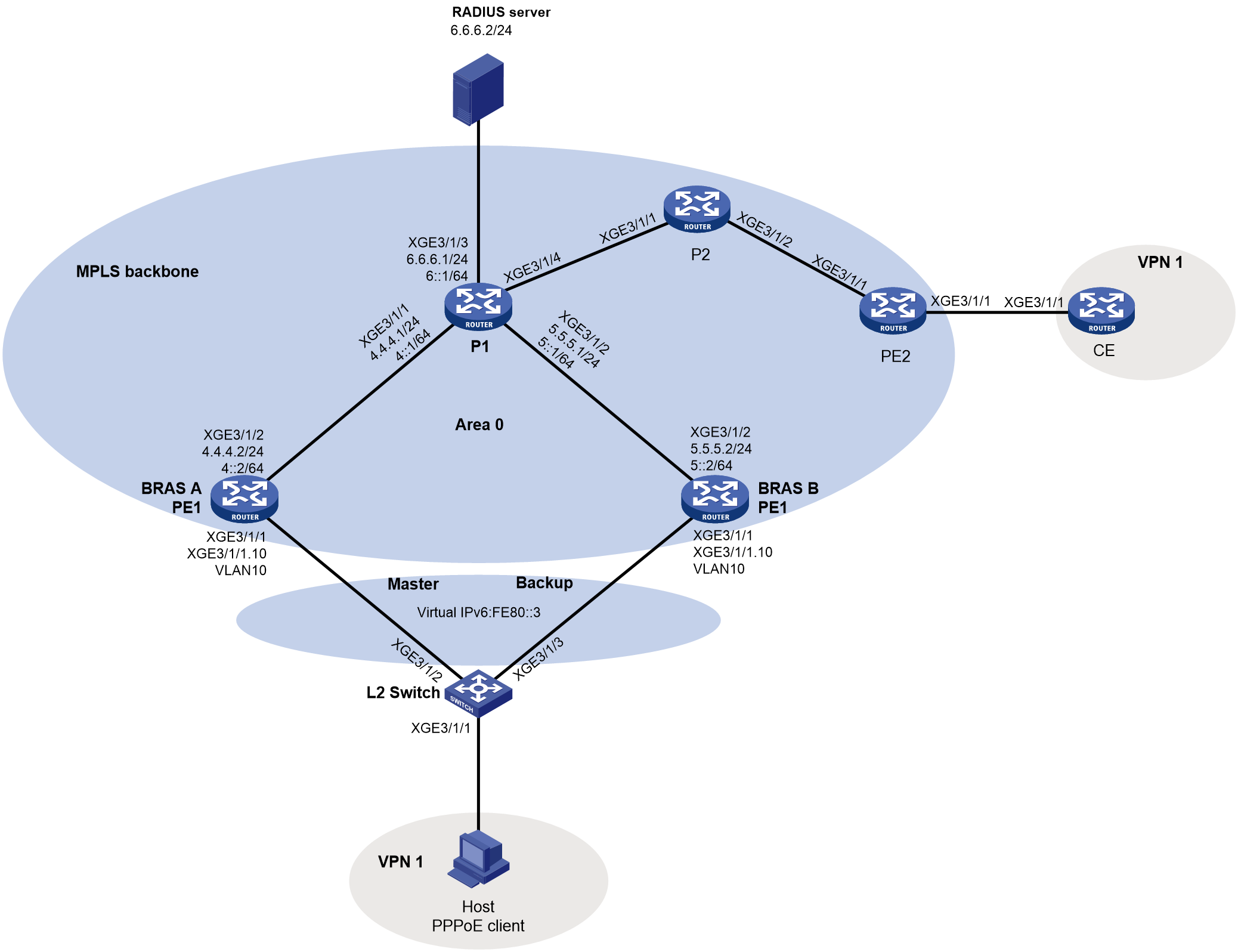

Example: Configuring VSRP for dual-stack PPPoE (IPv4 address pool and IPv6 address pool for a VPN instance)
As shown in Figure 8, the hosts run PPPoE client dialup software. To ensure service availability, enable VSRP for PPPoE on BRAS A (the master PPPoE server) and BRAS B (the backup PPPoE server). When BRAS A fails, BRAS B takes over the PPPoE services to avoid service interruption. Perform the following tasks:
·     Configure an IPv4 address pool and an IPv6 address pool for IP address assignment for uses in a VPN instance on the BRAS devices.
Figure 8 Network diagram
Configure MPLS L3VPN before you configure PPPoE. Assign matching VPN targets to the sites of VPN 1 for the sites to communicate with each other. This example provides only access authentication configuration on PE 1. For more information about other MPLS L3VPN configuration, see MPLS Configuration Guide.
1.     Assign IP addresses to interfaces, as shown in Figure 8. (Details not shown.)
client 3.3.3.3/32 {
ipaddr = 3.3.3.3
netmask=32
secret=123456
client 4.4.4.2/32 {
ipaddr = 4.4.4.2
netmask=32
secret=123456
client 5.5.5.2/32 {
ipaddr = 5.5.5.2
netmask=24
secret=123456
# Add the PPPoE client configuration to the users file. (The username of the PPPoE client is user1. The password is 123456.)
3.     Configure BRAS A:
a.     Create VPN instance vpn1.
<BRASA> system-view
[BRASA] ip vpn-instance vpn1
[BRASA-vpn-instance-vpn1] quit
b.     Configure a RADIUS scheme:
c.     Configure PBR:
Configure static routes and PBR for the RADIUS packets sent by BRAS devices to reach the RADIUS server.
# Configure a static route for users in VPN instance vpn1 to reach the RADIUS server.
[BRASA] ip route-static vpn-instance vpn1 6.6.6.2 32 4.4.4.1 public
# Configure ACL 3030 to match traffic with source address 6.6.6.2/32 and destination address 3.3.3.3/32.
[BRASA] acl advanced 3030
[BRASA-acl-ipv4-adv-3030] rule permit ip source 6.6.6.2 0 destination 3.3.3.3 0
[BRASA-acl-ipv4-adv-3030] quit
# Create PBR policy public_to_vpn1. Configure the policy to permit traffic that matches ACL 3030 in VPN instance vpn1.
[BRASA] policy-based-route public_to_vpn1 permit node 0
[BRASA-pbr-public_to_vpn1-0] if-match acl 3030
[BRASA-pbr-public_to_vpn1-0] apply access-vpn vpn-instance vpn1
[BRASA-pbr-public_to_vpn1-0] quit
# Apply PBR policy public_to_vpn1 to Ten-GigabitEthernet 3/1/2.
[BRASA–Ten-GigabitEthernet3/1/2] ip policy-based-route public_to_vpn1
d.     Configure an IPv4 address pool:
# Enable DHCP.
[BRASA] dhcp enable
[BRASA-ip-pool-pppoev4] gateway-list 3.3.3.3 export-route
[BRASA-ip-pool-pppoev4] dns-list 8.8.8.8
[BRASA-ip-pool-pppoev4] forbidden-ip 3.3.3.1
[BRASA-ip-pool-pppoev4] forbidden-ip 3.3.3.2
# Associate the address pool with VSRP instance vs1 and VPN instance vpn1.
[BRASA-ip-pool-pppoev4] vpn-instance vpn1
e.     Configure an IPv6 address pool:
# Create IPv6 address pool pppoev6. Assign subnet 3::/64 to the hosts and specify the DNS server address.
[BRASA-ipv6-pool-pppoev6] network 3::/64 export-route
[BRASA-ipv6-pool-pppoev6] dns-server 8::8
[BRASA-ipv6-pool-pppoev6] vpn-instance vpn1
[BRASA] ipv6 dhcp server forbidden-address 3::1 vpn-instance vpn1
[BRASA] ipv6 dhcp server forbidden-address 3::2 vpn-instance vpn1
[BRASA] ipv6 dhcp server forbidden-address 3::3 vpn-instance vpn1
# Specify the IPv4 address pool, IPv6 address pool, and VPN instance for users in the ISP domain.
[BRASA-isp-dm1] authorization-attribute ipv6-pool pppoev6
[BRASA-isp-dm1] authorization-attribute vpn-instance vpn1
g.     Configure OSPF:
# Configure Area 0.
[BRASA-ospf-1] quit
[BRASA] ospfv3
i.     Configure an IPv6 VRRP group:
k.     Configure PPPoE:
# Enable a PPPoE server on Ten-GigabitEthernet 3/1/1 and associate the interface with Virtual-Template 1.
# Configure Ten-GigabitEthernet 3/1/1 to automatically generate a link-local address.
# Set the managed address configuration flag (M) to 1 and set the other stateful configuration flag (O) to 1 in RA advertisements to be sent.
[BRASA-Ten-GigabitEthernet3/1/1] ipv6 nd autoconfig managed-address-flag
[BRASA-Ten-GigabitEthernet3/1/1] ipv6 nd autoconfig other-flag
# Enable DHCPv6 server on Ten-GigabitEthernet 3/1/1 and associate the interface with VSRP instance vs1.
4.     Configure BRAS B:
<BRASB> system-view
[BRASB] ip vpn-instance vpn1
[BRASB-vpn-instance-vpn1] quit
c.     Configure PBR:
[BRASB] ip route-static vpn-instance vpn1 6.6.6.2 32 5.5.5.1 public
[BRASB] acl advanced 3030
[BRASB-acl-ipv4-adv-3030] rule permit ip source 6.6.6.2 0 destination 3.3.3.3 0
[BRASB-acl-ipv4-adv-3030] quit
[BRASB] policy-based-route public_to_vpn1 permit node 0
[BRASB-pbr-public_to_vpn1-0] if-match acl 3030
[BRASB-pbr-public_to_vpn1-0] apply access-vpn vpn-instance vpn1
[BRASB-pbr-public_to_vpn1-0] quit
[BRASB–Ten-GigabitEthernet3/1/2] ip policy-based-route public_to_vpn1
# Enable DHCP.
[BRASB] dhcp enable
[BRASB-ip-pool-pppoev4] gateway-list 3.3.3.3 export-route
[BRASB-ip-pool-pppoev4] dns-list 8.8.8.8
[BRASB-ip-pool-pppoev4] forbidden-ip 3.3.3.1
[BRASB-ip-pool-pppoev4] forbidden-ip 3.3.3.2
[BRASB-ip-pool-pppoev4] vpn-instance vpn1
# Create IPv6 address pool pppoev6. Assign subnet 3::/64 to the hosts and specify DNS server address.
[BRASB-ipv6-pool-pppoev6] network 3::/64 export-route
[BRASB-ipv6-pool-pppoev6] dns-server 8::8
[BRASB-ipv6-pool-pppoev6] vpn-instance vpn1
[BRASB] ipv6 dhcp server forbidden-address 3::1 vpn-instance vpn1
[BRASB] ipv6 dhcp server forbidden-address 3::2 vpn-instance vpn1
[BRASB] ipv6 dhcp server forbidden-address 3::3 vpn-instance vpn1
[BRASB-isp-dm1] authorization-attribute ipv6-pool pppoev6
[BRASB-isp-dm1] authorization-attribute vpn-instance vpn1
g.     Configure OSPF:
# Configure Area 0.
[BRASB-ospf-1] quit
[BRASB] ospfv3
k.     Configure PPPoE:
[BRASB-Ten-GigabitEthernet3/1/1] ipv6 nd autoconfig managed-address-flag
[BRASB-Ten-GigabitEthernet3/1/1] ipv6 nd autoconfig other-flag
[BRASB-Ten-GigabitEthernet3/1/1] dhcp vsrp-instance vs1
[BRASB-Ten-GigabitEthernet3/1/1] quit
5.     Configure P1:
a.     Configure OSPF:
<P1> system-view
[P1] ospf 1 router-id 6.6.6.1
# Configure Area 0.
[P1-ospf-1] area 0.0.0.0
[P1-ospf-1-area-0.0.0.0] network 4.4.4.0 0.0.0.255
[P1-ospf-1-area-0.0.0.0] network 5.5.5.0 0.0.0.255
[P1-ospf-1-area-0.0.0.0] quit
[P1-ospf-1] quit
[P1] ospfv3
[P1-ospfv3-1] router-id 6.6.6.1
[P1-ospfv3-1] quit
# Configure Area 0.
[P1] interface ten-gigabitethernet 3/1/1
[P1–Ten-GigabitEthernet3/1/1] ospfv3 1 area 0
[P1–Ten-GigabitEthernet3/1/1] quit
[P1] interface ten-gigabitethernet 3/1/2
[P1–Ten-GigabitEthernet3/1/2] ospfv1 1 area 0
[P1–Ten-GigabitEthernet3/1/2] quit
[P1] interface ten-gigabitethernet 3/1/3
[P1-Ten-GigabitEthernet3/1/3] ospfv3 1 area 0
[P1-Ten-GigabitEthernet3/1/3] quit
c.     Configure static routes for P1 to reach 3.3.3.3:
# Configure a static route with BRAS A as the next hop.
[P1] ip route-static 3.3.3.3 32 4.4.4.2
# Configure a static route with BRAS B as the next hop.
[P1] ip route-static 3.3.3.3 32 5.5.5.2
# Create VLAN 10.
[L2Switch] vlan 10
         IPv6 address
0x1      XGE3/1/1                 3.3.3.4             001b-21a8-0949  -/-
         user1                    PPPoE users
         3::4
         IPv6 address
         user1                    PPPoE users
         3::4
         IPv6 address
         user1                    PPPoE users
         3::4

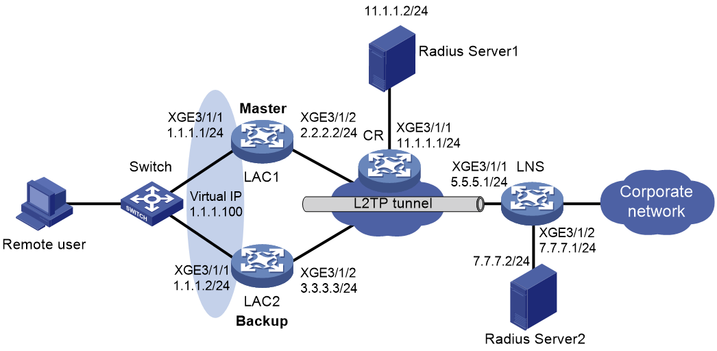

Example: Configuring VSRP for L2TP
As shown in Figure 9, enable VSRP for L2TP on LAC 1 (the master) and LAC 2 (the backup). When LAC 1 fails, LAC 2 can take over the L2TP services to avoid service interruption.
Figure 9 Network diagram
1.     Assign IP addresses to interfaces, as shown in Figure 9. Configure routes for the remote user, the LACs, the LNS, and the RADIUS servers to reach one another. Make sure the IP address of the interface deployed with VRRP is on the same subnet as the virtual IP address of the VRRP group. (Details not shown.)
2.     Configure RADIUS server 1 and RADIUS server 2. (Details not shown.)
3.     Configure the LNS:
# Create a RADIUS scheme named rad and enter RADIUS scheme view.
<LNS> system-view
[LNS] radius scheme rad
[LNS-radius-rad] primary authentication 7.7.7.2
[LNS-radius-rad] primary accounting 7.7.7.2
[LNS-radius-rad] key authentication simple auth2pass
[LNS-radius-rad] key accounting simple auth2pass
# Specify the source IP address as 7.7.7.1 (the IP address of Ten-GigabitEthernet 3/1/2) for outgoing RADIUS packets.
[LNS-radius-rad] nas-ip 7.7.7.1
[LNS-radius-rad] quit
# Enable DHCP and configure an address pool.
[LNS] dhcp enable
[LNS] ip pool pool1
[LNS-ip-pool-pool1] network 192.168.1.0 mask 255.255.255.0 export-route
[LNS-ip-pool-pool1] gateway-list 192.168.1.1 export-route

4.     Configure LAC 1:
<LAC1> system-view
[LAC1] radius scheme rad
# Specify the primary authentication server with IP address 11.1.1.2 and UDP port number 1812.
[LAC1-radius-rad] primary authentication 11.1.1.2 1812
# Specify the primary accounting server with IP address 11.1.1.2 and UDP port number 1813.
[LAC1-radius-rad] primary accounting 11.1.1.2 1813
[LAC1-radius-rad] key authentication simple auth1pass
[LAC1-radius-rad] key accounting simple auth1pass
# Specify the source IP address as 1.1.1.100 (the virtual IP address of VRRP group 1) for outgoing RADIUS packets.
[LAC1-radius-rad] nas-ip 1.1.1.100
[LAC1-radius-rad] quit
# Create ISP domain bbb and enter ISP domain view.
[LAC1] domain name bbb
# Configure the domain to use RADIUS scheme rad for authentication, authorization, and accounting for PPP users.
[LAC1-isp-bbb] authentication ppp radius-scheme rad
[LAC1-isp-bbb] authorization ppp radius-scheme rad
[LAC1-isp-bbb] accounting ppp radius-scheme rad
[LAC1-isp-bbb] quit
# Create interface Virtual-Template 1 and set the PPP authentication mode to PAP.
[LAC1] interface virtual-template 1
[LAC1-Virtual-Template1] ppp authentication-mode pap domain bbb
[LAC1-Virtual-Template1] quit
# Enable L2TP.
[LAC1] l2tp enable
# Create L2TP group 1 in LAC mode.
[LAC1] l2tp-group 1 mode lac
# Configure the local tunnel name as LAC.
[LAC1-l2tp1] tunnel name LAC
# Specify PPP user user1 as the condition for the LAC to initiate tunneling requests.
[LAC1-l2tp1] user fullusername user1
# Specify the LNS IP address as 5.5.5.1.
[LAC1-l2tp1] lns-ip 5.5.5.1
# Disable tunnel authentication.
[LAC1-l2tp1] undo tunnel authentication
# Associate L2TP group 1 with VSRP instance l2tp1.
[LAC1-l2tp1] vsrp-instance l2tp1
# Specify the source IP address for the L2TP tunnel as 6.6.6.1. After successful VSRP master and backup negotiation, only the master LAC generates a static route to the source address with the loopback interface as the output interface. To forward downstream traffic from LNS to the remote end always through the master LAC, use a dynamic routing protocol to advertise this static route. (Details not shown.)
[LAC1-l2tp1] tunnel vsrp source-ip 6.6.6.1
[LAC1-l2tp1] quit
# Configure the PPPoE server.
[LAC1] interface ten-gigabitethernet 3/1/1
[LAC1-Ten-GigabitEthernet3/1/1] pppoe-server bind virtual-template 1
# Associate the PPPoE server-enabled interface with VSRP instance l2tp1.
[LAC1-Ten-GigabitEthernet3/1/1] bras vsrp-instance l2tp1
[LAC1-Ten-GigabitEthernet3/1/1] quit
# Create track entry 2 to monitor the link status of uplink interface Ten-GigabitEthernet 3/1/2.
[LAC1] track 2 interface ten-gigabitethernet 3/1/2
# Create VRRP group 1 and set its virtual IP address to 1.1.1.100.
[LAC1] interface ten-gigabitethernet 3/1/1.10
[LAC1-Ten-GigabitEthernet3/1/1.10] ip address 1.1.1.1 255.255.255.0
[LAC1-Ten-GigabitEthernet3/1/1.10] vrrp vrid 1 virtual-ip 1.1.1.100
# Set the priority of LAC 1 to 120 in VRRP group 1 on Ten-GigabitEthernet 3/1/1.
[LAC1-Ten-GigabitEthernet3/1/1.10] vrrp vrid 1 priority 120
# Configure LAC 1 to operate in preemptive mode, and set the preemption delay to 90000 centiseconds (15 minutes). When the original master recovers, it has 15 minutes to synchronize data from the new master before switch-back to ensure stability and data consistency of the VRRP group.
[LAC1-Ten-GigabitEthernet3/1/1.10] vrrp vrid 1 preempt-mode delay 90000
[LAC1-Ten-GigabitEthernet3/1/1.10] vrrp ipv6 state-transition-delay 50
# Associate VRRP group 1 on Ten-GigabitEthernet 3/1/1 with track entry 2 and decrease the device priority by 50 when the state of track entry 2 changes to Negative.
[LAC1-Ten-GigabitEthernet3/1/1.10] vrrp vrid 1 track 2 priority reduced 50
[LAC1-Ten-GigabitEthernet3/1/1.10] vlan-type dot1q vid 10
[LAC1-Ten-GigabitEthernet3/1/1.10] quit
# Create VSRP group pname, and enter VSRP peer view.
[LAC1] vsrp peer pname
# Specify the local IP address as 2.2.2.2 and the peer IP address as 3.3.3.3 for VSRP to establish VSRP channels. The default TCP port number for the control channel is used.
[LAC1-vsrp-peer-pname] peer 3.3.3.3 local 2.2.2.2
[LAC1-vsrp-peer-pname] quit
# Create VSRP instance l2tp1 and associate it with VSRP group pname. Set the backup ID of the VSRP instance to 1.
[LAC1] vsrp instance l2tp1
[LAC1-vsrp-instance-l2tp1] backup id 1 peer pname
# Bind VSRP instance l2tp1 to VRRP group 1 on Ten-GigabitEthernet 3/1/1.
[LAC1-vsrp-instance-l2tp1] bind vrrp vrid 1 interface ten-gigabitethernet 3/1/1
[LAC1-vsrp-instance-l2tp1] quit
5.     Configure LAC 2:
<LAC2> system-view
[LAC2] radius scheme rad
[LAC2-radius-rad] primary authentication 11.1.1.2 1812
[LAC2-radius-rad] primary accounting 11.1.1.2 1813
[LAC2-radius-rad] key authentication simple auth1pass
[LAC2-radius-rad] key accounting simple auth1pass
[LAC2-radius-rad] nas-ip 1.1.1.100
[LAC2-radius-rad] quit
[LAC2] domain name bbb
[LAC2-isp-bbb] authentication ppp radius-scheme rad
[LAC2-isp-bbb] authorization ppp radius-scheme rad
[LAC2-isp-bbb] accounting ppp radius-scheme rad
[LAC2-isp-bbb] quit
[LAC2] interface virtual-template 1
[LAC2-Virtual-Template1] ppp authentication-mode pap domain default enable bbb
[LAC2-Virtual-Template1] quit
# Enable L2TP.
[LAC2] l2tp enable
[LAC2] l2tp-group 1 mode lac
[LAC2-l2tp1] tunnel name LAC
[LAC2-l2tp1] user fullusername user1
[LAC2-l2tp1] lns-ip 5.5.5.1
[LAC2-l2tp1] undo tunnel authentication
[LAC2-l2tp1] vsrp-instance l2tp1
[LAC2-l2tp1] tunnel vsrp source-ip 6.6.6.1
[LAC2-l2tp1] quit
[LAC2] interface ten-gigabitethernet 3/1/1
[LAC2-Ten-GigabitEthernet3/1/1] pppoe-server bind virtual-template 1
# Associate the PPPoE server with VSRP instance l2tp1.
[LAC2-Ten-GigabitEthernet3/1/1] bras vsrp-instance l2tp1
[LAC2-Ten-GigabitEthernet3/1/1] quit
[LAC2] interface ten-gigabitethernet 3/1/1.10
[LAC2-Ten-GigabitEthernet3/1/1.10] ip address 1.1.1.2 255.255.255.0
[LAC2-Ten-GigabitEthernet3/1/1.10] vrrp vrid 1 virtual-ip 1.1.1.100
# On Ten-GigabitEthernet 3/1/1.10, associate the direct route with track entry 1 and apply the cost 100 to the direct route when the state of track entry 1 changes to Negative.
[LAC2-Ten-GigabitEthernet3/1/1.10] route-direct track 1 degrade-cost 100
# Configure LAC 2 to operate in preemptive mode without setting the preemption delay. When the priority of the master decreases in the VRRP group, the backup can immediately take over as the new master for service continuity.
[LAC2–Ten-GigabitEthernet3/1/1.10] vrrp vrid 1 preempt-mode
[LAC2-Ten-GigabitEthernet3/1/1.10] quit
# Create VSRP group pname and enter VSRP peer view.
[LAC2] vsrp peer pname
# Specify the local IP address as 3.3.3.3 and the peer address as 2.2.2.2 for VSRP to establish VSRP channels. The default TCP port number for the control channel is used.
[LAC2-vsrp-peer-pname] peer 2.2.2.2 local 3.3.3.3
[LAC2-vsrp-peer-pname] quit
[LAC2] vsrp instance l2tp1
[LAC2-vsrp-instance-l2tp1] backup id 1 peer pname
[LAC2-vsrp-instance-l2tp1] bind vrrp vrid 1 interface ten-gigabitethernet 3/1/1
[LAC2-vsrp-instance-l2tp1] quit
# To enable RADIUS server 1 to always interact with the master LAC, configure the following settings. After configuration, when both the master and backup LACs redistribute the direct route of subnet 1.1.1.0/24 (where NAS IP address 1.1.1.100 resides) into the dynamic routing protocol (such as OSPF) and advertise the direct route to the upstream CR, the CR learns the subnet route 1.1.1.0/24 advertised by only the master device.
¡     # Create track entry 1 and associate it with VRRP group 1 on interface Ten-GigabitEthernet 3/1/1. When the device is in master state, the associated track entry changes to Positive state. When the device is in backup state, the associated track entry changes to Negative state.
[LAC2] track 1 vrrp interface ten-gigabitethernet 3/1/1.10 vrid 1
[LAC2-track-1] quit
¡     # On Ten-GigabitEthernet 3/1/1, associate the direct route with track entry 1 and apply the cost 100 to the direct route when the state of track entry 1 changes to Negative.
[LAC2-Ten-GigabitEthernet3/1/1] route-direct track 1 degrade-cost 100
¡     # Redistibute direct routes into OSPF process 100, and specify to use the original cost of redistributed routes. This ensures that the cost value for the routes advertised by the backup device to the CR is larger than the cost value for the routes advertised by the master device. As a result, the CR device learns the subnet route 1.1.1.0/24 advertised by only the master device. (This example uses OSPF to illustrate only the key configuration for route redistribution.)
[LAC2] ospf 100
[LAC2-ospf-100] import-route direct inherit-cost
[LAC2-ospf-100] quit
6.     Enter the username user1 and password pwd on the PPPoE client dialup software to initiate a connection request on the remote user.
# Verify that LAC 1 (the master) has synchronized L2TP service data to LAC 2 (the backup).
<LAC1> display vsrp instance l2tp1
VSRP instance name: l2tp1
 VSRP peer name: pname
 Backup ID: 1
 Bound VRID: VRRP VRID 1 interface Ten-GigabitEthernet3/1/1.10
 Instance status: Master
 Local status: Master
 Peer status: Backup
 Backup mode: Hot
 Traffic backup interval: 10(minutes)
 Traffic backup threshold: 50(MB)
 Route advertisement: Master only
# Verify that LAC 1 and LAC 2 have the same L2TP sessions.
<LAC1> display ppp sync-session vsrp-instance l2tp1
VSRP instance: l2tp1
VSRP instance state: Master
PSID        LTID       LSID      RSID      MAC address       IP address
Interface   Username   IPv6 NDPrefix       IPv6 PDPrefix     IPv6 address
1           28532      467       32060     6c5d-5cb3-0106    -
XGE3/1/1    user1      -                   -                 -
<LAC2> display ppp sync-session vsrp-instance l2tp1
VSRP instance state: Backup
# Verify that LAC 1 and LAC 2 have the same L2TP tunnel information.
<LAC1> display l2tp tunnel vsrp l2tp1
Total synchronized L2TP tunnels: 1
LocalTID RemoteTID State        Sessions RemoteAddress   RemotePort RemoteName
28532    4         Established  1        5.5.5.1         1701       LNS
<LAC2> display l2tp tunnel vsrp l2tp1
# Shut down LAC 1.
# Verify that LAC 2 becomes the master and takes over the L2TP services. LAC 1 becomes the backup. The data channel between them is disconnected.
<LAC2> display vsrp instance l2tp1
 Backup ID: 1
 Peer status: Down
 Backup mode: Hot

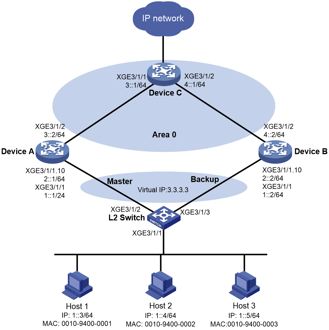

Example: Configuring VSRP and VRRP collaboration for ARP
As shown in Figure 10, configure VSRP to back up ARP entries between Device A and Device B.
·     Enable VSRP for ARP on Ten-GigabitEthernet 3/1/1 of Device A and Device B.
·     Configure VRRP on Ten-GigabitEthernet 3/1/1.10 of Device A and Device B, and configure these subinterfaces to terminate VLAN 10.
·     Enable OSPF on Device A and Device B to ensure that they can learn and advertise routes on their upstream links.
Figure 10 Network diagram
1.     Assign IP addresses to the interfaces, as shown in Figure 10. (Details not shown.)
2.     Configure Device A:
c.     Configure VSRP for ARP.
# Associate ARP with VSRP instance vs1.
[DeviceA–Ten-GigabitEthernet3/1/1.10] arp vsrp-instance vs1
# Specify TCP port 1024 for VSRP to establish data channels for ARP service backup.
[DeviceA] arp vsrp-port 1024
d.     Configure OSPF:
# Configure routing policy 1 to permit routes destined for network 2.2.2.0/24.
[DeviceA] ip prefix-list 1 permit 2.2.2.0 24
# Configure Area 0.
[DeviceA] ospf
[DeviceA-ospf-1-area-0.0.0.0] quit
3.     Configure Device B:
[DeviceB–Ten-GigabitEthernet3/1/1.10] arp vsrp-instance vs1
[DeviceB] arp vsrp-port 1024
d.     Configure OSPF:
[DeviceB] ip prefix-list 1 permit 2.2.2.0 24
# Configure Area 0.
[DeviceB] ospf
[DeviceB-ospf-1-area-0.0.0.0] quit
4.     Configure Device C:
5.     Configure the L2 Switch:
a.     Create VLAN 10.
[L2Switch] vlan 10
# Verify the VSRP configuration on Device A and Device B.
·     On the master:
[DeviceA] display vsrp instance
VSRP instance name: vs1
VSRP peer name: pr1
Backup ID:1
Bound VRID: VRRP VRID 1 interface GigabitEthernet0/0/1.10
Peer status: Backup
Backup mode: Hot
·     On the backup:
[DeviceB] display vsrp instance
VSRP peer name: pr1
Backup ID:1
Instance status: Backup
Peer status: Master
Backup mode: Hot
# Verify that Device A and Device B have the same ARP information for Ten-GigabitEthernet 3/1/1.
·     On the master:
[DeviceA] display arp all
  Type: S-Static   D-Dynamic   O-Openflow   R-Rule   M-Multiport  I-Invalid
IP address      MAC address    VLAN/VSI name Interface                Aging Type
11.1.1.2        0001-0001-0001 --            XGE3/1/1                 20    D
11.1.1.3        0001-0001-0000 --            XGE3/1/1                 20    D
11.1.1.4        0001-0000-ffff --            XGE3/1/1                 20    D
11.1.1.5        0001-0000-fffe --            XGE3/1/1                 20    D
·     On the backup:
[DeviceB] display arp all
11.1.1.2        0001-0001-0001 --            XGE3/1/1                 --    R
11.1.1.3        0001-0001-0000 --            XGE3/1/1                 --    R
11.1.1.4        0001-0000-ffff --            XGE3/1/1                 --    R
11.1.1.5        0001-0000-fffe --            XGE3/1/1                 --    R

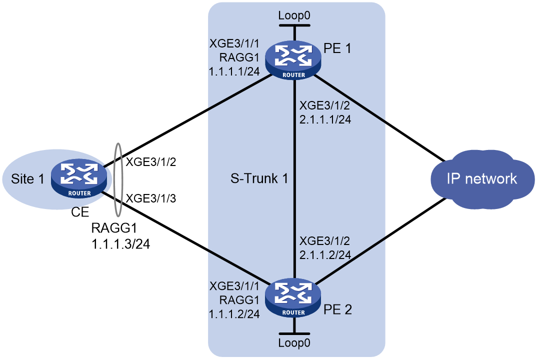

Example: Configuring VSRP and S-Trunk collaboration for ARP
As shown in Figure 11, configure VSRP to back up ARP entries between Device A and Device B.
·     Configure smart trunk 1 on Device A and Device B, and assign Route-Aggregation 1 of Device A and Device B to the smart trunk. Configure Route-Aggregation 1 of Device A as the primary member interface, and configure Route-Aggregation 1 of Device B as the secondary member interface.
·     Enable VSRP for ARP on Route-Aggregation 1 of Device A and Device B.
·     Configure VSRP and S-Trunk collaboration.
Figure 11 Network diagram
Configuring the CE
1.     Assign IP addresses to the interfaces, as shown in Figure 11. (Details not shown.)
2.     Configure link aggregation:
<CE> system-view
[CE] interface route-aggregation 1
[CE-Route-Aggregation1] link-aggregation mode dynamic
[CE-Route-Aggregation1] quit
[CE] interface ten-gigabitethernet 3/1/2
[CE-Ten-GigabitEthernet3/1/2] port link-aggregation group 1
[CE-Ten-GigabitEthernet3/1/2] quit
[CE] interface ten-gigabitethernet 3/1/3
[CE-Ten-GigabitEthernet3/1/3] port link-aggregation group 1
[CE-Ten-GigabitEthernet3/1/3] quit
Configuring PE 1
2.     Configure LACP system settings to set up the S-Trunk system.
<PE1> system-view
[PE1] lacp system-priority 10
[PE1] lacp system-mac 1-1-1
[PE1] lacp system-number 1
3.     Configure S-Trunk protocol packet parameters.
[PE1] s-trunk udp-port 2048
[PE1] s-trunk id 1
[PE1-s-trunk1] s-trunk ip destination 2.1.1.2 source 2.1.1.1
[PE1-s-trunk1] quit
4.     Configure static BFD to monitor link status for S-Trunk.
[PE1] bfd static bfd1 peer-ip 2.1.1.2 source-ip 2.1.1.1 discriminator local 1 remote 2
[PE1-bfd-static-session-bfd1] quit
[PE1] s-trunk id 1
[PE1-s-trunk1] s-trunk bfd-session bfd1
[PE1-s-trunk1] quit
5.     Create smart trunk 1 and assign member interfaces to it.
[PE1] interface route-aggregation 1
[PE1-Route-Aggregation1] link-aggregation mode dynamic
[PE1-Route-Aggregation1] s-trunk 1
[PE1-Route-Aggregation1] quit
[PE1] interface ten-gigabitethernet 3/1/1
[PE1-Ten-GigabitEthernet3/1/1] port link-aggregation group 1
[PE1-Ten-GigabitEthernet3/1/1] quit
6.     Configure a VSRP instance:
[PE1] vsrp peer pr1
# Specify the local IP address 2.1.1.1 and the peer address 2.1.1.2.
[PE1-vsrp-peer-pr1] peer 2.1.1.2 local 2.1.1.1
[PE1-vsrp-peer-pr1] quit
[PE1] vsrp instance vs1
# Specify the backup ID of VSRP instance vs1 as 1 in VSRP group pr1.
[PE1-vsrp-instance-vs1] backup id 1 peer pr1
# Bind VSRP instance vs1 to Route-Aggregation 1 in smart trunk 1.
[PE1-vsrp-instance-vs1] bind s-trunk 1 interface route-aggregation 1
[PE1-vsrp-instance-vs1] quit
7.     Configure VSRP for ARP:
# Enter the view of Router-Aggregation 1.
[PE1–Route-Aggregation1] arp vsrp-instance vs1
[PE1–Route-Aggregation1] quit
[PE1] arp vsrp-port 1024
Configuring PE 2
<PE2> system-view
[PE2] lacp system-priority 10
[PE2] lacp system-mac 1-1-1
[PE2] lacp system-number 2
[PE2] s-trunk udp-port 2048
[PE2] s-trunk id 1
[PE2-s-trunk1] s-trunk ip destination 2.1.1.1 source 2.1.1.2
[PE2-s-trunk1] quit
[PE2] bfd static bfd1 peer-ip 2.1.1.1 source-ip 2.1.1.2 discriminator local 2 remote 1
[PE2-bfd-static-session-bfd1] quit
[PE2] s-trunk id 1
[PE2-s-trunk1] s-trunk bfd-session bfd1
[PE2-s-trunk1] quit
[PE2] interface route-aggregation 1
[PE2-Route-Aggregation1] link-aggregation mode dynamic
[PE2-Route-Aggregation1] s-trunk 1
[PE2-Route-Aggregation1] quit
[PE2] interface ten-gigabitethernet 3/1/1
[PE2-Ten-GigabitEthernet3/1/1] port link-aggregation group 1
[PE2-Ten-GigabitEthernet3/1/1] quit
[PE2] vsrp peer pr1
# Specify the local IP address 2.1.1.2 and the peer address 2.1.1.1.
[PE2-vsrp-peer-pr1]peer 2.1.1.1 local 2.1.1.2
[PE2-vsrp-peer-pr1] quit
[PE2] vsrp instance vs1
[PE2-vsrp-instance-vs1] backup id 1 peer pr1
[PE2-vsrp-instance-vs1] bind s-trunk 1 interface route-aggregation 1
[PE2-vsrp-instance-vs1] quit
