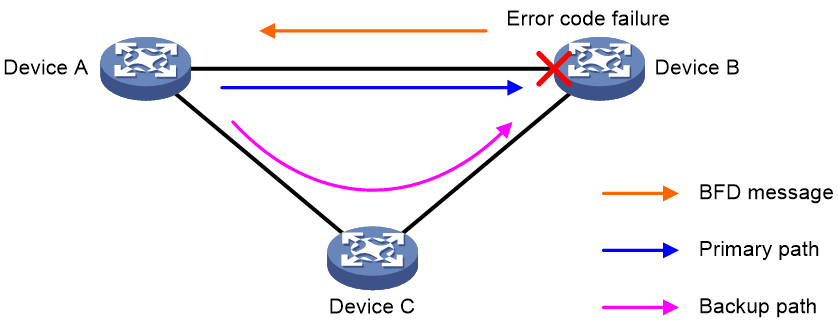

As shown in Figure 1, each interface has error code detection enabled for triggering LSP switchover. LDP labels are distributed among nodes. Typically, MPLS traffic is forwarded over the primary LSP. When error codes are detected on Device B, the following events occur:
¡     Device B senses the primary LSP failure, and switches traffic to the secondary LSP. At the same, Device B sends BFD messages to notify Device A of the error code failure.
¡     After Device A receives BFD messages from Device B, Device A also senses the primary LSP failure, and switches traffic to the secondary LSP.
Figure 1 Schematic diagram for error code detection for triggering LSP switchover
