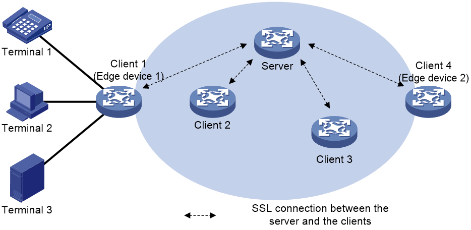

Trust network architecture
As shown in Figure 1, a trusted network adopts the Client/Server mode, in which the trust level feature is enabled on each network transmission device. The devices in the trust network architecture include terminals and network transmission devices.
Figure 1 Trust network architecture
Terminal
A terminal in a trust network (terminal) refers to a device with a security level in its IP address and secure communication requirements. In the IP address of a terminal, three bits are used to carry the security levels of the packets generated by the terminal, so as to identify the trustworthiness of the packets.
Network transmission device
Network transmission devices include the following types according to the device location in the transmission network:
·     Edge device—Network transmission devices located at the edge of a trust network and connected to Layer 3 of the terminals. The security levels of the packets received by edge devices are extracted according to the configuration.
·     Non-edge device—Network transmission devices that participate in trusted forwarding except edge devices. The packets received by non-edge devices can be forwarded normally according to the routes, without extracting their security levels.
Network transmission devices include the following types according to the device function in the transmission network:
·     Server—Network transmission devices acting as the server in a trust network. The server is the configuration center of the trust network. You need to configure the trust level policies and the parameters for secure transmission of packets on the server. The server deploys the configurations related to the trust level policies and the parameters for secure transmission of packets to all clients through SSL connection.
The server can be deployed as an edge device or a non-edge device. A device can only act as a server or a client.
Multiple servers can be deployed in a trust network, and a client can only be connected to a server. Make sure the configurations of trust level modules on multiple servers in a trust network are consistent. Otherwise, the packets cannot be forwarded according to the expected paths.
·     Client—Network transmission devices acting as the clients in a trust network. According to the configurations deployed by the server, a client calculates the trusted forwarding path and completes trusted forwarding of packets.

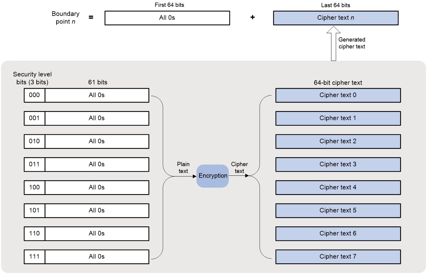

Boundary point
Boundary point is a parameter configured on the server to extract the security level of packets. The boundary point configurations are deployed to all clients. This command only takes effect on edge devices.
You need to configure eight boundary points (boundary point 0 to boundary point 7) on the server to extract eight security levels of the packets respectively. The boundary points use IPv6 address format. The generation method of the boundary points is shown in Figure 2.
Figure 2 Generation method of the boundary points
For example, boundary point 1 is generated as follows:
1.     Take the 64-bit binary number (with three security level bits of 001 and 61 bits of 0) as the plain text.
2.     Use the same algorithm as that used by the terminal to encrypt the plain text to generate a 64-bit cipher text.
3.     The 64-bit number with all bits of 0 and the generated 64-bit cipher text together form boundary point 1.
Edge devices use the boundary points to extract the packet security levels according to the following rules:
·     If the last 64 bits of the source IPv6 addresses of the received packets are in the range of cipher text 0 to cipher text 1, the security level of the packets is 0.
·     If the last 64 bits of the source IPv6 addresses of the received packets are in the range of cipher text 1 to cipher text 2, the security level of the packets is 1.
·     By analogy, if the last 64 bits of the source IPv6 addresses of the received packets are in the range of cipher text 7 to cipher text 0, the security level of the packets is 7.

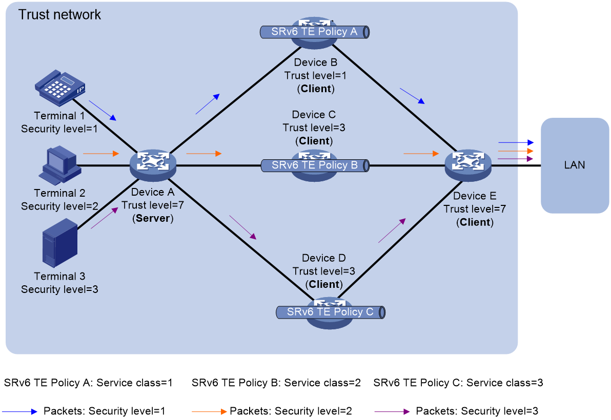

Figure 3 shows a packet forwarding process in a trust network.
Figure 3 Trust network forwarding diagram
Planning the network and configuring the trust level feature
Before trusted forwarding, you need to plan the network. The components to be planned includes the security levels of the terminals, the network transmission devices participating in trusted forwarding and their trust levels, the forwarding paths of packets with different security levels, the server and clients in the trust network.
For the trust network in Figure 3, the network is planned as shown in Table 1 and Table 2.
Table 1 Planning of packet security levels, flexible algorithms, and service classes
Terminal
Packet security level
Flexible algorithm identifier
Service class
Terminal 1
1
201
1
Terminal 2
2
202
2
Terminal 3
3
203
3
Table 2 Planning of device trust level policies, IS-IS System IDs, and trust levels
Trust level policy name
IS-IS System ID
Trust level
forDeviceA
1680.1000.1001
7
forDeviceB
1680.1000.1002
1
forDeviceC
1680.1000.1003
3
forDeviceD
1680.1000.1004
3
forDeviceE
1680.1000.1005
7

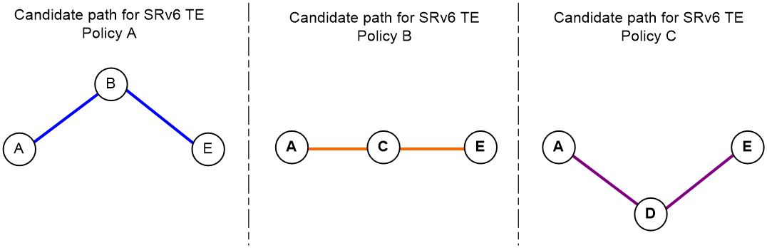

Generating network topologies based on flexible algorithms
1.     A network transmission device deploys the flexible algorithms supported by the device to neighboring devices according to its trust level. If the security levels of the received packets are lower than or equal to the trust level of the device, the flexible algorithms are deployed.
2.     For the trust network in Figure 3, IS-IS protocol calculates the routing topologies according to IS-IS System IDs and flexible algorithms, as shown in Figure 4.
¡     The trust level of Device A and Device E is 7, and flexible algorithm 201, 202, and 203 are deployed.
¡     The trust level of Device B is 1, and flexible algorithm 201 is deployed.
¡     The trust level of Device C and Device D is 3, and flexible algorithm 201, 202, and 203 are deployed.
Figure 4 Calculated routing topologies

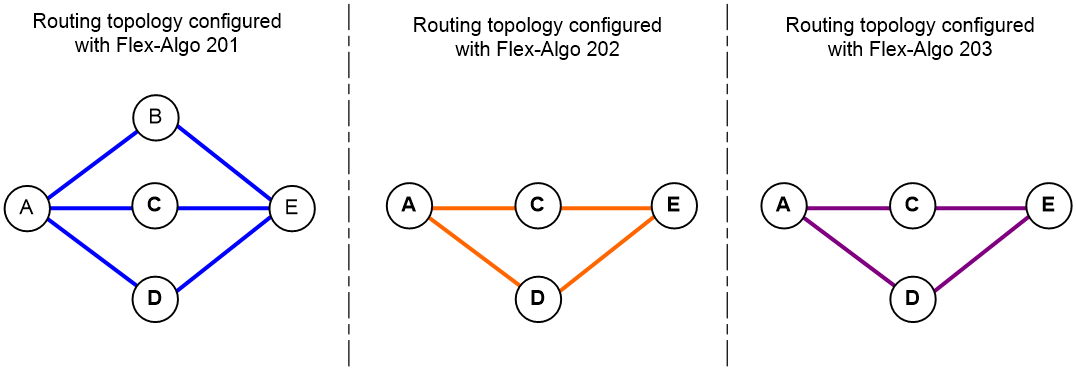

The edge device (Device A) finds the matching SRv6 TE policy tunnel according to the packet security levels and service classes. The candidate path of an SRv6 TE policy is calculated in the corresponding routing topology configured with specific flexible algorithm. If multiple physical paths exist in the routing topology, with an SRv6 TE policy, the traffic can be load shared among multiple paths, or a path can be strictly selected in priority to send the packets to the next network transmission device.
For the routing topologies in Figure 4, when strictly selecting a physical path, the SRv6 TE policy selects a forwarding path as follows:
·     The service class of the packets with security level 1 is 1, matching with SRv6 TE Policy A. The candidate path Device A > Device B > Device E for SRv6 TE Policy A is calculated in the routing topology configured with flexible algorithm 201.
·     The service class of the packets with security level 2 is 2, matching with SRv6 TE Policy B. The candidate path Device A > Device C > Device E for SRv6 TE Policy B is calculated in the routing topology configured with flexible algorithm 202.
·     The service class of the packets with security level 3 is 3, matching with SRv6 TE Policy C. The candidate path Device A > Device D > Device E for SRv6 TE Policy C is calculated in the routing topology configured with flexible algorithm 203.

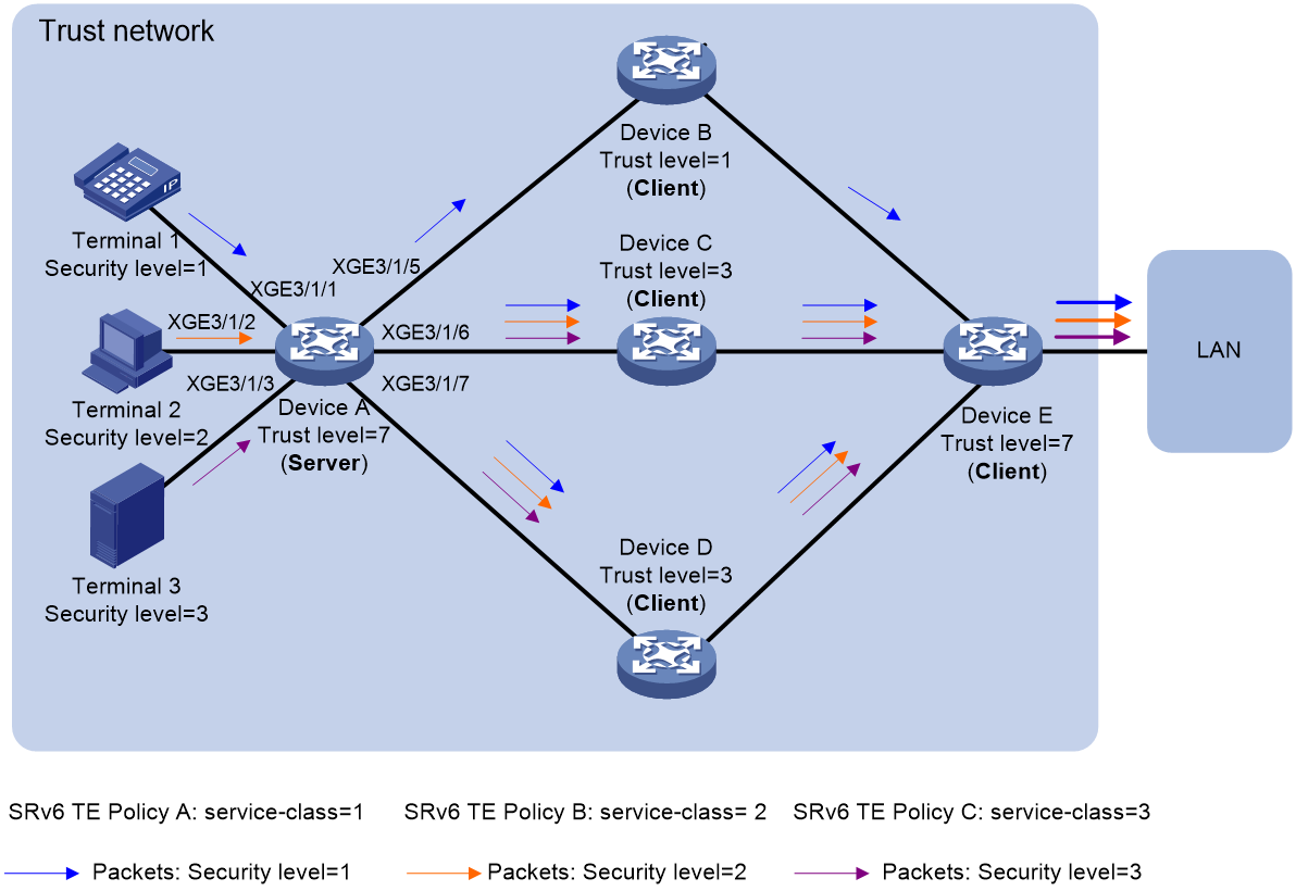

The actual forwarding paths of the packets are finally calculated as shown in Figure 5.
Figure 5 Strictly calculated actual forwarding topologies
For non-edge devices (Device B, Device C, Device D, and Device E), the received packets can be forwarded normally through SRv6 tunnels.

Configuring a trust level client
Restrictions and guidelines for configuring a trust level client
In a trust network, a device can only act as a server or a client. A device needs to exit the server mode so as to be used as a client.
When exiting the client mode, all configurations of the device in the client mode are automatically restored to the default. Use it with caution.

Three terminals are deployed in a trust network: IP phone (with security level 1), host (with security level 2), and DHCP server (with security level 3).
Device A and Device E are the most trusted, with trust level 7. The trust level of Device B is the lowest, which is 1. The trust level of Device C and Device D is medium, which is 3.
According to the security level of the terminals, trusted forwarding of the packets generated by the terminals is as follows:
·     The packets generated by the IP phone are forwarded in three paths: Device A > Device B > Device E, Device A > Device C > Device E, and Device A > Device D > Device E.
·     The packets generated by the host are forwarded in two paths: Device A > Device C > Device E and Device A > Device D > Device E.
·     The packets generated by the DHCP server are forwarded in two paths: Device A > Device C > Device E and Device A > Device D > Device E.
Figure 6 Trust level configuration network diagram

By using a packet capture tool to capture the packets, very that the packets are forwarded as follows:
·     The packets generated by the host are forwarded in two paths: Device A > Device C > Device E, Device A > Device D > Device E.
·     The packets generated by the DHCP server are forwarded in two paths: Device A > Device C > Device E, Device A > Device D > Device E.
