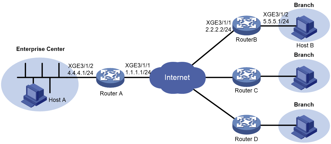

IPsec RRI
IPsec Reverse Route Injection (RRI) enables an IPsec tunnel gateway to automatically add and delete static routes destined for the protected private networks. It automatically adds the static routes when the IPsec SAs are established and deletes the static routes when the IPsec SAs are deleted. This greatly reduces the static route configuration work load on the gateway and increases the scalability of the IPsec VPN.
IPsec RRI is applicable to gateways that must provide many IPsec tunnels (for example, a headquarters gateway).
As shown in Figure 6, the traffic between the enterprise center and the branches are protected by IPsec. The gateway at the enterprise center is configured with static routes to route traffic to the IPsec-protected interfaces. It is difficult to add or modify static routes on the gateway at the enterprise center if the IPsec VPN has a large number of branches or if the network structure changes.
Figure 6 IPsec VPN
After you can enable IPsec RRI on the gateway, the gateway automatically adds a static route to the routing table each time an IPsec tunnel is established. The destination IP address is the protected private network, and the next hop is the remote IP address of the IPsec tunnel. Traffic destined for the peer end is routed to the IPsec tunnel interface and thereby protected by IPsec.
You can advertise the static routes created by IPsec RRI in the internal network, and the internal network device can use them to forward traffic in the IPsec VPN.
You can set preferences for the static routes created by IPsec RRI to implement flexible route management. For example, you can set the same preference for multiple routes to the same destination to implement load sharing, or you can set different preferences to implement route backup.
You can also set tags for the static routes created by IPsec RRI to implement flexible route control through routing policies.

For high availability, a core device is usually connected to an ISP through two links, which operate in backup or load sharing mode. The two interfaces negotiate with their peers to establish IPsec SAs respectively. When one interface fails and a link failover occurs, the other interface needs to take some time to renegotiate SAs, resulting in service interruption.
To solve these problems, bind a source interface to an IPsec policy and apply the policy to both interfaces. This enables the two physical interfaces to use the same source interface to negotiate IPsec SAs. As long as the source interface is up, the negotiated IPsec SAs will not be removed and will keep working, regardless of link failover.
Only the IKE-based IPsec policies can be bound to a source interface.
An IPsec policy can be bound to only one source interface.
A source interface can be bound to multiple IPsec policies.
If the source interface bound to an IPsec policy is removed, the IPsec policy becomes a common IPsec policy.
If no local address is specified for an IPsec policy that has been bound to a source interface, the IPsec policy uses the IP address of the bound source interface to perform IKE negotiation. If a local address is specified, the IPsec policy uses the local address to perform IKE negotiation.

IPsec configuration examples
Example: Configuring an IKE-based IPsec tunnel for IPv4 packets
As shown in Figure 10, establish an IPsec tunnel between Router A and Router B to protect data flows between subnet 10.1.1.0/24 and subnet 10.1.2.0/24. Configure the IPsec tunnel as follows:
·     Specify the encapsulation mode as tunnel, the security protocol as ESP, the encryption algorithm as 128-bit AES, and the authentication algorithm as HMAC-SHA1.
·     Set up SAs through IKE negotiation.
Figure 10 Network diagram
1.     Configure Router A:
# Configure IP addresses for interfaces. (Details not shown.)
# Configure an IPv4 advanced ACL to identify data flows from subnet 10.1.1.0/24 to subnet 10.1.2.0/24.

Example: Configuring an IKE-based IPsec tunnel for IPv6 packets
As shown in Figure 11, establish an IPsec tunnel between Router A and Router B to protect data flows between subnet 333::/64 and subnet 555::/64. Configure the IPsec tunnel as follows:
Figure 11 Network diagram
# Configure IPv6 addresses for interfaces. (Details not shown.)
# Configure an IPv6 advanced ACL to identify data flows from subnet 333::/64 to subnet 555::/64.

Example: Configuring IPsec RRI
As shown in Figure 13, branches access the enterprise center through an IPsec VPN.
Configure the IPsec VPN as follows:
·     Configure an IPsec tunnel between Router A and each branch gateway (Router B, Router C, and Router D) to protect traffic between subnets 4.4.4.0/24 and 5.5.5.0/24.
·     Configure the tunnels to use security protocol ESP, encryption algorithm DES, and authentication algorithm SHA1-HMAC-96. Use IKE for IPsec SA negotiation.
·     On each router, configure an IKE proposal to use the pre-shared key authentication method, encryption algorithm 3DES, and authentication algorithm HMAC-SHA1.
·     Configure IPsec RRI on Router A to automatically create static routes to the branches based on the established IPsec SAs.
Figure 13 Network diagram
1.     Assign IPv4 addresses to the interfaces on the routers according to Figure 13. (Details not shown.)
2.     Configure Router A:
# Create an IPsec transform set named tran1, and specify ESP as the security protocol, DES as the encryption algorithm, and HMAC-SHA-1-96 as the authentication algorithm.
<RouterA> system-view
[RouterA] ipsec transform-set tran1
[RouterA-ipsec-transform-set-tran1] encapsulation-mode tunnel
[RouterA-ipsec-transform-set-tran1] protocol esp
[RouterA-ipsec-transform-set-tran1] esp encryption-algorithm des
[RouterA-ipsec-transform-set-tran1] esp authentication-algorithm sha1
[RouterA-ipsec-transform-set-tran1] quit
# Create and configure the IPsec profile named profile1.
[RouterA] ike profile profile1
[RouterA-ike-profile-profile1] keychain key1
[RouterA-ike-profile-profile1] match remote identity address 2.2.2.2 255.255.255.0
[RouterA-ike-profile-profile1] quit
# Create an IKE-based IPsec policy entry named map1. Specify IPsec transform set tran1 and IKE profile profile1 for the IPsec policy.
[RouterA] ipsec policy map1 10 isakmp
[RouterA-ipsec-policy-isakmp-map1-10] transform-set tran1
[RouterA-ipsec-policy-isakmp-map1-10] ike-profile profile1
# Specify the primary slot for processing IPsec traffic.
[RouterA-ipsec-policy-isakmp-map1-10] service slot 3
# Specify the backup slot for processing IPsec traffic.
[RouterA-ipsec-policy-isakmp-map1-10] service standby slot
# Enable IPsec RRI, and set the preference to 100 and the tag to 1000 for the static routes created by IPsec RRI.
[RouterA-ipsec-policy-isakmp-map1-10] reverse-route dynamic
[RouterA-ipsec-policy-isakmp-map1-10] reverse-route preference 100
[RouterA-ipsec-policy-isakmp-map1-10] reverse-route tag 1000
[RouterA-ipsec-policy-isakmp-map1-10] quit
# Create an IKE proposal named 1, and specify 3DES as the encryption algorithm, HMAC-SHA1 as the authentication algorithm, and pre-share as the authentication method.
[RouterA] ike proposal 1
[RouterA-ike-proposal-1] encryption-algorithm 3des-cbc
[RouterA-ike-proposal-1] authentication-algorithm sha
[RouterA-ike-proposal-1] authentication-method pre-share
[RouterA-ike-proposal-1] quit
# Create an IKE keychain named key1 and specify 123 in plain text as the pre-shared key to be used with the remote peer at 2.2.2.2.
[RouterA] ike keychain key1
[RouterA-ike-keychain-key1] pre-shared-key address 2.2.2.2 key simple 123
[RouterA-ike-keychain-key1] quit
# Apply IPsec policy map1 to Ten-GigabitEthernet 3/1/1.
[RouterA] interface ten-gigabitethernet 3/1/1
[RouterA-Ten-GigabitEthernet3/1/1] ipsec apply policy map1
[RouterA-Ten-GigabitEthernet3/1/1] quit
3.     Configure Router B:
[RouterB] ipsec transform-set tran1
[RouterB-ipsec-transform-set-tran1] encapsulation-mode tunnel
[RouterB-ipsec-transform-set-tran1] protocol esp
[RouterB-ipsec-transform-set-tran1] esp encryption-algorithm des
[RouterB-ipsec-transform-set-tran1] esp authentication-algorithm sha1
[RouterB-ipsec-transform-set-tran1] quit
# Configure IPv4 advanced ACL 3000 to identify traffic from subnet 5.5.5.0/24 to subnet 4.4.4.0/24.
[RouterB] acl advanced 3000
[RouterB-acl-ipv4-adv-3000] rule permit ip source 5.5.5.0 0.0.0.255 destination 4.4.4.0 0.0.0.255
[RouterB-acl-ipv4-adv-3000] quit
# Create and configure an IKE profile named profile1.
[RouterB] ike profile profile1
[RouterB-ike-profile-profile1] keychain key1
[RouterB-ike-profile-profile1] match remote identity address 1.1.1.1 255.255.255.0
[RouterB-ike-profile-profile1] quit
# Create an IKE-based IPsec policy entry named map1 and configure the following settings for the policy entry:
¡     Set the sequence number to 10.
¡     Specify transform set tran1 and ACL 3000.
¡     Specify the remote IP address for the tunnel as 1.1.1.1.
¡     Specify IKE profile profile1.
[RouterB] ipsec policy map1 10 isakmp
[RouterB-ipsec-policy-isakmp-map1-10] transform-set tran1
[RouterB-ipsec-policy-isakmp-map1-10] security acl 3000
[RouterB-ipsec-policy-isakmp-map1-10] remote-address 1.1.1.1
[RouterB-ipsec-policy-isakmp-map1-10] ike-profile profile1
[RouterB-ipsec-policy-isakmp-map1-10] service slot 3
[RouterB-ipsec-policy-isakmp-map1-10] service standby slot 5
[RouterB-ipsec-policy-isakmp-map1-10] quit
[RouterB] ike proposal 1
[RouterB-ike-proposal-1] encryption-algorithm 3des-cbc
[RouterB-ike-proposal-1] authentication-algorithm sha
[RouterB-ike-proposal-1] authentication-method pre-share
[RouterB-ike-proposal-1] quit
# Create an IKE keychain named key1 and specify 123 in plain text as the pre-shared key to be used with the remote peer at 1.1.1.1.
[RouterB] ike keychain key1
[RouterB-ike-keychain-key1] pre-shared-key address 1.1.1.1 key simple 123
[RouterB-ike-keychain-key1] quit
[RouterB] interface ten-gigabitethernet 3/1/1
[RouterB-Ten-GigabitEthernet3/1/1] ipsec apply policy map1
[RouterB-Ten-GigabitEthernet3/1/1] quit
Make sure Router B has a route to the peer private network, with the outgoing interface as Ten-GigabitEthernet 3/1/1.
4.     Configure Router C and Router D in the same way Router B is configured.
1.     Verify that IPsec RRI can automatically create a static route from Router A to Router B:
# Initiate a connection from subnet 5.5.5.0/24 to subnet 4.4.4.0/24. IKE negotiation is triggered to establish IPsec SAs between Router A and Router B. (Details not shown.)
# Verify that IPsec SAs are established on Router A.
[RouterA] display ipsec sa
Interface: Ten-GigabitEthernet3/1/1
  IPsec policy: map1
  Sequence number: 10
  Mode: ISAKMP
    Tunnel id: 0
    Encapsulation mode: tunnel
    Perfect Forward Secrecy:
    Inside VPN:
    Extended Sequence Numbers enable: N
    Traffic Flow Confidentiality enable: N
    Path MTU: 1463
    Transmitting entity: Initiator
    Tunnel:
        local  address: 1.1.1.1
        remote address: 2.2.2.2
    Flow:
        sour addr: 4.4.4.0/255.255.255.0  port: 0  protocol: ip
        dest addr: 5.5.5.0/255.255.255.0  port: 0  protocol: ip
    [Inbound ESP SAs]
      SPI: 1014286405 (0x3c74c845)
      Connection ID: 90194313219
      Transform set: ESP-ENCRYPT-DES-CBC ESP-AUTH-SHA1
      SA duration (kilobytes/sec): 1843200/3600
      SA remaining duration (kilobytes/sec): 1843199/3590
      Max received sequence-number: 4
      Anti-replay check enable: Y
      Anti-replay window size: 64
      UDP encapsulation used for NAT traversal: N
      Status: Active
    [Outbound ESP SAs]
      SPI: 4011716027 (0xef1dedbb)
      Connection ID: 64424509441
      Max sent sequence-number: 4
      Status: Active
# Verify that IPsec RRI has created a static route to reach Router B.
[RouterA] display ip routing-table verbose
2.     Verify that Router A can automatically create static routes to Router C and Router D in the same way that you verify the IPsec RRI feature by using Router A and Router B. (Details not shown.)

Example: Main mode IKE with pre-shared key authentication configuration example
As shown in Figure 17, configure an IKE-based IPsec tunnel between Device A and Device B to secure the communication between subnet 10.1.1.0/24 and subnet 10.1.2.0/24.
·     Configure Device A and Device B to use the default IKE proposal for the IKE negotiation to set up the IPsec SAs.
·     Configure the two devices to use the pre-shared key authentication method for the IKE negotiation phase 1.
Figure 17 Network diagram

Example: Aggressive mode with RSA signature authentication configuration example
As shown in Figure 18, configure an IKE-based IPsec tunnel between Device A and Device B to secure the communication between subnet 10.1.1.0/24 and subnet 10.1.2.0/24.
Configure Device A and Device B to use aggressive mode for IKE negotiation phase 1 and to use RSA signature authentication. Device A acts as the initiator, and the subnet where Device A resides uses IP addresses dynamically allocated.
Figure 18 Network diagram

[DeviceB-pki-domain-domain2] root-certificate fingerprint md5 50c7a2d282ea710a449eede6c56b102e
# Specify the trusted CA 8088.
[DeviceB-pki-domain-domain2] ca identifier 8088
# Specify the URL of the registration server for certificate request through the SCEP protocol. This example uses http://192.168.222.1:446/eadbf9af4f2c4641e685f7a6021e7b298373feb7.
[DeviceB-pki-domain-domain2] certificate request url http://192.168.222.1:446/eadbf9af4f2c4641e685f7a6021e7b298373feb7
# Specify the CA to accept certificate requests.
[DeviceB-pki-domain-domain2] certificate request from ca
# Specify the PKI entity for certificate request as entity2.
[DeviceB-pki-domain-domain2] certificate request entity entity2
# Specify RSA key pair rsa1 with the general purpose for certificate request.
[DeviceB-pki-domain-domain2] public-key rsa general name rsa1
[DeviceB-pki-domain-domain2] quit
# Create an IKE profile named profile2.
[DeviceB] ike profile profile2
# Specify PKI domain domain2 for the IKE profile.
[DeviceB-ike-profile-profile2] certificate domain domain2
# Configure IKE phase 1 negotiation to use the aggressive mode.
[DeviceB-ike-profile-profile2] exchange-mode aggressive
# Set the local identity to FQDN name www.example.com.
[DeviceB-ike-profile-profile2] local-identity fqdn www.example.com
# Configure a peer ID with the identity type of FQDN name and the value of www.routera.example.com.
[DeviceB-ike-profile-profile2] match remote identity fqdn www.routera.example.com
[DeviceB-ike-profile-profile2] quit
# Create an IKE proposal named 10.
[DeviceB] ike proposal 10
# Specify the authentication algorithm as HMAC-MD5.
[DeviceB-ike-proposal-10] authentication-algorithm md5
# Specify the RSA authentication method.
[DeviceB-ike-proposal-10] authentication-method rsa-signature
[DeviceB-ike-proposal-10] quit
# Create an IKE-based IPsec policy entry. Specify the policy name as use1 and set the sequence number to 1.
[DeviceB] ipsec policy use1 1 isakmp
# Specify IPsec transform set tran1 for the IPsec policy.
[DeviceB-ipsec-policy-isakmp-use1-1] transform-set tran1
# Specify IKE profile profile2 for the IPsec policy.
[DeviceB-ipsec-policy-isakmp-use1-1] ike-profile profile2
[DeviceB-ipsec-policy-isakmp-use1-1] service slot 3
[DeviceB-ipsec-policy-isakmp-use1-1] service standby slot 5
[DeviceB-ipsec-policy-isakmp-use1-1] quit
# Apply IPsec policy use1 to Ten-GigabitEthernet 3/1/1.
[DeviceB] interface ten-gigabitethernet 3/1/1
[DeviceB-Ten-GigabitEthernet3/1/1] ipsec apply policy use1
[DeviceB-Ten-GigabitEthernet3/1/1] quit
# Configure a static route to the subnet where Host A resides. This example uses 1.1.1.2 as the next hop IP address.
[DeviceB] ip route-static 10.1.1.0 255.255.255.0 1.1.1.2
# Initiate a connection from subnet 10.1.1.0/24 to subnet 10.1.2.0/24 to trigger IKE negotiation. After IPsec SAs are successfully negotiated by IKE, traffic between the two subnets is IPsec-protected.

IKEv2 configuration examples
Example: IKEv2 with pre-shared key authentication configuration example
As shown in Figure 20, configure an IKE-based IPsec tunnel between Device A and Device B to secure the communication between subnet 10.1.1.0/24 and subnet 10.1.2.0/24.
·     Configure Device A and Device B to use the default IKEv2 proposal and the default IKEv2 policy in IKEv2 negotiation to set up IPsec SAs.
·     Configure the two devices to use the pre-shared key authentication method in IKEv2 negotiation.
Figure 20 Network diagram

Example: IKEv2 with RSA signature authentication configuration example
As shown in Figure 21, configure an IKE-based IPsec tunnel between Device A and Device B to secure the communication between subnet 10.1.1.0/24 and subnet 10.1.2.0/24.
Configure Device A and Device B to use IKEv2 negotiation and RSA signature authentication. Device A acts as the initiator, and the subnet where Device A resides uses IP addresses dynamically allocated.
Figure 21 Network diagram

# Set the packet encapsulation mode to tunnel.
[DeviceA-ipsec-transform-set-tran1] encapsulation-mode tunnel
# Use the ESP protocol for the IPsec transform set.
[DeviceA-ipsec-transform-set-tran1] protocol esp
# Specify the encryption and authentication algorithms.
[DeviceA-ipsec-transform-set-tran1] esp encryption-algorithm des-cbc
[DeviceA-ipsec-transform-set-tran1] esp authentication-algorithm sha1
[DeviceA-ipsec-transform-set-tran1] quit
# Create a PKI entity named entity1.
[DeviceA] pki entity entity1
# Set the common name to routera for the PKI entity.
[DeviceA-pki-entity-entity1] common-name routera
[DeviceA-pki-entity-entity1] quit
# Create a PKI domain named domain1.
[DeviceA] pki domain domain1
# Set the certificate request mode to auto and set the password to 123 for certificate revocation.
[DeviceA-pki-domain-domain1] certificate request mode auto password simple 123
# Set an MD5 fingerprint for verifying the validity of the CA root certificate.
[DeviceA-pki-domain-domain1] root-certificate fingerprint md5 50c7a2d282ea710a449eede6c56b102e
[DeviceA-pki-domain-domain1] ca identifier 8088
[DeviceA-pki-domain-domain1] certificate request url http://192.168.222.1:446/eadbf9af4f2c4641e685f7a6021e7b298373feb7
[DeviceA-pki-domain-domain1] certificate request from ca
# Specify the PKI entity for certificate request as entity1.
[DeviceA-pki-domain-domain1] certificate request entity entity1
[DeviceA-pki-domain-domain1] public-key rsa general name rsa1
[DeviceA-pki-domain-domain1] quit
# Create an IKEv2 profile named profile1.
[DeviceA] ikev2 profile profile1
# Specify the local authentication method as RSA signatures.
[DeviceA-ikev2-profile-profile1] authentication-method local rsa-signature
# Specify the remote authentication method as RSA signatures.
[DeviceA-ikev2-profile-profile1] authentication-method remote rsa-signature
# Specify PKI domain domain1 for the IKEv2 profile.
[DeviceA-ikev2-profile-profile1] certificate domain domain1
# Set the local ID to FQDN name www.routera.example.com.
[DeviceA-ikev2-profile-profile1] identity local fqdn www.routera.example.com
# Specify the peer ID that the IKEv2 profile matches. The peer ID is FQDN name www.example.com.
[DeviceA-ikev2-profile-profile1] match remote identity fqdn www.example.com
[DeviceA-ikev2-profile-profile1] quit
# Create an IKEv2 proposal named 10.
[DeviceA] ikev2 proposal 10
# Specify the integrity protection algorithm as HMAC-MD5.
[DeviceA-ikev2-proposal-10] integrity md5
# Specify the encryption algorithm as 3DES-CBC.
[DeviceA-ikev2-proposal-10] encryption 3des-cbc
# Specify the DH group as Group 1.
[DeviceA-ikev2-proposal-10] dh group1
# Specify the PRF algorithm as HMAC-MD5.
[DeviceA-ikev2-proposal-10] prf md5
[DeviceA-ikev2-proposal-10] quit
# Create an IKEv2 policy named 1.
[DeviceA] ikev2 policy 1
# Specify IKEv2 proposal 10 for the IKEv2 policy.
[DeviceA-ikev2-policy-1] proposal 10
[DeviceA-ikev2-policy-1] quit
# Create an IKE-based IPsec policy entry. Specify the policy name as map1 and set the sequence number to 10.
[DeviceA] ipsec policy map1 10 isakmp
# Specify remote IP address 2.2.2.2 for the IPsec tunnel.
[DeviceA-ipsec-policy-isakmp-map1-10] remote-address 2.2.2.2
[DeviceA-ipsec-policy-isakmp-map1-10] transform-set tran1
# Specify ACL 3101 to identify the traffic to be protected.
[DeviceA-ipsec-policy-isakmp-map1-10] security acl 3101
# Specify IKEv2 profile profile1 for the IPsec policy.
[DeviceA-ipsec-policy-isakmp-map1-10] ikev2-profile profile1
[DeviceA-ipsec-policy-isakmp-map1-10] service slot 3
[DeviceA-ipsec-policy-isakmp-map1-10] service standby slot 5
[DeviceA-ipsec-policy-isakmp-map1-10] quit
[DeviceA] interface ten-gigabitethernet 3/1/1
[DeviceA-Ten-GigabitEthernet3/1/1] ipsec apply policy map1
[DeviceA-Ten-GigabitEthernet3/1/1] quit
# Configure a static route to the subnet where Host B resides. This example uses 2.2.2.1 as the next hop IP address.
[DeviceA] ip route-static 10.1.2.0 255.255.255.0 2.2.2.1
2.     Configure Device B:
# Assign an IP address to each interface. (Details not shown.)
# Configure IPv4 advanced ACL 3101 to identify traffic from subnet 10.1.2.0/24 to subnet 10.1.1.0/24.
<DeviceB> system-view
[DeviceB] acl advanced 3101
[DeviceB-acl-ipv4-adv-3101] rule permit ip source 10.1.2.0 0.0.0.255 destination 10.1.1.0 0.0.0.255
[DeviceB-acl-ipv4-adv-3101] quit
# Create an IPsec transform set named tran1.
[DeviceB] ipsec transform-set tran1
[DeviceB-ipsec-transform-set-tran1] encapsulation-mode tunnel
[DeviceB-ipsec-transform-set-tran1] protocol esp
[DeviceB-ipsec-transform-set-tran1] esp encryption-algorithm des-cbc
[DeviceB-ipsec-transform-set-tran1] esp authentication-algorithm sha1
[DeviceB-ipsec-transform-set-tran1] quit
# Create a PKI entity named entity2.
[DeviceB] pki entity entity2
# Set the common name to routerb for the PKI entity.
[DeviceB-pki-entity-entity2] common-name routerb
[DeviceB-pki-entity-entity2] quit
# Create a PKI domain named domain2.
[DeviceB] pki domain domain2
[DeviceB-pki-domain-domain2] certificate request mode auto password simple 123
# Create an IKEv2 profile named profile2.
[DeviceB] ikev2 profile profile2
[DeviceB-ikev2-profile-profile2] authentication-method local rsa-signature
[DeviceB-ikev2-profile-profile2] authentication-method remote rsa-signature
[DeviceB-ikev2-profile-profile2] identity local fqdn www.example.com
# Specify the peer ID that the IKEv2 profile matches. The peer ID is FQDN name www.routera.example.com.
[DeviceB-ikev2-profile-profile2] match remote identity fqdn www.routera.example.com
[DeviceB-ikev2-profile-profile2] quit
[DeviceB] ikev2 proposal 10
[DeviceB-ikev2-proposal-10] integrity md5
[DeviceB-ikev2-proposal-10] encryption 3des-cbc
[DeviceB-ikev2-proposal-10] dh group1
[DeviceB-ikev2-proposal-10] prf md5
[DeviceB-ikev2-proposal-10] quit
[DeviceB] ikev2 policy 1
[DeviceB-ikev2-policy-1] proposal 10
[DeviceB-ikev2-policy-1] quit
# Specify the remote IP address 1.1.1.1 for the IPsec tunnel.
[DeviceB-ipsec-policy-isakmp-use1-1] remote-address 1.1.1.1
[DeviceB-ipsec-policy-isakmp-use1-1] security acl 3101
# Specify IKEv2 profile profile2 for the IPsec policy.
[DeviceB-ipsec-policy-isakmp-use1-1] ikev2-profile profile2
# Initiate a connection from subnet 10.1.1.0/24 to subnet 10.1.2.0/24 to trigger IKEv2 negotiation. After IPsec SAs are successfully negotiated by IKEv2, traffic between the two subnets is IPsec-protected.
