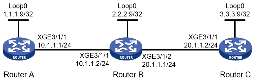

As shown in Figure 1, a CRLSP is set up by using the following steps:
1.     The ingress LSR generates a Path message that carries LABEL_REQUEST, and then forwards the message along the path calculated by CSPF hop-by-hop towards the egress LSR.
2.     After receiving the Path message, the egress LSR generates a Resv message carrying the reservation information and the LABEL object. It forwards the Resv message to the ingress LSR along the reverse direction of the path that the Path message traveled.
The Resv message advertises labels, reserves resources, and creates a reserve state on each LSR it passes, so QoS can be guaranteed for services transmitted on the CRLSP.
3.     When the ingress LSR receives the Resv message, the CRLSP is established.
Figure 1 Setting up a CRLSP

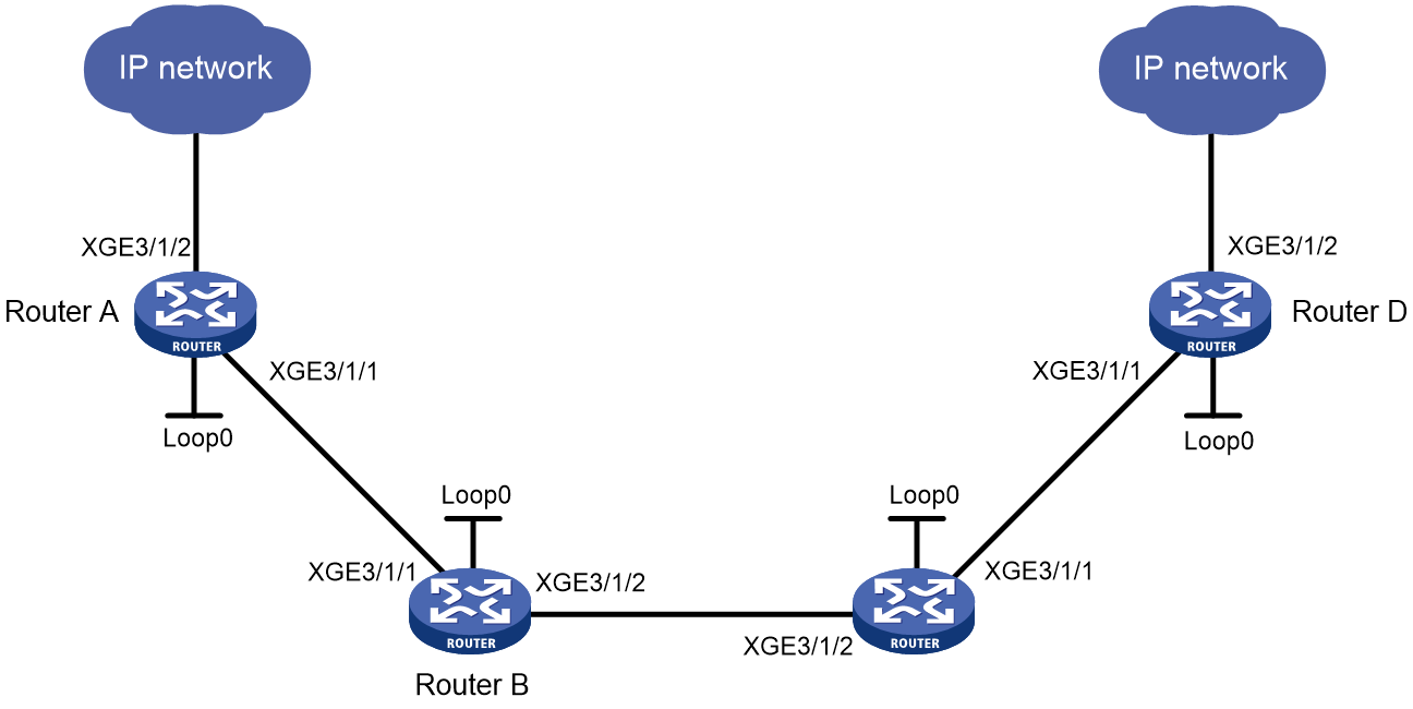

Example: Establishing an MPLS TE tunnel with RSVP-TE
Router A, Router B, Router C, and Router D run IS-IS and all of them are Layer 2 routers.
Use RSVP-TE to establish an MPLS TE tunnel from Router A to Router D to transmit data between the two IP networks. The MPLS TE tunnel requires a bandwidth of 2000 kbps.
The maximum bandwidth of the link that the tunnel traverses is 10000 kbps and the maximum reservable bandwidth of the link is 5000 kbps.
Figure 2 Network diagram
Device
Interface
IP address
Device
Interface
IP address
Router A
Loop0
1.1.1.9/32
Router C
Loop0
3.3.3.9/32
XGE3/1/1
10.1.1.1/24
XGE3/1/1
30.1.1.1/24
XGE3/1/2
100.1.1.1/24
XGE3/1/2
20.1.1.2/24
Router B
Loop0
2.2.2.9/32
Router D
Loop0
4.4.4.9/32
XGE3/1/1
10.1.1.2/24
XGE3/1/1
30.1.1.2/24
XGE3/1/2
20.1.1.1/24
XGE3/1/2
100.1.2.1/24
1.     Configure IP addresses and masks for interfaces. (Details not shown.)
2.     Configure IS-IS to advertise interface addresses, including the loopback interface address:
# Configure Router A.
<RouterA> system-view
[RouterA] isis 1
[RouterA-isis-1] network-entity 00.0005.0000.0000.0001.00
[RouterA-isis-1] quit
[RouterA] interface ten-gigabitethernet 3/1/1
[RouterA-Ten-GigabitEthernet3/1/1] isis enable 1
[RouterA-Ten-GigabitEthernet3/1/1] isis circuit-level level-2
[RouterA-Ten-GigabitEthernet3/1/1] quit
[RouterA] interface loopback 0
[RouterA-LoopBack0] isis enable 1
[RouterA-LoopBack0] isis circuit-level level-2
[RouterA-LoopBack0] quit
# Configure Router B.
<RouterB> system-view
[RouterB] isis 1
[RouterB-isis-1] network-entity 00.0005.0000.0000.0002.00
[RouterB-isis-1] quit
[RouterB] interface ten-gigabitethernet 3/1/1
[RouterB-Ten-GigabitEthernet3/1/1] isis enable 1
[RouterB-Ten-GigabitEthernet3/1/1] isis circuit-level level-2
[RouterB-Ten-GigabitEthernet3/1/1] quit
[RouterB] interface ten-gigabitethernet 3/1/2
[RouterB-Ten-GigabitEthernet3/1/2] isis enable 1
[RouterB-Ten-GigabitEthernet3/1/2] isis circuit-level level-2
[RouterB-Ten-GigabitEthernet3/1/2] quit
[RouterB] interface loopback 0
[RouterB-LoopBack0] isis enable 1
[RouterB-LoopBack0] isis circuit-level level-2
[RouterB-LoopBack0] quit
# Configure Router C.
<RouterC> system-view
[RouterC] isis 1
[RouterC-isis-1] network-entity 00.0005.0000.0000.0003.00
[RouterC-isis-1] quit
[RouterC] interface ten-gigabitethernet 3/1/1
[RouterC-Ten-GigabitEthernet3/1/1] isis enable 1
[RouterC-Ten-GigabitEthernet3/1/1] isis circuit-level level-2
[RouterC-Ten-GigabitEthernet3/1/1] quit
[RouterC] interface ten-gigabitethernet 3/1/2
[RouterC-Ten-GigabitEthernet3/1/2] isis enable 1
[RouterC-Ten-GigabitEthernet3/1/2] isis circuit-level level-2
[RouterC-Ten-GigabitEthernet3/1/2] quit
[RouterC] interface loopback 0
[RouterC-LoopBack0] isis enable 1
[RouterC-LoopBack0] isis circuit-level level-2
[RouterC-LoopBack0] quit
# Configure Router D.
<RouterD> system-view
[RouterD] isis 1
[RouterD-isis-1] network-entity 00.0005.0000.0000.0004.00
[RouterD-isis-1] quit
[RouterD] interface ten-gigabitethernet 3/1/1
[RouterD-Ten-GigabitEthernet3/1/1] isis enable 1
[RouterD-Ten-GigabitEthernet3/1/1] isis circuit-level level-2
[RouterD-Ten-GigabitEthernet3/1/1] quit
[RouterD] interface loopback 0
[RouterD-LoopBack0] isis enable 1
[RouterD-LoopBack0] isis circuit-level level-2
[RouterD-LoopBack0] quit
# Execute the display ip routing-table command on each router to verify that the routers have learned the routes to one another, including the routes to the loopback interfaces. (Details not shown.)
3.     Configure an LSR ID, and enable MPLS, MPLS TE, and RSVP:
[RouterA] mpls lsr-id 1.1.1.9
[RouterA] mpls te
[RouterA-te] quit
[RouterA] rsvp
[RouterA-rsvp] quit
[RouterA-Ten-GigabitEthernet3/1/1] mpls enable
[RouterA-Ten-GigabitEthernet3/1/1] mpls te enable
[RouterA-Ten-GigabitEthernet3/1/1] rsvp enable
[RouterB] mpls lsr-id 2.2.2.9
[RouterB] mpls te
[RouterB-te] quit
[RouterB] rsvp
[RouterB-rsvp] quit
[RouterB-Ten-GigabitEthernet3/1/1] mpls enable
[RouterB-Ten-GigabitEthernet3/1/1] mpls te enable
[RouterB-Ten-GigabitEthernet3/1/1] rsvp enable
[RouterB-Ten-GigabitEthernet3/1/2] mpls enable
[RouterB-Ten-GigabitEthernet3/1/2] mpls te enable
[RouterB-Ten-GigabitEthernet3/1/2] rsvp enable
[RouterC] mpls lsr-id 3.3.3.9
[RouterC] mpls te
[RouterC-te] quit
[RouterC] rsvp
[RouterC-rsvp] quit
[RouterC-Ten-GigabitEthernet3/1/1] mpls enable
[RouterC-Ten-GigabitEthernet3/1/1] mpls te enable
[RouterC-Ten-GigabitEthernet3/1/1] rsvp enable
[RouterC-Ten-GigabitEthernet3/1/2] mpls enable
[RouterC-Ten-GigabitEthernet3/1/2] mpls te enable
[RouterC-Ten-GigabitEthernet3/1/2] rsvp enable
[RouterD] mpls lsr-id 4.4.4.9
[RouterD] mpls te
[RouterD-te] quit
[RouterD] rsvp
[RouterD-rsvp] quit
[RouterD-Ten-GigabitEthernet3/1/1] mpls enable
[RouterD-Ten-GigabitEthernet3/1/1] mpls te enable
[RouterD-Ten-GigabitEthernet3/1/1] rsvp enable
4.     Configure IS-IS TE:
[RouterA] isis 1
[RouterA-isis-1] cost-style wide
[RouterA-isis-1] mpls te enable level-2
[RouterB] isis 1
[RouterB-isis-1] cost-style wide
[RouterB-isis-1] mpls te enable level-2
[RouterC] isis 1
[RouterC-isis-1] cost-style wide
[RouterC-isis-1] mpls te enable level-2
[RouterD] isis 1
[RouterD-isis-1] cost-style wide
[RouterD-isis-1] mpls te enable level-2
5.     Configure MPLS TE attributes of links:
# Set the maximum link bandwidth and maximum reservable bandwidth on Router A.
[RouterA-Ten-GigabitEthernet3/1/1] mpls te max-link-bandwidth 10000
[RouterA-Ten-GigabitEthernet3/1/1] mpls te max-reservable-bandwidth 5000
# Set the maximum link bandwidth and maximum reservable bandwidth on Router B.
[RouterB-Ten-GigabitEthernet3/1/1] mpls te max-link-bandwidth 10000
[RouterB-Ten-GigabitEthernet3/1/1] mpls te max-reservable-bandwidth 5000
[RouterB-Ten-GigabitEthernet3/1/2] mpls te max-link-bandwidth 10000
[RouterB-Ten-GigabitEthernet3/1/2] mpls te max-reservable-bandwidth 5000
# Set the maximum link bandwidth and maximum reservable bandwidth on Router C.
[RouterC-Ten-GigabitEthernet3/1/1] mpls te max-link-bandwidth 10000
[RouterC-Ten-GigabitEthernet3/1/1] mpls te max-reservable-bandwidth 5000
[RouterC-Ten-GigabitEthernet3/1/2] mpls te max-link-bandwidth 10000
[RouterC-Ten-GigabitEthernet3/1/2] mpls te max-reservable-bandwidth 5000
# Set the maximum link bandwidth and maximum reservable bandwidth on Router D.
[RouterD-Ten-GigabitEthernet3/1/1] mpls te max-link-bandwidth 10000
[RouterD-Ten-GigabitEthernet3/1/1] mpls te max-reservable-bandwidth 5000
6.     Configure an MPLS TE tunnel on Router A:
# Configure MPLS TE tunnel interface Tunnel 1.
[RouterA] interface tunnel 1 mode mpls-te
[RouterA-Tunnel1] ip address 7.1.1.1 255.255.255.0
# Specify the tunnel destination address as the LSR ID of Router D.
[RouterA-Tunnel1] destination 4.4.4.9
# Configure MPLS TE to use RSVP-TE to establish the tunnel.
[RouterA-Tunnel1] mpls te signaling rsvp-te
# Assign 2000 kbps bandwidth to the tunnel.
[RouterA-Tunnel1] mpls te bandwidth 2000
[RouterA-Tunnel1] quit
7.     Configure a static route on Router A to direct the traffic destined for subnet 100.1.2.0/24 to MPLS TE tunnel 1.
[RouterA] ip route-static 100.1.2.0 24 tunnel 1 preference 1
# Verify that the tunnel interface is up on Router A.
[RouterA] display interface tunnel
Tunnel1
Interface index: 13888
Current state: UP
Line protocol state: UP
Description: Tunnel1 Interface
Bandwidth: 64kbps
Maximum transmission unit: 64000
Internet address: 7.1.1.1/24 (primary)
Tunnel source unknown, destination 4.4.4.9
Tunnel TTL 255
Tunnel protocol/transport CR_LSP
Output queue - Urgent queuing: Size/Length/Discards 0/100/0
Output queue - Protocol queuing: Size/Length/Discards 0/500/0
Output queue - FIFO queuing: Size/Length/Discards 0/75/0
Last clearing of counters: Never
Last 300 seconds input rate: 0 bytes/sec, 0 bits/sec, 0 packets/sec
Last 300 seconds output rate: 0 bytes/sec, 0 bits/sec, 0 packets/sec
Input: 0 packets, 0 bytes, 0 drops
Output: 0 packets, 0 bytes, 0 drops
# Display detailed information about the MPLS TE tunnel on Router A.
[RouterA] display mpls te tunnel-interface
Tunnel Name            : Tunnel 1
Tunnel State            : Up (Main CRLSP up, Shared-resource CRLSP down)
Tunnel Attributes      :
  LSP ID               : 23331           Tunnel ID            : 1
  Admin State          : Normal
  Ingress LSR ID       : 1.1.1.9         Egress LSR ID        : 4.4.4.9
  Signaling            : RSVP-TE         Static CRLSP Name    : -
  Resv Style           : SE
  Tunnel mode          : -
  Reverse-LSP name     : -
  Reverse-LSP LSR ID   : -               Reverse-LSP Tunnel ID: -
  Class Type           : CT0             Tunnel Bandwidth     : 2000 kbps
  Reserved Bandwidth   : 2000 kbps
  Setup Priority       : 7               Holding Priority     : 7
  Affinity Attr/Mask   : 0/0
  Explicit Path        : -
  Backup Explicit Path : -
  Metric Type          : TE
  Record Route         : Disabled        Record Label         : Disabled
  FRR Flag             : Disabled        Backup Bandwidth Flag: Disabled
  Backup Bandwidth Type: -               Backup Bandwidth     : -
  Route Pinning        : Disabled
  Retry Limit          : 10              Retry Interval       : 2 sec
  Reoptimization       : Disabled        Reoptimization Freq  : -
  Backup Type          : None            Backup LSP ID        : -
  Auto Bandwidth       : Disabled        Auto Bandwidth Freq  : -
  Min Bandwidth        : -               Max Bandwidth        : -
  Collected Bandwidth  : -               Service-Class        : -
# Execute the display ip routing-table command on Router A to verify that a static route entry with interface Tunnel 1 as the output interface exists. (Details not shown.)
Example: Configuring RSVP GR
Router A, Router B, and Router C run IS-IS, and all of them are Layer 2 devices.
Use RSVP-TE to establish a TE tunnel from Router A to Router C.
Configure RSVP GR on the routers to ensure continuous forwarding when a router reboots.
Figure 3 Network diagram
2.     Configure IS-IS to advertise interface addresses, including the loopback interface address. (Details not shown.)
3.     Configure an LSR ID, enable MPLS, MPLS TE, RSVP, and RSVP hello:
[RouterA] mpls te
[RouterA-te] quit
[RouterA] rsvp
[RouterA-rsvp] quit
[RouterA-Ten-GigabitEthernet3/1/1] rsvp hello enable
[RouterB] mpls te
[RouterB-te] quit
[RouterB] rsvp
[RouterB] quit
[RouterB-Ten-GigabitEthernet3/1/1] rsvp hello enable
[RouterB-Ten-GigabitEthernet3/1/2] rsvp hello enable
[RouterC] mpls te
[RouterC-te] quit
[RouterC] rsvp
[RouterC-rsvp] rsvp
[RouterC-mpls] interface ten-gigabitethernet 3/1/1
[RouterC-Ten-GigabitEthernet3/1/1] rsvp hello enable
4.     Configure IS-IS TE. (Details not shown.)
5.     Configure an MPLS TE tunnel. (Details not shown.)
6.     Configure RSVP GR:
[RouterA] rsvp
[RouterA-rsvp] graceful-restart enable
[RouterB] rsvp
[RouterB-rsvp] graceful-restart enable
[RouterC] rsvp
[RouterC-rsvp] graceful-restart enable
After a tunnel is established from Router A to Router C, display detailed RSVP neighbor information on Router A.
<RouterA> display rsvp peer verbose
Peer: 10.1.1.2                            Interface: XGE3/1/1
Hello state: Up                           Hello type: Active
P2P PSB count: 0                          P2P RSB count: 1
P2MP PSB count: 0                         P2MP RSB count: 0
Src instance: 0x1f08                      Dst instance: 0x22
Summary refresh: Disabled                 Graceful Restart state: Ready
Peer GR restart time: 120000 ms           Peer GR recovery time: 0 ms
The output shows that the neighbor's GR state is Ready.
