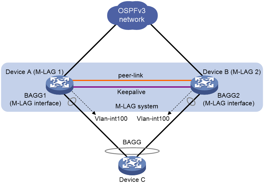

Establishing OSPFv3 neighbor relationships on an M-LAG network
When a customer-side device accesses the OSPFv3 network through both M-LAG member devices in an M-LAG system, the M-LAG member devices provide Layer 3 gateway services. The gateway interfaces (such as VLAN or VSI interfaces) on different M-LAG member devices might generate the same link-local address because they have the same IP address and MAC address. In this case, the M-LAG member devices cannot establish OSPFv3 neighbor relationships with the customer-side device.
To resolve this issue, configure the gateway interfaces to use M-LAG virtual IPv6 addresses for OSPFv3 neighbor relationship establishment. The M-LAG virtual IPv6 address configured for a gateway interface must be a link-local address because OSPFv3 uses link-local addresses for OSPFv3 neighbor relationship establishment. For more information about M-LAG, see M-LAG configuration in Layer 2—LAN Switching Configuration Guide.
As shown in Figure 1, Device C accesses the OSPFv3 network through the M-LAG system that consists of Device A and Device B. Device A and Device B provide Layer 3 gateway services. The gateway interface VLAN-interface 100 on Device A and the gateway interface VLAN-interface 100 on Device B have the same IP address and the same MAC address. To ensure that both Device A and Device B can establish an OSPFv3 neighbor relationship with Device C, configure different M-LAG virtual IPv6 addresses for the VLAN interfaces on Device A and Device B.
Figure 1 OSPFv3 neighbor relationship establishment on an M-LAG network
2.     Enter interface view.
3.     Specify a link-local address as the M-LAG virtual IPv6 address to be assigned to the interface.
port m-lag ipv6 virtual-ip ipv6-address link-local
By default, no M-LAG virtual IPv6 address is assigned to an interface.
For more information about this command, see M-LAG commands in Layer 2—LAN Switching Ethernet Command Reference.

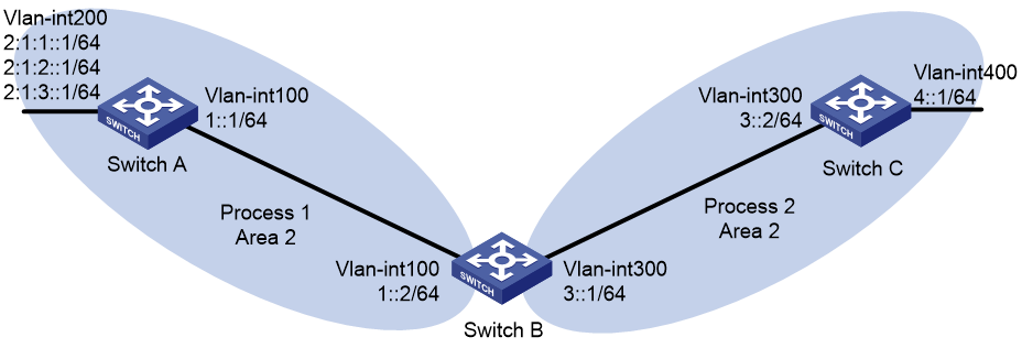

Example: Configuring OSPFv3 route summarization
As shown in Figure 9:
·     Switch A, Switch B, and Switch C are in Area 2.
·     OSPFv3 process 1 and OSPFv3 process 2 run on Switch B. Switch B communicates with Switch A and Switch C through OSPFv3 process 1 and OSPFv3 process 2, respectively.
·     On Switch A, configure IPv6 addresses 2:1:1::1/64, 2:1:2::1/64, and 2:1:3::1/64 for VLAN-interface 200.
·     On Switch B, configure OSPFv3 process 2 to redistribute direct routes and the routes from OSPFv3 process 1. Switch C can then learn the routes destined for 2::/64, 2:1:1::/64, 2:1:2::/64, and 2:1:3::/64.
·     On Switch B, configure route summarization to advertise only summary route 2::/16 to Switch C.
Figure 9 Network diagram
1.     Configure IPv6 addresses for interfaces. (Details not shown.)
2.     Configure OSPFv3:

3.     Configure OSPFv3 route redistribution:
# Configure OSPFv3 process 2 to redistribute direct routes and the routes from OSPFv3 process 1 on Switch B.
[SwitchB] ospfv3 2
[SwitchB-ospfv3-2] import-route ospfv3 1
[SwitchB-ospfv3-2] import-route direct
[SwitchB-ospfv3-2] quit
# Display the routing table on Switch C.

# On Switch B, configure OSPFv3 process 2 to advertise a single route 2::/16.
[SwitchB] ospfv3 2
[SwitchB-ospfv3-2] asbr-summary 2:: 16

Example: Configuring OSPFv3 IPsec profile
As shown in Figure 14, all switches run OSPFv3, and the AS is divided into two areas.
Configure IPsec profiles on the switches to authenticate and encrypt protocol packets.
Figure 14 Network diagram
2.     Configure OSPFv3 basic features:
# On Switch A, enable OSPFv3 and specify the router ID as 1.1.1.1.
<SwitchA> system-view
[SwitchA] ospfv3 1
[SwitchA-ospfv3-1] router-id 1.1.1.1
[SwitchA-ospfv3-1] quit
[SwitchA] interface vlan-interface 200
[SwitchA-Vlan-interface200] ospfv3 1 area 1
[SwitchA-Vlan-interface200] quit
# On Switch B, enable OSPFv3 and specify the router ID as 2.2.2.2.
<SwitchB> system-view
[SwitchB] ospfv3 1
[SwitchB-ospfv3-1] router-id 2.2.2.2
[SwitchB-ospfv3-1] quit
[SwitchB-Vlan-interface100] ospfv3 1 area 0
[SwitchB] interface vlan-interface 200
[SwitchB-Vlan-interface200] ospfv3 1 area 1
[SwitchB-Vlan-interface200] quit
# On Switch C, enable OSPFv3 and specify the router ID as 3.3.3.3.
<SwitchC> system-view
[SwitchC] ospfv3 1
[SwitchC-ospfv3-1] router-id 3.3.3.3
[SwitchC-ospfv3-1] quit
[SwitchC] interface vlan-interface 100
[SwitchC-Vlan-interface100] ospfv3 1 area 0
[SwitchC-Vlan-interface100] quit
3.     Configure OSPFv3 IPsec profiles:
¡     On Switch A:
# Create an IPsec transform set named trans.
[SwitchA] ipsec transform-set trans
# Specify the encapsulation mode as transport.
[SwitchA-ipsec-transform-set-trans] encapsulation-mode transport
# Specify the ESP encryption and authentication algorithms.
[SwitchA-ipsec-transform-set-trans] protocol esp
[SwitchA-ipsec-transform-set-trans] esp encryption-algorithm aes-cbc-128
[SwitchA-ipsec-transform-set-trans] esp authentication-algorithm sha1
[SwitchA-ipsec-transform-set-trans] quit
# Create a manual IPsec profile named profile001.
[SwitchA] ipsec profile profile001 manual
# Use IPsec transform set trans.
[SwitchA-ipsec-profile-manual-profile001] transform-set trans
# Configure the inbound and outbound SPIs for ESP.
[SwitchA-ipsec-profile-manual-profile001] sa spi outbound esp 123456
[SwitchA-ipsec-profile-manual-profile001] sa spi inbound esp 123456
# Configure the inbound and outbound SA keys for ESP.
[SwitchA-ipsec-profile-manual-profile001] sa string-key outbound esp simple abcdefg
[SwitchA-ipsec-profile-manual-profile001] sa string-key inbound esp simple abcdefg
[SwitchA-ipsec-profile-manual-profile001] quit
¡     On Switch B:
[SwitchB] ipsec transform-set trans
[SwitchB-ipsec-transform-set-trans] encapsulation-mode transport
[SwitchB-ipsec-transform-set-trans] protocol esp
[SwitchB-ipsec-transform-set-trans] esp encryption-algorithm aes-cbc-128
[SwitchB-ipsec-transform-set-trans] esp authentication-algorithm sha1
[SwitchB-ipsec-transform-set-trans] quit
[SwitchB] ipsec profile profile001 manual
[SwitchB-ipsec-profile-manual-profile001] transform-set trans
[SwitchB-ipsec-profile-manual-profile001] sa spi outbound esp 123456
[SwitchB-ipsec-profile-manual-profile001] sa spi inbound esp 123456
[SwitchB-ipsec-profile-manual-profile001] sa string-key outbound esp simple abcdefg
[SwitchB-ipsec-profile-manual-profile001] sa string-key inbound esp simple abcdefg
[SwitchB-ipsec-profile-manual-profile001] quit
# Create a manual IPsec profile named profile002.
[SwitchB] ipsec profile profile002 manual
[SwitchB-ipsec-profile-manual-profile002] transform-set trans
[SwitchB-ipsec-profile-manual-profile002] sa spi outbound esp 256
[SwitchB-ipsec-profile-manual-profile002] sa spi inbound esp 256
[SwitchB-ipsec-profile-manual-profile002] sa string-key outbound esp simple byebye
[SwitchB-ipsec-profile-manual-profile002] sa string-key inbound esp simple byebye
[SwitchB-ipsec-profile-manual-profile002] quit
¡     On Switch C:
[SwitchC] ipsec transform-set trans
[SwitchC-ipsec-transform-set-trans] encapsulation-mode transport
[SwitchC-ipsec-transform-set-trans] protocol esp
[SwitchC-ipsec-transform-set-trans] esp encryption-algorithm aes-cbc-128
[SwitchC-ipsec-transform-set-trans] esp authentication-algorithm sha1
[SwitchC-ipsec-transform-set-trans] quit
[SwitchC] ipsec profile profile002 manual
[SwitchC-ipsec-profile-manual-profile002] transform-set trans
[SwitchC-ipsec-profile-manual-profile002] sa spi outbound esp 256
[SwitchC-ipsec-profile-manual-profile002] sa spi inbound esp 256
[SwitchC-ipsec-profile-manual-profile002] sa string-key outbound esp simple byebye
[SwitchC-ipsec-profile-manual-profile002] sa string-key inbound esp simple byebye
[SwitchC-ipsec-profile-manual-profile002] quit
4.     Apply the IPsec profiles to areas:
