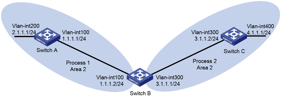

OSPF supports multiple processes. To run multiple OSPF processes, you must specify an ID for each process. The process IDs take effect locally and has no influence on packet exchange between routers. Two routers with different process IDs can exchange packets.
OSPF supports multiple VPNs. You can configure an OSPF process to run in a VPN instance. An OSPF process with no VPN instance specified runs on the public network. For more information about VPN, see MPLS Configuration Guide.

Example: Configuring OSPF route summarization on an ASBR
As shown in Figure 16:
·     Configure OSPF on Switch A, Switch B, and Switch C in Area 2.
·     Enable OSPF process 1 and process 2 on Switch B. Switch B uses OSPF process 1 to exchange routing information with Switch A, and uses OSPF process 2 to exchange routing information with Switch C.
·     Assign IP addresses 2.1.2.1/24, 2.1.3.1/24, and 2.1.4.1/24 to VLAN-interface 200 of Switch A. To enable Switch C to learn routes destined for 2.1.2.0/24, 2.1.3.0/24, 2.1.4.0/24, configure OSPF process 2 on Switch B to redistribute routes from process 1 and direct routes.
·     To minimize the size of the routing table on Switch C, configure ASBR route summarization on Switch B. Switch B advertises only the summary route 2.0.0.0/8.
Figure 16 Network diagram
1.     Configure IP addresses for interfaces. (Details not shown.)
2.     Configure OSPF:
# Enable OSPF process 1 on Switch A.
<SwitchA> system-view
[SwitchA] router id 11.2.1.1
[SwitchA] interface vlan-interface 200
[SwitchA-Vlan-interface200] ip address 2.1.2.1 24
[SwitchA-Vlan-interface200] ip address 2.1.3.1 24 sub
[SwitchA-Vlan-interface200] ip address 2.1.4.1 24 sub
[SwitchA-Vlan-interface200] quit
[SwitchA] ospf 1
[SwitchA-ospf-1] area 2
[SwitchA-ospf-1-area-0.0.0.2] network 1.1.1.0 0.0.0.255
[SwitchA-ospf-1-area-0.0.0.2] network 2.1.0.0 0.0.255.255
[SwitchA-ospf-1-area-0.0.0.2] quit
[SwitchA-ospf-1] quit
# Enable OSPF process 1 and process 2 on Switch B.
<SwitchB> system-view
[SwitchB] router id 11.2.1.2
[SwitchB] ospf 1
[SwitchB-ospf-1] area 2
[SwitchB-ospf-1-area-0.0.0.2] network 1.1.1.0 0.0.0.255
[SwitchB-ospf-1-area-0.0.0.2] quit
[SwitchB-ospf-1] quit
[SwitchB] ospf 2
[SwitchB-ospf-2] area 2
[SwitchB-ospf-2-area-0.0.0.2] network 3.1.1.0 0.0.0.255
[SwitchB-ospf-2-area-0.0.0.2] quit
[SwitchB-ospf-2] quit
# Enable OSPF process 2 on Switch C.
<SwitchC> system-view
[SwitchC] router id 11.1.1.2
[SwitchC] ospf 2
[SwitchC-ospf-2] area 2
[SwitchC-ospf-2-area-0.0.0.2] network 3.1.1.0 0.0.0.255
[SwitchC-ospf-2-area-0.0.0.2] network 4.1.0.0 0.0.255.255
[SwitchC-ospf-2-area-0.0.0.2] quit
[SwitchC-ospf-2] quit
3.     Configure OSPF to redistribute routes:
# Configure OSPF process 2 on Switch B to redistribute routes from OSPF process 1 and direct routes.
[SwitchB] ospf 2
[SwitchB-ospf-2]import-route direct
[SwitchB-ospf-2]import-route ospf 1
# Display routing table information on Switch C.
[SwitchC] display ip routing-table
Destinations : 28       Routes : 28
Destination/Mask   Proto   Pre Cost        NextHop         Interface
0.0.0.0/32         Direct  0   0           127.0.0.1       InLoop0
1.1.1.0/24         O_ASE2  150 1           3.1.1.1         Vlan300
2.1.2.0/24         O_ASE2  150 1           3.1.1.1         Vlan300
2.1.3.0/24         O_ASE2  150 1           3.1.1.1         Vlan300
2.1.4.0/24         O_ASE2  150 1           3.1.1.1         Vlan300
3.1.1.0/24         Direct  0   0           3.1.1.2         Vlan300
3.1.1.0/32         Direct  0   0           3.1.1.2         Vlan300
3.1.1.2/32         Direct  0   0           127.0.0.1       InLoop0
3.1.1.255/32       Direct  0   0           3.1.1.2         Vlan300
4.1.1.0/24         Direct  0   0           4.1.1.1         Loop101
4.1.1.0/32         Direct  0   0           4.1.1.1         Loop101
4.1.1.1/32         Direct  0   0           127.0.0.1       InLoop0
4.1.1.255/32       Direct  0   0           4.1.1.1         Loop101
4.1.2.0/24         Direct  0   0           4.1.2.1         Loop102
4.1.2.0/32         Direct  0   0           4.1.2.1         Loop102
4.1.2.1/32         Direct  0   0           127.0.0.1       InLoop0
4.1.2.255/32       Direct  0   0           4.1.2.1         Loop102
4.1.3.0/24         Direct  0   0           4.1.3.1         Loop103
4.1.3.0/32         Direct  0   0           4.1.3.1         Loop103
4.1.3.1/32         Direct  0   0           127.0.0.1       InLoop0
4.1.3.255/32       Direct  0   0           4.1.3.1         Loop103
127.0.0.0/8        Direct  0   0           127.0.0.1       InLoop0
127.0.0.0/32       Direct  0   0           127.0.0.1       InLoop0
127.0.0.1/32       Direct  0   0           127.0.0.1       InLoop0
127.255.255.255/32 Direct  0   0           127.0.0.1       InLoop0

4.     Configure OSPF to summarize routes on the ASBR:
# Configure OSPF process 2 on Switch B to advertise summary route 2.0.0.0/8.
[SwitchB] ospf 2
[SwitchB-ospf-2] asbr-summary 2.0.0.0 8
[SwitchC]display ip routing-table
Destinations : 26       Routes : 26
