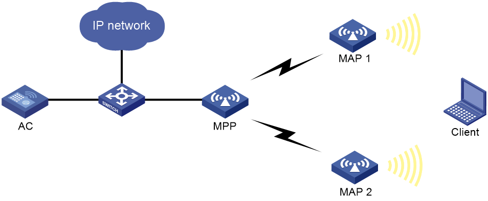

WLAN mesh network

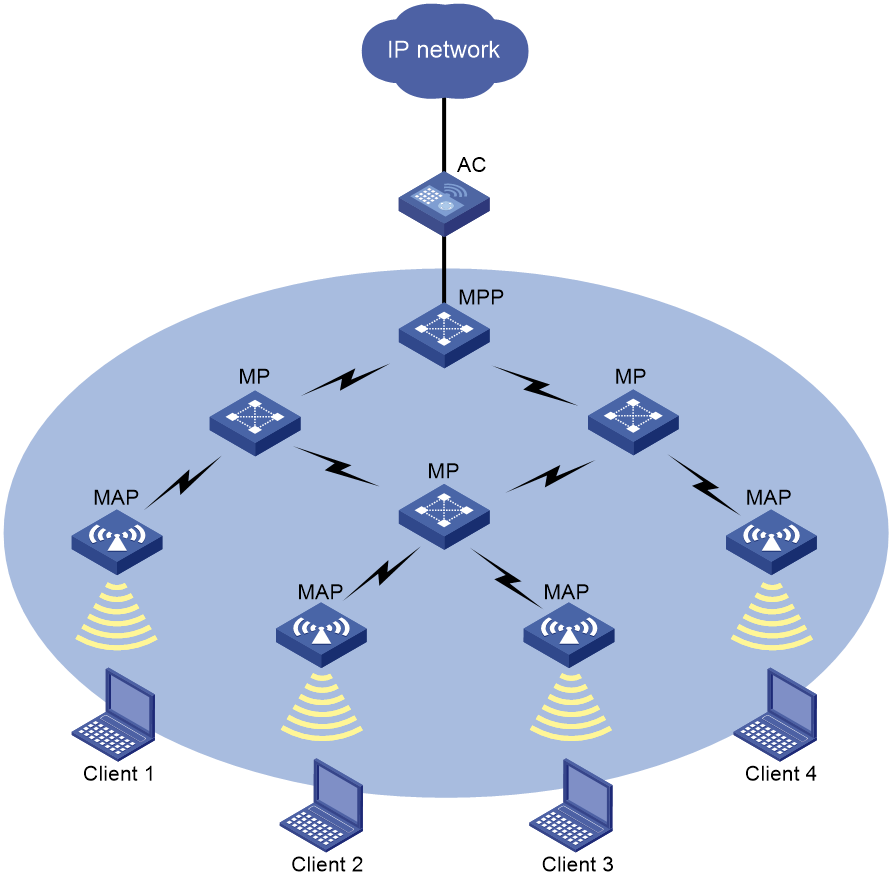

Figure 1 shows a WLAN mesh network.
APs on a WLAN mesh network are mesh points (MPs). MPs play the following roles:
·     Single-purpose MP—Provides only mesh services.
·     Mesh access point (MAP)—Provides both mesh and access services.
·     Mesh portal point (MPP)—Provides a wired connection to a wired network.
Figure 1 WLAN mesh network diagram

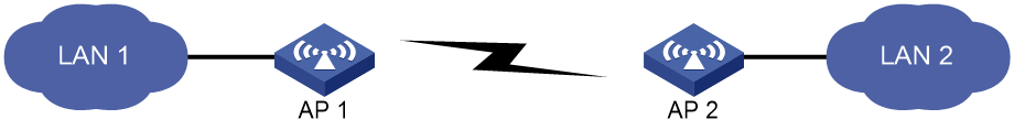

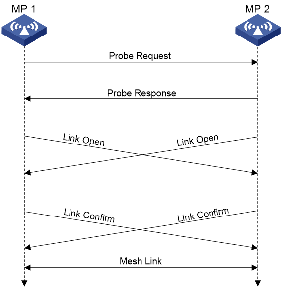

Point-to-point topology
As shown in Figure 3, you can set up a mesh link between two APs to connect two LANs.
Figure 3 WDS point to point topology

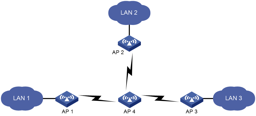

Star topology
As shown in Figure 4, you can set up mesh links between one central AP and multiple leaf APs to connect multiple LANs. In this topology, all data between LANs must traverse the central AP (AP 4 in this example).
Figure 4 Star topology

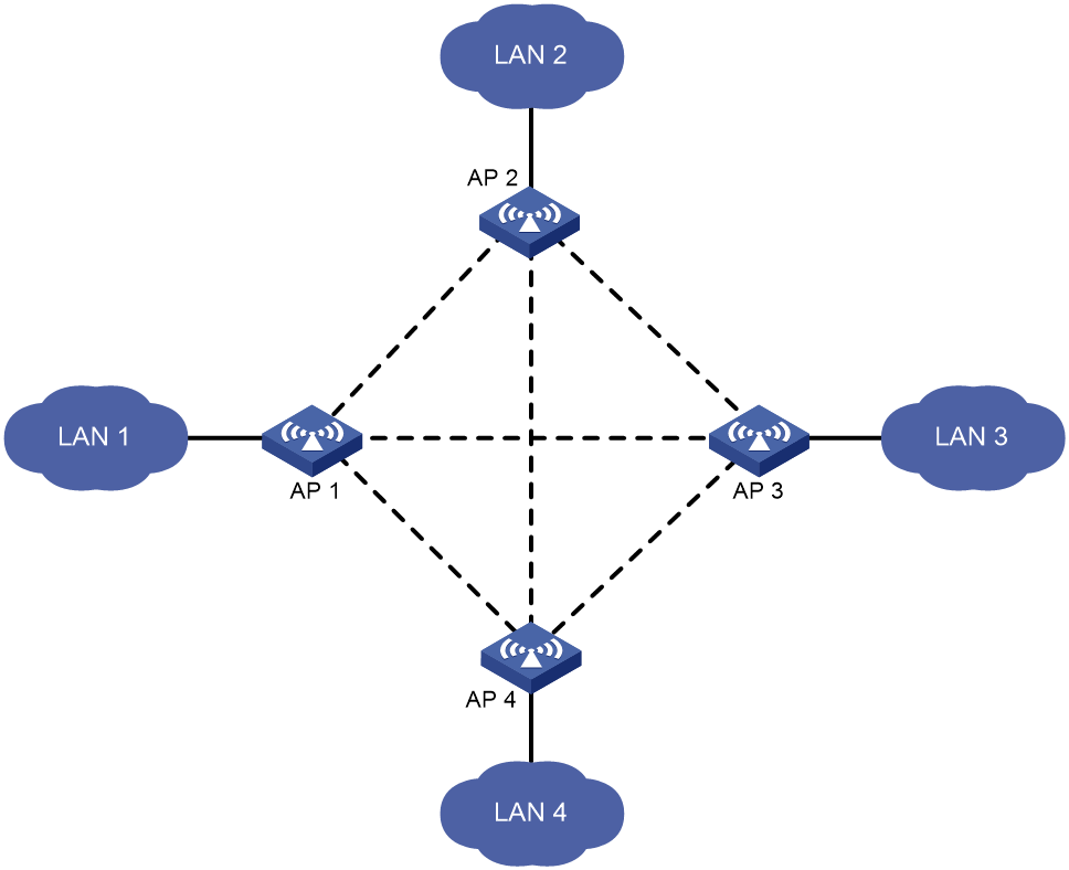

Topology created without administrative intervention
Without administrative intervention, the WDS topology depends on the result of automatic neighbor discovery and mesh link establishment between APs.

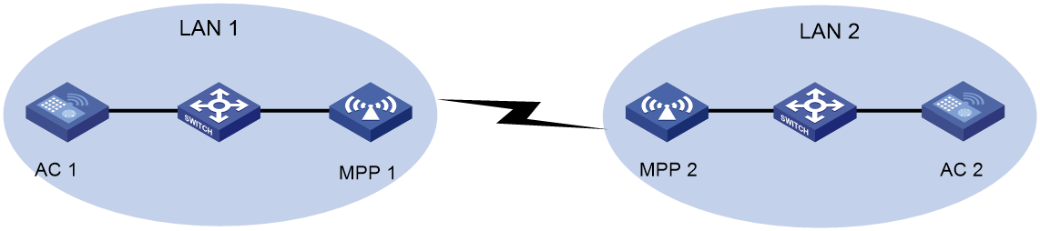

VLAN
VLANs can be deployed in mesh networks for devices in different LANs to communicate with each other. Figure 6 shows the application of VLANs in high-speed railway mesh networks.
As shown in Figure 6, an AC and multiple APs are deployed in each carriage on a train. All devices are assigned to the same VLAN. Therefore, the two APs at both ends of each carriage can act as MPPs to establish mesh links with the MPPs on the adjacent carriages. Other APs provide WLAN access services. All devices communicate with the outside through the central server deployed in the middle of the train.
In this scenario, IP address conflict might occur because all ACs use the same configuration for easy configuration and maintenance. To address this issue, configure NAT on each AC and configure the mesh interfaces to allow the VLAN for MPP communications. For more information about NAT, see Network Connectivity Configuration Guide.

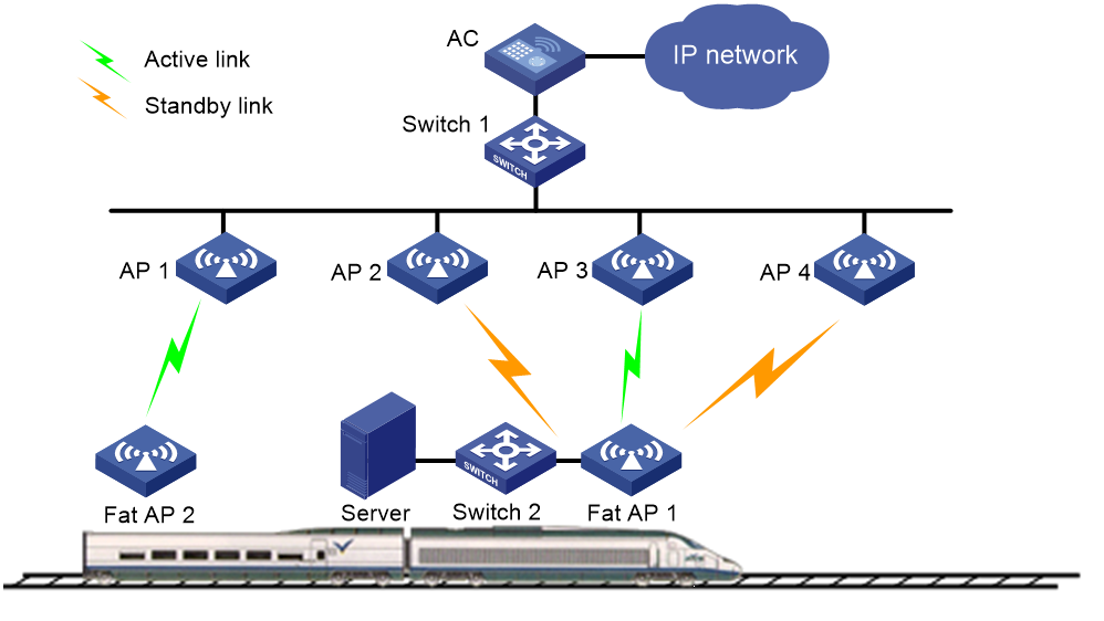

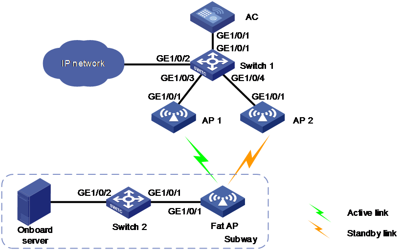

MLSP
MLSP requires cooperation of both ACs and fat APs.
Mobile Link Switch Protocol (MLSP) is designed for subway application to provide stable data transmission through mesh links between onboard and trackside MPs. The onboard MPs are responsible for link selection, maintenance, and switchover.
With MLSP enabled, each onboard MP maintains one active link and multiple standby links at the same time. Only the active link is used for data transmission. An onboard MP keeps switching its active link during train movement to ensure stable data transmission.
In subway applications, signals can be transmitted over the air, in waveguides, or in linking coaxial (LCX) cables. Signals transmitted over the air are called air signal and signals transmitted in waveguides or LCX cables are called waveguide signals. As a best practice to avoid signal interference, deploy waveguides or LCX cables in areas with strong interference.
As shown in Figure 7, AP 1 through AP 4 are trackside MPs, and fat AP 1 and fat AP 2 are onboard MPs.
Figure 7 MLSP mesh network diagram
Air signal link switchover
An onboard MP uses a mesh link as a standby link if the RSSI on the link reaches or exceeds the sum of the link establishment threshold and the mesh link hold RSSI. If the MP does not have an active link, it uses the link as the active link.
An onboard MP switches to the optimal standby mesh link when one of the following conditions is met:
·     The link hold timer expires and a standby link has an RSSI higher than the active link for a value that reaches or exceeds the link switchover threshold.
·     The RSSI on the active link is lower than the mesh link hold RSSI.
·     The RSSI on the active link reaches or exceeds the link saturation RSSI.
If no standby link is available, the MP keeps using the active link when the RSSI on the active link is lower than the mesh link hold RSSI. The MP terminates the active link when the active link RSSI reaches or exceeds the link saturation RSSI.

Configuring MLSP
Prerequisites for MLSP
Make sure you have finished basic mesh profile and mesh policy configuration and the onboard MPs can successfully establish mesh links with the trackside MPs.
Configuring trackside MPs
2.     Enter mesh policy view.
wlan mesh-policy policy-name
3.     Enable mesh link initiation.
link-initiation enable
By default, mesh link initiation is enabled.
4.     Specify the signal transmission method.
transmission-method { air | waveguide }
By default, signals are transmitted over the air.
5.     (Optional.) Configure mesh link establishment and maintenance:
¡     Set the mesh link establishment threshold.
link-establish-threshold threshold-value
By default, the mesh link establishment threshold is 5 dBm.
¡     Set the mesh link hold RSSI.
link-hold-rssi value
By default, the mesh link hold RSSI is 15.
As a best practice, set the link hold RSSI for trackside MPs smaller than the link hold RSSI for onboard MPs in case the trackside MPs terminates mesh links actively.
¡     Set the mesh link saturation RSSI.
link-saturation-rssi value
By default, the mesh link saturation RSSI is 150.
¡     Disable temporary mesh link establishment.
undo temporary-link enable
By default, temporary mesh link establishment is enabled.
To prevent frequent temporary mesh link establishment from affecting trackside MP performance, you can disable this feature.
¡     Set the level of interval for sending keepalive requests.
active-link keepalive-transmit-level value
By default, the level of interval for sending keepalive request is 0.
Set the level on the AC that manages trackside MPs. Trackside MPs inform onboard MPs of the level to control the keepalive requests sent by the onboard MPs.
Enabling Comware 7 APs to establish mesh connections with Comware 5 APs
In a scenario where both Comware 7 and Comware 5 APs are deployed, enable this feature for all Comware 7 APs that require mesh connections.
By default, a default mesh policy named default_mesh_policy exists.
3.     Enable Comware 7 APs to establish mesh connections with Comware 5 APs.
comware5-compatibility enable
By default, Comware 7 APs cannot establish mesh connections with Comware 5 APs.

As shown in Figure 9, establish an 802.11n 5GHz WLAN mesh network to provide network access for the clients. Configure the MP and MAPs to establish mesh links on channel 149.
Figure 9 Network diagram
1.     Configure a mesh profile:
# Create a mesh profile.
<AC> system-view
[AC] wlan mesh-profile 1
# Set the mesh ID to 1.
[AC-wlan-mesh-profile-1] mesh-id 1
# Enable SAE for authentication and key management.
[AC-wlan-mesh-profile-1] akm mode sae
# Configure a preshared key.
[AC-wlan-mesh-profile-1] preshared-key pass-phrase simple 12345678
# Enable the mesh profile.
[AC-wlan-mesh-profile-1] mesh-profile enable
[AC-wlan-mesh-profile-1] quit
2.     Configure a service template.
[AC] wlan service-template service1
[AC-wlan-st-service1] ssid mesh-network
[AC-wlan-st-service1] service-template enable
[AC-wlan-st-service1] quit
3.     Configure settings for the MPP:
# Create an AP template for the MPP. Make sure you select the correct AP model and specify the correct serial ID.
[AC] wlan ap mpp model WA6320
[AC-wlan-ap-mpp] serial-id 219801A28N819CE0002T
# Bind the mesh profile to the MPP's radio 1.
[AC-wlan-ap-mpp] radio 1
[AC-wlan-ap-mpp-radio-1] mesh-profile 1
# Set the radio type of the MPP's radio 1 to 802.11n (5GHz).
[AC-wlan-ap-mpp-radio-1] type dot11an
# Set the working channel of the radio to 149.
[AC-wlan-ap-mpp-radio-1] channel 149
# Enable the radio.
[AC-wlan-ap-mpp-radio-1] radio enable
[AC-wlan-ap-mpp-radio-1] quit
# Disable the MPP from sending neighbor probe requests.
[AC-wlan-ap-mpp] portal-service enable
[AC-wlan-ap-mpp] quit
4.     Configure settings for the MAPs:
# Create an AP template for MAP 1. Make sure you select the correct AP model and specify the correct serial ID.
[AC] wlan ap map1 model WA6320
[AC-wlan-ap-map1] serial-id 219801A28N819CE0002T
# Bind the mesh profile to the MAP's radio 1.
[AC-wlan-ap-map1] radio 1
[AC-wlan-ap-map1-radio-1] mesh-profile 1
# Bind the service template to the MAP's radio 1.
[AC-wlan-ap-map1-radio-1] service-template service1
# Set the radio type of the MAP's radio 1 to 802.11n (5GHz).
[AC-wlan-ap-map1-radio-1] type dot11an
[AC-wlan-ap-map1-radio-1] channel 149
# Add the MAC address of a radio on the MPP to the mesh peer whitelist to avoid loops. MAP 1 can set up a mesh link only with the MPP.
[AC-wlan-ap-map1-radio-1] mesh peer-mac-address 77a2-c25d-e316
# Enable the radio.
[AC-wlan-ap-map1-radio-1] radio enable
[AC-wlan-ap-map1-radio-1] quit
[AC-wlan-ap-map1] quit
# Configure settings for MAP 2 in the same way settings for MAP 1 are configured.
[AC] wlan ap map2 model WA6320
[AC-wlan-ap-map2] serial-id 219801A28N819CE0002T
[AC-wlan-ap-map2] radio 1
[AC-wlan-ap-map2-radio-1] mesh-profile 1
[AC-wlan-ap-map2-radio-1] service-template service1
[AC-wlan-ap-map2-radio-1] type dot11an
[AC-wlan-ap-map2-radio-1] channel 149
[AC-wlan-ap-map2-radio-1] mesh peer-mac-address 77a2-c25d-e316
[AC-wlan-ap-map2-radio-1] radio enable
[AC-wlan-ap-map2-radio-1] quit
[AC-wlan-ap-map2] quit
[AC] quit
# Verify that the MPP and MAPs can establish mesh links.
<AC> display wlan mesh-link ap
AP Name: mpp
 Peer           Local          Status     RSSI Packets(Rx/Tx)
 4a9b-c5bb-e43f 77a2-c25d-e316 Forwarding 22   6058/1900
 a6b5-1c5a-22ff 77a2-c25d-e316 Forwarding 35   5354/1900
AP Name: map1
 77a2-c25d-e316 4a9b-c5bb-e43f Forwarding 22   1900/6058
AP Name: map2
 77a2-c25d-e316 a6b5-1c5a-22ff Forwarding 35   1900/5354
# Verify that the clients have associated with their respective APs.
<AC> display wlan client
Total number of clients: 1
MAC address    Username             AP name               R IP address      VLAN ID
000f-e265-6400 N/A                  map1                  1 1.1.1.1         300
Example: Configuring VLAN settings for a WLAN mesh network
As shown in Figure 10, both LAN 1 and LAN 2 belong to VLAN 2. Configure MPP 1 and MPP 2 to establish a mesh link on channel 149, and to permit traffic from VLAN 2.
Figure 10 Network diagram
<AC1> system-view
[AC1] wlan mesh-profile 1
[AC1-wlan-mesh-profile-1] mesh-id 1
[AC1-wlan-mesh-profile-1] akm mode sae
[AC1-wlan-mesh-profile-1] preshared-key pass-phrase simple 12345678
[AC1-wlan-mesh-profile-1] mesh-profile enable
[AC1-wlan-mesh-profile-1] quit
[AC1] wlan service-template service1
[AC1-wlan-st-service1] ssid mesh-network
[AC1-wlan-st-service1] service-template enable
[AC1-wlan-st-service1] quit
[AC1] wlan ap mpp1 model WA6320
[AC1-wlan-ap-mpp1] serial-id 219801A28N819CE0002T
# Bind the mesh profile to radio 1 of the MPP.
[AC1-wlan-ap-mpp1] radio 1
[AC1-wlan-ap-mpp1-radio-1] mesh-profile 1
# Set the radio type for radio 1 of the MPP to 802.11n (5GHz).
[AC1-wlan-ap-mpp1-radio-1] type dot11an
[AC1-wlan-ap-mpp1-radio-1] channel 149
# Enable the radio.
[AC1-wlan-ap-mpp1-radio-1] radio enable
[AC1-wlan-ap-mpp1-radio-1] quit
4.     Configure the mesh interface:
# Create mesh interface 1.
[AC1-wlan-ap-mpp1] interface wlan-mesh 1
[AC1-wlan-ap-mpp1-wlan-mesh-1] quit
# Bind the mesh interface to radio 1 of the MPP.
[AC1-wlan-ap-mpp1-radio-1] mesh-interface 1
# Set the link type to trunk.
[AC1-wlan-ap-mpp1-wlan-mesh-1] mesh-port link type trunk
# Assign the trunk port to VLAN 2.
[AC1-wlan-ap-mpp1-wlan-mesh-1] mesh-port trunk permit vlan 2
# Enable remote configuration assignment.
[AC1-wlan-ap-mpp1] remote-configuration enable
5.     Configure AC 2 in the same way AC 1 is configured.
# Configure VLAN-interface 2 on both AC 1 and AC 2 to verify that AC 1 and AC 2 can ping each other successfully.
Example: Configuring MLSP
As shown in Figure 11, trackside MPs (AP 1 and AP 2) are connected to the AC through Switch 1, and the onboard MP (fat AP) is connected to the onboard server through Switch 2. Configure MLSP for the onboard MP to communicate with trackside MPs.
Figure 11 Network diagram
·     If multiple servers exist on the train, and each server must be connected to a different VLAN, configure the following settings:
¡     Create VLANs and VLAN interfaces on Switch 2. The VLAN interfaces are used as the gateways for the servers.
¡     Configure a static route from the IP network to each server.
¡     If onboard devices and devices on the IP network communicate at Layer 3 and onboard MPs are deployed at both ends of the train, OSPF is required for traffic between these devices to be dynamically forwarded by the MP at the front or rear. You must configure the network type as NBMA on VLAN interfaces on Switch 1 and Switch 2, and manually specify the neighbor for the interfaces.
1.     Specify the IP address and gateway of the onboard server as 192.168.20.3 and 192.168.20.2, respectively. (Details not shown.)
2.     Configure the onboard MP:
# Create VLAN 30 and VLAN-interface 30, and specify an IP address for the VLAN interface. This VLAN will be used as the management VLAN.
<FatAP> system-view
[FatAP] vlan 30
[FatAP-vlan30] quit
[FatAP] interface vlan-interface 30
[FatAP-Vlan-interface30] ip address 30.1.1.2 255.255.255.0
[FatAP-Vlan-interface30] quit
# Create VLAN 40. This VLAN will be used as the service VLAN.
[FatAP] vlan 40
[FatAP-vlan40] quit
# Configure GigabitEthernet 1/0/1 that connects the fat AP to Switch 2 as a trunk port, and assign the port to VLANs 30 and 40.
[FatAP] interface gigabitethernet 1/0/1
[FatAP-GigabitEthernet1/0/1] port link-type trunk
[FatAP-GigabitEthernet1/0/1] port trunk permit vlan 30 40
[FatAP-GigabitEthernet1/0/1] quit
[FatAP] wlan mesh-profile 1
[FatAP-wlan-mesh-profile-1] mesh-id 1
[FatAP-wlan-mesh-profile-1] akm mode sae
[FatAP-wlan-mesh-profile-1] preshared-key pass-phrase simple 12345678
[FatAP-wlan-mesh-profile-1] mesh-profile enable
[FatAP-wlan-mesh-profile-1] quit
# Create mesh policy 1 and enable mesh link initiation.
[FatAP] wlan mesh-policy 1
[FatAP-wlan-mesh-policy-1] link-initiation enable
# Enable MLSP.
[FatAP-wlan-mesh-policy-1] mlsp enable
# Set the mesh link establishment threshold to 3.
[FatAP-wlan-mesh-policy-1] link-establish-threshold 3
# Set the mesh link hold RSSI to 20.
[FatAP-wlan-mesh-policy-1] link-hold-rssi 20
# Set the mesh link saturation RSSI to 100.
[FatAP-wlan-mesh-policy-1] link-saturation-rssi 100
# Set the mesh link hold time to 4000.
[FatAP-wlan-mesh-policy-1] link-hold-time 4000
# Set the mesh link keepalive packet limit for the active link to 5.
[FatAP-wlan-mesh-policy-1] active-link keepalive-count 5
# Set the mesh link switchover threshold to 5.
[FatAP-wlan-mesh-policy-1] link-switch-threshold 5
# Set the probe request interval to 100.
[FatAP-wlan-mesh-policy-1] probe-request-interval 100
# Configure the MP to proxy the gateway for the onboard server. The gateway is VLAN-interface 40 on Switch 2.
[FatAP-wlan-mesh-policy-1] mlsp-proxy mac-address 000f-e201-0101 vlan 40 ip 192.168.20.2
# Configure the MP to proxy the management VLAN interface VLAN-interface 30 on Switch 2.
[FatAP-wlan-mesh-policy-1] mlsp-proxy mac-address 000f-e201-0101 vlan 30 ip 30.1.1.3
[FatAP-wlan-mesh-policy-1] quit
# Bind mesh profile 1 to radio interface WLAN-Radio 1/0/1.
[FatAP] interface wlan-radio 1/0/1
[FatAP-WLAN-Radio1/0/1] mesh-profile 1
# Set the radio mode to 802.11ac (5 GHz).
[FatAP-WLAN-Radio1/0/1] type dot11ac
# Set the working channel to 149.
[FatAP-WLAN-Radio1/0/1] channel 149
# Bind mesh policy 1 to radio interface WLAN-Radio 1/0/1.
[FatAP-WLAN-Radio1/0/1] mesh-policy name 1
# Enable the radio interface.
[FatAP-WLAN-Radio1/0/1] undo shutdown
[FatAP-WLAN-Radio1/0/1] quit
# Create a mesh interface.
[FatAP] interface wlan-mesh 1
# Configure the mesh interface as a trunk port.
[FatAP-WLAN-Mesh1] port link-type trunk
# Assign the port to VLANs 30 and 40, and remove the port from VLAN 1.
[FatAP-WLAN-Mesh1] port trunk permit vlan 30 40
[FatAP-WLAN-Mesh1] undo port trunk permit vlan 1
[FatAP-WLAN-Mesh1] quit
# Bind the mesh interface to WLAN-Radio 1/0/1.
[FatAP-WLAN-Radio1/0/1] mesh-interface 1
# Configure a static route to the IP network.
[FatAP] ip route-static 192.168.10.0 255.255.255.0 30.1.1.1
3.     Configure Switch 2.
<Switch2> system-view
[Switch2] vlan 30
[Switch2-vlan30] quit
[Switch2] interface vlan-interface 30
[Switch2-Vlan-interface30] ip address 30.1.1.3 255.255.255.0
[Switch2-Vlan-interface30] quit
# Create VLAN 40 and VLAN-interface 40, and specify an IP address for the VLAN interface. This VLAN interface will be used as the gateway for the onboard network.
[Switch2] vlan 40
[Switch2-vlan40] quit
[Switch2] interface vlan-interface 40
[Switch2-Vlan-interface40] ip address 192.168.20.2 255.255.255.0
[Switch2-Vlan-interface40] quit
# Configure GigabitEthernet 1/0/1 that connects Switch 2 to the fat AP as a trunk port, and assign the port to VLANs 30 and 40.
[Switch2] interface gigabitEthernet 1/0/1
[Switch2-GigabitEthernet1/0/1] port link-type trunk
[Switch2-GigabitEthernet1/0/1] port trunk permit vlan 30 40
[Switch2-GigabitEthernet1/0/1] quit
# Assign GigabitEthernet 1/0/2 that connects Switch 2 to the onboard server to VLAN 40.
[Switch2] interface gigabitEthernet 1/0/2
[Switch2-GigabitEthernet1/0/2] port access vlan 40
[Switch2-GigabitEthernet1/0/2] quit
[Switch2] ip route-static 192.168.10.0 255.255.255.0 192.168.20.1
4.     Edit the AP's configuration file.
# Edit the configuration file of the AP, name the file as map.txt, and upload the file to the AC.
vlan 30
vlan 40
5.     Configure the trackside MPs:
# Create VLAN 10 and VLAN-interface 10, and specify an IP address for the interface. The AP will use an IP address in the same network as this IP address to establish a CAPWAP tunnel with the AC.
<AC> system-view
[AC] vlan 10
[AC-vlan10] quit
[AC] interface vlan-interface 10
[AC-Vlan-interface10] ip address 172.16.1.2 255.255.255.0
[AC-Vlan-interface10] quit
# Configure GigabitEthernet 1/0/1 that connects the AC to Switch 1 as a trunk port, and assign the port to VLAN 10.
[AC] interface gigabitethernet 1/0/1
[AC-GigabitEthernet1/0/1] port link-type trunk
[AC-GigabitEthernet1/0/1] port trunk permit vlan 10
[AC-GigabitEthernet1/0/1] quit
# Create mesh policy 1 and disable mesh link initiation.
[AC] wlan mesh-policy 1
[AC-wlan-mesh-policy-1] undo link-initiation enable
[AC-wlan-mesh-policy-1] link-establish-threshold 3
# Set the mesh link hold RSSI to 5.
[AC-wlan-mesh-policy-1] link-hold-rssi 5
[AC-wlan-mesh-policy-1] link-saturation-rssi 100
# Disable temporary mesh link establishment.
[AC-wlan-mesh-policy-1] undo temporary-link enable
[AC-wlan-mesh-policy-1] quit
# Create manual AP ap1 and specify its serial ID.
[AC] wlan ap ap1 model WA5620E-T
[AC-wlan-ap-ap1] serial-id 210235A29G007C000050
# Bind mesh profile 1 to radio 1.
[AC-wlan-ap-ap1] radio 1
[AC-wlan-ap-ap1-radio-1] mesh-profile 1
# Bind mesh policy 1 to radio 1.
[AC-wlan-ap-ap1-radio-1] mesh-policy name 1
[AC-wlan-ap-ap1-radio-1] type dot11ac
[AC-wlan-ap-ap1-radio-1] channel 149
# Enable the radio.
[AC-wlan-ap-ap1-radio-1] radio enable
[AC-wlan-ap-ap1-radio-1] quit
[AC-wlan-ap-ap1] quit
# Create manual AP ap2 and specify its serial ID.
[AC] wlan ap ap2 model WA5620E-T
[AC-wlan-ap-ap2] serial-id 210235A29G007C000090
[AC-wlan-ap-ap2] radio 1
[AC-wlan-ap-ap2-radio-1] mesh-profile 1
[AC-wlan-ap-ap2-radio-1] mesh-policy name 1
# Set the radio mode to 802.11c (5 GHz).
[AC-wlan-ap-ap2-radio-1] type dot11ac
[AC-wlan-ap-ap2-radio-1] channel 149
# Enable the radio.
[AC-wlan-ap-ap2-radio-1] radio enable
[AC-wlan-ap-ap2-radio-1] quit
[AC-wlan-ap-ap2] quit
# Create a mesh interface for AP ap1.
[AC] wlan ap ap1
[AC-wlan-ap-ap1] interface wlan-mesh 1
[AC-wlan-ap-ap1-wlan-mesh-1] mesh-port link-type trunk
[AC-wlan-ap-ap1-wlan-mesh-1] mesh-port trunk permit vlan 30 40
[AC-wlan-ap-ap1-wlan-mesh-1] undo mesh-port trunk permit vlan 1
[AC-wlan-ap-ap1-wlan-mesh-1] quit
# Bind the mesh interface to radio 1 on AP ap1.
[AC-wlan-ap-ap1-radio-1] mesh-interface 1
# Upload the AP's configuration file.
[AC-wlan-ap-ap1] map-configuration map.txt
# Create a mesh interface for AP ap2.
[AC] wlan ap ap2
[AC-wlan-ap-ap2] interface wlan-mesh 1
[AC-wlan-ap-ap2-wlan-mesh-1] mesh-port link-type trunk
[AC-wlan-ap-ap2-wlan-mesh-1] mesh-port trunk permit vlan 30 40
[AC-wlan-ap-ap2-wlan-mesh-1] undo mesh-port trunk permit vlan 1
[AC-wlan-ap-ap2-wlan-mesh-1] quit
# Bind the mesh interface to radio 1 on AP ap2.
[AC-wlan-ap-ap2-radio-1] mesh-interface 1
[AC-wlan-ap-ap2] map-configuration map.txt
6.     Configure Switch 1.
# Create VLAN 10 and VLAN-interface 10, and specify an IP address for the VLAN interface. This VLAN will be used for forwarding traffic between the AC and APs.
<Switch1> system-view
[Switch1] vlan 10
[Switch1-vlan10] quit
[Switch1] interface vlan-interface 10
[Switch1-Vlan-interface10] ip address 172.16.1.1 255.255.255.0
[Switch1-Vlan-interface10] quit
# Create VLAN 20 and VLAN-interface 20, and specify an IP address for the VLAN interface. This IP address will be used as the address for the communication between Switch 1 and the IP network.
[Switch1] vlan 20
[Switch1-vlan20] quit
[Switch1] interface vlan-interface 20
[Switch1-Vlan-interface20] ip address 192.168.10.1 255.255.255.0
[Switch1-Vlan-interface20] quit
[Switch1] vlan 30
[Switch1-vlan30] quit
[Switch1] interface vlan-interface 30
[Switch1-Vlan-interface30] ip address 30.1.1.1 255.255.255.0
[Switch1-Vlan-interface30] quit
# Create VLAN 40 and VLAN-interface 40, and specify an IP address for the VLAN interface. This VLAN will be used as the service VLAN.
[Switch1] vlan 40
[Switch1-vlan40] quit
[Switch1] interface vlan-interface 40
[Switch1-Vlan-interface40] ip address 192.168.20.1 255.255.255.0
[Switch1-Vlan-interface40] quit
# Configure GigabitEthernet 1/0/1 that connects Switch 1 to the AC as a trunk port, and assign the port to VLAN 10.
[Switch1] interface gigabitEthernet 1/0/1
[Switch1-GigabitEthernet1/0/1] port link-type trunk
[Switch1-GigabitEthernet1/0/1] port trunk permit vlan 10
[Switch1-GigabitEthernet1/0/1] quit
# Configure GigabitEthernet 1/0/3 that connects Switch 1 to AP 1 as a trunk port, assign the port to VLANs 10, 30, and 40, and remove the port from VLAN 1.
[Switch1] interface gigabitEthernet 1/0/3
[Switch1-GigabitEthernet1/0/3] port link-type trunk
[Switch1-GigabitEthernet1/0/3] port trunk permit vlan 10 30 40
[Switch1-GigabitEthernet1/0/3] undo port trunk permit vlan 1
# Set the PVID to VLAN 10 for GigabitEthernet1/0/3.
[Switch1-GigabitEthernet1/0/3] port trunk pvid vlan 10
[Switch1-GigabitEthernet1/0/3] quit
# Configure GigabitEthernet 1/0/4 that connects Switch 1 to AP 2 as a trunk port, assign the port to VLANs 10, 30, and 40, and remove the port from VLAN 1.
[Switch1] interface gigabitEthernet 1/0/4
[Switch1-GigabitEthernet1/0/4] port link-type trunk
[Switch1-GigabitEthernet1/0/4] port trunk permit vlan 10 30 40
[Switch1-GigabitEthernet1/0/4] undo port trunk permit vlan 1
# Set the PVID to VLAN 10 for GigabitEthernet1/0/4.
[Switch1-GigabitEthernet1/0/4] port trunk pvid vlan 10
[Switch1-GigabitEthernet1/0/4] quit
# Configure GigabitEthernet 1/0/2 that connects the device to the IP network as a trunk port.
[Switch1] interface gigabitEthernet 1/0/2
[Switch1-GigabitEthernet1/0/2] port link-type trunk
[Switch1-GigabitEthernet1/0/2] port trunk permit vlan all
[Switch1-GigabitEthernet1/0/2] quit
[Switch1] quit
# Enable DHCP.
[Switch1] dhcp enable
# Configure DHCP address pool 1 to assign IP addresses to APs on subnet 172.16.1.0/24, and specify gateway addresses in the DHCP address pool.
[Switch1] dhcp server ip-pool 1
[Switch1-dhcp-pool-1] network 172.16.1.0 mask 255.255.255.0
[Switch1-dhcp-pool-1] gateway-list 172.16.1.1
# Exclude IP address 172.16.1.2 of VLAN-interface 10 on the AC from dynamic allocation in DHCP address pool 1.
[Switch1-dhcp-pool-1] forbidden-ip 172.16.1.2
[Switch1-dhcp-pool-1] quit
# Display mesh link information on the onboard MP to verify that mesh links have been established.
<FatAP> display wlan mesh-link
 Peer MAC       RSSI BSSID          Interface         Link state    Online time
 d461-fe59-8620 74   d461-fe59-8380 WLAN-MeshLink129  Active(ac)    00h 02m 27s
 d461-fe59-87d0 49   d461-fe59-8380 WLAN-MeshLink130  Standby(ac)   00h 02m 07s
# Display mesh link information on the onboard MP to verify that an active/standby link switchover has occurred.
 d461-fe59-8620 52   d461-fe59-8380 WLAN-MeshLink129  Standby(ac)   00h 02m 37s
 d461-fe59-87d0 72   d461-fe59-8380 WLAN-MeshLink130  Active(ac)    00h 02m 17s
