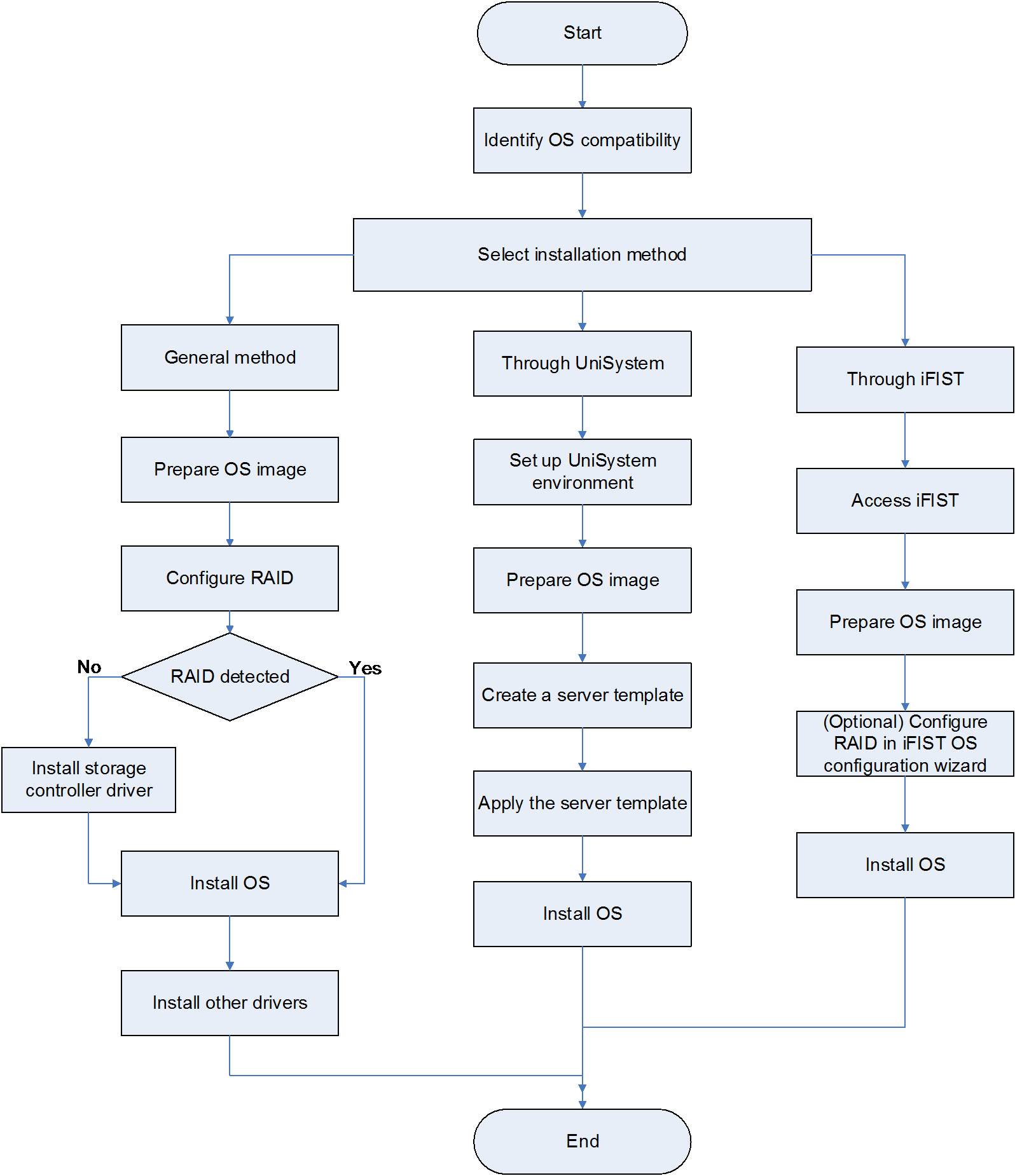

Installation workflow·· 3

The operating system (OS) installation methods vary by application scenario, as shown in Table 1.
Table 1 OS installation methods
Application scenario
Feature
OS installation on a single server
Installing an OS through the BIOS
Most common OS installation method. You can monitor each installation phase and customize the settings.
Installing an OS and drivers through iFIST
Simplifies OS installation and saves time.
Bulk OS installation on multiple servers
Installs OSs in bulk in a large-sized network.

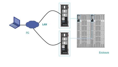

3.     Connect the PC to the management (MGMT) port on a minimum of one OM module, as shown in Figure 3.
Figure 3 Connecting the PC to both the active and standby OM modules

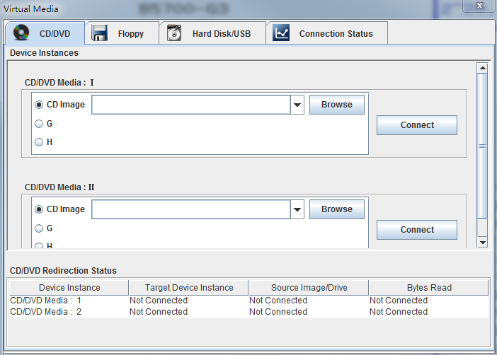

Connecting the OS image
Before installing an OS, connect the boot media that contain the OS image to the server.
·     For local login, you can use an optical disk drive, bootable USB disk, or PXE server as the boot media.
·     For remote console login, you can use an optical disk drive, bootable USB disk, PXE server, or virtual media (virtual disk, CD/DVD, or drive/USB) as the boot media. To install an OS on multiple servers in bulk, use a PXE server as the boot media.
Use Table 4 to determine the OS image preparation method based on the boot media.
Table 4 Preparing an OS image
Boot media
Preparing for installation
Optical disk drive
Insert the optical disk drive that contains the OS image into the optical drive.
Bootable USB drive
Insert the bootable USB disk that contains the OS image into the USB port.
PXE
1.     Set up the PXE environment, including a TFTP server and a DHCP server.

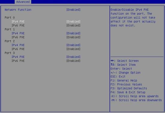

4.     Access the Advanced > Network PXE Control screen. Then, enable PXE on each port (Enabled by default).
Figure 6 Enabling PXE on network ports

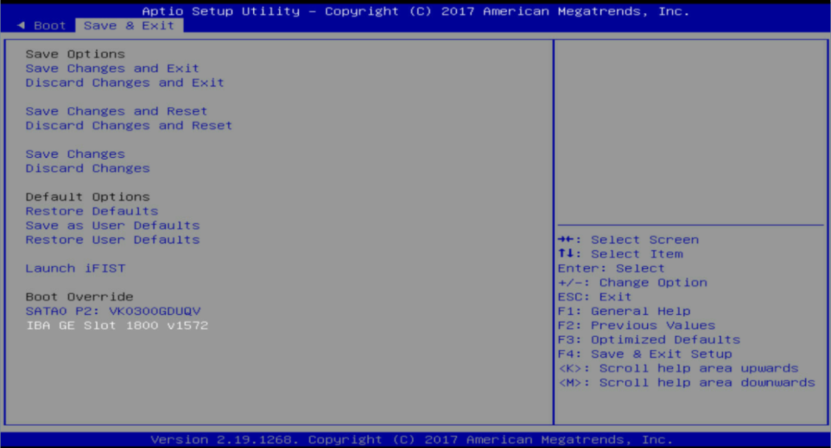

6.     Click the Save & Exit tab, and then select the boot option for PXE in the Boot Override area.
¡     For UEFI boot mode, select the port connecting to the PXE server. In this example, port 1 connects to the PXE server.
Figure 7 PXE boot options in UEFI boot mode
¡     For Legacy boot mode, select the only option. All ports on the network adapter share the same PXE boot option.
Figure 8 PXE boot options in Legacy boot mode
Mounting an OS image through a remote console
IMPORTANT
IMPORTANT:
To avoid OS installation failure caused by connection errors in a WAN, mount an OS image in the same LAN as the server.
This section mounts a virtual CD/DVD.
To mount an OS image through a remote console:
1.     Log in to the server from the HDM console.
2.     Select Media > Virtual Media Wizard from the navigation bar.
Figure 9 Virtual Media
3.     Click the CD/DVD tab, and then click Browse in the CD/DVD Media: I area. In the dialog box that opens, select a CD/DVD file, and then click Open.
Figure 10 Selecting a CD/DVD file
4.     Click Connect to complete mounting the CD/DVD image file.

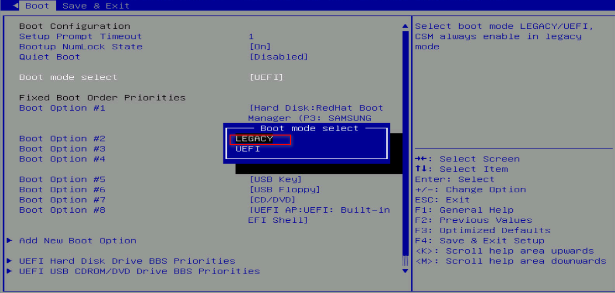

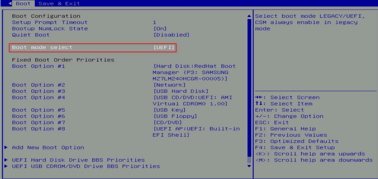

To set the BIOS boot mode:
1.     In the BIOS Setup Utility, click the Boot tab, select Boot mode select, and then press Enter.
Figure 12 Setting the BIOS boot mode
2.     Select the Legacy or UEFI mode, and then press Enter.
Figure 13 Selecting a BIOS boot mode

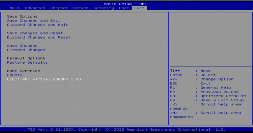

Selecting the boot media
1.     Start the server, and press F7 at the prompt, as shown in Figure 14.
Figure 14 Starting the server
2.     Select the boot media that contains the OS image. This section provides figures for selecting physical optical drive GK-DT-STDVDRAM and virtual media AMI Virtual CDROM0 mounted from the remote console as examples.
Figure 15 Selecting physical optical drive GK-DT-STDVDRAM as the boot media
Figure 16 Selecting virtual media AMI Virtual CDROM0 as the boot media

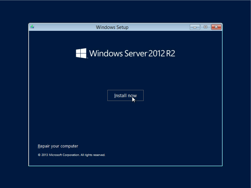

3.     Click Install now.
Figure 18 Starting installing Windows Server

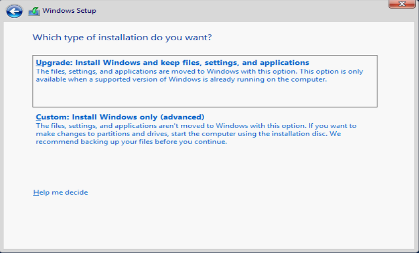

5.     Select I accept the license terms, and then click Next.
Figure 20 License terms
6.     Select an installation type, Custom or Upgrade.
To install a new OS, select Custom. To upgrade your OS, select Upgrade.
This example selects the Custom type.
Figure 21 Selecting an installation type

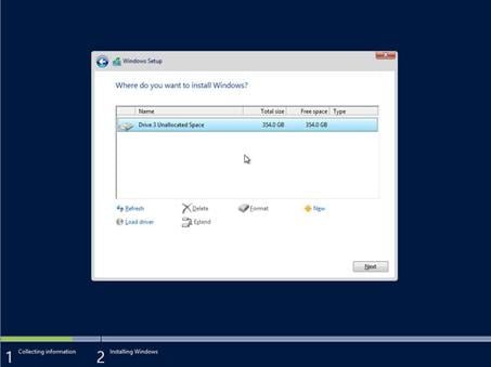

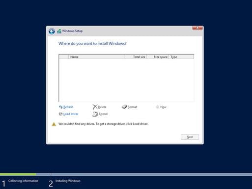

7.     Click Load Driver, and then click Browse.
CAUTION
CAUTION:
Load the storage controller driver when installing a Windows Server OS to avoid the following issues:
·     The disk cannot be detected (see Figure 22).
·     The OS cannot be accessed after installation.
Figure 22 Disk not detected
Figure 23 Loading a driver
8.     Select the path where the driver is located, and then click OK.
Figure 24 Selecting the driver path
9.     Select the driver to install, and then click Next.
Figure 25 Driver detected
10.     Select the destination drive to install the OS, and then click Next.
Figure 26 Loading storage controller driver completed

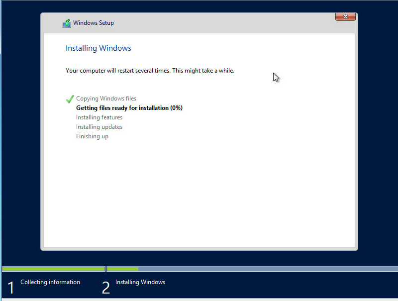

11.     Wait for the system to complete OS installation.
Figure 27 Installing the OS

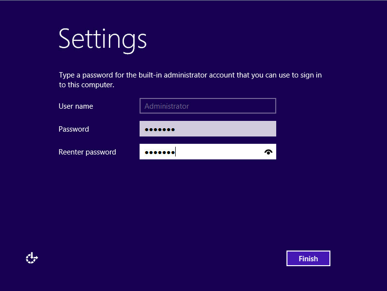

12.     Set the password, and then click Finish after the system completes installation and enters the Settings page.
The user name is Administrator, which cannot be modified.
Figure 28 Setting the password

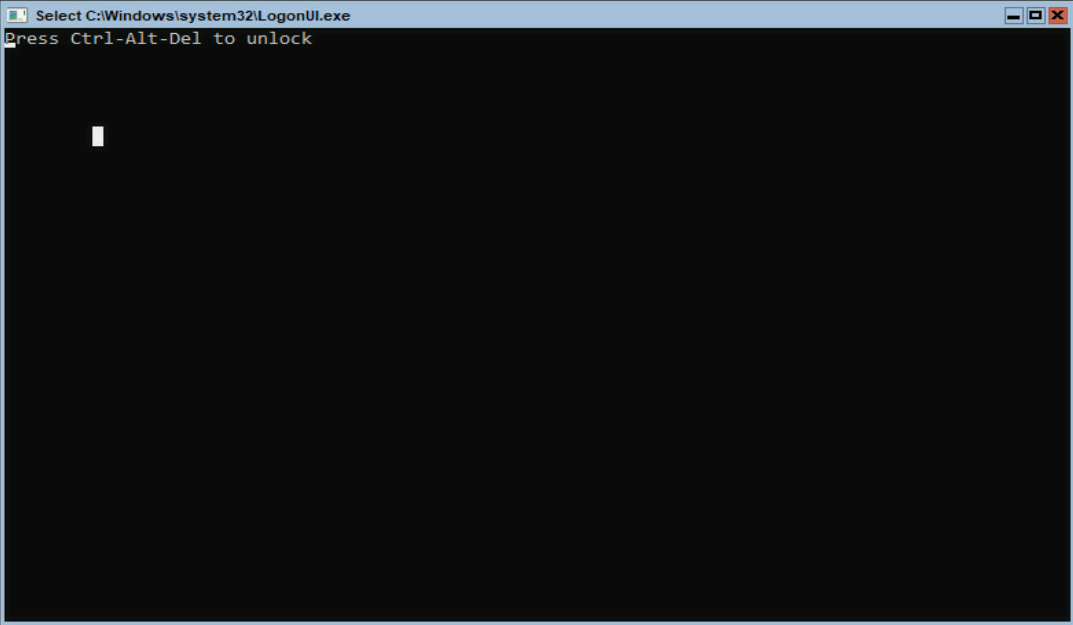

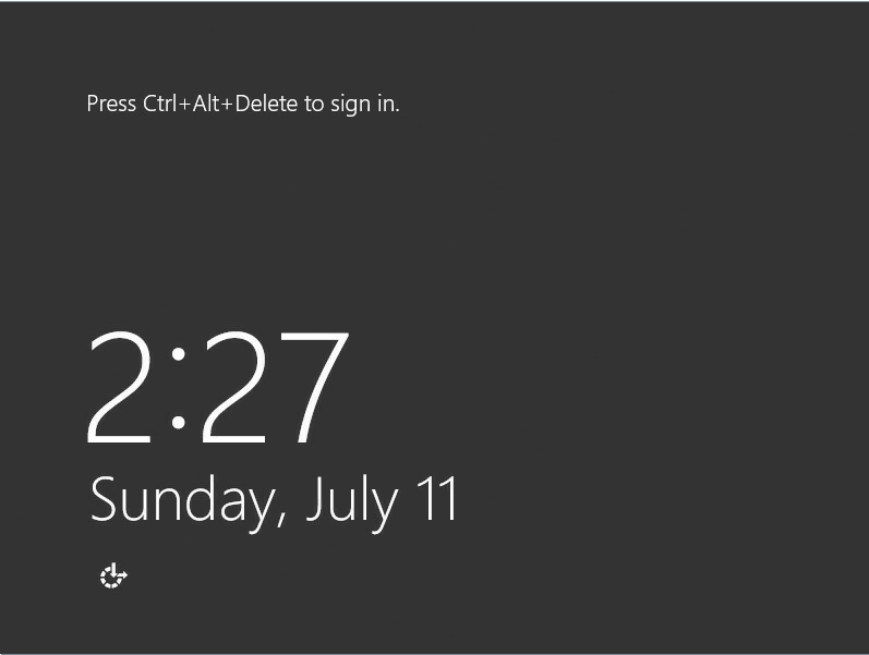

13.     Press Ctrl+Alt+Delete on the keyboard of the remote console as prompted.
Figure 29 OS installation completed

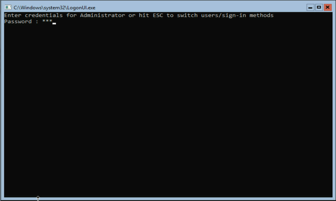

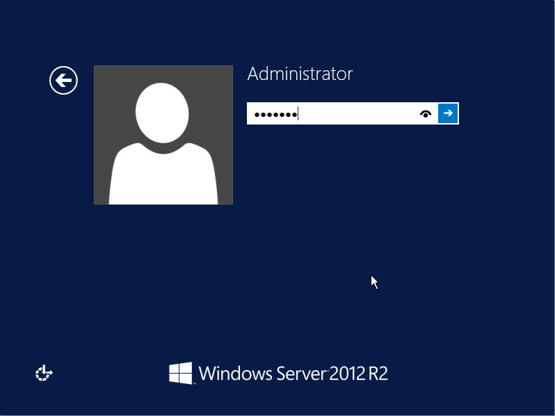

14.     Enter the administrator password.

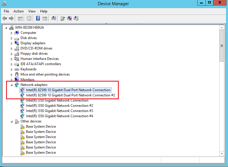

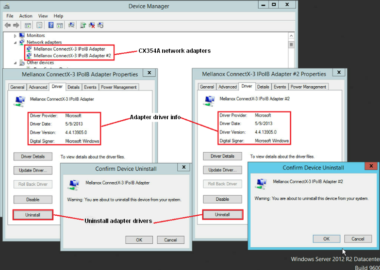

For the OS to correctly identify hardware devices, install the Chipset driver after OS installation.
Figure 30 Entering the administrator password
Figure 31 Entering the OS
The CPU on the server supports QAT, if Device Manager displays the following:
To use QAT, contact Intel Support.

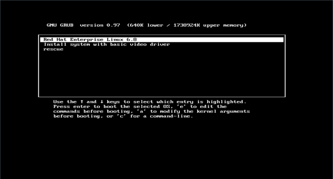

1.     Enter the BIOS and select boot options. For more information, see "Selecting the boot media."
2.     Select Red Hat Enterprise Linux 6.8, and then press e as prompted, as shown in Figure 32.
Figure 32 Confirming OS installation
3.     Select the line that starts with kernel, and then press e.
Figure 33 Selecting the line that starts with kernel
4.     Input the linux dd command, and then press Enter. Then press b to start installation.

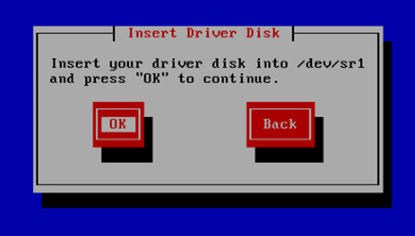

6.     Select the mirrored interface to mount the driver disk.
Figure 36 Selecting the mirrored interface

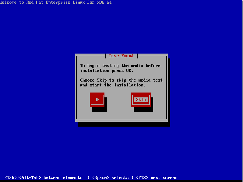

9.     Press Tab, select OK or Skip, and then press Enter. This example selects Skip.
Figure 39 Confirming media test

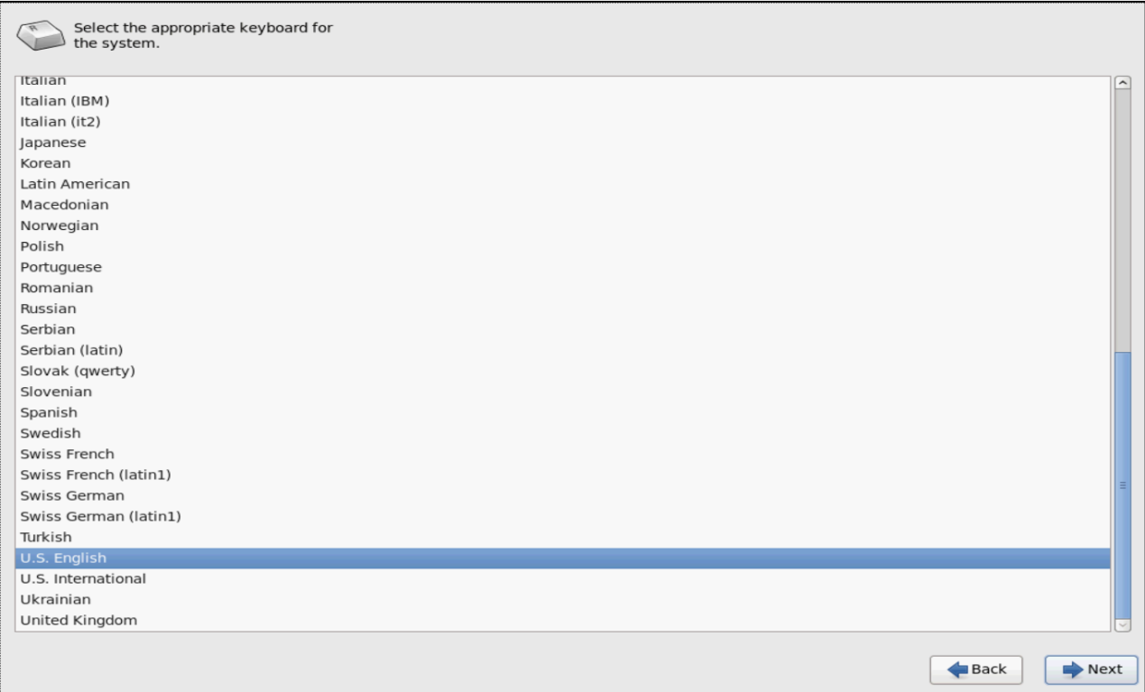

12.     Select the keyboard, and then click Next.
Figure 42 Selecting the keyboard

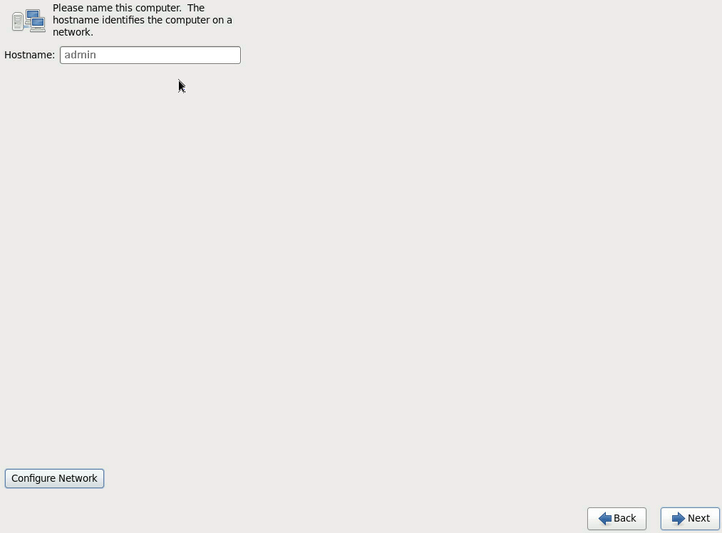

14.     Enter the host name in the Hostname field, and then click Next.
To configure the network, click Configure Network on the lower left corner of the page. This example does not configure the network.
Figure 44 Setting the host name

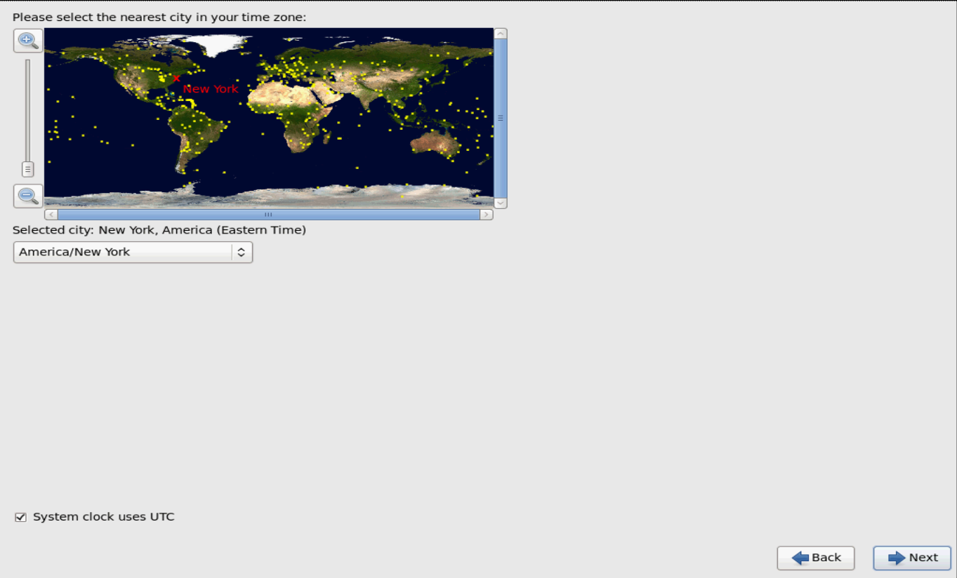

15.     Select your time zone, and then click Next.
Figure 45 Selecting your time zone

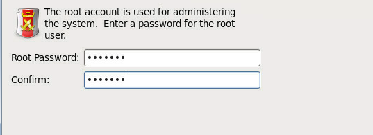

16.     Set the root password, and then click Next.
Figure 46 Setting the root password

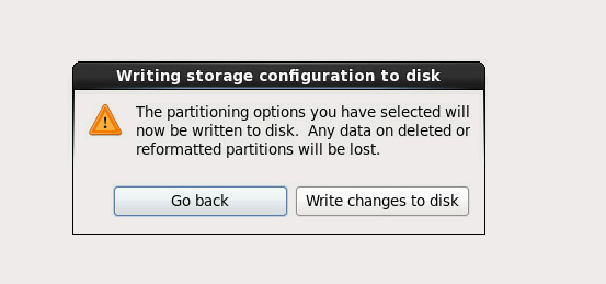

18.     Back up all data on the disk, and then click Write changes to disk to format the disk.
Figure 48 Confirming the formatting operation

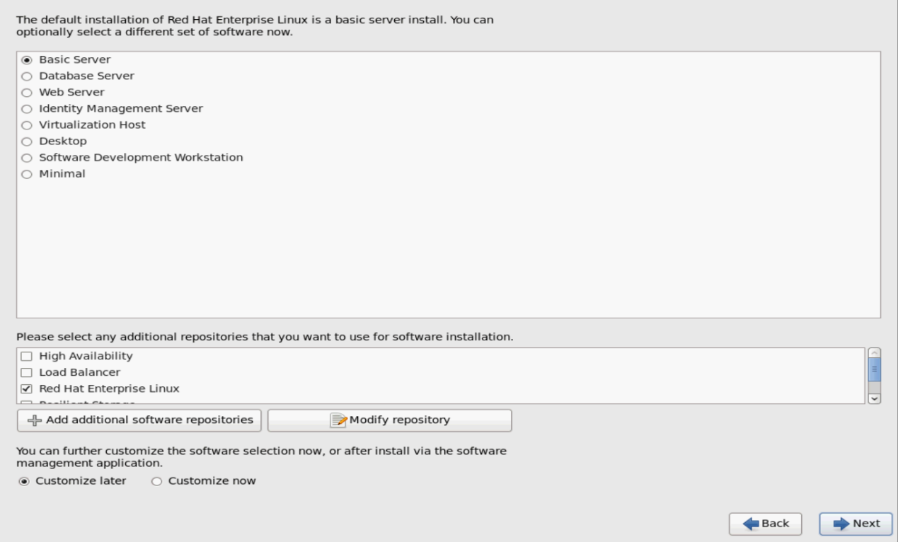

19.     Select a server type and additional repositories, select Customize now, and then click Next.
The following server types are available:
¡     Basic ServerBase, without GUI.
¡     Database ServerBase, plus MySQL database, without GUI.
¡     Web ServerBase, plus PHP, Web server, and MySQL database client, without GUI.
¡     Identity Management Server.
¡     Virtualization HostBase, virtualization platform.
¡     DesktopBasic desktop, including commonly-used desktop software.
¡     Software Development WorkstationIncludes base, virtualization platform, desktop platform, and development tools.
¡     MinimalCore.
Figure 49 Server type options

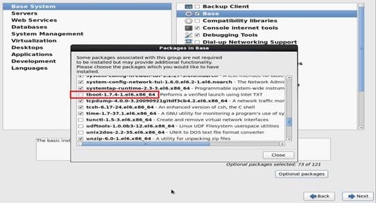

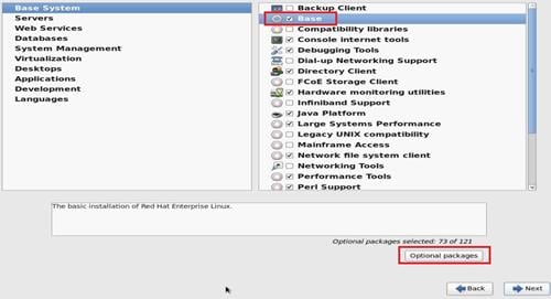

20.     Select Base, and then click Optional packages.
Figure 50 Server installation options
21.     Click Close, and then click Next. For the OS to start correctly, make sure the boot package is not selected if the BIOS boot mode is UEFI.
Figure 51 Base System

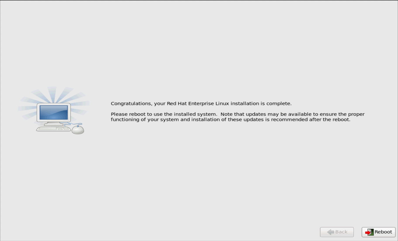

22.     Click Reboot to reboot the server.
Figure 53 Rebooting the server
Figure 54 Logging in to the OS

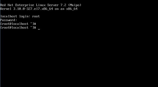

Installing a Red Hat 7.x, Red Hat 8.x, CentOS 7.x, or CentOS 8.x OS
The installation procedures are similar for Red Hat 7.x, Red Hat 8.x, CentOS 7.x, and CentOS 8.x OSs. This section installs Red Hat Enterprise Linux 7.2 and the storage controller driver.
Make sure both the OS image and the storage controller driver file have been mounted to the server. You can mount a file to the server through a CD/DVD, USB disk, or virtual media.
To install a Red Hat/CentOS 7.x OS:

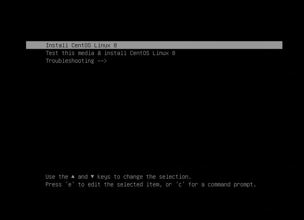

2.     Select Red Hat Enterprise Linux 7.2, and then press e as prompted, as shown in Figure 55.
Figure 55 Confirming OS installation

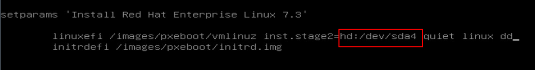

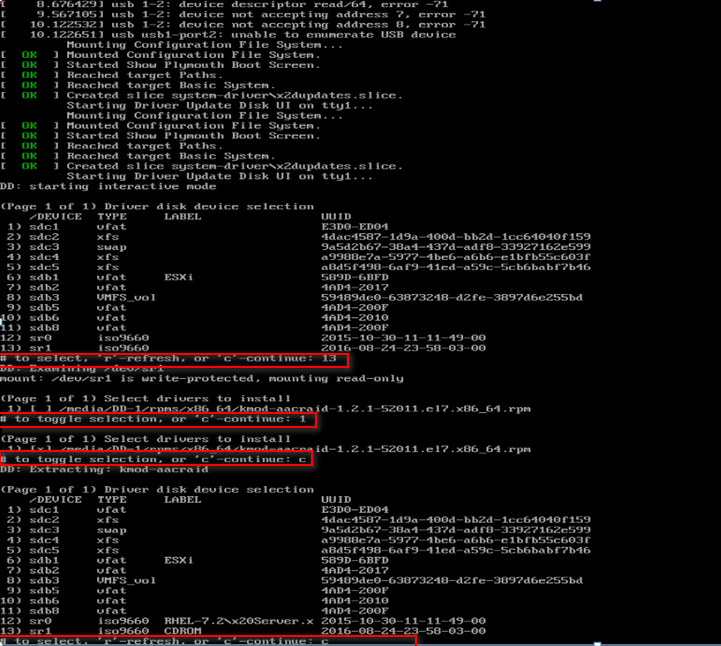

3.     Input linux dd at the end of the line that starts with linuxefi, and then press F10 or Ctrl+X to start installation.
Figure 56 Parameter configuration
4.     Perform the following steps to configure the parameters:

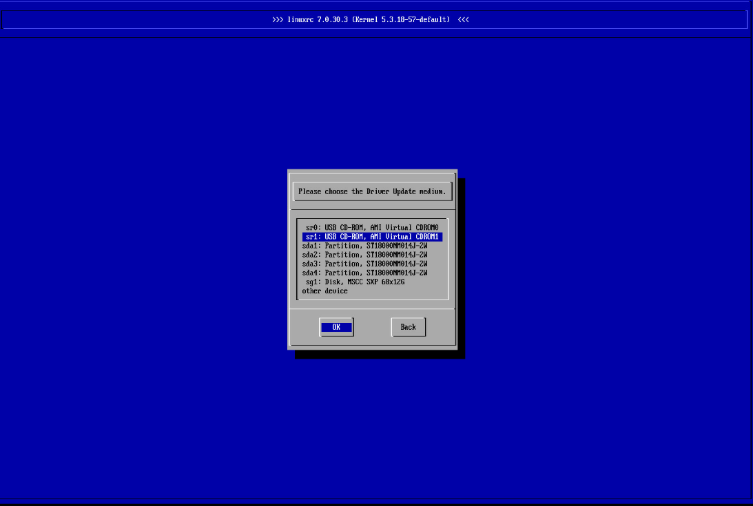

a.     Display the location of the driver. In this example, sr1 has a driver mounted, so you select 13.
b.     Enter 1 to select the rpm file.
c.     Enter c to continue installation.
If not all drivers are listed on the page, enter r to refresh the driver list.
Figure 57 Parameter configuration
5.     Select the system language, and then click Continue.
Figure 58 Selecting the language

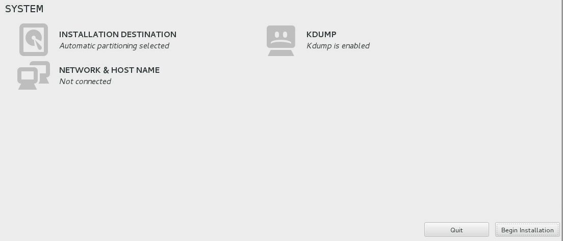

6.     Configure the options in Figure 59 as required.
If an icon has a  mark, it indicates that the configuration is incorrect, and you must reconfigure the option.
The following describes only the steps for specifying a destination disk. The default settings are used for other options.
Figure 59 Option configuration

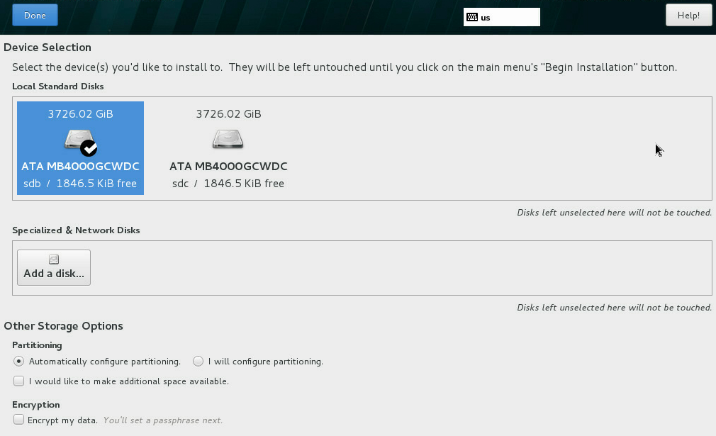

7.     Click INSTALLATION DESTINATION. Select the disk where the OS is to be installed, and then click Done.
This example uses automatic partitioning. To use manual partitioning, select I will configure partitioning.
Then you must select Standard Partition from the New mount points will use the following partitioning scheme list for successful OS installation.
If you select manual partitioning in UEFI boot mode, you must create the /boot/efi partition, and the files in the partition must be in efipartition or fat format. If you do not do so, an error will occur during OS installation.
Figure 60 Selecting the disk to install the OS
8.     Click Reclaim space to format the disk when the following dialog box appears.
Figure 61 Confirming the formatting operation
9.     Click Delete all. When the status in the Action column changes to Delete, click Reclaim space to delete all partitions.
Figure 62 Deleting the current partitions
10.     Click Begin Installation.
Figure 63 Starting installing the OS

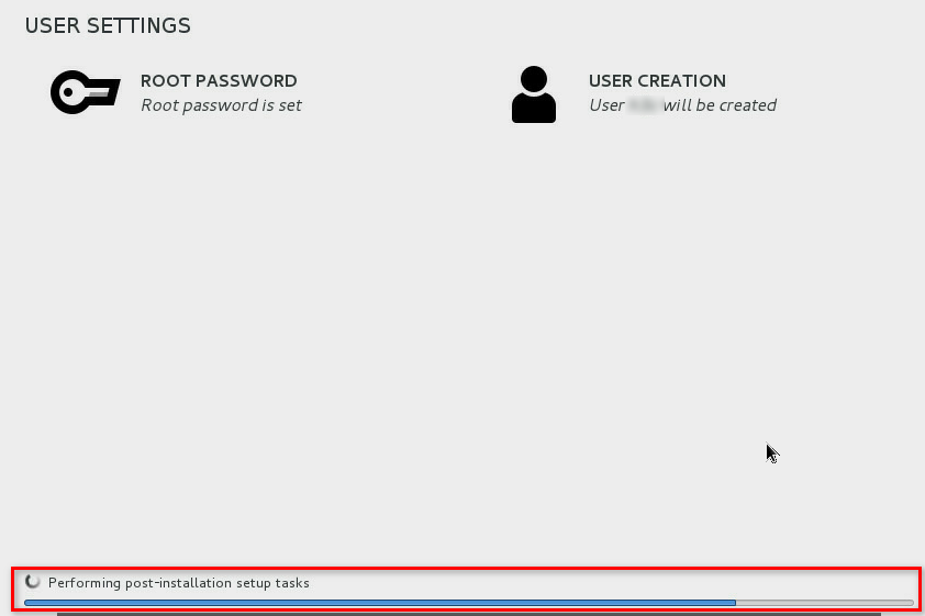

11.     Click ROOT PASSWORD.
Figure 64 User settings
12.     Enter the root password, and then click Done. If the password is too simple, the system gives a prompt. To accept the simple password, click Done twice.
Figure 65 Setting the root password
As a best practice, set a root password to one with the Strong security level.
13.     Click USER CREATION, create a new user account, set the password, and then click Done. If the password is too simple, the system gives a prompt. To accept the simple password, click Done twice.
Figure 66 Creating a user account
14.     Wait for the system to complete installation.
Figure 67 Installing the OS

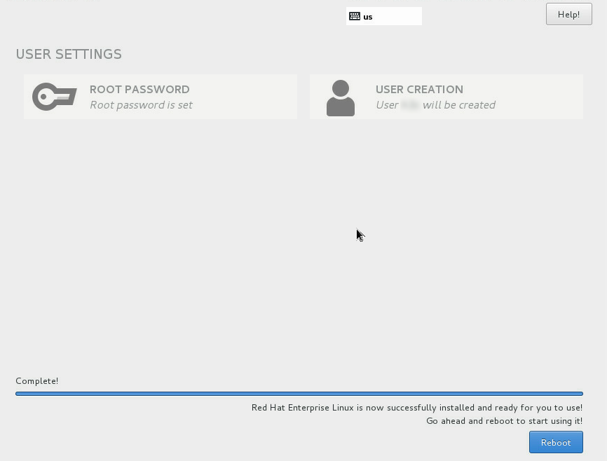

15.     Click Reboot to reboot the server after the installation is complete.
Figure 68 Rebooting the server
Figure 69 Logging in to the OS

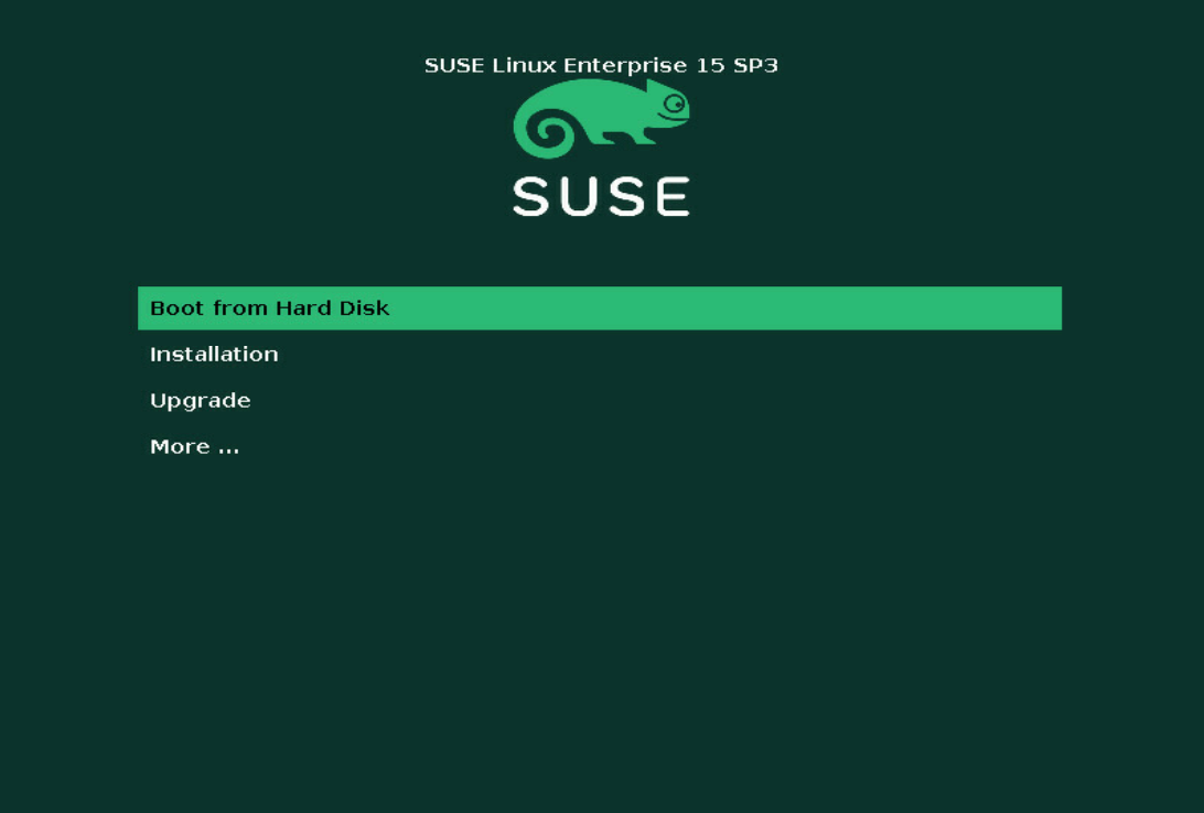

Installing an SUSE OS
Installing an SUSE 11 SP4 OS
The installation procedures are similar for SUSE OSs. This example installs SLES 11 SP4.

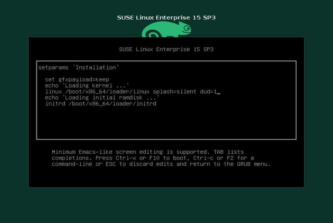

You do not need to install the storage controller driver for an SUSE OS.
To install an SUSE 11 SP4 OS:
2.     As shown in Figure 70, click Installation, and then press E.
Figure 70 Confirming OS installation

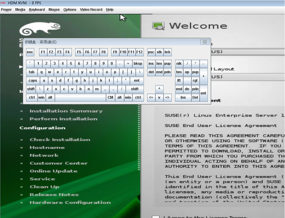

3.     Open the soft keyboard, and press Ctrl+Alt+F2 to enter the CLI console.
Figure 71 Entering the CLI console

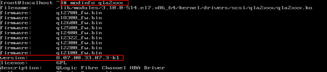

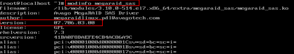

4.     Enter the modinfo aacraid command to identify whether the driver has been installed successfully. Press Ctrl+Alt+F7 to continue OS installation.

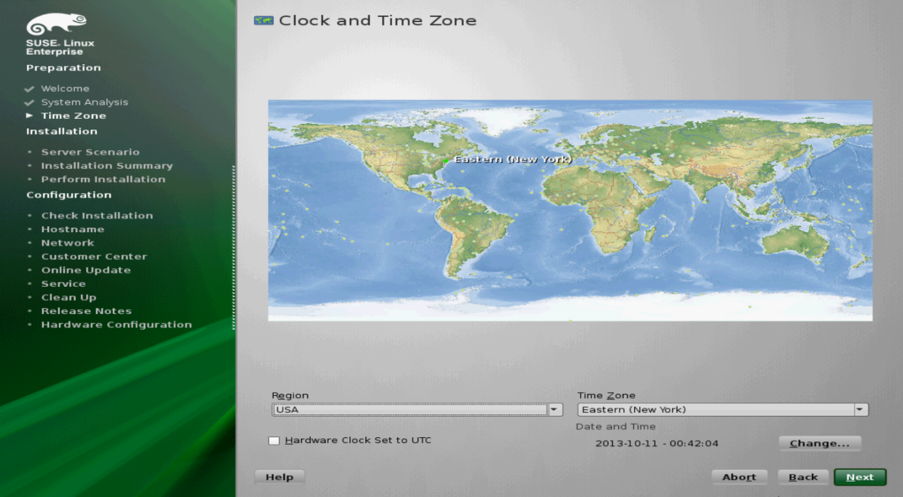

9.     Select your time zone, and then click Next.
Figure 76 Selecting your time zone

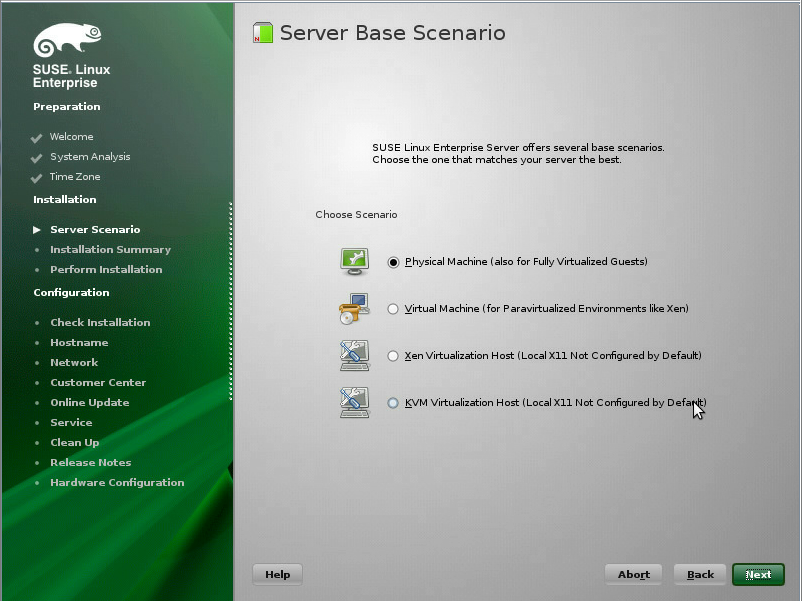

10.     Select the server base scenario, and then click Next. As a best practice, select Physical Machine for new installation.
Figure 77 Selecting the server base scenario

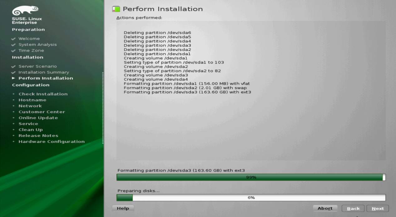

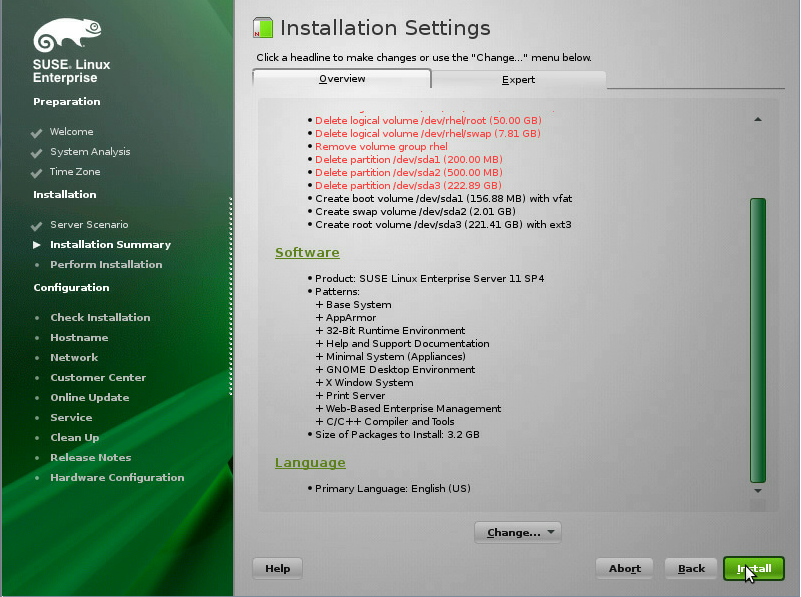

11.     To use the default settings, click Install. The system will start OS installation.
Figure 78 Installing the OS

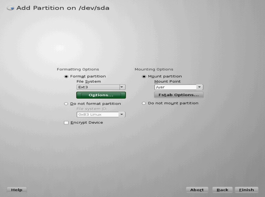

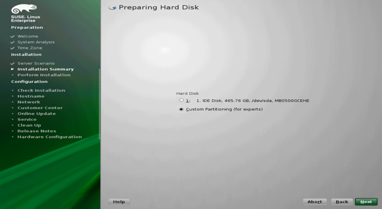

12.     To manually partition the disk:
a.     Click Partitioning, on the Preparing Hard Disk page select a partitioning method, and then click Next.
If you select 1.IDE Disk, the system will automatically partition the disk based on the size of the disk. If you select Custom Partitioning, you can manually partition the disk as needed. This example selects Custom Partitioning.
Figure 79 Preparing hard disk
b.     From the left navigation tree, select Hard Disks > sda.
The following partitions must be added:
-     swap—Switching partition to implement virtual memory. As a best practice, set its size to one or twice of the physical memory.
-     /boot/efi—System boot file partition. It must be in the efi partition or fat format. As a best practice, set the size to 100 MB to 200 MB.
-     /—Root partition to save system software and files.
Figure 80 Partitioning the disk
c.     Click Add. On the page that opens, set the partition size, and then click Next.
Figure 81 Adding a partition
d.     Select a file system and mount point, and then click Finish.
Figure 82 Setting the partition
e.     To install software, click Software. On the page that opens, select software and set system tasks, and then click OK.
Figure 83 Selecting software
13.     Click Install.
Figure 84 Installing the OS
14.     After the installation is complete, click Next. The system will automatically reboot.
Figure 85 Performing installation
Figure 86 OS rebooting
Figure 89 Confirming OS installation
3.     Input dud=1 at the end of the line that starts with linuxefi, and then press F10 to start installation.
Figure 90 Editing the kernel

5.     As shown in Figure 92, select the medium that contains the storage controller driver by using the up and down arrow keys on the keyboard. Then, select OK and press Enter to confirm the loading.
Figure 92 Selecting the medium containing the storage controller driver
6.     As shown in Figure 93, set the language and keyboard layout of the OS, and then select the type of the OS to be installed in the Product to install section. Then, click Next. The following installs a new OS as an example.
Figure 93 Setting the language, keyboard layout, and OS type

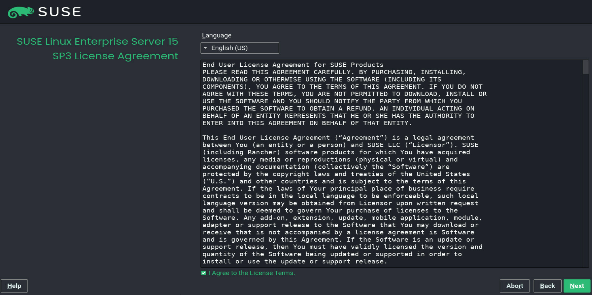

7.     As shown in Figure 94, select I Agree to the License Terms, and then click Next.
Figure 94 License terms

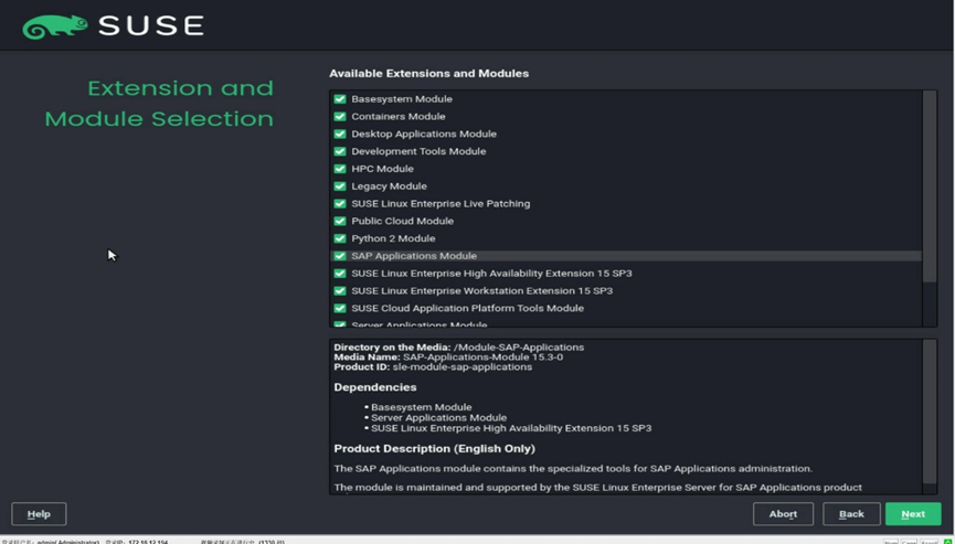

9.     As shown in Figure 97, select extensions and modules for the system as needed, and click Next. It might be time consuming if you select many opions.
Figure 97 Selecting extensions and modules

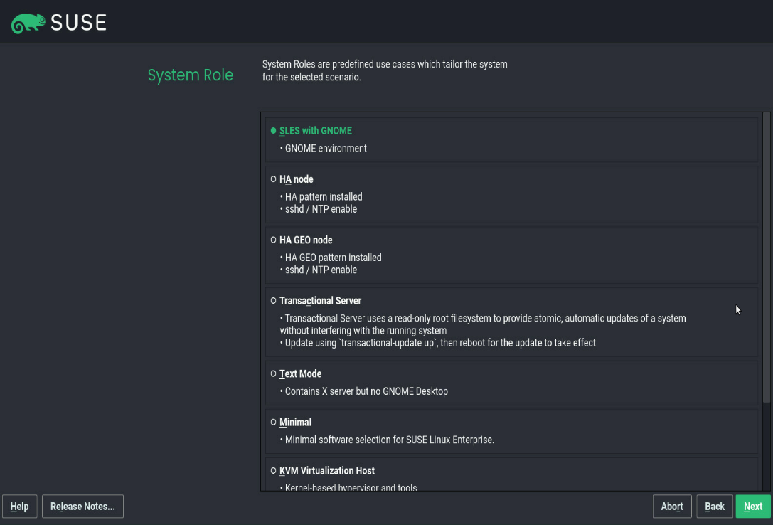

11.     As shown in Figure 99, select an application scenario for the system, and then click Next.
Figure 99 Selecting the application scenario for the system

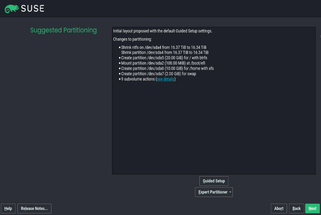

12.     As shown in Figure 100, to use the default partitions, click Next only. You can also configure user-defined partitions in the following methods:
¡     To configure partitions in guide mode, click Guided Setup to enter the screen as shown in Figure 101.
¡     To configure partitions in expert mode, click Expert Partitioner to enter the screen as shown in Figure 102.
·     swap—Switching partition to implement virtual memory. As a best practice, set its size to one or twice of the physical memory.
·     /boot/efi—System boot file partition. It must be in the efi partition or fat format. As a best practice, set the size to 100 MB to 200 MB.
·     /—Root partition to save system software and files.
Figure 100 Disk partitioning
Figure 101 Partitioning in guide mode
Figure 102 Partitioning in expert mode

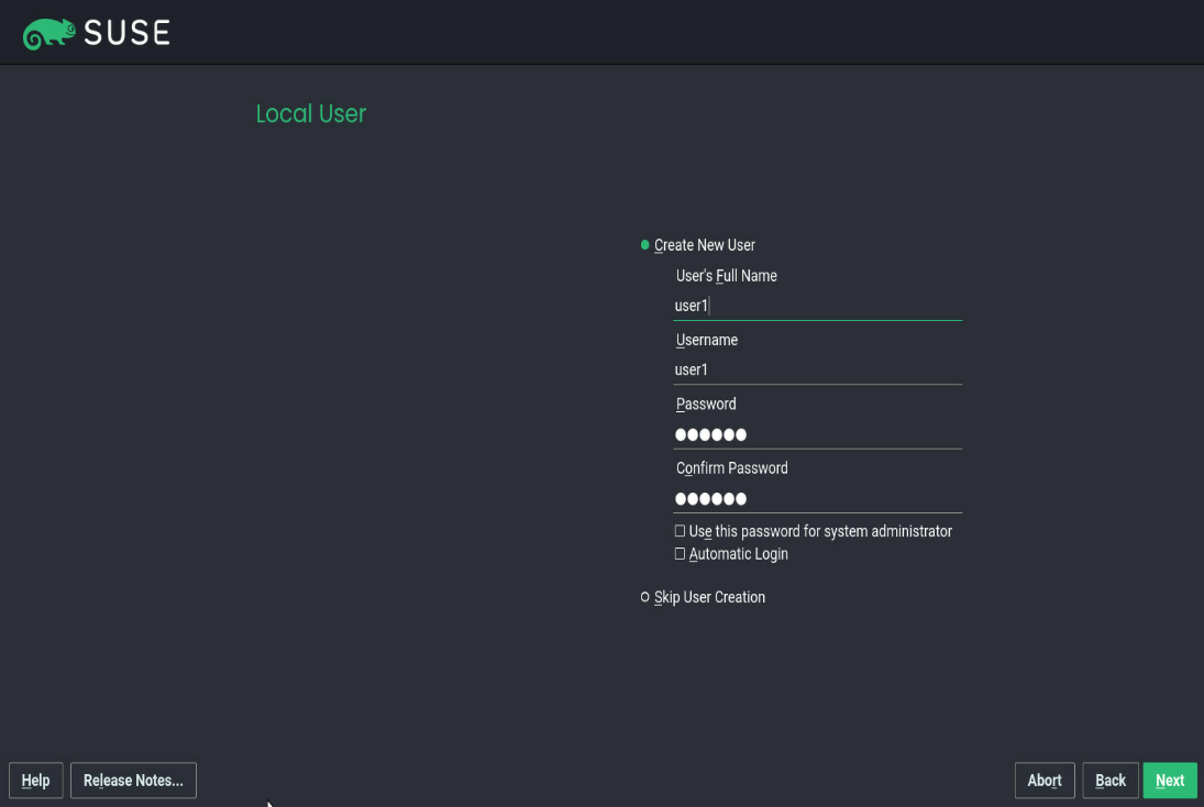

14.     As shown in Figure 104, set the username and password to create a local user, and then click Next.
Figure 104 Setting the username and password

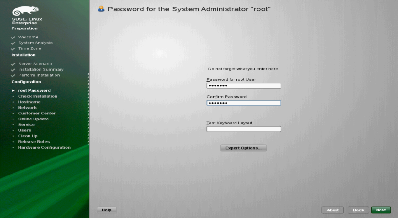

15.     As shown in Figure 105, set the root password, and then click Next.
Figure 105 Setting the root password

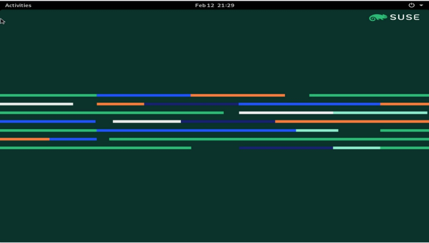

18.     After system installation finishes, restart the system and enter the username and password to enter the system desktop, as shown in Figure 110.
Figure 110 Entering the system desktop

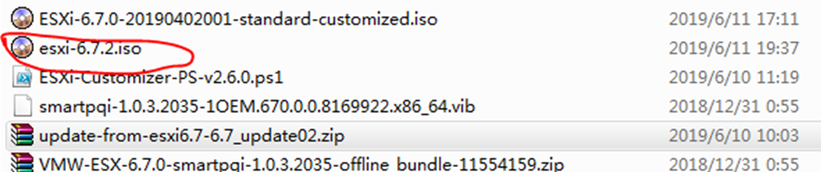

b.     Put the storage controller driver, original VMWare ESXi OS image, and ESXi-Customizer-PS in the same directory.
Figure 115 Preparing the driver, OS image, and ESXi-Customizer-PS

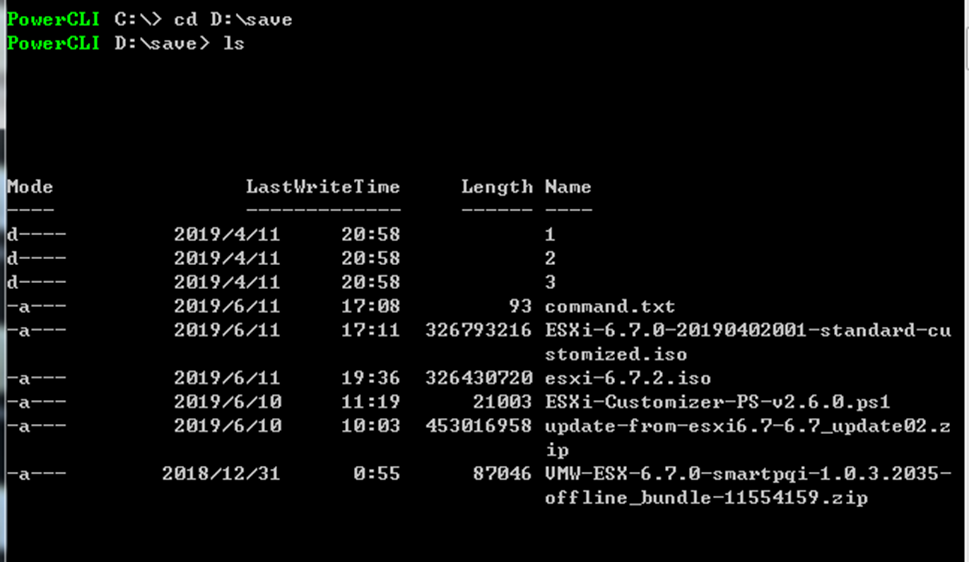

c.     Run VMware PowerCLI, and execute the cd command to enter the directory where the driver resides.
Figure 116 Entering the directory where the driver resides

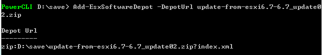

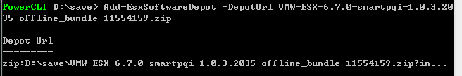

d.     Execute the Add-esxsoftwareDepot –depoturl driver_file_name.zip command to load the driver file.
Figure 117 Loading the driver file

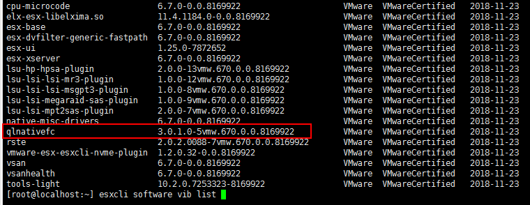

e.     Execute the Get-EsxSoftwarePackage command to obtain the driver name. In this example, the driver name is smartpqi.
Figure 118 Viewing driver information
f.     Execute the Add-esxsoftwareDepot –depoturl OS_image_file_name.zip command to load the OS image.
Figure 119 Loading the OS image

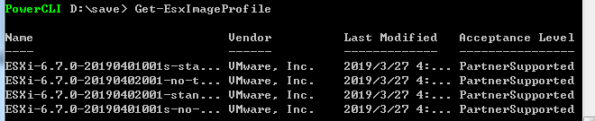

g.     Execute the Get-EsxImageProfile command to obtain the name of the target configuration file. An OS image contains multiple configuration files for different installation scenarios. In this example, the OS image contains four configuration files. This section uses the third configuration file.
Figure 120 Viewing OS image information
h.     Execute the Add-EsxSoftwarePackage –ImageProfile configuration_file_name –SoftwarePackage driver_name command to integrate the OS image and the driver.
Figure 121 Integrating the OS image and the driver
i.     Execute the Export-EsxImageProfile -NoSignatureCheck –ImageProfile configuration_file_name –ExportToIso –FilePath export_path_and_file_name command to export the OS image integrated with the driver.
Figure 122 Exporting the OS image integrated with the driver
j.     Verify that the OS image has been exported to the specified path with the specified name.
Figure 123 Obtaining the OS image integrated with the driver

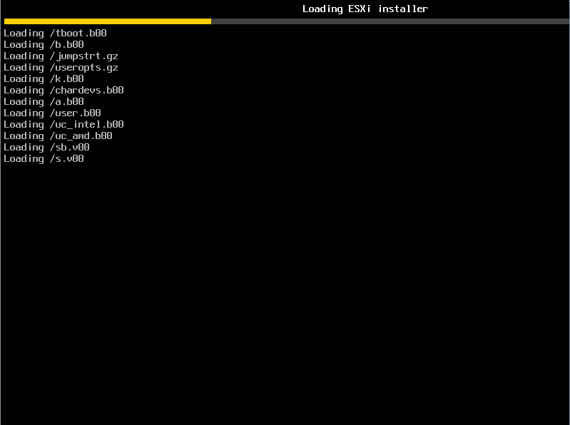

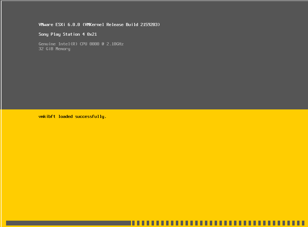

Figure 124 Loading ESXi installer
Figure 125 Loading the OS module
3.     Press Enter as prompted to continue installation.
Figure 126 VMware ESXi installation

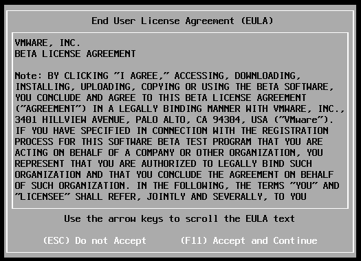

4.     Press F11.
Figure 127 License Agreement

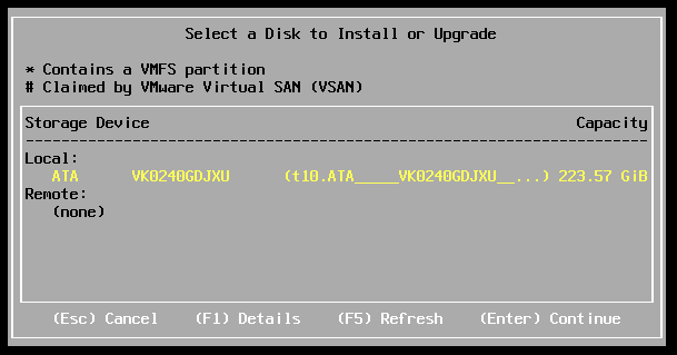

5.     Select the disk to install the OS and then press Enter. To see details, press F1.
Figure 128 Selecting the disk to install the OS

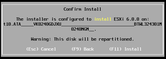

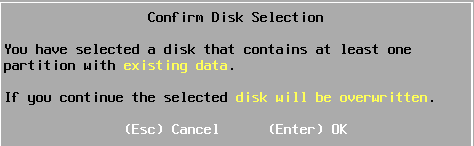

6.     Confirm disk selection and then press Enter. To change to another disk, press Esc and then select another one.
Figure 129 Confirming disk selection

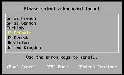

7.     Select a keyboard layout as prompted, and press Enter when the following dialog box appears.
Figure 130 Selecting a keyboard layout

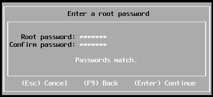

8.     Set the root password, and then press Enter.
Figure 131 Setting the root password
9.     Press F11 to start installation.
Figure 132 Confirming VMware ESXi OS installation

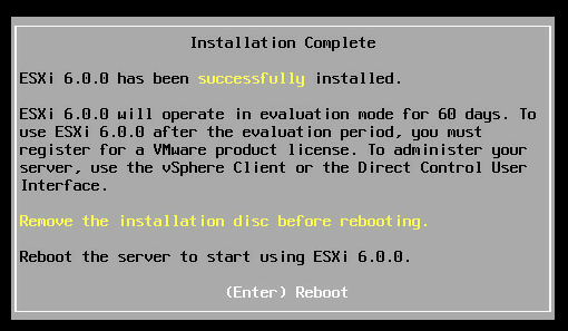

10.     Press Enter to reboot the server.
If the OS image is obtained from a CD/DVD or bootable USB disk, remove the CD/DVD or USB disk, and then press Enter to reboot the server.
Figure 133 OS installation completed
Figure 134 OS reboot completed

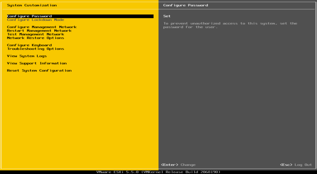

11.     Press F2, enter the root password, and then press Enter.
The OS installation is complete when the page as shown in Figure 136 appears.
Figure 135 Entering the root password
Figure 136 Configuring the password

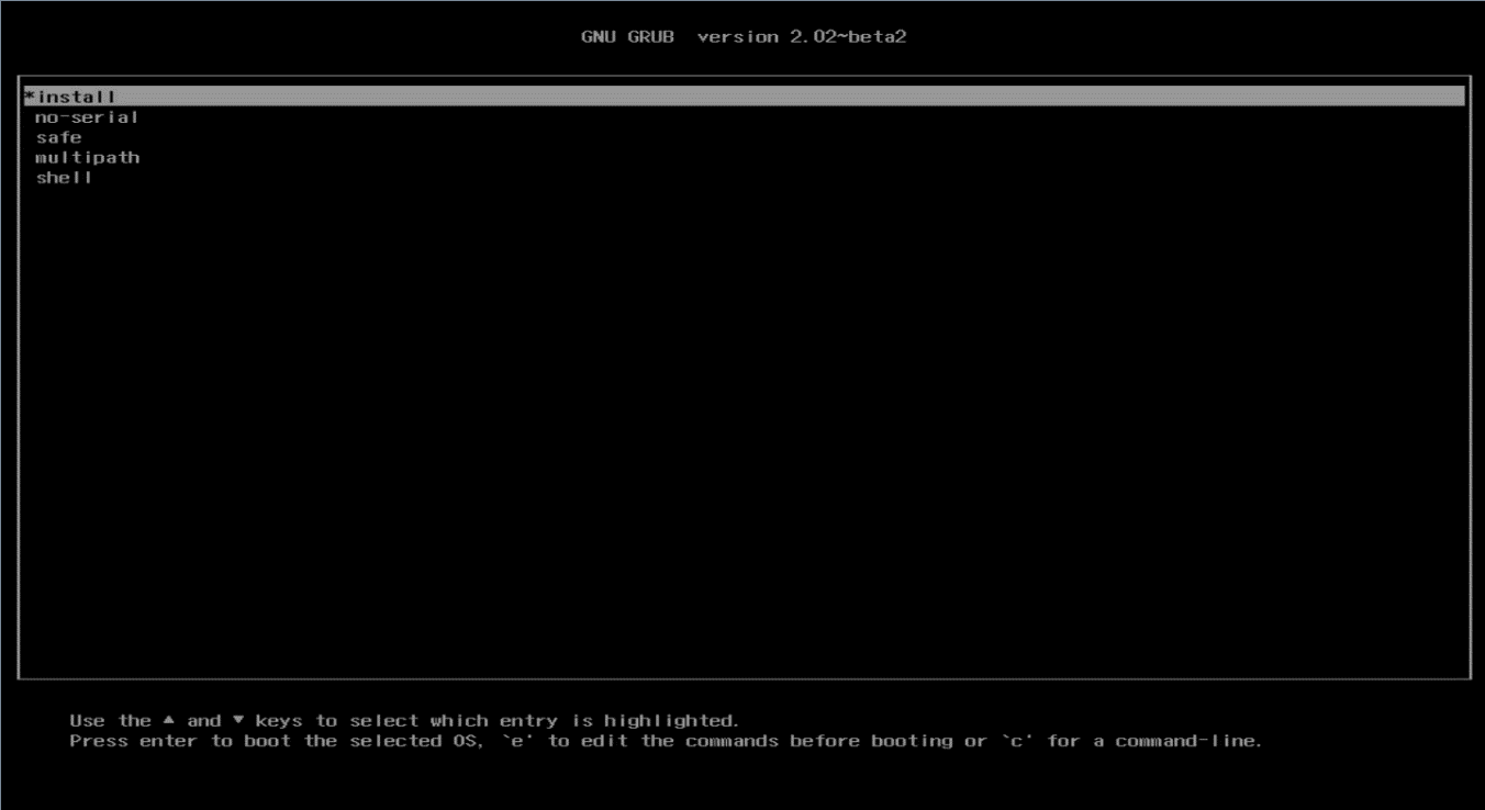

2.     Select Install, and then press Enter.
Figure 137 Grub

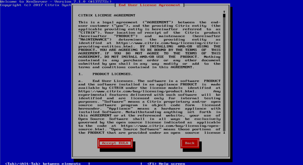

5.     Read the End User License Agreement, select Accept EULA, and then press Enter.
Figure 140 End User License Agreement

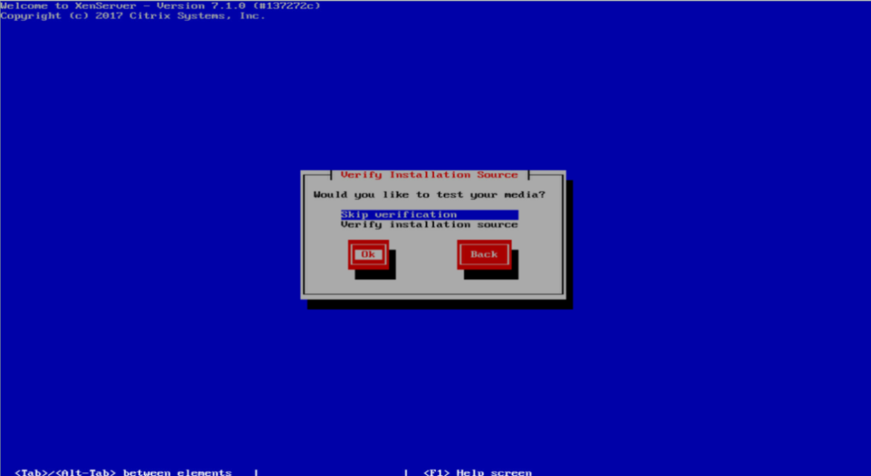

8.     Select Skip verification, and then click OK.
If you encounter any issues during installation, verify the installation source as a best practice.
Figure 143 Verifying the installation source

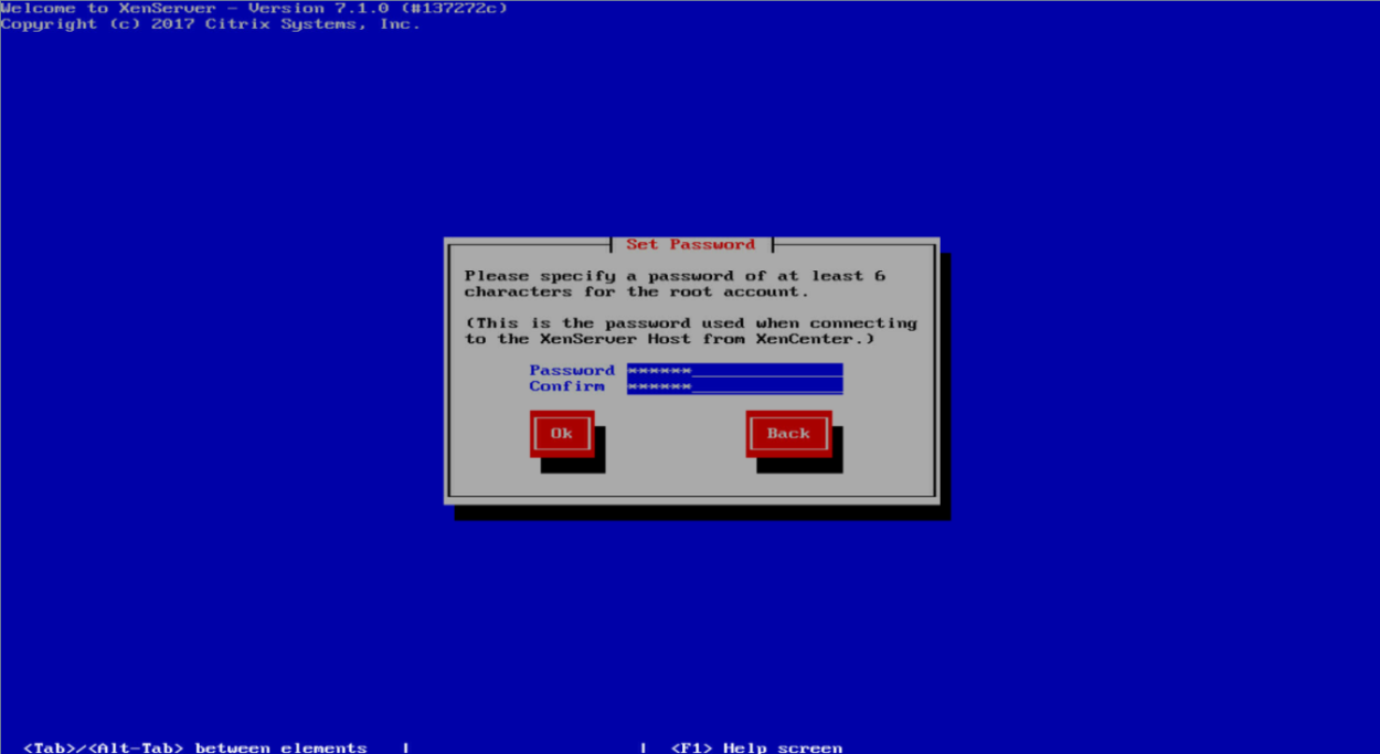

9.     Set and confirm the root password, and then click OK. XenCenter will use this password to connect to the XenServer host.
Figure 144 Setting the root password

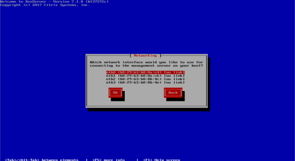

10.     Select a network interface for connecting to the management server, and then click OK.
Figure 145 Selecting a network interface

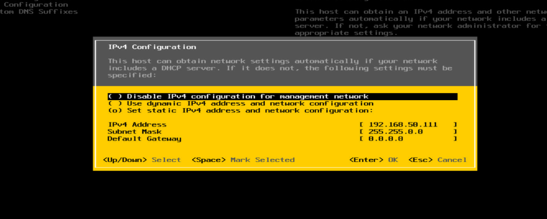

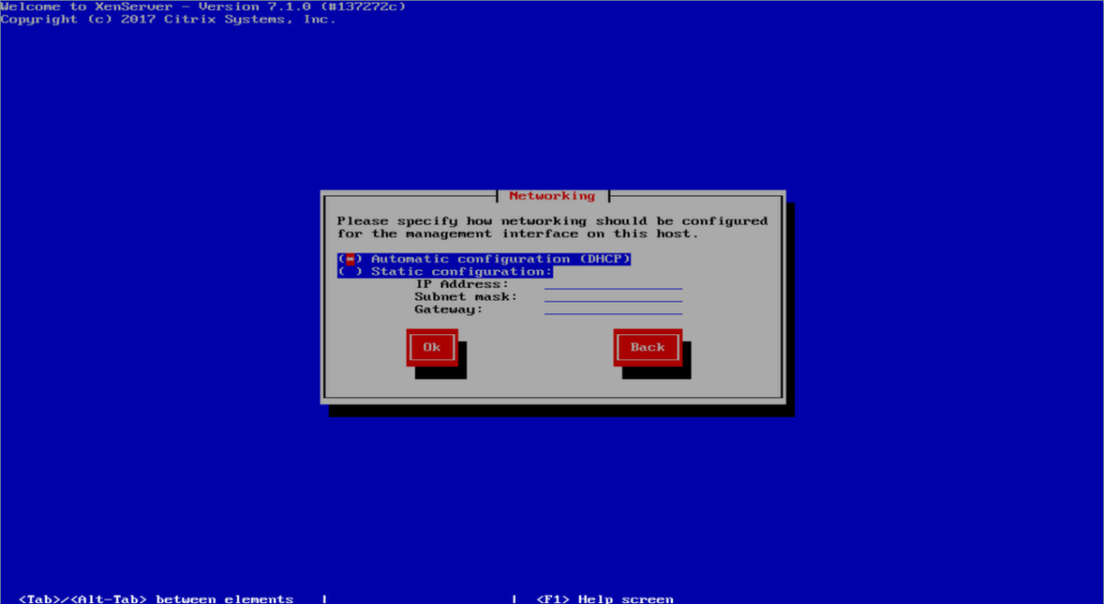

11.     Select a method for specifying an IP address for the management interface, and then click OK.
¡     Automatic configuration (DHCP)Obtains an IP address through DHCP.
¡     Static configurationManually specify an IP address. If you select this option, you must also specify an IP address, mask, and gateway address.
Figure 146 Specifying an IP address

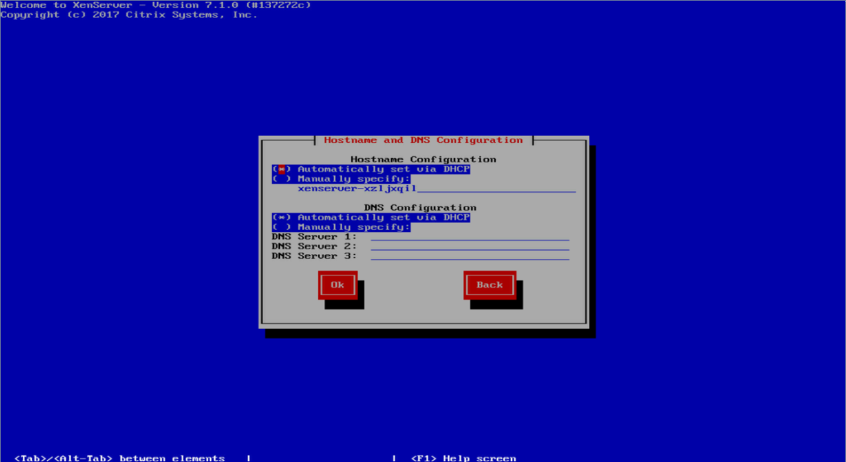

12.     Configure DNS by using either of the following methods, and then click OK.
¡     Automatically set via DHCP.
¡     Manually specify. If you select this option, you must specify an IP address for a minimum of one DNS server.
Figure 147 Configuring DNS

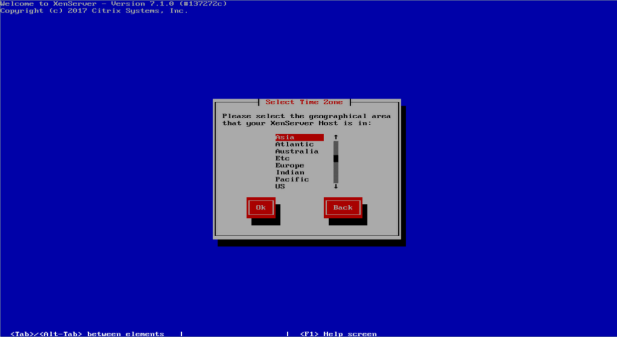

13.     Set the time zone by selecting the geographical area and then the city, and then click OK.
Figure 148 Setting the time zone

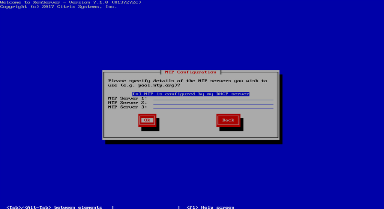

14.     Select a method for setting the system time, and then click OK.
¡     Using NTPYou must specify a minimum of one NTP server and specify the IP address of the NTP server.
¡     Manual time entryYou must manually enter the system time after installation.
Figure 149 Selecting the method for setting the system time
Figure 150 Configuring the NTP server

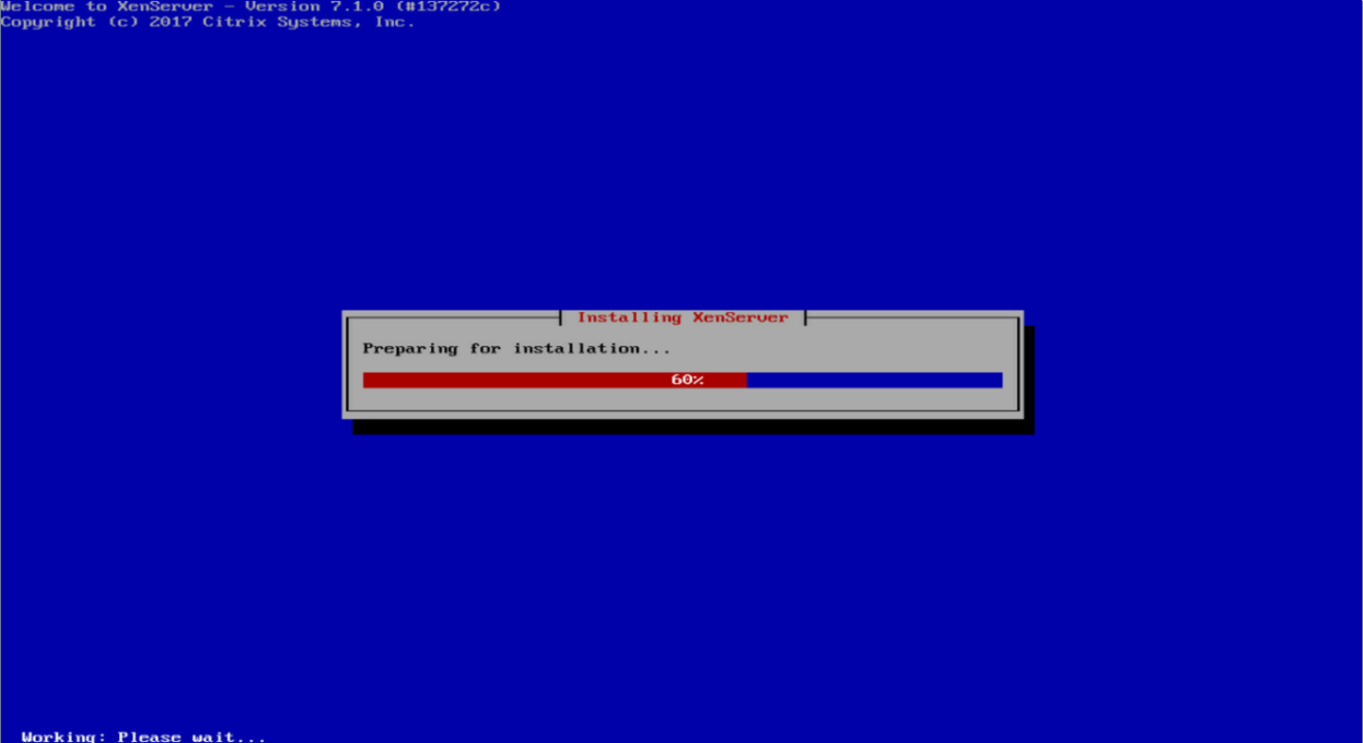

15.     Select Install XenServer, and then press Enter to start installation.
Figure 151 Starting installation
16.     Wait for the system to complete installation.
Figure 152 OS installation in progress
17.     Click OK after installation is completed to restart the server.
Figure 153 Installation completed

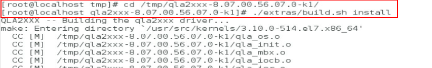

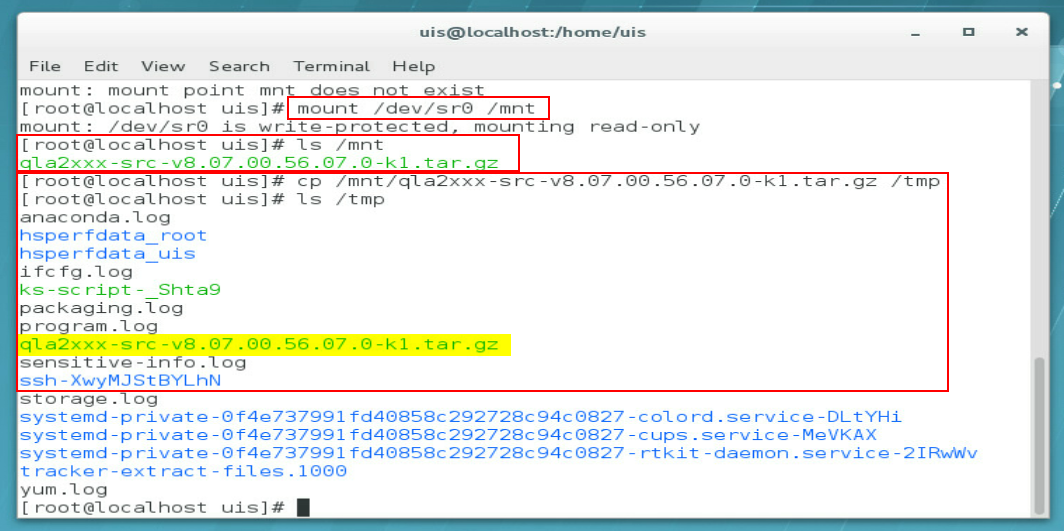

Install the RAID controller driver package by following the procedures in the Readme packed with the RAID controller driver package obtained from the H3C official website.
If the system displays that the driver name is in use when you remove the driver shipped with the kernel by executing the modpobe –r driver_name or rmmod driver_name command, it indicates that the hard drive connected to the storage controller has the system disk where the controller is created. In this case, do not remove the driver until you are prompted or reboot the server and then enter the BIOS Setup Utility to delete the original logical disk, create a new disk and then continue installation.

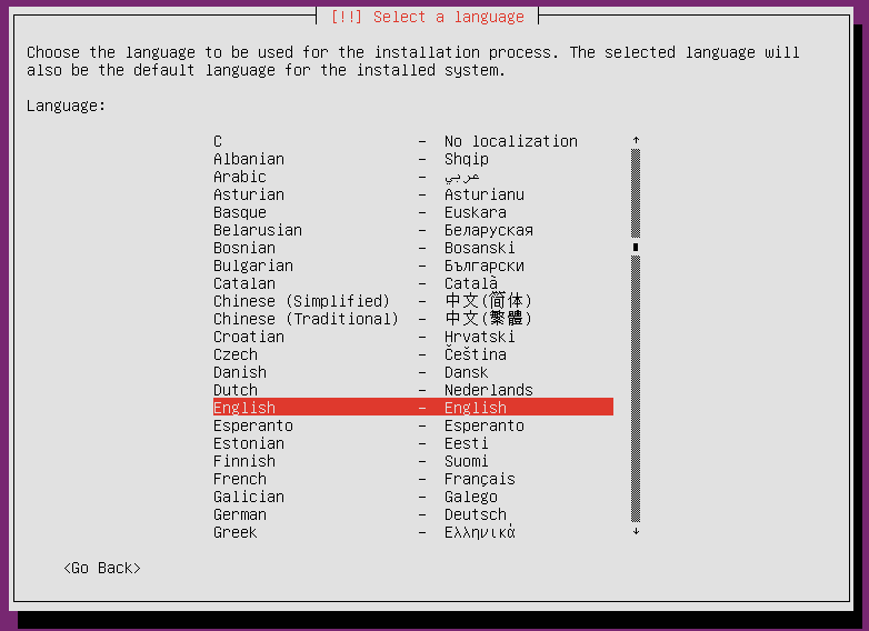

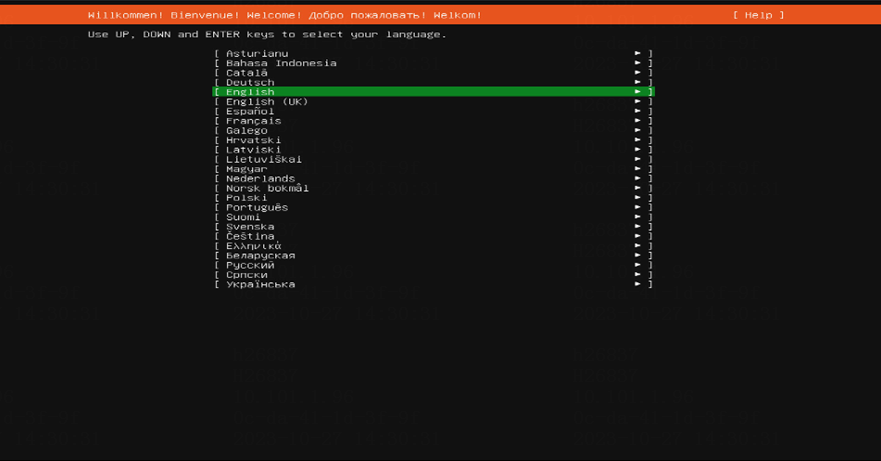

3.     Select a language, and then press Enter.
Figure 157 Selecting a language

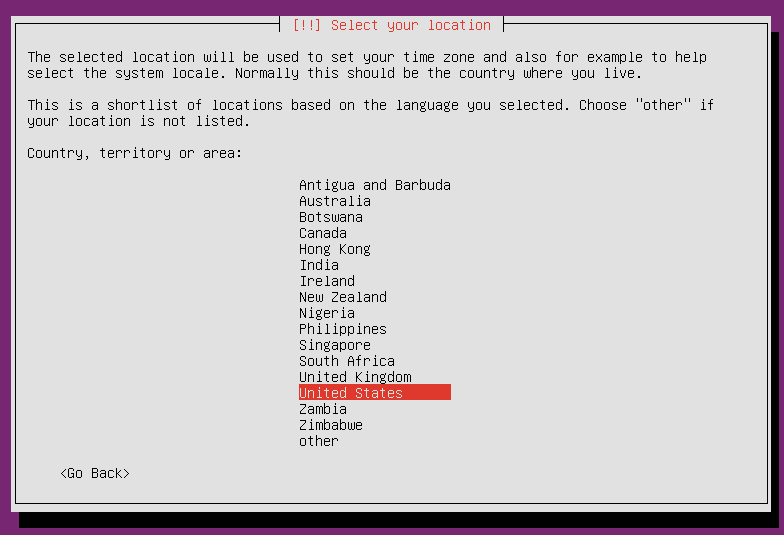

4.     Select your location, and then press Enter.
Figure 158 Selecting a location

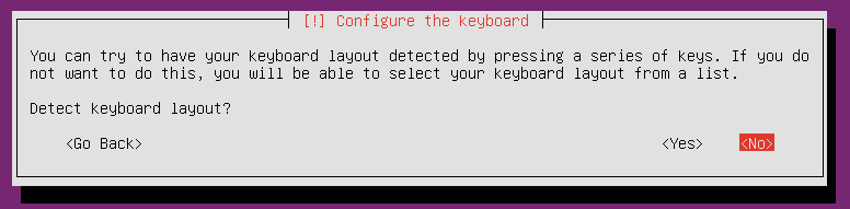

5.     Select whether to detect keyboard layout. This example skips keyboard layout detection.
Figure 159 Selecting whether to detect keyboard layout

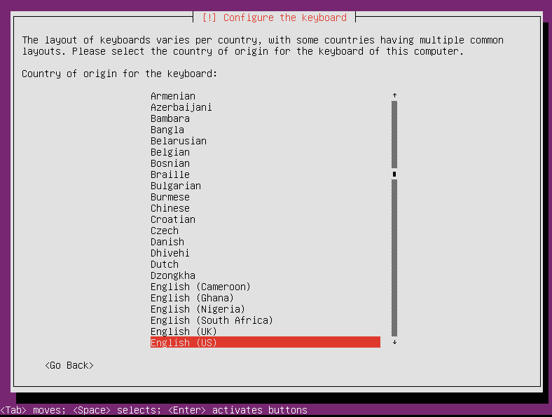

6.     Select the country of origin for the keyboard, and then press Enter.
Figure 160 Selecting the country of origin for the keyboard

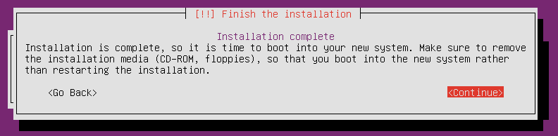

19.     Press Enter when the following page appears to complete installation.
Figure 176 Finishing the installation

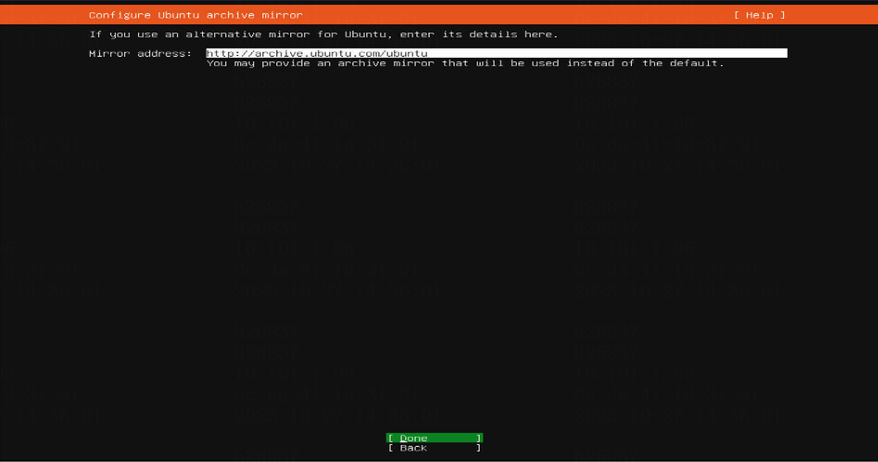

9.     As shown in Figure 187, set the mirror address. Enter the mirror address in the Mirror address field. Then, select Done and press Enter.
Figure 187 Setting the mirror address

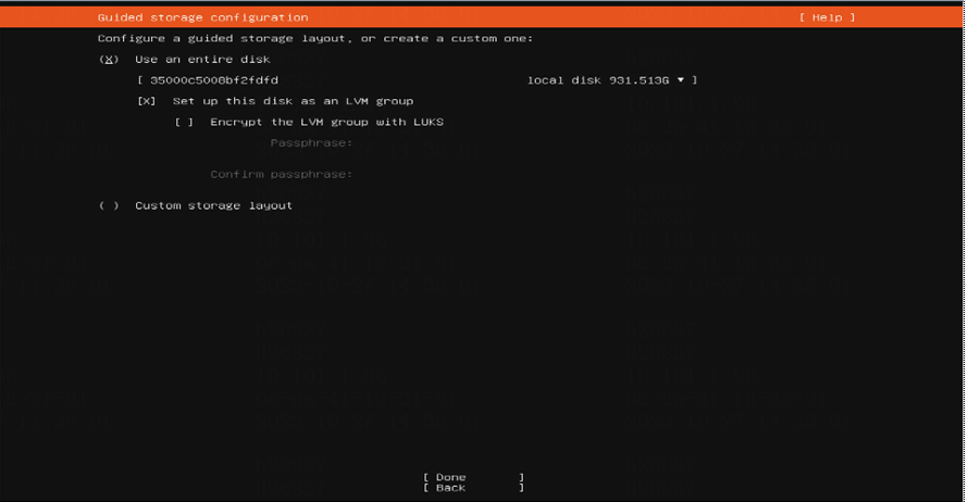

11.     As shown in Figure 189, configure partitions.
¡     In Use an entire disk mode, select a disk, move the cursor to Done, and press Enter. The system will partition the disk according to the default settings.
¡     In Custom storage layout mode, move the cursor to Done, and press Enter to enter the manual partitioning screen.
Figure 189 Configuring partitions
12.     As shown in Figure 190, manually partition disks. You can partition disks as needed. This example partition the disk based on the installation procedure. After partitioning, select Done and press Enter.
Figure 190 Manual partitioning

4.     On the INSTALLATION SUMMARY page that opens, configure the system information, including the installation destination, network name, and host name.
Figure 200 Configuring system information
a.     In the SYSTEM area of the INSTALLATION SUMMARY page, click Installation Destination. On the page that opens, select the destination devices, select a storage configuration, select whether to encrypt the data, and then click Done.
Figure 201 Configuring the installation destination
b.     In the SYSTEM area of the INSTALLATION SUMMARY page, click Network & Host Name. On the page that opens, select a network port, specify a host name, and then click Done.
Figure 202 Configuring the network name and host name

6.     After the installation finishes, click Root Password on the CONFIGURATION page to set the root password and click Done.
As a best practice, specify a strong password.
Figure 204 Setting the root password

13.     Enter the administrator password.
Figure 223 Entering the administrator password
