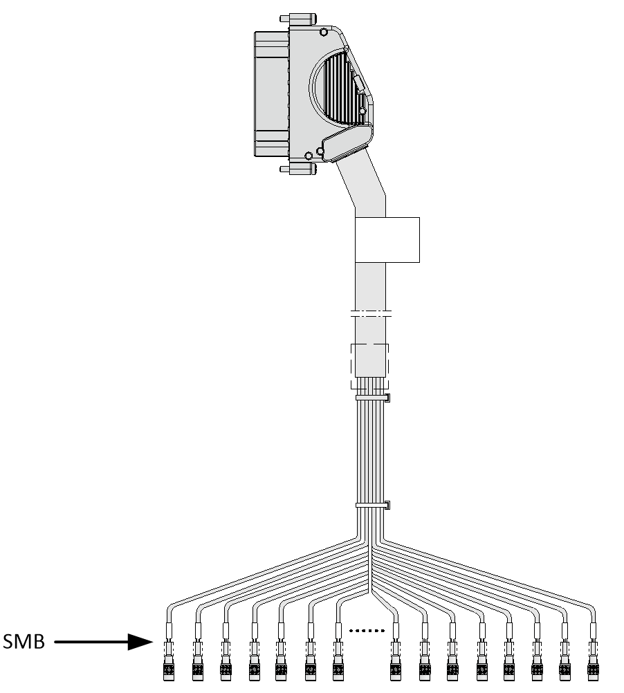

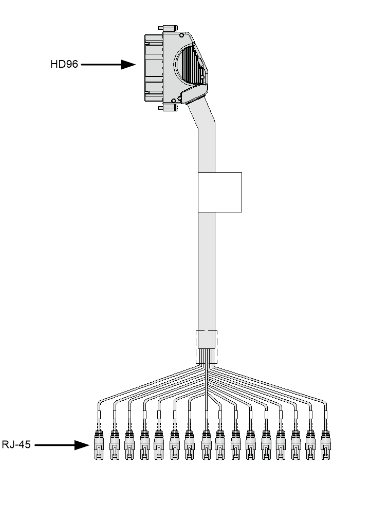

E1 cable
You can use an E1 cable to connect E1-HM96 Ethernet copper ports.
Figure3-4 E1 cable (1)
Figure3-5 E1 cable (2)
Figure3-6 E1 cable (3)

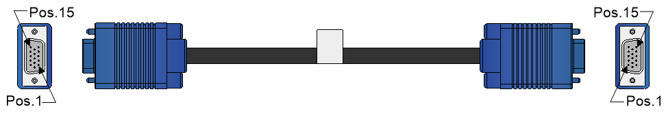

VGA cable
You can use a VGA cable to connect the universal open application platform and PC (or terminal).
Figure3-7 VGA cable
Table3-5 Cable connections between the universal open application platform and VGA connectors on the PC (or terminal)
VGA
Signal
1
VGA_RED
2
VGA_GREEN
3
VGA_BIUE
4
VGA_CABLE_PRSNT
5
GND
6
RED GND
7
GREEN GND
8
BIUE GND
9
P5V
10
GND
11
NC
12
VGA_SW_DATX
13
VGA_HSYNC
14
VGA_VSYNC
15
VGA_SW_CLKX

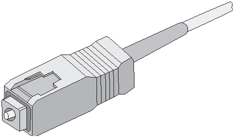

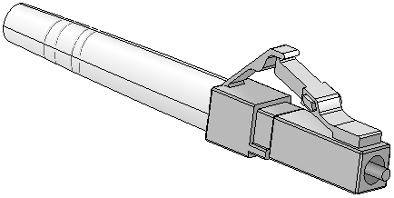

Fiber connector
Fiber connectors are indispensable passive components in an optical fiber communication system. They allow the removable connection between optical channels, which makes the optical system debugging and maintenance more convenient and the transit dispatching of the system more flexible.
Figure3-8 SC connector
Figure3-9 LC connector
