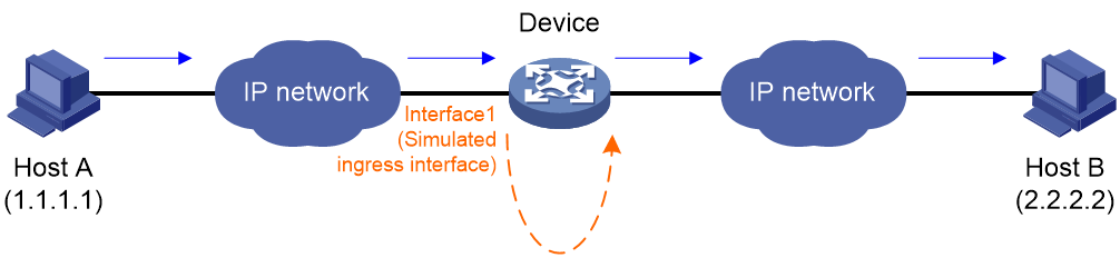

Packet trace uses a packet profile to construct traced packets, injects the packets to the device from an ingress interface, simulates the packet forwarding process, and traces the forwarding process. This feature can identify whether the device can forward packets correctly and whether packet loss has occurred during the forwarding process. If packets are lost, the feature can assist in locating the packet loss cause.
Application scenario
As shown in Figure 1, you can use packet trace as follows:
1.     Capture a packet sent from Host A to Host B on Interface 1 of the device.
2.     Configure a packet profile on the device according to the field values in the captured packet.
3.     Execute a packet trace operation. In the operation, specify the profile to construct traced packets and injects the packets to the device from Interface 1. The device simulates the packet forwarding process and traces the entire packet forwarding process, including the packets are injected, processed by software and hardware, and sent out of the device.
4.     View the packet trace operation result, obtain the forwarding process of the packets, identify whether packets are lost, and locate the packet drop reason.
Figure 1 Application scenario

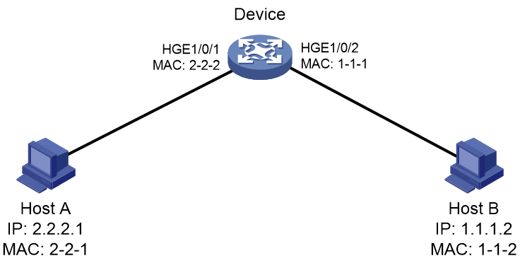

As shown in Figure 2, the Telnet client Telnets to the Telnet server. The Telnet connection is flapping.
Use the packet trace feature to identify whether Telnet packets are dropped when the packets pass through the device. If the packets are dropped on the device, locate the packet drop reason.
Figure 2 Network diagram

The output shows that the device can correctly forward the Telnet packets sent from the Telnet client to the Telnet server without packet loss. Packet loss occurred at other locations.

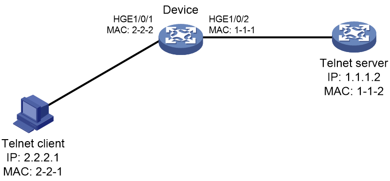

As shown in Figure 3, when Host A pings Host B, packets are lost. Use the packet trace feature to identify whether ping packets are dropped when the packets pass through the device. If the packets are dropped on the device, locate the packet drop reason.
Figure 3 Network diagram

The output shows that the device can correctly forward the ping packets sent from Host A to Host B without packet loss. Packet loss occurred at other locations.

[Sysname-packet-trace-r1-raw-packet] raw-packet-end
[Sysname-packet-trace-r1-raw] quit
# Execute a packet trace operation.
[Sysname] packet-trace execute profile r1 interface hundredgige 3/0/1
Packet Trace Result:
Forwarding path:
    ForwardingVlanValid
    L2DstHit
    L3SrcHostHit
    L3DestHostHit
    L3DestRouteHit
    L2SrcMiss
    MystationHit
Packet resolution:
    KnownL3UcPkt
Source port STP state:  Forward
Egress interface info:
 Destination mod:40 port:0
    l3 egress intf show 100001
Packet drop reason:
    NoDrop
# Display results about packet trace operations that use packet profile r1.
[Sysname] display packet-trace history profile r1
Ingress interface: HundredGigE3/0/1
Packet trace result 1:
Forwarding path:
    ForwardingVlanValid
    L2DstHit
    L3SrcHostHit
    L3DestHostHit
    L3DestRouteHit
    L2SrcMiss
    MystationHit
Packet resolution:
    KnownL3UcPkt
Packet drop reason:
NoDrop
The output shows that the device can correctly forward the data packets sent between the FTP client and the FTP server without packet loss. Packet loss occurred at other locations.
