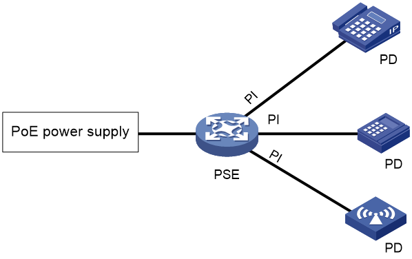

IEEE 802.3af-compliant power over Ethernet (PoE) enables a network device to supply power to terminals over twisted pair cables.
As shown in Figure 1, a PoE system includes the following elements:
·     PoE power supply—A PoE power supply provides power for the entire PoE system.
·     PSE—A power sourcing equipment (PSE) detects and classifies powered devices (PDs), supplies power to PDs, and monitors the PD power. PSEs include endpoint PSEs and midspan PSEs. An endpoint PSE is integrated in the device. A midspan PSE is independent of the device.
H3C PSEs are endpoint PSEs. Endpoint PSE devices are classified into single-PSE devices and multiple-PSE devices.
¡     A single-PSE device has only one PSE firmware.
¡     A multiple-PSE device has multiple PSEs. An interface card that can supply PoE power is a PSE. A multiple-PSE device uses PSE IDs to identify different PSEs. To display the mapping between the ID and slot number of a PSE, execute the display poe device command. The device is a multiple-PSE device.
·     PI—A power interface (PI) is a PoE-capable Ethernet interface on a PSE.
·     PD—A PD receives power from the PSE.
PDs include IP telephones, APs, portable chargers, POS terminals, and Web cameras.
You can also connect a PD to a redundant power source for reliability.
Figure 1 PoE system diagram
Only the S7503X-PoE, S7506X-PoE, and S7510X-PoE switches support PoE. For a PoE-capable switch to supply PoE power, install an LSQM4GV48SA0 or LSQM4GV48SC0 interface module on the switch.

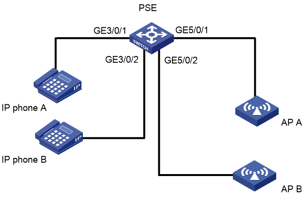

PoE configuration example
Network requirements
As shown in Figure 2, the device has PSE 10 and PSE 16, in slots 3 and 5, respectively. Configure PoE to meet the following requirements:
·     PSE 10 has a maximum power of 400 watts.
·     The device supplies power to IP phones and APs.
·     The device preferentially guarantees power supply to IP phone B when power overload occurs.
·     Power supplied to AP B does not exceed 9000 milliwatts.
Figure 2 Network diagram
Configuration procedure
# Enable the PI priority policy.
<PSE> system-view
[PSE] poe pd-policy priority
# Enable PoE for the PSEs.
[PSE] poe enable pse 10
[PSE] poe enable pse 16
# Set the maximum power of PSE 10 to 400 watts.
[PSE] poe pse 10 max-power 400
# Enable PoE on GigabitEthernet 3/0/1 and GigabitEthernet 5/0/1.
[PSE] interface gigabitethernet 3/0/1
[PSE-GigabitEthernet3/0/1] poe enable
[PSE-GigabitEthernet3/0/1] quit
[PSE] interface gigabitethernet 5/0/1
[PSE-GigabitEthernet5/0/1] poe enable
[PSE-GigabitEthernet5/0/1] quit
# Enable PoE on GigabitEthernet 3/0/2, and set its power priority to critical.
[PSE] interface gigabitethernet 3/0/2
[PSE-GigabitEthernet3/0/2] poe enable
[PSE-GigabitEthernet3/0/2] poe priority critical
[PSE-GigabitEthernet3/0/2] quit
# Enable PoE on GigabitEthernet 5/0/2, and set its maximum power to 9000 milliwatts.
[PSE] interface gigabitethernet 5/0/2
[PSE-GigabitEthernet5/0/2] poe enable
[PSE-GigabitEthernet5/0/2] poe max-power 9000
# Verify that the device is supplying power correctly to the IP phones and APs, and the IP phones and APs are operating correctly.
