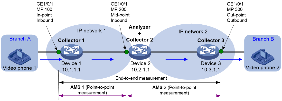

Figure 1 shows the important iNQA concepts including MP, collector, analyzer, and AMS.
Figure 1 Network diagram

As shown in Figure 1:
·     To measure the packet loss between MP 100 and MP 300, AMS is not needed.
·     If packet loss occurs between MP 100 and MP 300, configure AMS 1 and AMS 2 on the analyzer to locate on which span the packet loss occurs.
¡     Bind MP 100 of collector 1 and MP 200 of collector 2 to AMS 1. Add MP 100 to the ingress MP group of the AMS 1 and MP 200 to the egress MP group of the AMS 1.
¡     Bind MP 200 of collector 2 and MP 300 of collector 3 to AMS 2. Add MP 200 to the ingress MP group of the AMS 2 and MP 300 to the egress MP group of the AMS 2.

This measurement is based on atomic measurement spans (AMSs), which define smaller ranges than the end-to-end measurement. This method is helpful if you want to find out between which specific devices the packet loss occurs.
As shown in Figure 7, to configure point-to-point measurement, define AMSs, specify the flow direction in each AMS, and configure the ingress MP group and egress MP group for each AMS.
Figure 7 Point-to-point packet loss measurement

Example: Configuring an end-to-end iNQA packet loss measurement
As shown in Figure 9, Video phone 1 sends a video data flow to Video phone 2 through an IP network. The Video phone 2 is experiencing an erratic video display problem.
·     Enable the collector functionality on Device 1 and Device 2 and enable the analyzer functionality on Device 2.
·     Define the flow from Device 1 to Device 2 as the forward flow.
·     Set the packet loss upper limit and packet loss lower limit to 6% and 4%, respectively.
Figure 9 Network diagram

Example: Configuring an point-to-point iNQA packet loss measurement
As shown in Figure 10, Video phone 1 sends a video data flow to Video phone 2 through an IP network. The Video phone 2 is experiencing an erratic video display problem.
·     Enable the collector functionality on Device 1, Device 2, and Device 3, and enable the analyzer functionality on Device 2.
·     Define the flow from Device 1 to Device 3 as the forward flow.
·     Run the packet loss measurement for 15 minutes.
Figure 10 Network diagram
1.     Assign 10.1.1.1, 10.2.1.1, and 10.3.1.1 to Collector 1, Collector 2, and Collector 3, respectively.
2.     Configure OSPF in the IP network to make sure the analyzer Collector 1, Collector 3, and the analyzer can reach each other. (Details not shown.)
3.     Configure NTP or PTP on Collector 1, Collector 2, and Collector 3 for clock synchronization. (Details not shown.)
