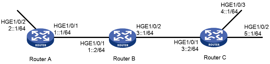

Example: Configuring basic RIPng
As shown in Figure 2, Router A, Router B, and Router C learn IPv6 routing information through RIPng. Configure route filtering on Router B to accept all received routes except the route 2::/64 and to advertise only the route 4::/64.
Figure 2 Network diagram
IMPORTANT
IMPORTANT:
By default, interfaces on the device are disabled (in ADM or Administratively Down state). To have an interface operate, you must use the undo shutdown command to enable that interface.
1.     Configure IPv6 addresses for the interfaces. (Details not shown.)
2.     Configure basic RIPng settings:
# Configure Router A.

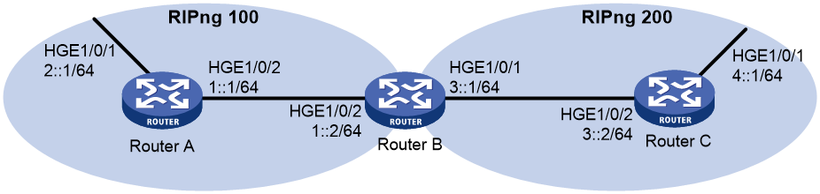

Example: Configuring RIPng route redistribution
As shown in Figure 3, Router B communicates with Router A through RIPng 100 and with Router C through RIPng 200.
Configure route redistribution on Router B, so the two RIPng processes can redistribute routes from each other.
Figure 3 Network diagram
# Enable RIPng 100 on Router A.
<RouterA> system-view
[RouterA] ripng 100
[RouterA-ripng-100] quit
[RouterA] interface hundredgige 1/0/1
[RouterA-HundredGigE1/0/1] ripng 100 enable
[RouterA-HundredGigE1/0/1] quit
[RouterA] interface hundredgige 1/0/2
[RouterA-HundredGigE1/0/2] ripng 100 enable
# Enable RIPng 100 and RIPng 200 on Router B.
<RouterB> system-view
[RouterB] ripng 100
[RouterB-ripng-100] quit
[RouterB] interface hundredgige 1/0/2
[RouterB-HundredGigE1/0/2] ripng 100 enable
[RouterB-HundredGigE1/0/2] quit
[RouterB] ripng 200
[RouterB-ripng-200] quit
[RouterB] interface hundredgige 1/0/1
[RouterB-HundredGigE1/0/1] ripng 200 enable
#  Enable RIPng 200 on Router C.
<RouterC> system-view
[RouterC] ripng 200
[RouterC] interface hundredgige 1/0/1
[RouterC-HundredGigE1/0/1] ripng 200 enable
[RouterC-HundredGigE1/0/1] quit
[RouterC] interface hundredgige 1/0/2
[RouterC-HundredGigE1/0/2] ripng 200 enable
[RouterC-HundredGigE1/0/2] quit
# Display the routing table on Router A.
[RouterA] display ipv6 routing-table
Destinations : 7 Routes : 7
Destination: ::1/128                                     Protocol  : Direct
NextHop    : ::1                                         Preference: 0
Interface  : InLoop0                                     Cost      : 0
Destination: 1::/64                                      Protocol  : Direct
NextHop    : ::                                          Preference: 0
Interface  : HGE1/0/2                                    Cost      : 0
Destination: 1::1/128                                    Protocol  : Direct
Destination: 2::/64                                      Protocol  : Direct
Interface  : HGE1/0/1                                    Cost      : 0
Destination: 2::1/128                                    Protocol  : Direct
Destination: FE80::/10                                   Protocol  : Direct
Interface  : NULL0                                       Cost      : 0
Destination: FF00::/8                                    Protocol  : Direct
3.     Configure RIPng route redistribution:
# Configure route redistribution between the two RIPng processes on Router B.
[RouterB] ripng 100
[RouterB-ripng-100] import-route ripng 200
[RouterB] ripng 200
[RouterB-ripng-200] import-route ripng 100

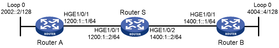

Example: Configuring RIPng GR
As shown in Figure 4, Router A, Router B, and Router C learn IPv6 routing information through RIPng.
Configure Router A as the GR restarter. Configure Router B and Router C as the GR helpers to synchronize their routing tables with Router A by using GR.
Figure 4 Network diagram

Example: Configuring RIPng NSR
As shown in Figure 5, Router S, Router A, and Router B learn IPv6 routing information through RIPng.
Enable RIPng NSR on Router S to ensure correct routing when an active/standby switchover occurs on Router S.
Figure 5 Network diagram
IMPORTANT
IMPORTANT:
2.     Configure RIPng on the routers to ensure the following: (Details not shown.)
¡     Router S, Router A, and Router B can communicate with each other at Layer 3.
¡     Dynamic route update can be implemented among them with RIPng.
3.     Enable RIPng NSR on Router S.
<RouterS> system-view
[RouterS] ripng 1
[RouterS-ripng-1] non-stop-routing
[RouterS-ripng-1] quit

# During the switchover period, display RIPng neighbors on Router A to verify the neighbor relationship between Router A and Router S.
[RouterA] display ripng 1 neighbor
 Neighbor Address: FE80::AE45:5CE7:422E:2867
     Interface  : HundredGigE1/0/1
     Version    : RIPng version 1     Last update: 00h00m23s
     Bad packets: 0                   Bad routes : 0
# Display RIPng routes on Router A to verify if Router A has a route to the loopback interface on Router B.
[RouterA] display ripng 1 route
   Route Flags: A - Aging, S - Suppressed, G - Garbage-collect, D - Direct
                O - Optimal, F - Flush to RIB
 Peer FE80::AE45:5CE7:422E:2867 on HundredGigE1/0/1
 Destination 1400:1::/64,
     via FE80::AE45:5CE7:422E:2867, cost 1, tag 0, AOF, 1 secs
 Destination 4004::4/128,
     via FE80::AE45:5CE7:422E:2867, cost 2, tag 0, AOF, 1 secs
 Local route
 Destination 2002::2/128,
     via ::, cost 0, tag 0, DOF
 Destination 1200:1::/64,
# Display RIPng neighbors on Router B to verify the neighbor relationship between Router B and Router S.
[RouterB] display ripng 1 neighbor
 Neighbor Address: FE80::20C:29FF:FECE:6277
     Version    : RIPng version 1     Last update: 00h00m18s
# Display RIPng routes on Router B to verify if Router B has a route to the loopback interface on Router A.
[RouterB] display ripng 1 route
 Peer FE80::20C:29FF:FECE:6277 on HundredGigE1/0/1
     via FE80::20C:29FF:FECE:6277, cost 2, tag 0, AOF, 24 secs
     via FE80::20C:29FF:FECE:6277, cost 1, tag 0, AOF, 24 secs
 Local route
The output shows the following when an active/standby switchover occurs on Router S:
·     The neighbor relationships and routing information on Router A and Router B have not changed.
·     The traffic from Router A to Router B has not been impacted.
Example: Configuring RIPng FRR
As shown in Figure 6, Router A, Router B, and Router C run RIPng. Configure RIPng FRR so that when Link A becomes unidirectional, traffic can be switched to Link B immediately.
Figure 6 Network diagram
Device
Interface
IP address
Router A
HundredGigE 1/0/1
1::1/64
Router A
HundredGigE 1/0/2
2::1/64
Router A
Loopback 0
10::1/128
Router B
HundredGigE 1/0/1
3::1/64
Router B
HundredGigE 1/0/2
2::2/64
Router B
Loopback 0
20::1/128
Router C
HundredGigE 1/0/1
1::2/64
Router C
HundredGigE 1/0/2
3::2/64
IMPORTANT
IMPORTANT:
1.     Configure IPv6 addresses for the interfaces on the routers. (Details not shown.)
2.     Configure RIPng on the routers to make sure Router A, Router B, and Router C can communicate with each other at the network layer. (Details not shown.)
3.     Configure RIPng FRR:
[RouterA] ipv6 prefix-list abc index 10 permit 20::1 128
[RouterA] route-policy frr permit node 10
[RouterA-route-policy-frr-10] if-match ipv6 address prefix-list abc
[RouterA-route-policy-frr-10] apply ipv6 fast-reroute backup-interface hundredgige 1/0/1 backup-nexthop 1::2

# Display the route 20::1/128 on Router A to view the backup next hop information.
[RouterA] display ipv6 routing-table 20::1 128 verbose
Summary count : 1
Destination: 20::1/128
   Protocol: RIPng
  Process ID: 1
   SubProtID: 0x0                        Age: 00h17m42s
        Cost: 1                   Preference: 100
       IpPre: N/A                 QosLocalID: N/A
         Tag: 0                        State: Inactive Adv
   OrigTblID: 0x0                    OrigVrf: default-vrf
     TableID: 0xa                     OrigAs: 0
       NibID: 0x22000003              LastAs: 0
      AttrID: 0xffffffff            Neighbor: FE80::34CD:9FF:FE2F:D02
       Flags: 0x41               OrigNextHop: FE80::34CD:9FF:FE2F:D02
       Label: NULL               RealNextHop: FE80::34CD:9FF:FE2F:D02
     BkLabel: NULL                 BkNextHop: FE80::7685:45FF:FEAD:102
     SRLabel: NULL                 Interface: HundredGigE1/0/2
   BkSRLabel: NULL               BkInterface: HundredGigE1/0/1
   Tunnel ID: Invalid            IPInterface: HundredGigE1/0/2
 BkTunnel ID: Invalid          BKIPInterface: HundredGigE1/0/1
     InLabel: NULL            ColorInterface: N/A
    SIDIndex: NULL          BKColorInterface: N/A
    FtnIndex: 0x0            TunnelInterface: N/A
TrafficIndex: N/A          BKTunnelInterface: N/A
   Connector: N/A                     PathID: 0x0
  SRTunnelID: Invalid
    SID Type: N/A                        NID: Invalid
    FlushNID: Invalid                  BkNID: Invalid
  BkFlushNID: Invalid              StatFlags: 0x0
         Exp: N/A
   VpnPeerId: N/A                       Dscp: N/A
         SID: N/A           OrigLinkID: 0x0
       BkSID: N/A           RealLinkID: 0x0
CommBlockLen: 0
