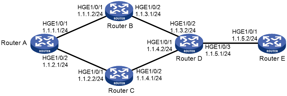

In certain cases, route summarization might result in incorrect route calculation because it disables subnet route advertisement. If the routing table contains non-contiguous subnets, disable automatic route summarization so that RIPv2 can advertise subnet routes and host routes for correct route calculation.
As shown in Figure 1, RIPv2 is enabled on all interfaces on Device A, Device B, and Device C. If automatic route summarization is enabled (default setting), both Device A and Device C will send 10.1.0.0/8 to Device B. To ensure correct route calculation on Device B based on subnets 10.1.0.0/16 and 10.2.0.0/16, disable RIPv2 automatic route summarization.
Figure 1 Disabling RIPv2 automatic route summarization
To prevent loops caused by route summarization, create a black hole route by specifying interface NULL 0 as the output interface of the summary route. Packets that match the black hole route are dropped.

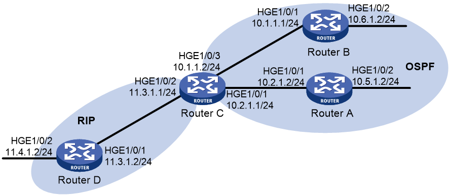

Example: Configuring basic RIP
As shown in Figure 3, enable RIPv2 on all interfaces on Router A and Router B. Configure Router B to not advertise route 10.2.1.0/24 to Router A, and to accept only route 2.1.1.0/24 from Router A.
Figure 3 Network diagram
IMPORTANT
IMPORTANT:
By default, interfaces on the device are disabled (in ADM or Administratively Down state). To have an interface operate, you must use the undo shutdown command to enable that interface.

# Display the RIP routing table on Router A.
[RouterA] display rip 1 route
 Route Flags: R - RIP, T - TRIP
              P - Permanent, A - Aging, S - Suppressed, G - Garbage-collect
              D - Direct, O - Optimal, F - Flush to RIB
 Peer 1.1.1.2 on HundredGigE1/0/1
      Destination/Mask        Nexthop           Cost    Tag     Flags   Sec
      10.0.0.0/8              1.1.1.2           1       0       RAOF    9
 Local route
      1.1.1.0/24              0.0.0.0           0       0       RDOF    -
      2.1.1.0/24              0.0.0.0           0       0       RDOF    -
      3.1.1.0/24              0.0.0.0           0       0       RDOF    -
The output shows that RIPv1 uses natural masks to advertise routing information.

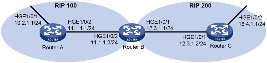

Example: Configuring RIP route redistribution
As shown in Figure 4, Router B communicates with Router A through RIP 100 and with Router C through RIP 200.
Configure RIP 200 to redistribute direct routes and routes from RIP 100 on Router B so Router C can learn routes destined for 10.2.1.0/24 and 11.1.1.0/24. Router A cannot learn routes destined for 12.3.1.0/24 and 16.4.1.0/24.
Figure 4 Network diagram
IMPORTANT
IMPORTANT:
1.     Configure IP addresses for the interfaces. (Details not shown.)

3.     Configure RIP route redistribution:
# Configure RIP 200 to redistribute direct routes and routes from RIP 100 on Router B.
[RouterB] rip 200
[RouterB-rip-200] import-route rip 100
[RouterB-rip-200] import-route direct
[RouterB-rip-200] quit

Example: Configuring an additional metric for a RIP interface
As shown in Figure 5, run RIPv2 on all the interfaces of Router A, Router B, Router C, Router D, and Router E.
Router A has two links to Router D. The link from Router B to Router D is more stable than that from Router C to Router D. Configure an additional metric for RIP routes received from HundredGigE 1/0/2 on Router A so Router A prefers route 1.1.5.0/24 learned from Router B.
Figure 5 Network diagram
IMPORTANT
IMPORTANT:
1.     Configure IP addresses for the the interfaces. (Details not shown.)
2.     Configure basic RIP settings:
# Configure Router A.
<RouterA> system-view
[RouterA] rip
[RouterA-rip-1] network 1.0.0.0
[RouterA-rip-1] version 2
[RouterA-rip-1] undo summary
[RouterA-rip-1] quit
# Configure Router B.
<RouterB> system-view
[RouterB] rip
[RouterB-rip-1] network 1.0.0.0
[RouterB-rip-1] version 2
[RouterB-rip-1] undo summary
# Configure Router C.
<RouterC> system-view
[RouterC] rip
[RouterC-rip-1] network 1.0.0.0
[RouterC-rip-1] version 2
[RouterC-rip-1] undo summary
# Configure Router D.
<RouterD> system-view
[RouterD] rip
[RouterD-rip-1] network 1.0.0.0
[RouterD-rip-1] version 2
[RouterD-rip-1] undo summary
# Configure Router E.
<RouterE> system-view
[RouterE] rip
[RouterE-rip-1] network 1.0.0.0
[RouterE-rip-1] version 2
[RouterE-rip-1] undo summary
# Display all active routes in the RIP database on Router A.
[RouterA] display rip 1 database
   1.0.0.0/8, auto-summary
       1.1.1.0/24, cost 0, nexthop 1.1.1.1, RIP-interface
       1.1.2.0/24, cost 0, nexthop 1.1.2.1, RIP-interface
       1.1.3.0/24, cost 1, nexthop 1.1.1.2
       1.1.4.0/24, cost 1, nexthop 1.1.2.2
       1.1.5.0/24, cost 2, nexthop 1.1.1.2
       1.1.5.0/24, cost 2, nexthop 1.1.2.2
The output shows two RIP routes destined for network 1.1.5.0/24. The next hops of the routes are Router B (1.1.1.2) and Router C (1.1.2.2). The cost of the routes is 2.

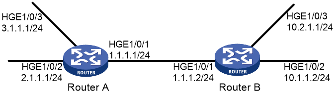

Example: Configuring RIP to advertise a summary route
As shown in Figure 6, Router A and Router B run OSPF, Router D runs RIP, and Router C runs OSPF and RIP.
·     Configure RIP to redistribute OSPF routes on Router C so Router D can learn routes destined for networks 10.1.1.0/24, 10.2.1.0/24, 10.5.1.0/24, and 10.6.1.0/24.
·     To reduce the routing table size of Router D, configure route summarization on Router C to advertise only the summary route 10.0.0.0/8 to Router D.
Figure 6 Network diagram
2.     Configure basic OSPF settings:
[RouterA] ospf
[RouterA-ospf-1] area 0
[RouterA-ospf-1-area-0.0.0.0] network 10.5.1.0 0.0.0.255
[RouterA-ospf-1-area-0.0.0.0] network 10.2.1.0 0.0.0.255
[RouterA-ospf-1-area-0.0.0.0] quit
[RouterB] ospf
[RouterB-ospf-1] area 0
[RouterB-ospf-1-area-0.0.0.0] network 10.1.1.0 0.0.0.255
[RouterB-ospf-1-area-0.0.0.0] network 10.6.1.0 0.0.0.255
[RouterB-ospf-1-area-0.0.0.0] quit
[RouterC] ospf
[RouterC-ospf-1] area 0
[RouterC-ospf-1-area-0.0.0.0] network 10.1.1.0 0.0.0.255
[RouterC-ospf-1-area-0.0.0.0] network 10.2.1.0 0.0.0.255
[RouterC-ospf-1-area-0.0.0.0] quit
[RouterC-ospf-1] quit
3.     Configure basic RIP settings:
[RouterC] rip 1
[RouterC-rip-1] network 11.3.1.0
[RouterD] rip 1
[RouterD-rip-1] network 11.0.0.0
[RouterD-rip-1] quit
# Configure RIP to redistribute routes from OSPF process 1 and direct routes on Router C.
[RouterC-rip-1] import-route direct
[RouterC-rip-1] import-route ospf 1
[RouterC-rip-1] quit
# Display the IP routing table on Router D.
[RouterD] display ip routing-table
         Destinations : 15       Routes : 15
0.0.0.0/32          Direct 0    0            127.0.0.1       InLoop0
10.1.1.0/24         RIP    100  1            11.3.1.1        HGE1/0/1
10.2.1.0/24         RIP    100  1            11.3.1.1        HGE1/0/1
10.5.1.0/24         RIP    100  1            11.3.1.1        HGE1/0/1
10.6.1.0/24         RIP    100  1            11.3.1.1        HGE1/0/1
11.3.1.0/24         Direct 0    0            11.3.1.2        HGE1/0/1
11.3.1.0/32         Direct 0    0            11.3.1.2        HGE1/0/1
11.3.1.2/32         Direct 0    0            127.0.0.1       InLoop0
11.4.1.0/24         Direct 0    0            11.4.1.2        HGE1/0/2
11.4.1.0/32         Direct 0    0            11.4.1.2        HGE1/0/2
11.4.1.2/32         Direct 0    0            127.0.0.1       InLoop0
127.0.0.0/8         Direct 0    0            127.0.0.1       InLoop0
127.0.0.0/32        Direct 0    0            127.0.0.1       InLoop0
127.0.0.1/32        Direct 0    0            127.0.0.1       InLoop0
127.255.255.255/32  Direct 0    0            127.0.0.1       InLoop0
4.     Configure route summarization:
# Configure route summarization on Router C to advertise only the summary route 10.0.0.0/8.
[RouterC] interface hundredgige 1/0/2
[RouterC-HundredGigE1/0/2] rip summary-address 10.0.0.0 8
Destinations : 12        Routes : 12
10.0.0.0/8          RIP    100  1            11.3.1.1        HGE1/0/1

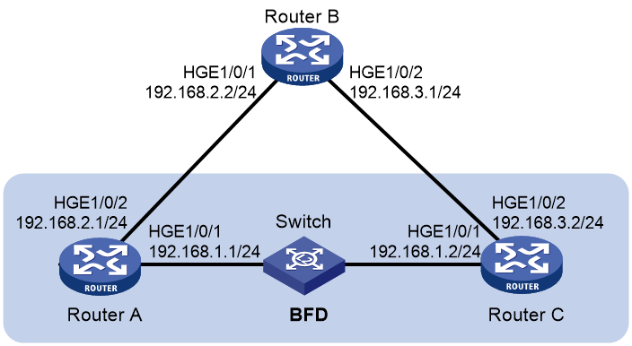

Example: Configuring BFD for RIP (single-hop echo detection for a directly connected neighbor)
As shown in Figure 9, HundredGigE 1/0/1 of Router A and Router C runs RIP process 1. HundredGigE 1/0/2 of Router A runs RIP process 2. HundredGigE 1/0/2 of Router C and HundredGigE 1/0/1 and HundredGigE 1/0/2 of Router B run RIP process 1.
·     Configure a static route destined for 100.1.1.1/24 and enable static route redistribution into RIP on Router C. This allows Router A to learn two routes destined for 100.1.1.1/24 through HundredGigE 1/0/1 and HundredGigE 1/0/2 respectively, and uses the one through HundredGigE 1/0/1.
·     Enable BFD for RIP on HundredGigE 1/0/1 of Router A. When the link over HundredGigE 1/0/1 fails, BFD can quickly detect the failure and notify RIP. RIP deletes the neighbor relationship and route information learned on HundredGigE 1/0/1, and uses the route destined for 100.1.1.1 24 through HundredGigE 1/0/2.
Figure 9 Network diagram
IMPORTANT
IMPORTANT:
1.     Configure IP addresses for interfaces. (Details not shown.)
[RouterA] rip 1
[RouterA-rip-1] network 192.168.1.0
[RouterA] rip 2
[RouterA-rip-2] network 192.168.2.0
[RouterA-rip-2] quit
[RouterB] rip 1
[RouterB-rip-1] network 192.168.2.0
[RouterB-rip-1] network 192.168.3.0
[RouterB-rip-1] quit
[RouterC] rip 1
[RouterC-rip-1] network 192.168.1.0
[RouterC-rip-1] network 192.168.3.0
[RouterC-rip-1] import-route static
3.     Enable BFD and configure BFD parameters on Router A.
[RouterA] bfd echo-source-ip 11.11.11.11
[RouterA] interface hundredgige 1/0/1
[RouterA-HundredGigE1/0/1] rip bfd enable
[RouterA-HundredGigE1/0/1] bfd min-echo-receive-interval 500
[RouterA-HundredGigE1/0/1] bfd detect-multiplier 7
[RouterA-HundredGigE1/0/1] quit
4.     Configure a static route on Router C.
[RouterC] ip route-static 120.1.1.1 24 null 0
# Display the BFD session information on Router A.
<RouterA> display bfd session
 Total sessions: 1        Up sessions: 1        Init mode: Active
 IPv4 session working in echo mode:
 LD               SourceAddr      DestAddr        State Holdtime    Interface
 4                192.168.1.1     192.168.1.2     Up    2000ms      GE1/0/1
# Display RIP routes destined for 120.1.1.0/24 on Router A.
<RouterA> display ip routing-table 120.1.1.0 24
Summary count : 1
Destination/Mask   Proto   Pre Cost        NextHop         Interface
120.1.1.0/24       RIP     100 1           192.168.1.2     HGE1/0/1
The output shows that Router A communicates with Router C through HundredGigE 1/0/1. Then the link over HundredGigE 1/0/1 fails.
Summary count : 1
120.1.1.0/24       RIP     100 2           192.168.2.2     HGE1/0/2
The output shows that Router A communicates with Router C through HundredGigE 1/0/2.

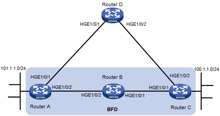

Example: Configuring BFD for RIP (single-hop echo detection for a specific destination)
As shown in Figure 10, HundredGigE 1/0/2 of Router A and HundredGigE 1/0/1 of Router B run RIP process 1. HundredGigE 1/0/2 of Router B and Router C runs RIP process 1.
·     Configure a static route destined for 100.1.1.0/24 and enable static route redistribution into RIP on both Router A and Router C. This allows Router B to learn two routes destined for 100.1.1.0/24 through HundredGigE 1/0/1 and HundredGigE 1/0/2. The route redistributed from Router A has a smaller cost than that redistributed from Router C, so Router B uses the route through HundredGigE 1/0/1.
·     Enable BFD for RIP on HundredGigE 1/0/2 of Router A, and specify HundredGigE 1/0/1 of Router B as the destination. When a unidirectional link occurs between Router A and Router B, BFD can quickly detect the link failure and notify RIP. RIP then deletes the neighbor relationship and the route information learned on HundredGigE 1/0/2. It does not receive or send any packets on HundredGigE 1/0/2. When the route learned from Router A ages out, Router B uses the route destined for 100.1.1.1/24 through HundredGigE 1/0/2.
Figure 10 Network diagram
IMPORTANT
IMPORTANT:
[RouterA] rip 1
[RouterA-rip-1] network 192.168.2.0
[RouterA-rip-1] import-route static
[RouterB] rip 1
[RouterC] rip 1
[RouterC-rip-1] import-route static cost 3
[RouterA] interface hundredgige 1/0/2
[RouterA-HundredGigE1/0/2] rip bfd enable destination 192.168.2.2
[RouterA-HundredGigE1/0/2] bfd min-echo-receive-interval 500
[RouterA-HundredGigE1/0/2] quit
4.     Configure static routes:
# Configure a static route on Router A.
[RouterA] ip route-static 100.1.1.0 24 null 0
# Configure a static route on Router C.
[RouterC] ip route-static 100.1.1.0 24 null 0
 3                192.168.2.1     192.168.2.2     Up    2000ms      HGE1/0/2

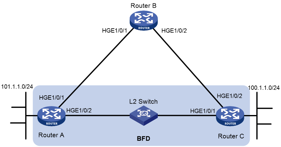

Example: Configuring BFD for RIP (bidirectional control detection for an indirectly connected neighbor)
As shown in Figure 11, HundredGigE 1/0/2 of Router A and HundredGigE 1/0/1 of Router C run RIP process 1. HundredGigE 1/0/1 on Router A runs RIP process 2. HundredGigE 1/0/2 on Router C, and HundredGigE 1/0/1 and HundredGigE 1/0/2 on Router D run RIP process 1.
·     Configure a static route destined for 100.1.1.0/24 on Router A.
·     Configure a static route destined for 101.1.1.0/24 on Router C.
·     Enable static route redistribution into RIP on Router A and Router C. This allows Router A to learn two routes destined for 100.1.1.0/24 through HundredGigE 1/0/2 and HundredGigE 1/0/1. It uses the route through HundredGigE 1/0/2.
·     Enable BFD for RIP on HundredGigE 1/0/2 of Router A and HundredGigE 1/0/1 of Router C.
When the link over HundredGigE 1/0/2 fails, BFD can quickly detect the link failure and notify RIP. RIP deletes the neighbor relationship and the route information learned on HundredGigE 1/0/2, and uses the route destined for 100.1.1.0/24 through HundredGigE 1/0/1.
Figure 11 Network diagram
Device
Interface
IP address
Router A
HundredGigE 1/0/1
192.168.3.1/24
Router A
HundredGigE 1/0/2
192.168.1.1/24
Router B
HundredGigE 1/0/1
192.168.2.1/24
Router B
HundredGigE 1/0/2
192.168.1.2/24
Router C
HundredGigE 1/0/1
192.168.2.2/24
Router C
HundredGigE 1/0/2
192.168.4.2/24
Router D
HundredGigE 1/0/1
192.168.3.2/24
Router D
HundredGigE 1/0/2
192.168.4.1/24

3.     Configure BFD settings:
# Enable BFD and configure BFD parameters on Router A.
[RouterA] bfd session init-mode active
[RouterA-HundredGigE1/0/2] bfd min-transmit-interval 500
[RouterA-HundredGigE1/0/2] bfd min-receive-interval 500
[RouterA-HundredGigE1/0/2] bfd detect-multiplier 7
# Enable BFD and configure BFD parameters on Router C.
[RouterC] bfd session init-mode active
[RouterC] interface hundredgige 1/0/1
[RouterC-HundredGigE1/0/1] rip bfd enable
[RouterC-HundredGigE1/0/1] bfd min-transmit-interval 500
[RouterC-HundredGigE1/0/1] bfd min-receive-interval 500
[RouterC-HundredGigE1/0/1] bfd detect-multiplier 6
[RouterC-HundredGigE1/0/1] quit
# Configure a static route to Router C on Router A.
[RouterA] ip route-static 192.168.2.0 24 hundredgige 1/0/2 192.168.1.2
[RouterA] quit
# Configure a static route to Router A on Router C.
[RouterC] ip route-static 192.168.1.0 24 hundredgige 1/0/1 192.168.2.1
[RouterA] display bfd session
 IPv4 session working in control mode:
 LD/RD            SourceAddr      DestAddr        State Holdtime    Interface
 513/513          192.168.1.1     192.168.2.2     Up    1700ms      HGE1/0/2
# Display RIP routes destined for 100.1.1.0/24 learned on Router A.
[RouterA] display ip routing-table 100.1.1.0 24
Summary count : 1
100.1.1.0/24       RIP     100 1           192.168.2.2     HGE1/0/2
The output shows that Router A communicates with Router C through HundredGigE 1/0/2. Then the link over HundredGigE 1/0/2 fails.
# Display RIP routes destined for 100.1.1.0/24 on Router A.
Summary count : 1
100.1.1.0/24       RIP     100 2           192.168.3.2     HGE1/0/1
Example: Configuring BFD for RIP (bidirectional control detection for a directly connected neighbor)
As shown in Figure 12, HundredGigE 1/0/2 of Router A and HundredGigE 1/0/1 of Router C run RIP process 1. HundredGigE 1/0/1 on Router A runs RIP process 2. HundredGigE 1/0/2 on Router C, and HundredGigE 1/0/1 and HundredGigE 1/0/2 on Router B run RIP process 1.
When link Router A—L2 Switch—Router C fails, BFD can quickly detect the link failure and notify RIP. RIP immediately switches to the Router A—Router B—Router C.
Figure 12 Network diagram
IMPORTANT
IMPORTANT:
[RouterA] rip 1
[RouterA-rip-1] network 101.1.1.0
[RouterA] rip 2
[RouterA-rip-2] version 2
[RouterA-rip-2] undo summary
[RouterA-rip-2] network 192.168.3.0
[RouterB] rip 1
[RouterB-rip-1] network 192.168.4.0
[RouterC] rip 1
[RouterC-rip-1] network 192.168.4.0
[RouterC-rip-1] network 100.1.1.0
[RouterA-HundredGigE1/0/2] rip bfd enable ctrl
[RouterC-HundredGigE1/0/1] rip bfd enable ctrl
 513/513          192.168.1.1     192.168.1.2     Up    1700ms      HGE1/0/2
Summary count : 1
100.1.1.0/24       RIP     100 1           192.168.1.2     HGE1/0/2
The output shows that Router A communicates with Router C through L2 Switch.
# When Router A—L2 Switch—Router C fails, display RIP routes destined for 100.1.1.0/24 on Router A.
Summary count : 1
The output shows that Router A communicates with Router C through Router B.
