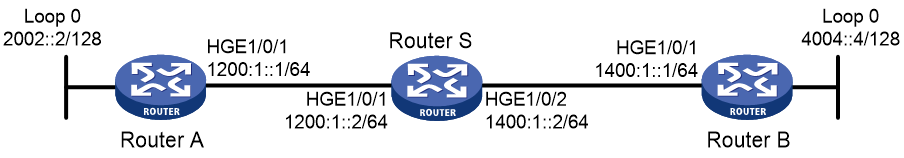

Example: Configuring basic RIPng
As shown in Figure 2, Router A, Router B, and Router C learn IPv6 routing information through RIPng. Configure route filtering on Router B to accept all received routes except the route 2::/64 and to advertise only the route 4::/64.
IMPORTANT: By default, interfaces on the device are disabled (in ADM or Administratively Down state). To have an interface operate, you must use the undo shutdown command to enable that interface. |
1. Configure IPv6 addresses for the interfaces. (Details not shown.)
2. Configure basic RIPng settings:
# Configure Router A.

# Display the RIPng routing table on Router B.
[RouterB] display ripng 1 route

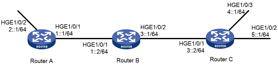

Example: Configuring RIPng route redistribution
As shown in Figure 3, Router B communicates with Router A through RIPng 100 and with Router C through RIPng 200.
Configure route redistribution on Router B, so the two RIPng processes can redistribute routes from each other.
# Enable RIPng 100 on Router A.

# Display the routing table on Router A.
[RouterA] display ipv6 routing-table

Example: Configuring RIPng NSR
As shown in Figure 5, Router S, Router A, and Router B learn IPv6 routing information through RIPng.
Enable RIPng NSR on Router S to ensure correct routing when an active/standby switchover occurs on Router S.
2. Configure RIPng on the routers to ensure the following: (Details not shown.)
¡ Router S, Router A, and Router B can communicate with each other at Layer 3.
¡ Dynamic route update can be implemented among them with RIPng.
3. Enable RIPng NSR on Router S.
<RouterS> system-view
[RouterS] ripng 1
[RouterS-ripng-1] non-stop-routing
[RouterS-ripng-1] quit

The output shows the following when an active/standby switchover occurs on Router S:
· The neighbor relationships and routing information on Router A and Router B have not changed.
· The traffic from Router A to Router B has not been impacted.
Example: Configuring RIPng FRR
As shown in Figure 6, Router A, Router B, and Router C run RIPng. Configure RIPng FRR so that when Link A becomes unidirectional, traffic can be switched to Link B immediately.
Device |
Interface |
IP address |
Router A |
1. Configure IPv6 addresses for the interfaces on the routers. (Details not shown.)
2. Configure RIPng on the routers to make sure Router A, Router B, and Router C can communicate with each other at the network layer. (Details not shown.)
3. Configure RIPng FRR:
<RouterA> system-view
[RouterA] ipv6 prefix-list abc index 10 permit 20::1 128
[RouterA] route-policy frr permit node 10
[RouterA-route-policy-frr-10] if-match ipv6 address prefix-list abc
[RouterA-route-policy-frr-10] apply ipv6 fast-reroute backup-interface hundredgige 1/0/1 backup-nexthop 1::2
[RouterA-route-policy-frr-10] quit
[RouterA] ripng 1
[RouterA-ripng-1] fast-reroute route-policy frr
[RouterA-ripng-1] quit
