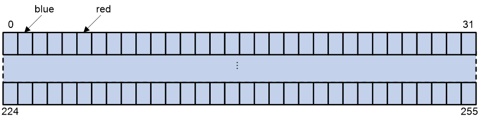

IS-IS address
As shown in Figure 1, an NSAP address comprises the Initial Domain Part (IDP) and the Domain Specific Part (DSP). The IDP is analogous to the network ID of an IP address, and the DSP is analogous to the subnet and host ID.
The IDP includes the Authority and Format Identifier (AFI) and the Initial Domain Identifier (IDI).
The DSP includes:
·     High Order Part of DSP (HO-DSP)Identifies the area.
·     System ID—Identifies the host.
·     SEL—Also known as the N-SEL or the NSAP selector (SEL). It is similar to the protocol identifier in IP and is used to identify the type of service. Different transport layer protocols correspond to different SELs.
The IDP and DSP are variable in length. The length of an NSAP address is in the range of 8 to 20 bytes.
Figure 1 NSAP address format

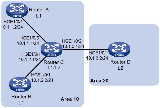

IS-IS routers on a broadcast network must elect a DIS.
The Level-1 and Level-2 DISs are elected separately. You can assign different priorities to a router for different level DIS elections. The higher the router priority, the more likely the router becomes the DIS. If multiple routers with the same highest DIS priority exist, the one with the highest Subnetwork Point of Attachment (SNPA) address will be elected. On a broadcast network, the SNPA address is the MAC address. A router can be the DIS for different levels.
IS-IS DIS election differs from OSPF DIS election in the following ways:
·     A router with priority 0 can also participate in the DIS election.
·     When a router with a higher priority is added to the network, an LSP flooding process is performed to elect the router as the new DIS.
As shown in Figure 4, the same level routers on a network, including non-DIS routers, establish adjacency with each other.
Figure 4 DIS in the IS-IS broadcast network

IS-IS PDUs are encapsulated into link layer frames. An IS-IS PDU has two parts, the headers and the variable length fields. The headers comprise the PDU common header and the PDU specific header. All PDUs have the same PDU common header. The specific headers vary by PDU type.
Figure 5 PDU format

Configuring IS-IS route leaking
By default, the Level-2 router does not advertise the routes of the Level-2 area and other Level-1 areas to a Level-1 area. The Level-1 routers in that Level-1 area sends packets destined for other areas to the nearest Level-1-2 router. As a result, IS-IS cannot use the optimal route to forward these packets. To resolve this issue, perform this task to configure IS-IS route leaking.
After you configure route leaking on a Level-1-2 router, this feature functions as follows:
1.     Filters routes with the specified criteria.
2.     Imports the desired routes from other Level-1 areas and the Level-2 area into the Level-1 area to which the Level-1-2 router belongs.
As shown in Figure 7, the optimal path from Device A to Device F is Device A > Device B > Device D > Device E > Device F and the total cost is 40. By default, the actual path to Device F on Device A is Device A > Device C > Device E > Device F and the total cost is 70. After you configure route leaking on Device C and Device D, IS-IS will use the Device A > Device B > Device D > Device E > Device F path to forward traffic from Device A to Device F.
Figure 7 Route leaking
Perform this task to control route advertisement (route leaking) between Level-1 and Level-2.
You can configure IS-IS to advertise routes from Level-2 to Level-1, and to not advertise routes from Level-1 to Level-2.

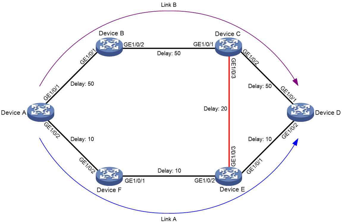

As shown in Figure 8, when no flexible algorithm is configured, all nodes calculate optimal paths based on the cost assigned to the links.
Figure 8 Topology without flexible algorithm 130
For comparison, you can configure flexible algorithm 130 for all nodes except Router F. The FAD of flexible algorithm 130 is as follows:
·     Calculation type—SPF algorithm.
·     Metric type—IS-IS link cost.
·     Constraint—Exclude affinity attribute red.
In the new topology shown in Figure 9, all nodes calculate optimal paths based on the calculation type and metric type in the FAD.
Figure 9 Topology with flexible algorithm 130

Mapping an affinity attribute name to an affinity bit
IS-IS supports a maximum of 256 affinity bits. They are numbered from 0 to 255. You can perform this task to map different affinity attribute names to these bits. As shown in Figure 10, affinity attribute name blue is mapped to bit 1, and red to bit 5.
This feature enables you to configure affinity attributes for links or define the flexible algorithm topology by specifying only the affinity attribute names.
Figure 10 Mapping an affinity attribute name to an affinity bit

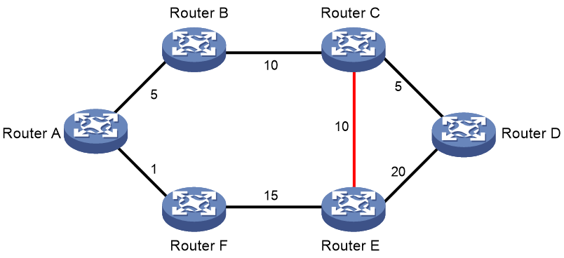

As shown in Figure 13, Router B is the source node and Router A is the destination node.
The number on each link represents the link cost. A data flow traverses from Router B to Router A. To avoid traffic loss against Router B failure, TI-LFA FRR calculates the backup path: Router B > Router C > Router E > Router F > Router A.

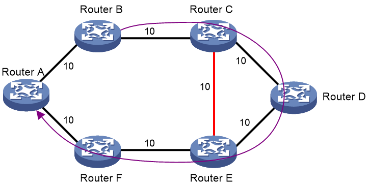

Figure 13 TI-LFA FRR backup path calculation without a flexible algorithm

In this case, the backup path calculated by TI-LFA FRR is Router B > Router C > Router D > Router E > Router F > Router A.
Figure 14 TI-LFA FRR backup path calculation with a flexible algorithm
FRR microloop avoidance for a flexible algorithm
When a link or node fails, TI-LFA FRR switches the traffic to the backup path to ensure continuous data forwarding. During the route convergence process, microloops might occur and cause packet loss and disorder if the route convergence on each device is not simultaneous.

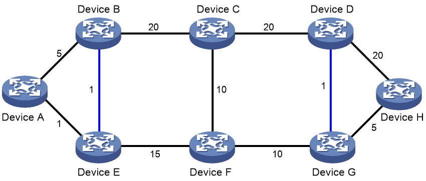

As shown in Figure 15, flexible algorithm 128 is configured for all nodes on the network and TI-LFA is enabled for that flexible algorithm. The FAD of flexible algorithm 128 is as follows:
·     Metric type—IS-IS link cost. The link cost of each link in Figure 15 is 10.
If no node failures occur, Device A forwards traffic to Device C along the path: Device A > Device B > Device C. If Device B fails, traffic to Device C will be switched to the backup path calculated by TI-LFA. After Device A finishes route convergence, traffic to Device C will be forwarded along the post-convergence path. If Device D has not finished route convergence and still forward traffic along the pre-convergence path, a loop is formed between Device A and Device D. The loop exists until Device D finishes route convergence.
Figure 15 TI-LFA FRR microloop avoidance after a node failed
FRR microloop avoidance can resolve this issue. After you enable this feature for Device A, Device A first switches traffic to the backup path calculated by TI-LFA when Device B fails. Device A does not start route convergence unless Device D and Device F finish route convergence. After Device A also finishes route convergence, Device A switches the traffic to the post-convergence route.

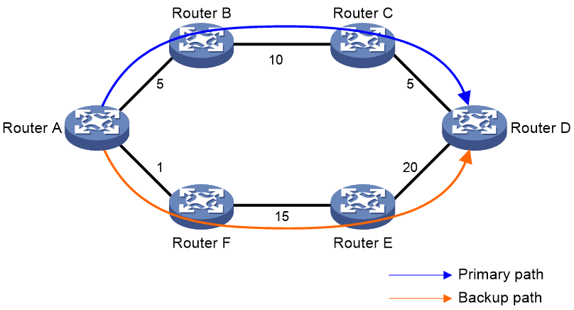

As shown in Figure 16, flexible algorithm 128 is configured for all nodes on the network. The FAD of flexible algorithm 128 is as follows:
·     Constraint—Exclude affinity attribute blue.
Traffic forwarding path Device A->Device E->Device F->Device G->Device H has three backup paths. You can set the priority of each backup path selection policy as follows to control backup path selection:
·     To select path Device A->Device E->Device F->Device C->Device D ->Device H that involves Device E, set a higher priority for the node-protection policy than the lowest-cost policy.
·     To select path Device A->Device B->Device C->Device F->Device G ->Device H that has the lowest cost, set a higher priority for the lowest-cost policy than the node-protection policy.
Figure 16 IS-IS FRR backup path selection

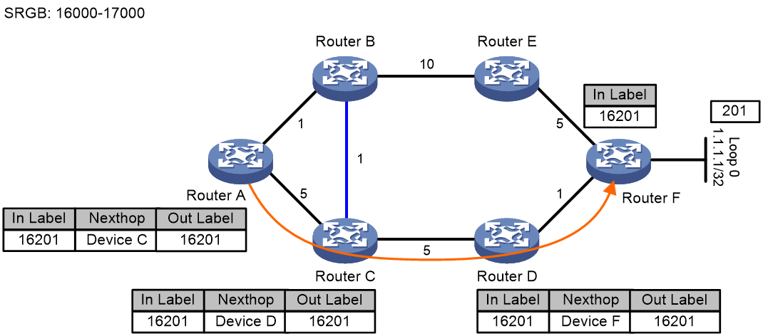

Applying a flexible algorithm to SR-MPLS
IS-IS advertises a prefix SID together with the algorithm ID associated to that prefix SID. By default, the algorithm ID associated to a prefix SID is 0. In this case, IS-IS uses the SPF algorithm and IS-IS link cost to calculate the optimal path to the prefix of that prefix SID.
After you associate a prefix SID to a flexible algorithm, IS-IS uses the flexible algorithm to calculate the optimal path to the prefix of that prefix SID. For example, you can associate the prefix SID configure on the loopback interface of Router F to flexible algorithm 130. The FAD of flexible algorithm 130 is as follows:
SID index value 201 is assigned to loopback address 1.1.1.1/32 on Router F. The incoming label calculated by Router F is 16201. After using flexible algorithm 130 to calculate the optimal path to 1.1.1.1/32, Router A creates a label forwarding entry. The incoming label is 16201, the outgoing label is 16201, and the next hop is Router C. Figure 17 shows the established SRLSP from Router A to Router F.
Figure 17 SRLSP from Router A to Router F with flexible algorithm 130

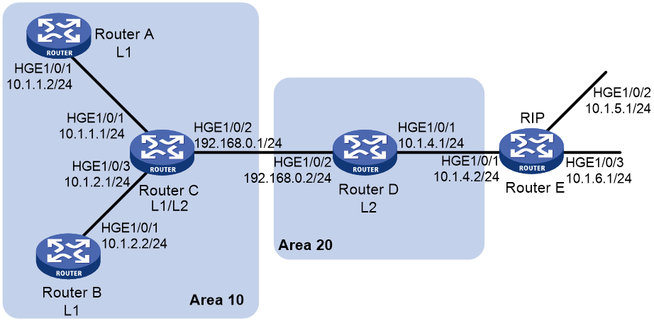

Configuring the administrative tag value for an interface
This task simplifies route management by allowing IS-IS to control IP address prefixes with the administrative tag.
As shown in Figure 19, Device A needs to communicate with Device B, Device C, and Device D. For security purposes, other devices in areas 2, 3, and 5 should not receive the packets sent by Device A. To resolve this issue, perform the following task:
1.     Configure the same administrative tag value for the IS-IS interfaces on Device B, Device C, and Device D.
2.     Configure route leaking from Level-2 to Level-1 on the Level-1-2 device in Area 4 and specify the same tag value as the route filter.
As shown in Figure 20, the IS-IS network topology on Device A is updated after you perform the above task.
Figure 19 IS-IS network diagram without the administrative tag
Figure 20 IS-IS network diagram with the administrative tag

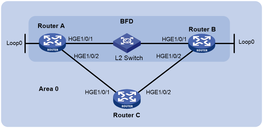

Enabling BFD control packet mode for IS-IS PIC
2.     Enter interface view.
3.     Enable BFD control packet mode for IS-IS PIC.
isis primary-path-detect bfd ctrl
By default, BFD control packet mode is disabled for IS-IS PIC.
To use BFD (control packet mode) to detect primary link failures, you must enable BFD control packet mode on both ends of the link.
Enabling BFD echo packet mode for IS-IS PIC
2.     (Optional.) Configure the source IP address of BFD echo packets.
bfd echo-source-ip ip-address
By default, the source IP address of BFD echo packets is not configured.
To avoid network congestion caused by a large number of ICMP redirect packets from neighbors, use this command. The source IP address cannot be on the same network segment as any local interface's IP address.
For more information, see High Availability Command Reference.
3.     Enter interface view.
4.     Enable BFD echo packet mode for IS-IS PIC.
isis primary-path-detect bfd echo
By default, BFD echo packet mode is disabled for IS-IS PIC.
To use BFD (echo packet mode) to detect primary link failures, you only need to enable BFD echo packet mode on one end of the link.

A link or router failure on a path can cause packet loss. IS-IS LFA FRR enables fast rerouting to minimize the failover time.
Figure 24 Network diagram for IS-IS LFA FRR
In Figure 24, after you enable LFA FRR on Router B, IS-IS automatically calculates or designates a backup next hop when a link failure is detected. In this way, packets are directed to the backup next hop to reduce traffic recovery time. Meanwhile, IS-IS calculates the shortest path based on the new network topology, and forwards packets over the path after network convergence.
When a primary link failure occurs, BFD can detect and report the link failure to IS-IS for a primary-backup path switchover. This can shorten the duration of service interruption.

As shown in Figure 25, the traffic forwarding path is PE 1—P 1—P 2—PE 2. To avoid traffic loss caused by link failures between P 1 and P 2, the system establishes an LDP tunnel between P 1 and P 4, which is the PQ node. When the link between P 1 and P 2 fails, P 1 encapsulates IP packets in MPLS packets and sends the MPLS packets to P 4 through the LDP tunnel. After receiving the MPLS packets, P 4 removes the MPLS labels of the packets and then forwards the packets to the next hop based on the IP routing table.
The system determines P 4 as the PQ node as follows:
1.     Uses P 1 (source node of the protected link) and its neighbors except P 2 (which passes the protected link) as the roots to establish shortest path trees.
2.     Finds out all nodes that are reachable from P 1 or one of its neighbors without passing the protected link, which are PE 1, P 1, P 3, and P 4.
These nodes form the extended P space.
3.     Uses P 2 (destination node of the protected link) as the root to establish a reverse shortest path tree.
4.     Finds out all nodes that are reachable from P 2 without passing the protected link, which are PE 2 and P 4.
These nodes form the Q space.
5.     Finds out all nodes that reside in both the extended P space and the Q space.
Only P 4 resides in both the extended P space and the Q space, so P 4 is the PQ node of the protected link.
Figure 25 Network diagram for IS-IS remote LFA FRR

Setting the priority for FRR backup path selection policies
IS-IS FRR uses specific policies for backup path calculation. The fast-reroute tiebreaker command defines the priority for the backup path selection policy. The higher the value, the higher the priority of the associated backup path selection policy. Changing the backup path selection policy priority can affect the backup path calculation result for IS-IS FRR. The backup paths can provide node protection or link protection for traffic, or provide both node protection and link protection.
IS-IS FRR supports the following backup path selection policies that are used to generate different topologies for backup path calculation:
·     Node protection—IS-IS FRR performs backup path calculation after excluding the primary next hop node.
·     Lowest cost—IS-IS FRR performs backup path calculation after excluding the direct primary link.
·     SRLG disjoint—When one link in the SRLG fails, the other links in the SRLG might also fail. If you use a link in this SRLG as the backup link for the faulty link, protection does not take effect. To avoid this issue, IS-IS FRR excludes the local links in the same SRLG as the direct primary link and then performs backup path calculation.
For IS-IS FRR, the SRLG disjoint policy depends on the node protection and lowest cost policies.
If multiple backup path selection policies exist in an IS-IS process, the policy with the highest priority is used to calculate the backup path. If the policy fails to calculate the backup path, another policy with higher priority is used. IS-IS performs backup path calculation by using the node protection and lowest cost policies as follows:
·     If the node protection policy has higher priority and fails to calculate the backup path, IS-IS uses the lowest cost policy to calculate the backup path. If the lowest cost policy still fails to calculate the backup path, reliability cannot be ensured upon primary link failure.
·     If the lowest cost policy has higher priority and fails to calculate the backup path, IS-IS does not perform further backup path calculation with the node protection policy. Reliability cannot be ensured upon primary link failure.
Table 4 shows the backup path selection mechanism for IS-IS FRR based on priorities of backup path selection policies.
Table 4 Backup path selection mechanism for IS-IS FRR
Priorities of link selection policies
Node protection > lowest cost > SRLG-disjoint
IS-IS FRR performs calculations based on the node protection and lowest cost policies in descending order of priority.
IS-IS FRR performs a maximum of two calculations. If IS-IS FRR obtains a backup path with a link selection policy, it does not perform further calculation.
Node protection > SRLG-disjoint > lowest cost
IS-IS FRR performs calculations based on the node protection, node protection + SRLG-disjoint, lowest cost + SRLG-disjoint, and lowest cost policies in descending order of priority.
IS-IS FRR performs a maximum of four calculations. If IS-IS FRR obtains a backup path with a link selection policy, it does not perform further calculation.
SRLG-disjoint > node protection > lowest cost
IS-IS FRR performs calculations based on the node protection + SRLG-disjoint, lowest cost + SRLG-disjoint, node protection, and lowest cost policies in descending order of priority.
Lowest cost > node protection > SRLG-disjoint
IS-IS FRR performs calculations based on the lowest cost policy.
IS-IS FRR performs only one calculation.
Lowest cost > SRLG-disjoint > node protection
SRLG-disjoint > lowest cost > node protection
IS-IS FRR performs calculations based on the node protection + SRLG-disjoint, lowest cost + SRLG-disjoint, and lowest cost policies in descending order of priority.
IS-IS FRR performs a maximum of three calculations. If IS-IS FRR obtains a backup path with a link selection policy, it does not perform further calculation.
If the node-protection policy has a higher priority but the backup path calculation fails, IS-IS uses the lowest-cost policy for further calculation. If the backup path calculation still fails, IS-IS does not perform further backup path calculation.
If the lowest-cost policy has a higher priority but the backup path calculation fails, IS-IS does not perform further backup path calculation.

IS-IS configuration examples
Example: Configuring basic IS-IS
As shown in Figure 26, Router A, Router B, Router C, and Router D reside in an AS.
Router A and Router B are Level-1 routers, Router D is a Level-2 router, and Router C is a Level-1-2 router connecting two areas. Router A, Router B, and Router C are in area 10, and Router D is in area 20.
Figure 26 Network diagram
1.     Configure IP addresses for interfaces. (Details not shown.)
2.     Configure IS-IS:
# Configure Router A
<RouterA> system-view
[RouterA] isis 1
[RouterA-isis-1] is-level level-1
[RouterA-isis-1] network-entity 10.0000.0000.0001.00
[RouterA-isis-1] quit
[RouterA] interface hundredgige 1/0/1
[RouterA-HundredGigE1/0/1] isis enable 1
[RouterA-HundredGigE1/0/1] quit
# Configure Router B.
<RouterB> system-view
[RouterB] isis 1
[RouterB-isis-1] is-level level-1
[RouterB-isis-1] network-entity 10.0000.0000.0002.00
[RouterB-isis-1] quit
[RouterB] interface hundredgige 1/0/1
[RouterB-HundredGigE1/0/1] isis enable 1
[RouterB-HundredGigE1/0/1] quit
# Configure Router C.
<RouterC> system-view
[RouterC] isis 1
[RouterC-isis-1] network-entity 10.0000.0000.0003.00
[RouterC-isis-1] quit
[RouterC] interface hundredgige 1/0/3
[RouterC-HundredGigE1/0/3] isis enable 1
[RouterC-HundredGigE1/0/3] quit
[RouterC] interface hundredgige 1/0/1
[RouterC-HundredGigE1/0/1] isis enable 1
[RouterC-HundredGigE1/0/1] quit
[RouterC] interface hundredgige 1/0/2
[RouterC-HundredGigE1/0/2] isis enable 1
[RouterC-HundredGigE1/0/2] quit
# Configure Router D
<RouterD> system-view
[RouterD] isis 1
[RouterD-isis-1] is-level level-2
[RouterD-isis-1] network-entity 20.0000.0000.0004.00
[RouterD-isis-1] quit
[RouterD] interface hundredgige 1/0/1
[RouterD-HundredGigE1/0/1] isis enable 1
[RouterD-HundredGigE1/0/1] quit
[RouterD] interface hundredgige 1/0/2
[RouterD-HundredGigE1/0/2] isis enable 1
[RouterD-HundredGigE1/0/2] quit

# Display IS-IS routing information on each router.
[RouterA] display isis route
                         Route information for IS-IS(1)
                         Level-1 IPv4 Forwarding Table
 IPv4 Destination     IntCost    ExtCost ExitInterface   NextHop         Flags
 10.1.1.0/24          10         NULL    HGE1/0/1        Direct          D/L/-
 10.1.2.0/24          20         NULL    HGE1/0/1        10.1.1.1        R/-/-
 192.168.0.0/24       20         NULL    HGE1/0/1        10.1.1.1        R/-/-
 0.0.0.0/0            10         NULL    HGE1/0/1        10.1.1.1        R/-/-
      Flags: D-Direct, R-Added to Rib, L-Advertised in LSPs, U-Up/Down Bit Set
[RouterC] display isis route
 10.1.2.0/24          10         NULL    HGE1/0/3        Direct          D/L/-
 192.168.0.0/24       10         NULL    HGE1/0/2        Direct          D/L/-
                         Level-2 IPv4 Forwarding Table
 10.1.1.0/24          10         NULL                                    D/L/-
 10.1.2.0/24          10         NULL                                    D/L/-
 10.1.4.0/24          10         NULL                                    D/L/-
 192.168.0.0/24       10         NULL                                    D/L/-
[RouterD] display isis route
 10.1.1.0/24          20         NULL    HGE1/0/2        192.168.0.1     R/-/-
 10.1.2.0/24          20         NULL    HGE1/0/2        192.168.0.1     R/-/-
 10.1.4.0/24          10         NULL    HGE1/0/1        Direct          D/L/-
3.     Configure RIPv2 on Router D and Router E, and configure IS-IS to redistribute RIP routes on Router D:
# Configure RIPv2 on Router D.
[RouterD] rip 1
[RouterD-rip-1] network 10.0.0.0
[RouterD-rip-1] version 2
[RouterD-rip-1] undo summary
# Configure RIPv2 on Router E.
[RouterE] rip 1
[RouterE-rip-1] network 10.0.0.0
[RouterE-rip-1] version 2
[RouterE-rip-1] undo summary
# On Router D, configure IS-IS to redistribute routes from RIP.
[RouterD-rip-1] quit
[RouterD] isis 1
[RouterD–isis-1] address-family ipv4
[RouterD–isis-1-ipv4] import-route rip level-2
# Display IS-IS routing information on Router C.
 10.1.4.0/24          20         NULL    HGE1/0/2        192.168.0.2     R/L/-
 10.1.5.0/24          10         0       HGE1/0/2        192.168.0.2     R/L/-
 10.1.6.0/24          10         0       HGE1/0/2        192.168.0.2     R/L/-
Example: Configuring IS-IS authentication
As shown in Figure 29, Router A, Router B, Router C, and Router D reside in the same IS-IS routing domain.
Router A, Router B, and Router C belong to Area 10, and Router D belongs to Area 20.
·     Configure neighbor relationship authentication between neighbors.
·     Configure area authentication in Area 10 to prevent untrusted routes from entering into the area.
·     Configure routing domain authentication on Router C and Router D to prevent untrusted routes from entering the routing domain.
Figure 29 Network diagram
2.     Configure basic IS-IS:
# Configure Router A.
[RouterA] isis 1
[RouterB] isis 1
[RouterC] isis 1
# Configure Router D.
[RouterD] isis 1
[RouterD-isis-1] network-entity 20.0000.0000.0001.00
3.     Configure neighbor relationship authentication between neighbors:
# Set the authentication mode to MD5 and set the plaintext key to eRq on HundredGigE 1/0/1 of Router A and on HundredGigE 1/0/3 of Router C.
[RouterA-HundredGigE1/0/1] isis authentication-mode md5 plain eRg
[RouterC-HundredGigE1/0/3] isis authentication-mode md5 plain eRg
# Set the authentication mode to MD5 and set the plaintext key to t5Hr on HundredGigE 1/0/1 of Router B and on HundredGigE 1/0/1 of Router C.
[RouterB-HundredGigE1/0/1] isis authentication-mode md5 plain t5Hr
[RouterC-HundredGigE1/0/1] isis authentication-mode md5 plain t5Hr
# Set the authentication mode to MD5 and set the plaintext key to hSec on HundredGigE 1/0/1 of Router D and on HundredGigE 1/0/2 of Router C.
[RouterC-HundredGigE1/0/2] isis authentication-mode md5 plain hSec
[RouterD-HundredGigE1/0/1] isis authentication-mode md5 plain hSec
4.     Set the area authentication mode to MD5 and set the plaintext key to 10Sec on Router A, Router B, and Router C.
[RouterA] isis 1
[RouterA-isis-1] area-authentication-mode md5 plain 10Sec
[RouterB] isis 1
[RouterB-isis-1] area-authentication-mode md5 plain 10Sec
[RouterC] isis 1
[RouterC-isis-1] area-authentication-mode md5 plain 10Sec
5.     Set routing domain authentication mode to MD5 and set the plaintext key to 1020Sec on Router C and Router D.
[RouterC] isis 1
[RouterC-isis-1] domain-authentication-mode md5 plain 1020Sec
[RouterD] isis 1
[RouterD-isis-1] domain-authentication-mode md5 plain 1020Sec

Example: Configuring BFD for IS-IS
·     As shown in Figure 32, run IS-IS on Router A, Router B and Router C so that they can reach each other at the network layer.
·     After the link over which Router A and Router B communicate through the Layer 2 switch fails, BFD can quickly detect the failure and notify IS-IS of the failure. Router A and Router B then communicate through Router C.
Figure 32 Network diagram
Table 5 Interface and IP address assignment
Device
Interface
IP address
Device
Interface
IP address
Router A
HGE1/0/1
192.168.0.102/24
Router B
HGE1/0/1
192.168.0.100/24
HGE1/0/2
10.1.1.102/24
HGE1/0/2
13.1.1.1/24
Loop0
121.1.1.1/32
Loop0
120.1.1.1/32
Router C
HGE1/0/1
10.1.1.100/24
HGE1/0/2
13.1.1.2/24
[RouterA] isis
[RouterA] interface loopback 0
[RouterA-LoopBack0] isis enable
[RouterA-LoopBack0] quit
[RouterA] interface hundredgige 1/0/2
[RouterA-HundredGigE1/0/2] isis enable
[RouterA-HundredGigE1/0/2] quit
[RouterB] isis
[RouterB] interface loopback 0
[RouterB-LoopBack0] isis enable
[RouterB-LoopBack0] quit
[RouterB] interface hundredgige 1/0/2
[RouterB-HundredGigE1/0/2] isis enable
[RouterB-HundredGigE1/0/2] quit
[RouterC] isis
3.     Configure BFD functions:
# Enable BFD and configure BFD parameters on Router A.
[RouterA] bfd session init-mode active
[RouterA-HundredGigE1/0/1] isis bfd enable
[RouterA-HundredGigE1/0/1] bfd min-receive-interval 500
[RouterA-HundredGigE1/0/1] bfd min-transmit-interval 500
[RouterA-HundredGigE1/0/1] bfd detect-multiplier 7
# Enable BFD and configure BFD parameters on Router B.
[RouterB] bfd session init-mode active
[RouterB-HundredGigE1/0/1] isis bfd enable
[RouterB-HundredGigE1/0/1] bfd min-receive-interval 500
[RouterB-HundredGigE1/0/1] bfd min-transmit-interval 500
[RouterB-HundredGigE1/0/1] bfd detect-multiplier 8
# Display the BFD session information on Router A.
<RouterA> display bfd session
 Total sessions: 1     Up sessions: 1     Init mode: Active
 IPv4 session working in control mode:
LD/RD           SourceAddr      DestAddr        State  Running Up for Holdtime
   Interface
 3/1             192.168.0.102   192.168.0.100   Up     00:00:20       1700ms
   HGE1/0/1
# Display routes destined for 120.1.1.1/32 on Router A.
<RouterA> display ip routing-table 120.1.1.1 verbose
Summary count : 1
Destination: 120.1.1.1/32
    Protocol: IS_L1
  Process ID: 1
   SubProtID: 0x1                        Age: 04h20m37s
        Cost: 10                  Preference: 10
       IpPre: N/A                 QosLocalID: N/A
         Tag: 0                        State: Active Adv
   OrigTblID: 0x0                    OrigVrf: default-vrf
     TableID: 0x2                     OrigAs: 0
       NibID: 0x26000002              LastAs: 0
      AttrID: 0xffffffff            Neighbor: 0.0.0.0
       Flags: 0x1008c            OrigNextHop: 192.168.0.100
       Label: NULL               RealNextHop: 192.168.0.100
     BkLabel: NULL                 BkNextHop: N/A
     SRLabel: NULL                 Interface: HundredGigE1/0/1
   BkSRLabel: NULL              BkInterface: N/A
   Tunnel ID: Invalid           IPInterface: HundredGigE1/0/1
 BkTunnel ID: Invalid         BkIPInterface: N/A
     InLabel: NULL           ColorInterface: N/A
    SIDIndex: NULL         BkColorInterface: N/A
    FtnIndex: 0x0           TunnelInterface: N/A
TrafficIndex: N/A         BkTunnelInterface: N/A
   Connector: N/A                    PathID: 0x0
  SRTunnelID: Invalid
    SID Type: N/A                       NID: Invalid
    FlushNID: Invalid                 BkNID: Invalid
  BkFlushNID: Invalid             StatFlags: 0x0
         Exp: N/A
   VpnPeerId: N/A                      Dscp: N/A
         SID: N/A                OrigLinkID: 0x0
       BkSID: N/A                RealLinkID: 0x0
CommBlockLen: 0
The output shows that Router A and Router B communicate through Ethernet 1/1. Then the link over Ethernet 1/1 fails.
Summary count : 1
    Protocol: IS_L1
  Process ID: 1
        Cost: 20                  Preference: 10
       Flags: 0x1008c            OrigNextHop: 10.1.1.100
       Label: NULL               RealNextHop: 10.1.1.100
     SRLabel: NULL                 Interface: HundredGigE1/0/2
    Tunnel ID: Invalid           IPInterface: HundredGigE1/0/2
   SRTunnelID: Invalid
          Exp: N/A
The output shows that Router A and Router B communicate through Ethernet 1/2.

Example: Configuring IS-IS remote LFA FRR
As shown in Figure 33, Router A, Router B, Router C, and Router D reside in the same IS-IS routing domain.
·     Run IS-IS on all the routers to interconnect them with each other.
·     Configure MPLS LDP on all the routers.
·     Configure IS-IS remote LFA FRR so that when Link A fails, traffic can be switched to Link B immediately.
Figure 34 Network diagram

Example: Configuring IS-IS multi-instance processes
As shown in Figure 35, the IPv4 and IPv6 costs are different on an interface. Configure IS-IS multi-instance processes to isolate the IPv4 and IPv6 network and avoid IPv6 route calculation errors.
Figure 35 Network diagram
Table 8 Interface and IP address assignment
Device
Interface
IPv4 address
IPv6 address
Router A
HGE1/0/1
10.1.1.1/24
2001::1/64
Loop0
1.1.1.1/32
10::1/128
Router B
HGE1/0/1
10.1.1.2/24
2001::2/64
Loop0
2.2.2.2/32
20::1/128
Configure IPv4 and IPv6 addresses for the interfaces. (Details not shown.)
