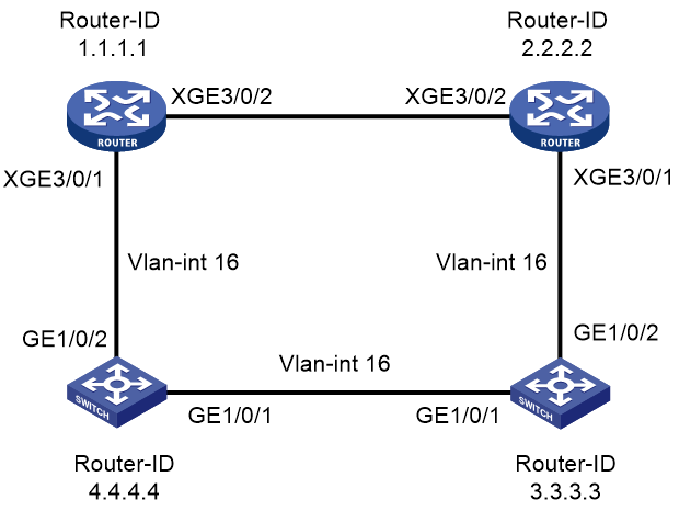

OSPFv3 neighbor relationship establishment failure with a Huawei switch on P2P network
Symptom
A CR16000-M device and a Huawei switch fail to establish an OSPFv3 neighbor relationship on a P2P network. The neighbor state remains Init. The network diagram is as shown in Figure 1.
Figure 1 Network diagram
Troubleshooting procedure
1.     Execute the display ospfv3 peer command on the device whose router ID is 1.1.1.1 to view its neighbor information. The output shows that the device has established a neighbor relationship with another device whose router ID is 2.2.2.2, but the neighbor state remains Init.
<Sysname> display ospfv3 peer
 OSPFv3 Process 1 with Router ID 1.1.1.1
 Area: 0.0.0.0
 Router ID       Pri State             Dead-Time InstID Interface
 2.2.2.2         1   Init/ -           00:00:32  0      Vlan16
2.     Execute the display ospfv3 peer command on the device whose router ID is 2.2.2.2 to view its neighbor information. The output shows that the device has established a neighbor relationship with the device whose router ID is 3.3.3.3, and the neighbor state is Full.
 OSPFv3 Process 1 with Router ID 2.2.2.2
 Area: 0.0.0.0
 3.3.3.3         1   Full/ -           00:00:32  0      Vlan16
3.     Capture packets on device 2.2.2.2. The packet capture results show that the device receives Hello packets sent by the other three devices. Packet capture results on the other three devices show that only device 3.3.3.3 receives Hello packets from device 2.2.2.2. This issue prevents device 1.1.1.1 from establishing a neighbor relationship with device 2.2.2.2.
4.     To resolve this issue, assign the interfaces connecting the CR16000-M device and the related Huawei switch to a VLAN different from the VLAN to which the interfaces connecting the Huawei switches belong.
Root cause
Layer 2 interfaces connecting the Huawei switches and the Layer 2 interfaces connecting the CR16000-M device and the related Huawei switch all belong to VLAN 16. As a result, all devices within the same broadcast domain. Since the network type for OSPFv3 is P2P, the establishment of OSPFv3 neighbor relationship depends on the order of receiving Hello packets.
As shown in Figure 1, device 1.1.1.1 attempts to establish a neighbor relationship with device 2.2.2.2. However, device 2.2.2.2 has already established a neighbor relationship with device 3.3.3.3. Consequently, device 1.1.1.1 cannot receive Hello packets from device 2.2.2.2, leaving the neighbor state as Init.
Solution
Divide the broadcast domain by assigning the interfaces connecting the CR16000-M device and a Huawei switch to a VLAN different from the VLAN to which the interfaces connecting the Huawei switches belong. Start an OSPFv3 process on the VLAN interfaces respectively. The CR16000-M device can then establish a neighbor relationship with the related Huawei switch.

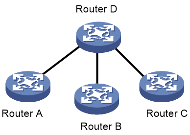

BGP peer flapping
Symptom
As shown in Figure 2, Router A is a route reflector. It establishes a BGP session with Router C via Router B. Both Router A and Router C are CR16000-M devices. Router B is a third-party device. During device deployment, the BGP peer session between Router A and Router C flaps repeatedly.
Figure 2 Network diagram
1.     Verify that all peer sessions of Router A are normal except for the peer session between Router A and Router C. This session is repeatedly re-established.
2.     View the logfile. It prompts a session holdtime timeout error and the BGP state is changed from Established to Idle. After the BGP session is re-established, the BGP state transitions from OpenConfirm to Established. The BGP session is repeatedly terminated and re-established.
%Feb  4 12:24:47:654 2022 MPLS-RouterA-B-YueQ-10F-A02-PE BGP/5/BGP_STATE_CHANGED: BGP default.: 172.25.128.210 state has changed from ESTABLISHED to IDLE for a notification received: Hold Timer Expired/ErrSubCode Unspecified.
%Feb  4 12:24:49:819 2022 MPLS-RouterA-B-YueQ-10F-A02-PE BGP/5/BGP_STATE_CHANGED: BGP default.: 172.25.128.210 State is changed from OPENCONFIRM to ESTABLISHED.
3.     Execute the ping command on Router A and Router C. They can access each other. The possible cause for this issue might be that Router B discards BGP messages. You can collect BGP debug information from Router A and Router C.
a.     View BGP debug information on Router A. Router A transmits and receives keepalive messages.
*Feb 17 15:19:14:500 2022 MPLS-RouterA-B-YueQ-10F-A02-PE BGP/7/DEBUG: -MDC=1;
        BGP.: 172.25.128.210 Send KEEPALIVE
        Length: 19
 %Feb 17 15:19:57:037 2022 MPLS-RouterA-B-YueQ-10F-A02-PE SSHS/5/SSHS_ACL_DENY: -MDC=1; The SSH Connection 61.240.202.41(ZJWS_INTERNET) request was denied according to ACL rules.
*Feb 17 15:20:08:829 2022 MPLS-RouterA-B-YueQ-10F-A02-PE BGP/7/DEBUG: -MDC=1;
        BGP.: 172.25.128.210 Recv KEEPALIVE
        Length: 19
*Feb 17 15:20:10:500 2022 MPLS-RouterA-B-YueQ-10F-A02-PE BGP/7/DEBUG: -MDC=1;
 BGP_TIMER.: 172.25.128.210 KA Timer Expired.
        Length: 19
b.     View BGP debug information on Router C. Router C transmits keepalive messages, but does not receive keepalive messages.
Feb 17 15:20:07:314 2022 MPLS-RouterC-B-SD-1F-1-E10-RR BGP/7/DEBUG: -MDC=1;
        BGP.: 172.25.128.174 Send KEEPALIVE
        Length: 19
 *Feb 17 15:21:01:314 2022 MPLS-RouterC-B-SD-1F-1-E10-RR BGP/7/DEBUG: -MDC=1;
 BGP_TIMER.: 172.25.128.174 KA Timer Expired.
        Length: 19
*Feb 17 15:21:18:314 2022 MPLS-RouterC-B-SD-1F-1-E10-RR BGP/7/DEBUG: -MDC=1;
 BGP_TIMER.: 172.25.128.174 HD Timer Expired.
 BGP_TIMER.: 172.25.128.174 Restart Timer Created.
*Feb 17 15:21:18:315 2022 MPLS-RouterC-B-SD-1F-1-E10-RR BGP/7/DEBUG: -MDC=1;
 BGP_TIMER.: 172.25.128.174 KA Timer Deleted.
 BGP_TIMER.: 172.25.128.174 HD Timer Deleted.
%Feb 17 15:21:18:315 2022 MPLS-RouterC-B-SD-1F-1-E10-RR BGP/5/BGP_STATE_CHANGED: -MDC=1;
 BGP default.: 172.25.128.174 state has changed from ESTABLISHED to IDLE for hold timer expiration caused by peer device.
4.     Further inspect the on-site settings. The default MTU for the interface was modified.
interface Route-Aggregation11
description To_SD_E10_ASR9k_BE11
mtu 1586
ip address 172.25.140.202 255.255.255.252
isis enable 100
isis circuit-type p2p
link-aggregation mode dynamic
mpls enable
5.     View the BGP log. The BGP session is terminated every 18 seconds. This issue might be caused by packet fragmentation.
6.     Use the ping command on Router A to ping Router C. Specify different ICMP echo request lengths (1472, 1500, 1558, and 1559 bytes) and disable Router A from fragmenting these ICMP echo requests. Router A cannot ping Router C if the specified ICMP echo request length is 1558 or 1559 bytes. It is found that Router B's MTU is 1586 bytes. Therefore, messages exceeding 1586 bytes will be discarded by Router B.
<RouterA> ping -f -s 1472 172.25.128.174 172.25.128.210
<RouterA> ping -f -s 1500 172.25.128.174 172.25.128.210
<RouterA> ping -f -s 1558 172.25.128.174 172.25.128.210
<RouterA> ping -f -s 1559 172.25.128.174 172.25.128.210
7.     To avoid packet discarding by Router B, set a smaller TCP MSS or MTU. This operation makes TCP packet fragments smaller. As a best practice, set the TCP MSS to 1400. TCP MSS adjustment is required at only one end, because the two ends use the minimum TCP MSS for communication.
Root cause
Keepalive and update messages are transmitted during BGP session establishment. Router B discards the update messages of Router A because they exceed the MTU of Router B. As a result, Router C can receive the keepalive messages of Router A, but not the update messages of Router A, which causes the related TCP packets to be discarded due to discontiguous TCP sequence numbers. Router C only transmits keepalive messages and does not receive keepalive messages. Since the update messages of Router C do not exceed the MTU of Router B, Router A can transmit and receive keepalive messages.
Solution
Adjust the TCP MSS or MTU value for the  local and remote devices, ensuring that their BGP TCP packet segments are smaller than the MTU of the intermediate device.

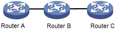

Inconsistent round-trip paths due to BGP and OSPF route selection
Symptom
On a typical three-level network, as shown in Figure 3, Router A and Router B operates as level-1 core PEs and Switch A as the level-1 core CE. Router C and Router D operates as level-2 core devices, and Router E and Router F operates as level-3 core devices. Switch B operates as the level-3 core CE and connects to a site whose IP address is 8.8.8.8.
Switch B connects to the level-3 PEs through primary and backup links.
·     The primary link is Router A <> Router C <> Router E. It passes routes to Router A via BGP and MPLS L3VPN. On Router A, BGP VPNv4 routes and OSPF routes are mutually redistributed. Finally, Router A passes the routes to Switch A via OSPF. Router A and Router E share the same OSPF domain ID, which is the default value of 0.
·     The backup link connects Router B <> Router D <> Router F. Router F redistributes the static routes from the access layer into OSPF, and then passes the routes to Switch A via OSPF.
On the network, two OSPF processes exist: OSPF 1 runs on Router A, Switch A, Router B, and Router D, and OSPF 2 runs on Router D and Router F. On Router D, the two OSPF processes redistribute routes into each other.
On this network, traffic passes through the primary link when it operates correctly, and switches to the backup link upon a fault in the primary link. After the primary link recovers, the traffic is steered back to the primary link. The current issue is that traffic is not steered back to the primary link after the primary link recovers.
Figure 3 Network diagram
The following output information is for illustration only.
1.     View the route destined for site 8.8.8.8 in VPN instance 1.
<RouterA> display ip routing-table vpn-instance 1 8.8.8.8
Summary count : 1
Destination/Mask   Proto   Pre Cost        NextHop         Interface
8.8.8.8/32         BGP     255 2           6.6.6.6         XGE3/0/1
The output shows that the route to 8.8.8.8 is learned from BGP. The next hop address is the loopback address of Router C and the preference is 255.
2.     View the LSDB information for OSPF 1 on Router A, and view the LSA corresponding to site 8.8.8.8.
<RouterA> display ospf 1 lsdb
              OSPF Process 1 with Router ID 10.0.0.2
                 Link State Database
                         Area: 0.0.0.0
 Type      LinkState ID    AdvRouter       Age  Len   Sequence  Metric
 Router    10.0.0.2        10.0.0.2        669  36    80000003  0
 Router    5.5.5.5         5.5.5.5         661  48    80000004  0
 Router    1.1.1.1         1.1.1.1         660  60    80000007  0
 Network   10.0.0.6        5.5.5.5         660  32    80000002  0
 Network   10.0.0.2        10.0.0.2        669  32    80000002  0
 Sum-Net   8.8.8.8         10.0.0.2        650  28    80000001  2
                 AS External Database
 External  10.0.0.0        5.5.5.5         642  36    80000001  1
 External  7.7.7.7         5.5.5.5         642  36    80000001  1
Route distinguisher: 1:6
 Total number of routes: 1
 Paths:   1 available, 1 best
 BGP routing table information of 8.8.8.8/32:
 From            : 6.6.6.6 (6.6.6.6)
 Rely nexthop    : 10.0.0.10
 Original nexthop: 6.6.6.6
 OutLabel        : 1279
 Ext-Community   : <OSPF Domain Id: 0.0.0.0:0>, <OSPF Router Id: 6.6.6.6:0:0>,
                   <OSPF AreaNum: 0.0.0.0 RouteType: 1 Option: 0>, <RT: 1:1>
 RxPathID        : 0x0
 TxPathID        : 0x0
 AS-path         : (null)
 Origin          : incomplete
 Attribute value : MED 2, localpref 100, pref-val 0
 State           : valid, internal, best
 IP precedence   : N/A
 QoS local ID    : N/A
 Traffic index   : N/A
Site 8.8.8.8 has an LSA of the Sum-Net type, which means it is a Network Summary LSA (Type-3). Router A and Router E share the same OSPF domain ID, 0. The OSPF domain ID carried by the BGP VPNv4 route for site 8.8.8.8 is 0. When Router A redistributes the BGP VPNv4 route into OSPF, it advertises the route to Switch A in a Network Summary LSA (Type-3 LSA), because Router A's primary domain ID matches the OSPF domain ID in the route.
Router B has two LSAs for site 8.8.8.8, a Type-3 LSA from Router A in OSPF 1 and a Type-5 LSA from Router F in OSPF 2. The Type-3 LSA has a higher preference than the Type-5 LSA. Consequently, when Router B's two OSPF processes import routes from each other, the Type-3 LSA from OSPF 2 is active instead of the Type-5 LSA from OSPF 1. Router B advertises the Type-3 LSA to the backup link, and traffic is forwarded based on the Type-3 LSA, passing through the primary link.
3.     On Router A, shut down and restore BGP peer sessions. Use the display ip routing-table command to display routes with destination address 8.8.8.8 in VPN instance 1.
<RouterA> display ip routing-table vpn 1 8.8.8.8
Summary count : 1
8.8.8.8/32         O_ASE2  150 1           10.0.0.1        XGE3/0/1
The output shows that the route for 8.8.8.8 is an OSPF route, not a BGP route. Router D redistributes this route as a Type-5 LSA, and traffic is forwarded via the backup link.
4.     On Router A, execute the display ip routing-table command to display BGP VPNv4 routes destined for 8.8.8.8.
<RouterA> display bgp routing-table vpnv4
 BGP local router ID is 2.2.2.2
 Status codes: * - valid, > - best, d - dampened, h - history
               s - suppressed, S - stale, i - internal, e - external
               a - additional-path
       Origin: i - IGP, e - EGP, ? - incomplete
 Total number of routes from all PEs: 1
 Route distinguisher: 1:2(1)
 Total number of routes: 6
     Network            NextHop         MED        LocPrf     PrefVal Path/Ogn
* >  1.1.1.1/32         10.0.0.1        2                     32768   ?
* >  5.5.5.5/32         10.0.0.1        3                     32768   ?
* >  7.7.7.7/32         10.0.0.1        2                     32768   ?
* >i 8.8.8.8/32         6.6.6.6         2          100        0       ?
* >  10.0.0.0/20        10.0.0.1        2                     32768   ?
* >  10.0.0.4/30        10.0.0.1        3                     32768   ?
The output shows that the BGP neighbor relationship has been successfully restored, but the traffic is not steered to the primary link.
5.     On Router A, configure a routing policy to set the preference to 130 for routes destined for 8.8.8.8.
a.     Create an IPv4 prefix list named p1 that only permits routes for 8.8.8.8/32 to pass.
<RouterA> system-view
[RouterA] ip prefix-list p1 permit 8.8.8.8 32
b.     Create a routing policy named policy1 with a node sequence number of 10 and the match mode of permit. If traffic matches IPv4 prefix list p1, the routing policy sets the route preference to 130.
[RouterA] route-policy policy1 permit node 10
[RouterA-route-policy-policy1-10] if-match ip address prefix-list p1
[RouterA-route-policy-policy1-10] apply preference 130
6.     View routes destined for site 8.8.8.8 on Router A.
Summary count : 1
8.8.8.8/32         BGP     130 2           6.6.6.6         XGE3/0/1
The output shows that the route for 8.8.8.8 has been restored to the BGP route, and traffic is forwarded through the primary link.
Root cause
If you configure the OSPF domain ID by using the domain-id command, the PE attaches the primary domain ID to the route as an extended community attribute when redistributing an OSPF route into BGP. The domain ID is passed to the remote PE. Upon receiving the BGP route, the remote PE compares the locally configured primary and secondary OSPF domain IDs with the OSPF domain ID carried in the route. If the primary or secondary domain ID matches the domain ID in the route and the route is an intra-area or inter-area route, the route is advertised to the CE as a Network Summary LSA (Type-3 LSA) when redistributed into OSPF. If the primary or secondary domain ID does not matches the domain ID in the route, it is advertised to the CE as either an AS External LSA (Type-5 LSA) or an NSSA External LSA (Type-7 LSA).
When the primary link operates correctly, two LSAs about site 8.8.8.8 exist on Router D, a Type-3 LSA from Router A in OSPF 1 and a Type-5 LSA from Router F in OSPF 2. The Type-3 LSA has a higher preference than the Type-5 LSA. As a result, when Router D's two OSPF processes import routes from each other, the Type-3 LSA introduced by OSPF 2 is active instead of the Type-5 LSA redistributed by OSPF 1. Router D advertises the Type-3 LSA to the backup link but not the Type-5 LSA to the primary link. Traffic is forwarded according to the Type-3 LSA, passing through the primary link.
When the BGP route fails, the Type-3 LSA is withdrawn. Router A learns the Type-5 LSA redistributed by Router D, directing traffic through the backup link. After the BGP route is restored, its default preference is 255. Since the OSPF route generated from the Type-5 LSA has a preference of 150, the OSPF route takes precedence over the BGP route, placing the BGP route in inactive state. As a result, traffic continues to pass through the backup link.
Solution
Configure a routing policy that modifies the preference for BGP routes destined for the site through, ensuring those BGP routes take precedence over OSPF routes. Traffic will be automatically switched from the backup link to the primary link when the BGP routes are restored.

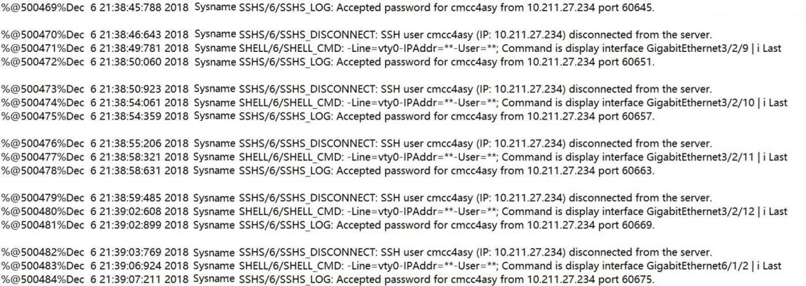

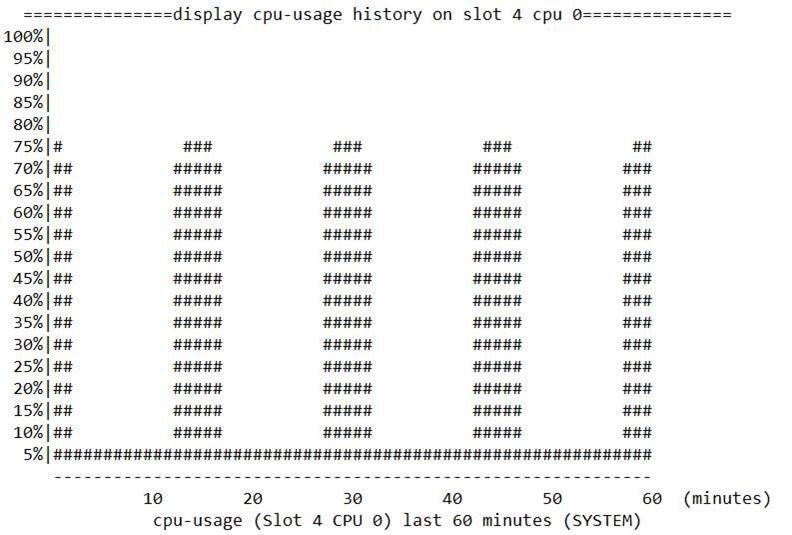

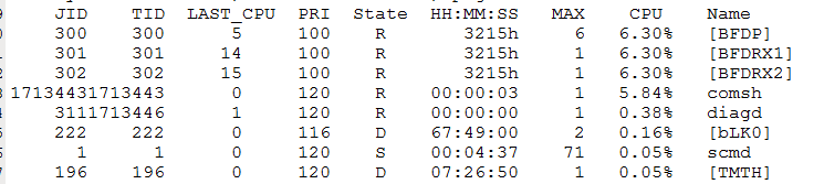

High CPU usage on the active MPU caused by frequent logins
Symptom
The CPU usage of the active MPU on multiple devices periodically rose to about 75%, as shown in the following figure:
1.     When the CPU usage increases, the process statistics show that the comsh process occupies a high CPU usage.
<Sysname>monitor thread dumbtty slot 4 cpu 0
2.     View log files. The information shows that many SSH users continuously log in periodically.
Root cause
An abnormal server attempts periodic logins to the device and executes a series of commands within a short period. When users repeatedly log in and out of the device and execute display commands in a short period, many temporary processes will be created, resulting in a sudden increase in CPU usage.
Solution
To resolve server login anomaly, the device performs CPU optimization based on SSH exceptions to prevent a sudden increase in CPU usage.

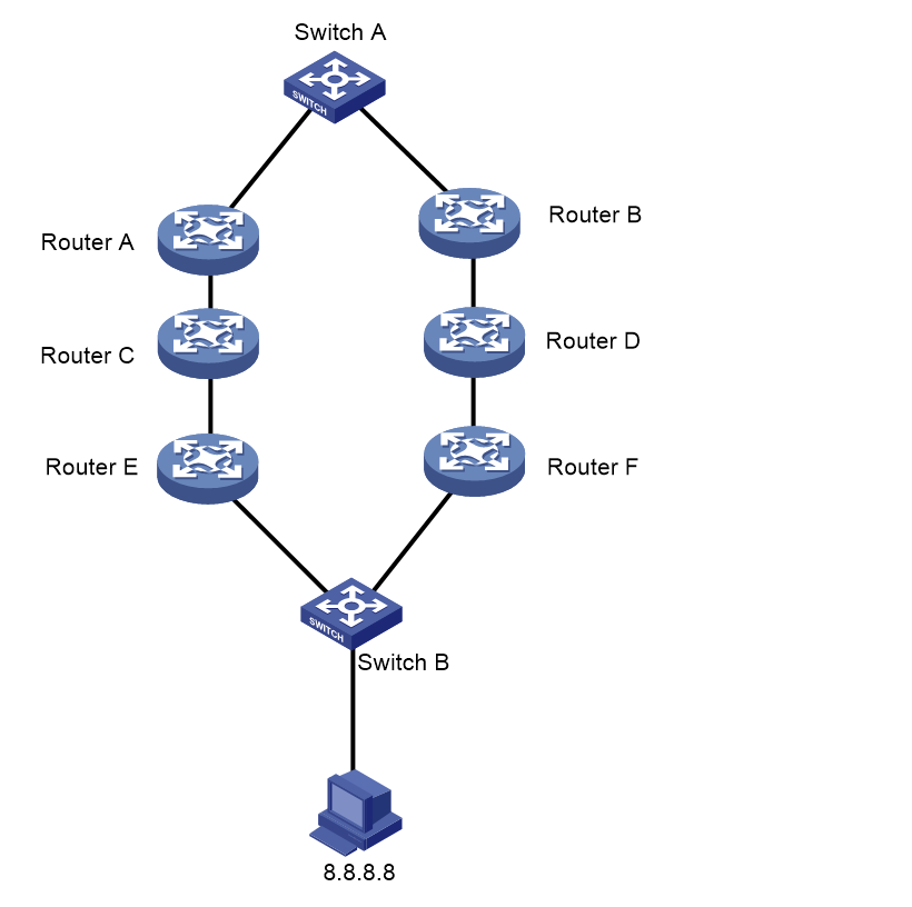

Route flapping caused by attribute changes of BGP summary routes
Symptom
As shown in Figure 4, Router D establishes an EBGP peer relationship with Router A, Router B, and Router C separately. Router D learns route 1.1.1.1/32 from Router A and route 1.1.1.2/32 from Router B. Router D summarize the two routes as route 1.1.1.0/24 before transmitting them to Router C. Route 1.1.1.1/32 is a local network route advertised by BGP on Router A after the configuration of the network command. Route 1.1.1.2/32 is a static route redistributed by Router B after the configuration of the import-route command. BGP route dampening is enabled on Router C by using the dampening command. When route 1.1.1.2/32 flaps on Router B, summary route 1.1.1.0/24 should remain stable on Router D. However, the summary route also flaps in fact.
Figure 4 Network diagram
The following information is for illustration only.
1.     Use the display bgp routing-table ipv4 unicast command to view the BGP routes learned by Router D.
a.     View route 1.1.1.1/32 learned from Router A.
<RouterD> display bgp routing-table ipv4 1.1.1.1 32
BGP local router ID: 20.0.0.2
Local AS number: 200
BGP routing table information of 1.1.1.1/32:
From            : 10.0.0.1 (1.1.1.1)
Original nexthop: 10.0.0.1
OutLabel        : NULL
RxPathID        : 0x0
TxPathID        : 0x0
AS-path         : 100
Origin          : igp
Attribute value : MED 0, pref-val 0
State           : suppressed, valid, external, best
IP precedence   : N/A
QoS local ID    : N/A
Traffic index   : N/A
b.     View route 1.1.1.2/32 learned from Router B.
<RouterD> display bgp routing-table ipv4 1.1.1.2 32
BGP routing table information of 1.1.1.2/32:
From            : 20.0.0.1 (20.0.0.1)
Rely nexthop    : 20.0.0.1
Original nexthop: 20.0.0.1
OutLabel        : NULL
RxPathID        : 0x0
TxPathID        : 0x0
AS-path         : 100
Origin          : incomplete
IP precedence   : N/A
QoS local ID    : N/A
Traffic index   : N/A
Router D can learn two detailed routes, one from Router A and the other from Router B. The two routes have different ORIGIN attributes.
¡     igp—Originated in the AS. The origin of routes advertised with the network command is IGP.
¡     egp—Learned through an exterior gateway protocol (EGP).
¡     incomplete—Unknown origin. The origin of routes redistributed from IGP protocols is INCOMPLETE.
Route 1.1.1.1/32 is a local network route advertised by BGP on Router A after the configuration of the network command. The ORIGIN attribute of route 1.1.1.1/32 is igp. Route 1.1.1.2/32 is a static route redistributed by using the import-route command. The ORIGIN attribute of route 1.1.1.2/32 is incomplete.
2.     Use the display bgp routing-table ipv4 unicast command to view the BGP summary routes on Router D before route flapping.
<RouterD> display bgp routing-table ipv4 1.1.1.0
BGP routing table information of 1.1.1.0/24:
Original nexthop: 127.0.0.1
OutLabel        : NULL
RxPathID        : 0x0
TxPathID        : 0x0
AS-path         : (null)
Origin          : incomplete
Attribute value : pref-val 32768
State           : valid, local, best
This route is an atomic-aggregated route

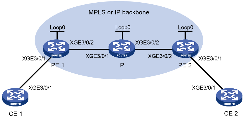

Tracert responses show unexpected addresses in a VPN network
Symptom
As shown in Figure 5, the device is deployed in a VPN network as a PE (PE 1 and PE 2). When the tracert command is used to display the VPN traffic path between CE 1 and CE 2, the command output shows addresses not on the path, but traffic forwarding remains normal.
Figure 5 Network diagram
Device
Interface
IP Address
Device
Interface
IP Address
CE 1
XGE3/0/1
30.0.0.2/24
P
Loop0
N/A
On PE 1
Loop0
8.8.8.8/32
XGE3/0/1
N/A
XGE3/0/1
30.0.0.1/24
XGE3/0/2
N/A
XGE3/0/2
N/A
On PE 2
Loop0
N/A
CE 2
XGE3/0/1
20.0.0.2/24
XGE3/0/1
20.0.0.1/24
XGE3/0/2
N/A
The following output information is for illustration only, and it might vary by software or hardware of the device.
1.     Use the tracert command on both CE 1 and CE 2 to check if the echo addresses on the service paths are displayed correctly.
# Run a tracert from CE 1 to CE 2.
[CE1] tracert 20.0.0.2
traceroute to 20.0.0.2 (30.0.0.2), 30 hops at most, 40 bytes each packet, press CTRL+C to break
1   30.0.0.1 (30.0.0.1)  1.000 ms  0.000 ms  1.000 ms
11  20.0.0.1 (20.0.0.1) [AS 65002]  1.000 ms  1.000 ms  1.000 ms
12  20.0.0.2 (20.0.0.2) [AS 65002]  2.000 ms  2.000 ms  2.000 ms
The echo addresses are displayed correctly. The first hop is a direct address, and the 11th hop is the direct address of CE 2.
Run a tracert from CE 2 to CE 1.
[CE2] tracert 30.0.0.2
traceroute to 30.0.0.2 (30.0.0.2), 30 hops at most, 40 bytes each packet, press CTRL+C to break
1   20.0.0.1 (20.0.0.1)  0.000 ms  1.000 ms  0.000 ms
11  8.8.8.8 (8.8.8.8)  2.000 ms  1.000 ms  2.000 ms
12  30.0.0.2 (30.0.0.2) [AS 65001]  2.000 ms  1.000 ms  3.000 ms
The echo addresses are displayed abnormally. Under normal circumstances, the 11th hop should display the direct address of CE 2, but the actual address shown is 8.8.8.8.
Normal service forwarding and normal final hop for tracert indicate that the routing and interfaces are free of anomalies.
2.     Use the display ip interface brief command on PE 1 to check if  address 8.8.8.8 exists.
[PE1] display ip interface brief
*down: administratively down
(s): spoofing  (l): loopback
Interface           Physical Protocol IP address/Mask    VPN instance Description
XGE3/0/1            up       up       30.0.0.1/24        v1           --
XGE3/0/2            up       up       1.1.1.2/8          --           --
Loop1               up       up(s)    2.2.2.2/32         --           --
Loop0               up       up(s)    8.8.8.8/32         v1           --
The interface with address 8.8.8.8 has also been bound to a VPN.
3.     Use packet capture software to capture packets and check if the device's tracert echo address is correct.
The device's echo address is 8.8.8.8.
Root cause
This symptom is a normal part of the device's packet processing. In a VPN network, if the device is not directly connected to the next hop when processing tracert messages, it will use the smallest IP address from all interfaces bound to the VPN service as the source IP to transmit ICMP messages. This can result in tracert echo information that does not match expectations.
Traffic not routed through a VPN does not have this issue.
Solution
This issue is a normal part of the device's packet processing and merely reflects a variation in tracert responses. It does not affect packet forwarding.
