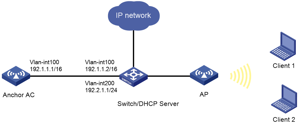

As shown in Figure 1, the switch acts as a DHCP server to assign IP addresses to the AP and the clients. Configure local forwarding on the AC for the AP to forward the client traffic.
· Use the serial ID labeled on the AP's rear panel to specify an AP.
· For XGE 1/0/1 on the AP to join VLAN 200, activate remote configuration synchronization on the AC. Alternatively, edit the AP configuration file, and deploy it to the AP.
· Configure the switch to permit VLAN 200.

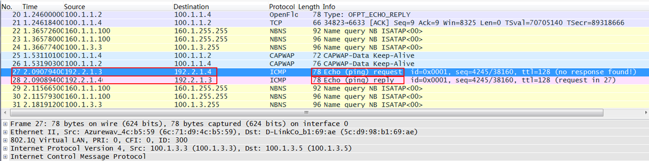

# Verify that Client 1 can Client 2 obtain IP address 192.2.1.3 and 192.2.1.4, respectively, and ICMP packets are not encapsulated in the CAPWAP tunnel but are forwarded directly.
Figure 2 Local forwarding of ICMP packets
