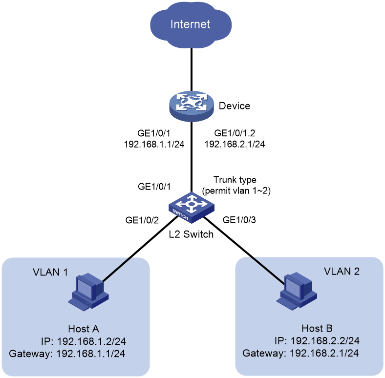

As shown in Figure 1, Host A, Host B, and L2 Switch are connected. Host A is in VLAN 1, and Host B is in VLAN 2. On Device, the IP address of interface GigabitEthernet 1/0/1 is 192.168.1.1/24, and the IP address of subinterface GigabitEthernet 1/0/1.2 is 192.168.2.1/24. The link type of interface GigabitEthernet 1/0/1 on L2 Switch is trunk, and permits VLAN 2. Configure the network to enable Host A and Host B to access the Internet.
Figure 1 Network diagram
Analysis
Unambiguous Dot1q termination only allows an interface to receive VLAN packets with the specified outermost VLAN ID, and does not allow packets from other VLANs to pass through the interface. After receiving the packets, the interface will remove the outermost VLAN tag from the packets. When packets are sent, a VLAN tag with the specified VLAN ID is added to the packets.
The PVID for GigabitEthernet 1/0/1 (trunk type) on L2 Switch is VLAN 1, and the interface permits VLAN 1 and VLAN 2. The link type for GigabitEthernet 1/0/2 on L2 Switch is access, and the access interface belongs to VLAN 1 by default.

1.     Configure Host A and Host B.
Assign IP address 192.168.1.2/24 and gateway address 192.168.1.1/24 to Host A. Assign IP address 192.168.2.2/24 and gateway address 192.168.2.1/24 to Host B.
2.     Configure L2 Switch.
# Create VLAN 2. Assign GigabitEthernet 1/0/3 to VLAN 2.
<L2_Switch> system-view
[L2_Switch] vlan 2
[L2_Switch-vlan2] port gigabitethernet 1/0/3
[L2_Switch-vlan2] quit
# Set the link type of GigabitEthernet 1/0/1 to trunk and assign it to VLANs 1 and 2.
[L2_Switch] interface gigabitethernet 1/0/1
[L2_Switch-GigabitEthernet1/0/1] port link-type trunk
[L2_Switch-GigabitEthernet1/0/1] port trunk permit vlan 1 to 2
3.     Configure Device.
# Create subinterface GigabitEthernet 1/0/1.2, configure its IP address as 192.168.2.1/24, and configure GigabitEthernet 1/0/1.2 to terminate packets of VLAN 2.
<Device> system-view
[Device] interface gigabitethernet 1/0/1.2
[Device-GigabitEthernet1/0/1.2] ip address 192.168.2.1 255.255.255.0
[Device-GigabitEthernet1/0/1.2] vlan-type dot1q vid 2
[Device-GigabitEthernet1/0/1.2] quit
# Assign IP address 192.168.1.1/24 to GigabitEthernet 1/0/1.
[Device-GigabitEthernet1/0/1] ip address 192.168.1.1 255.255.255.0
Both Host A and Host B can access the Internet.
