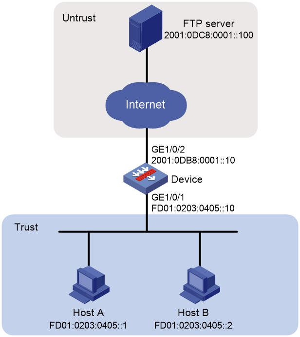

Example: Configuring IPv6 source prefix translation (single internal and external network)
As shown in Figure 1, internal users use IPv6 prefix FD01:0203:0405::/48 and the internal IPv6 addresses are not routable on the Internet. For internal users to access the FTP server on the Internet, configure IPv6 source prefix translation to translate the internal IPv6 prefix FD01:0203:0405::/48 to external prefix 2001:0DF8:0001::/48.
Figure 1 Network diagram
1.     Assign IPv6 addresses to interfaces:
# Assign an IPv6 address to interface GigabitEthernet 1/0/1.
<Device> system-view
[Device-GigabitEthernet1/0/1] ipv6 address FD01:0203:0405::10 48
# Assign IPv6 addresses to other interfaces in the same way. (Details not shown.)
2.     Configure settings for routing.
This example configures a static route, and the next hop in the route is 2001:0DB8:0001::11.
[Device] ipv6 route-static 2001:0DC8:0001::100 48 2001:0DB8:0001::11
3.     Add interfaces to security zones.
[Device] security-zone name trust
[Device-security-zone-Trust] import interface gigabitethernet 1/0/1
[Device-security-zone-Trust] quit
[Device] security-zone name untrust
[Device-security-zone-Untrust] import interface gigabitethernet 1/0/2
[Device-security-zone-Untrust] quit
4.     Configure a security policy:
# Configure a rule named trust-untrust to permit the packets from Host A and Host B to the FTP server.
[Device] security-policy ipv6
[Device-security-policy-ipv6] rule 1 name trust-untrust
[Device-security-policy-ipv6-1-trust-untrust] source-zone trust
[Device-security-policy-ipv6-1-trust-untrust] destination-zone untrust
[Device-security-policy-ipv6-1-trust-untrust] source-ip-host FD01:0203:0405::1
[Device-security-policy-ipv6-1-trust-untrust] source-ip-host FD01:0203:0405::2
[Device-security-policy-ipv6-1-trust-untrust] destination-ip-host 2001:0DC8:0001::100
[Device-security-policy-ipv6-1-trust-untrust] action pass
[Device-security-policy-ipv6-1-trust-untrust] quit
[Device-security-policy-ipv6] quit
5.     Configure IPv6 source prefix translation:
# Configure an IPv6 source prefix mapping from FD01:0203:0405::/48 to FD01:0203:0405::/48.
[Device] interface gigabitethernet 1/0/2
[Device-GigabitEthernet1/0/2] nat66 prefix source fd01:0203:0405:: 48 2001:0df8:0001:: 48
[Device-GigabitEthernet1/0/2] quit
# Verify that internal hosts can access the FTP server. (Details not shown.)
# Verify NAT66 configurations.
[Device] display nat66 all
NAT66 source information:
  Totally 1 source rules.
  Interface(outbound): GigabitEthernet1/0/2
    Original prefix/prefix-length: FD01:203:405::/48
    Translated prefix/prefix-length: 2001:DF8:1::/48
# Verify that NAT66 sessions are established.
<Device> display nat66 session verbose
Slot 1:
Initiator:
  Source      IP/port: FD01:203:405::1/56002
  Destination IP/port: 2001:DC8:1::100/21
  VPN instance/VLAN ID/Inline ID: -/-/-
  Protocol: TCP(6)
  Inbound interface: GigabitEthernet1/0/1
  Source security zone: Trust
Responder:
  Source      IP/port: 2001:DC8:1::100/21
  Destination IP/port: 2001:DF8:1:D50F::1/56002
  Protocol: TCP(6)
  Inbound interface: GigabitEthernet1/0/2
  Source security zone: Untrust
State: TCP_ESTABLISHED
Application: FTP
Rule ID: 1
Rule name: 1
Start time: 2018-12-06 14:48:31  TTL: 3597s
Initiator->Responder:            0 packets          0 bytes
Responder->Initiator:            0 packets          0 bytes
Total sessions found: 1

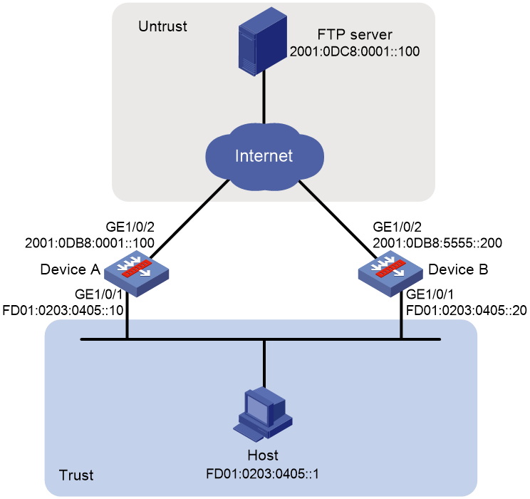

Example: Configuring IPv6 source prefix translation (multihomed network)
As shown in Figure 2, internal users use IPv6 prefix FD01:0203:0405::/48 and the internal IPv6 address is not routable on the Internet.
Device A and Device B are connected to the same internal network but different external networks. Configure IPv6 source prefix translation to translate the internal IPv6 prefix FD01:0203:0405::/48 to different external prefixes so that the internal address can be translated to two external addresses.
Figure 2 Network diagram
1.     Configure Device A.
a.     Assign IPv6 addresses to interfaces:
<DeviceA> system-view
[DeviceA-GigabitEthernet1/0/1] ipv6 address FD01:0203:0405::10 48
[DeviceA-GigabitEthernet1/0/1] quit
b.     Configure settings for routing.
[DeviceA] ipv6 route-static 2001:0DC8:0001::100 48 2001:0DB8:0001::11
c.     Add interfaces to security zones.
[DeviceA] security-zone name trust
[DeviceA-security-zone-Trust] import interface gigabitethernet 1/0/1
[DeviceA-security-zone-Trust] quit
[DeviceA] security-zone name untrust
[DeviceA-security-zone-Untrust] import interface gigabitethernet 1/0/2
[DeviceA-security-zone-Untrust] quit
d.     Configure a security policy:
# Configure a rule named trust-untrust to permit the packets from the host to the FTP server.
[DeviceA] security-policy ipv6
[DeviceA-security-policy-ipv6] rule name trust-untrust
[DeviceA-security-policy-ipv6-1-trust-untrust] source-zone trust
[DeviceA-security-policy-ipv6-1-trust-untrust] destination-zone untrust
[DeviceA-security-policy-ipv6-1-trust-untrust] source-ip-host FD01:0203:0405::1
[DeviceA-security-policy-ipv6-1-trust-untrust] destination-ip-host 2001:0DC8:0001::100
[DeviceA-security-policy-ipv6-1-trust-untrust] action pass
[DeviceA-security-policy-ipv6-1-trust-untrust] quit
[DeviceA-security-policy-ipv6] quit
e.     Configure IPv6 source prefix translation:
# Configure an IPv6 source prefix mapping from FD01:0203:0405::/48 to 2001:0DF8:0001::/48.
[DeviceA] interface gigabitethernet 1/0/2
[DeviceA-GigabitEthernet1/0/2] nat66 prefix source fd01:0203:0405:: 48 2001:0df8:0001:: 48
[DeviceA-GigabitEthernet1/0/2] quit
2.     Configure Device B.
<DeviceB> system-view
[DeviceB-GigabitEthernet1/0/1] ipv6 address FD01:0203:0405::20 48
[DeviceB-GigabitEthernet1/0/1] quit
This example configures a static route, and the next hop in the route is 2001:0DB8:5555::11.
[DeviceB] ipv6 route-static 2001:0DC8:0001::100 48 2001:0DB8:5555::11
[DeviceB] security-zone name trust
[DeviceB-security-zone-Trust] import interface gigabitethernet 1/0/1
[DeviceB-security-zone-Trust] quit
[DeviceB] security-zone name untrust
[DeviceB-security-zone-Untrust] import interface gigabitethernet 1/0/2
[DeviceB-security-zone-Untrust] quit
[DeviceB] security-policy ipv6
[DeviceB-security-policy-ipv6] rule name trust-untrust
[DeviceB-security-policy-ipv6-1-trust-untrust] source-zone trust
[DeviceB-security-policy-ipv6-1-trust-untrust] destination-zone untrust
[DeviceB-security-policy-ipv6-1-trust-untrust] source-ip-host FD01:0203:0405::1
[DeviceB-security-policy-ipv6-1-trust-untrust] destination-ip-host 2001:0DC8:0001::100
[DeviceB-security-policy-ipv6-1-trust-untrust] action pass
[DeviceB-security-policy-ipv6-1-trust-untrust] quit
[DeviceB-security-policy-ipv6] quit
# Configure an IPv6 source prefix mapping from FD01:0203:0405::/48 to 2001:0DE8:0001::/48.
[DeviceB] interface gigabitethernet 1/0/2
[DeviceB-GigabitEthernet1/0/2] nat66 prefix source fd01:0203:0405:: 48 2001:0de8:0001:: 48
[DeviceB-GigabitEthernet1/0/2] quit
# Verify that the internal host can access the FTP server through Device A or Device B. The internal prefix is mapped to different external prefixes and external prefixes are mapped to the same internal prefix on the two NAT66 devices.
# Verify NAT66 configurations on Device A.
[DeviceA] display nat66 all
# Verify NAT66 configurations on Device B.
[DeviceB] display nat66 all
    Translated prefix/prefix-length: 2001:DE8:1::/48
# Verify that NAT66 sessions are established on Device A.
[DeviceA] display nat66 session verbose
Slot 1:
Initiator:
  Source      IP/port: FD01:203:405::1/35990
  Protocol: TCP(6)
Responder:
  Destination IP/port: 2001:DF8:1:D50F::1/35990
  Protocol: TCP(6)
Application: FTP
Rule ID: 0
Rule name: aaa
Start time: 2021-10-31 14:47:44  TTL: 3584s
# Verify that NAT66 sessions are established on Device B.
[DeviceB] display nat66 session verbose
Slot 1:
Initiator:
  Source      IP/port: FD01:203:405::1/35992
  Protocol: TCP(6)
Responder:
  Destination IP/port: 2001:DE8:1:D51F::1/35992
  Protocol: TCP(6)
Application: FTP
Rule ID: 0
Rule name: aaa
Start time: 2021-10-31 14:50:03  TTL: 3594s

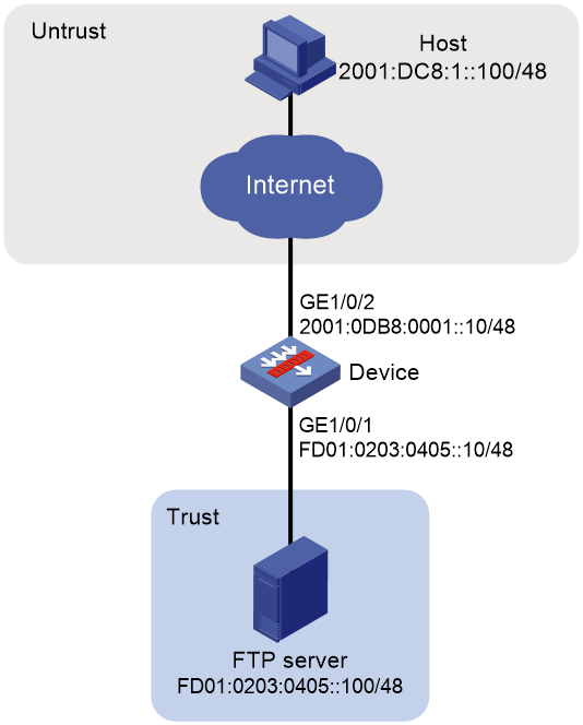

Example: Configuring IPv6 destination prefix translation
As shown in Figure 3, the internal IPv6 address of FTP server is FD01:0203:0405::100/48. The internal prefix is FD01:0203:0405::/48. Configure destination IPv6 prefix translation to allow the FTP server to use IPv6 address 2001:AB01:0001::1 to provide services for external users.
Figure 3 Network diagram
2.     Add interfaces to security zones.
3.     Configure a security policy:
# Configure a rule named untrust-trust to permit the packets from the hosts in the external network to the FTP server in the Trust security zone.
[Device-security-policy-ipv6] rule 1 name untrust-trust
[Device-security-policy-ipv6-1-untrust-trust] source-zone untrust
[Device-security-policy-ipv6-1-untrust-trust] destination-zone trust
[Device-security-policy-ipv6-1-untrust-trust] destination-ip-host FD01:0203:0405::100
[Device-security-policy-ipv6-1-untrust-trust] action pass
[Device-security-policy-ipv6-1-untrust-trust] quit
4.     Configure IPv6 destination prefix translation:
# Configure an IPv6 destination prefix mapping from 2001:AB01:0001::1/128 to FD01:0203:0405::100/128.
[Device-GigabitEthernet1/0/2] nat66 prefix destination 2001:ab01:1::1 128 fd01:203:405::100 128
# Verify that external hosts can access the FTP server. (Details not shown.)
NAT66 destination information:
  Totally 1 destination rules.
  Interface(inbound): GigabitEthernet1/0/2
    Original prefix/prefix-length: 2001:AB01:1::1/128
    Translated prefix/prefix-length: FD01:203:405::100/128
[Device] display nat66 session verbose
Slot 1:
Initiator:
  Source      IP/port: 2001:DC8:1::100/9025
  Destination IP/port: 2001:AB01:1::1/21
  Protocol: TCP(6)
Responder:
  Source      IP/port: FD01:203:405::100/21
  Destination IP/port: 2001:DC8:1::100/9025
  Protocol: TCP(6)
Application: FTP
Rule ID: 1
Rule name: 1
Start time: 2018-12-06 14:56:03  TTL: 3579s
