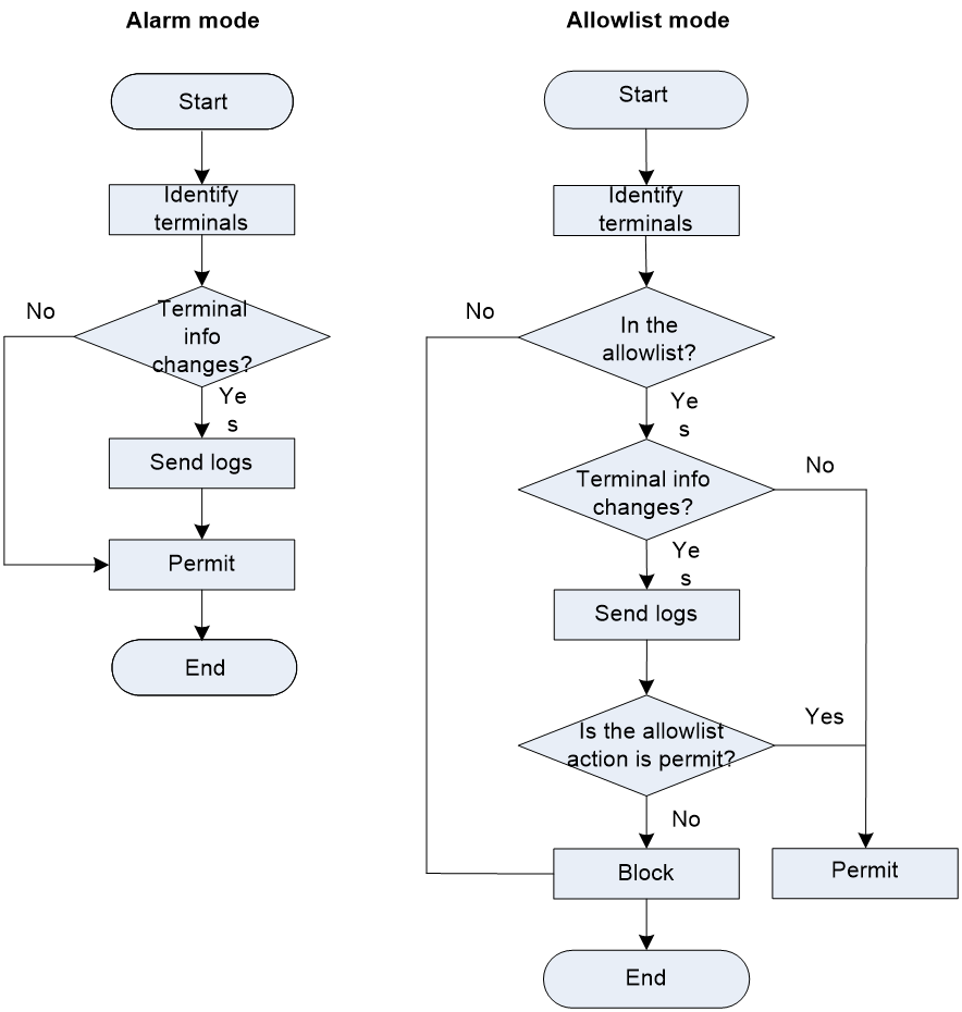

Terminal identification works as follows:
· Alarm mode—As shown in Figure 1, the system identifies each terminal and permits traffic of all terminals. When the system detects a terminal for the first time or detects that the information about an existing terminal changes, the system sends a log message.
· Whitelist mode
a. As shown in Figure 1, the system identifies each terminal and checks whether the IP address of each terminal (including terminals classified as other category) is in the allowlist. An unidentifiable terminal is classified as other category.
b. If the IP address of a terminal is not in the allowlist, the system drops the traffic of the terminal. If the IP address of a terminal is in the allowlist, the system checks whether the terminal information changes. If the terminal information does not change, the system permits the traffic.
c. If the terminal information changes, the system sends a log message and check whether the allowlist action is permit.
d. If the allowlist action is permit, the system permits the traffic. Otherwise, the system drops the traffic.
Figure 1 Terminal identification workflow

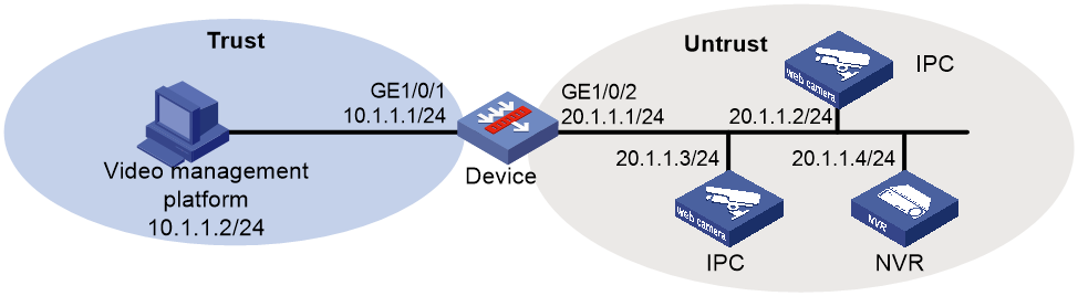

Example: Configuring alarm-mode terminal identification
As shown in Figure 2, the device is used to identify and manage terminals to enhance security.
Configure terminal identification on the device to meet the following requirements:
· The device can identify terminal information when a new terminal comes online or information about an existing terminal changes.
· The Web interface of the device can display identified terminal information.
1. Assign IP addresses to interfaces:
# Assign an IP address to interface GigabitEthernet 1/0/1.
<Device> system-view
[Device-GigabitEthernet1/0/1] ip address 10.1.1.1 255.255.255.0
2. Configure address object groups:
# Create an IPv4 address object group named management, and add the video management platform to the object group.
[Device] object-group ip address management
[Device-obj-grp-ip-management] network host address 10.1.1.2
[Device-obj-grp-ip-management] quit
# Create an IPv4 address object group named terminal, and add the terminals to be monitored to the object group.
[Device] object-group ip address terminal
[Device-obj-grp-ip-terminal] network subnet 20.1.1.0 24
[Device-obj-grp-ip-terminal] quit
3. Add interfaces to security zones.
[Device] security-zone name trust
[Device-security-zone-Trust] import interface gigabitethernet 1/0/1
[Device-security-zone-Trust] quit
[Device] security-zone name untrust
[Device-security-zone-Untrust] import interface gigabitethernet 1/0/2
[Device-security-zone-Untrust] quit
4. Configure a security policy:
# Configure a rule named trust-untrust to allow the video management platform to access monitored terminals.
[Device] security-policy ip
[Device-security-policy-ip] rule name trust-untrust
[Device-security-policy-ip-1-trust-untrust] source-zone trust
[Device-security-policy-ip-1-trust-untrust] destination-zone untrust
[Device-security-policy-ip-1-trust-untrust] source-ip management
[Device-security-policy-ip-1-trust-untrust] destination-ip terminal
[Device-security-policy-ip-1-trust-untrust] action pass
[Device-security-policy-ip-1-trust-untrust] quit
# Configure a rule named untrust-trust to allow the monitored terminals to access the video management platform.
[Device-security-policy-ip] rule name untrust-trust
[Device-security-policy-ip-2-untrust-trust] source-zone untrust
[Device-security-policy-ip-2-untrust-trust] destination-zone trust
[Device-security-policy-ip-2-untrust-trust] source-ip terminal
[Device-security-policy-ip-2-untrust-trust] destination-ip management
[Device-security-policy-ip-2-untrust-trust] action pass
[Device-security-policy-ip-2-untrust-trust] quit
[Device-security-policy-ip] quit
5. Configure address object group for identifying terminal addresses.
[Device] terminal-identification
[Device-terminal-identification] manage object-group ipv4 management

Example: Configuring allowlist-mode terminal identification
As shown in Figure 3, the device is used to identify and manage terminals to enhance security.
· The device can identify a terminal and block its traffic when a terminal comes online for the first time, and the device can displays terminal information on the Web interface.
· The device can approve the blocked terminal as a legal terminal and permits the traffic from the terminal.
· The device can block the traffic from the terminal when the terminal information changes.
5. Configure the operating mode as allowlist, specify an address object group, specify the drop action, and enable terminal identification logging.
[Device] terminal identification
[Device-terminal-identification] work-mode allowlist
[Device-terminal-identification] allowlist object-group ipv4 allowlist
[Device-terminal-identification] allowlist action drop
[Device-terminal-identification] logging enable
6. Configure address object group for identifying terminal addresses.
[Device-terminal-identification] terminal object-group ipv4 terminal
7. Approve blocked terminals as legal terminals and permits the traffic from the terminals.
[Device-terminal-identification] approved all
[Device-terminal-identification] quit
# Verify that you can view the terminal information from the Web interface after a terminal comes online for the first time and its traffic is blocked.
To view terminal information, select Monitor > Terminal Info > Terminal Status from the left navigation tree, and click the Terminal heat map tab.
After the terminal is approved as illegal, the system permits the traffic from the terminal. On the Terminal heat map tab, you can view information about the terminal approved.
