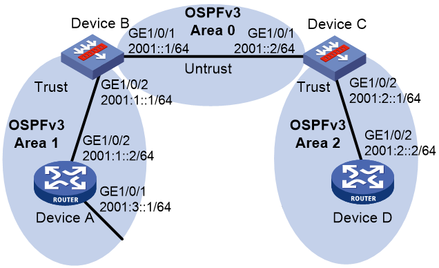

OSPFv3 configuration examples
Example: Configuring OSPFv3 stub area
As shown in Figure 2:
·     Enable OSPFv3 on all devices.
·     Split the AS into three areas.
·     Configure Device B and Device C as ABRs to forward routing information between areas.
·     Configure Area 2 as a stub area to reduce LSAs in the area without affecting route reachability.
Figure 2 Network diagram
# Configure Device B.
1.     Configure IPv6 addresses for interfaces correctly according to Figure 2.
a.     Configure an IP address for GigabitEthernet 1/0/1.
<DeviceB> system-view
[DeviceB-GigabitEthernet1/0/1] ipv6 address 2001::1 64
[DeviceB-GigabitEthernet1/0/1] quit
b.     Configure IP addresses for other interfaces in the same way GigabitEthernet 1/0/1 is configured. (Details not shown.)
2.     Add each interface on Device B to a security zone.

4.     Configure basic OSPFv3 functions:
# On Device A, enable OSPFv3 and specify the device ID as 1.1.1.1.
<DeviceA> system-view
[DeviceA] ospfv3 1
[DeviceA-ospfv3-1] router-id 1.1.1.1
[DeviceA-ospfv3-1] quit
[DeviceA-GigabitEthernet1/0/1] ospfv3 1 area 1
[DeviceA-GigabitEthernet1/0/1] quit
[DeviceA] interface gigabitethernet 1/0/2
[DeviceA-GigabitEthernet1/0/2] ospfv3 1 area 1
[DeviceA-GigabitEthernet1/0/2] quit
# On Device B, enable OSPFv3 and specify the device ID as 2.2.2.2.
[DeviceB] ospfv3 1
[DeviceB-ospfv3-1] router-id 2.2.2.2
[DeviceB-ospfv3-1] quit
[DeviceB-GigabitEthernet1/0/1] ospfv3 1 area 0
[DeviceB] interface gigabitethernet 1/0/2
[DeviceB-GigabitEthernet1/0/2] ospfv3 1 area 1
[DeviceB-GigabitEthernet1/0/2] quit
# On Device C, enable OSPFv3 and specify the device ID as 3.3.3.3.
[DeviceC] ospfv3 1
[DeviceC-ospfv3-1] router-id 3.3.3.3
[DeviceC-ospfv3-1] quit
[DeviceC] interface gigabitethernet 1/0/1
[DeviceC-GigabitEthernet1/0/1] ospfv3 1 area 0
[DeviceC-GigabitEthernet1/0/1] quit
[DeviceC] interface gigabitethernet 1/0/2
[DeviceC-GigabitEthernet1/0/2] ospfv3 1 area 2
[DeviceC-GigabitEthernet1/0/2] quit
# On Device D, enable OSPFv3 and specify the device ID as 4.4.4.4.
<DeviceD> system-view
[DeviceD] ospfv3 1
[DeviceD-ospfv3-1] router-id 4.4.4.4
[DeviceD-ospfv3-1] quit
[DeviceD] interface gigabitethernet 1/0/2
[DeviceD-GigabitEthernet1/0/2] ospfv3 1 area 2
[DeviceD-GigabitEthernet1/0/2] quit
5.     Configure Area 2 as a stub area:
# Configure Device D.
[DeviceD] ospfv3
[DeviceD-ospfv3-1] area 2
[DeviceD-ospfv3-1-area-0.0.0.2] stub
[DeviceD-ospfv3-1-area-0.0.0.2] quit
# Configure Device C, and specify the cost of the default route sent to the stub area as 10.
[DeviceC] ospfv3
[DeviceC-ospfv3-1] area 2
[DeviceC-ospfv3-1-area-0.0.0.2] stub
[DeviceC-ospfv3-1-area-0.0.0.2] default-cost 10

  AdvRouter  : 1.1.1.1                   Preference : 10
  NibID      : 0x23000002                Cost       : 2
  Interface  : GE1/0/2                   BkInterface: N/A
  Nexthop    : FE80::CCA:73FF:FEA2:206
  BkNexthop  : N/A
 *Destination: 2001:1::/64
  Type       : IA                        Area       : 0.0.0.2
  NibID      : 0x23000002                Cost       : 3
  BkNexthop  : N/A
 *Destination: 2001:2::/64
  Type       : I                         Area       : 0.0.0.2
  AdvRouter  : 4.4.4.4                   Preference : 10
  NibID      : 0x23000001                Cost       : 1
  Nexthop    : ::
  BkNexthop  : N/A
 *Destination: 2001:3::/64
  NibID      : 0x23000002                Cost       : 4
  BkNexthop  : N/A
 Total: 5
 Intra area: 1         Inter area: 4         ASE: 0         NSSA: 0
# Verify that devices in area 1 can ping devices in area 2, and vice versa.
