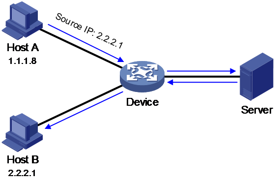

Unicast Reverse Path Forwarding (uRPF) protects a network against source address spoofing attacks, such as DoS and DDoS attacks.
uRPF application scenario
Attackers send packets with a forged source address to access a system in the name of authorized users or even the administrator. The attacks are disruptive to the attacked target.
Figure 1 Source address spoofing attack
As shown in Figure 1, an attacker on Host A sends the server requests with a forged source IP address 2.2.2.1 at a high rate. The server sends response packets to IP address 2.2.2.1 (Host B). Consequently, both the server and Host B are attacked. If the administrator disconnects Host B by mistake, the network service is interrupted.
Attackers can also send packets with different forged source IP addresses or attack multiple servers simultaneously to block connections or even break down the network.
uRPF can prevent these source address spoofing attacks. It checks whether an interface that receives a packet is the output interface of the FIB entry that matches the source IP address of the packet. If not, uRPF considers it a spoofing attack and discards the packet.
