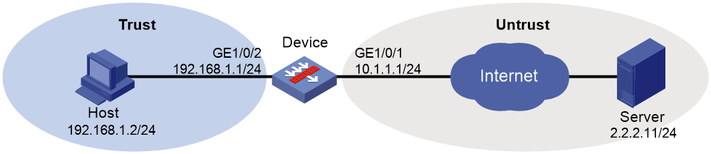

Example: Configuring ASPF FTP application inspection
Configure an ASPF policy on the device to inspect the FTP traffic flows passing through the device. Only return packets for FTP connections initiated by users on the internal network are permitted to pass through the device and get into the internal network. All other types of packets from the external network to the internal network are blocked.
Figure 3 Network diagram
1.     Assign IP addresses to interfaces:
# Assign an IP address to interface GigabitEthernet 1/0/1.
<Device> system-view
[Device-GigabitEthernet1/0/1] ip address 10.1.1.1 255.255.255.0
2.     Configure settings for routing.
This example configures a static route, and the next hop in the route is 10.1.1.2.
[Device] ip route-static 2.2.2.0 24 10.1.1.2
3.     Add interfaces to security zones.
[Device] security-zone name trust
[Device-security-zone-Trust] import interface gigabitethernet 1/0/2
[Device-security-zone-Trust] quit
[Device] security-zone name untrust
[Device-security-zone-Untrust] import interface gigabitethernet 1/0/1
[Device-security-zone-Untrust] quit
4.     Configure ACL 3500 to permit the IP packets from the host to the Internet.
[Device] acl advanced 3500
[Device-acl-ipv4-adv-3500] rule permit ip source 192.168.1.0 0.0.0.255
[Device-acl-ipv4-adv-3500] quit
5.     Create ASPF policy 1 for FTP inspection.
[Device] aspf policy 1
[Device-aspf-policy-1] detect ftp
[Device-aspf-policy-1] quit
6.     Create a zone pair with the source security zone Trust and destination zone Untrust. Apply the ACL to the zone pair to permit the IP packets between the host and the Internet, and apply the ASPF policy to the zone pair.
[Device] zone-pair security source trust destination untrust
[Device-zone-pair-security-Trust-Untrust] packet-filter 3500
[Device-zone-pair-security-Trust-Untrust] aspf apply policy 1
[Device-zone-pair-security-Trust-Untrust] quit
# Verify that an ASPF session has been established for the FTP connection between the host and the server.
<Device> display aspf session ipv4
Slot 0:
Initiator:
  Source      IP/port: 192.168.1.2/1877
  Destination IP/port: 2.2.2.11/21
  VPN instance/VLAN ID/Inline ID: -/-/-
  Protocol: TCP(6)
  Inbound interface: GigabitEthernet1/0/1
    Source security zone: Trust
Total sessions found: 1
# Verify that only return packets that match the entries can enter the internal network. (Details not shown.)
