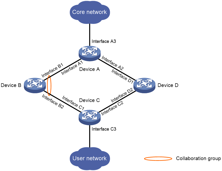

Typical application
As shown in Figure 1, Device C accesses the core network through Device B. When Interface B1 goes down, the switchover of traffic from Device C to Device D is slow because Interface B2 is still up.
If Interface B1 and Interface B2 belong to one collaboration group, Device B brings down Interface B2 when Interface B1 goes down to achieve fast traffic switchover. Similarly, the device brings down Interface B1 when Interface B2 goes down.
Figure 1 Interface collaboration application scenario

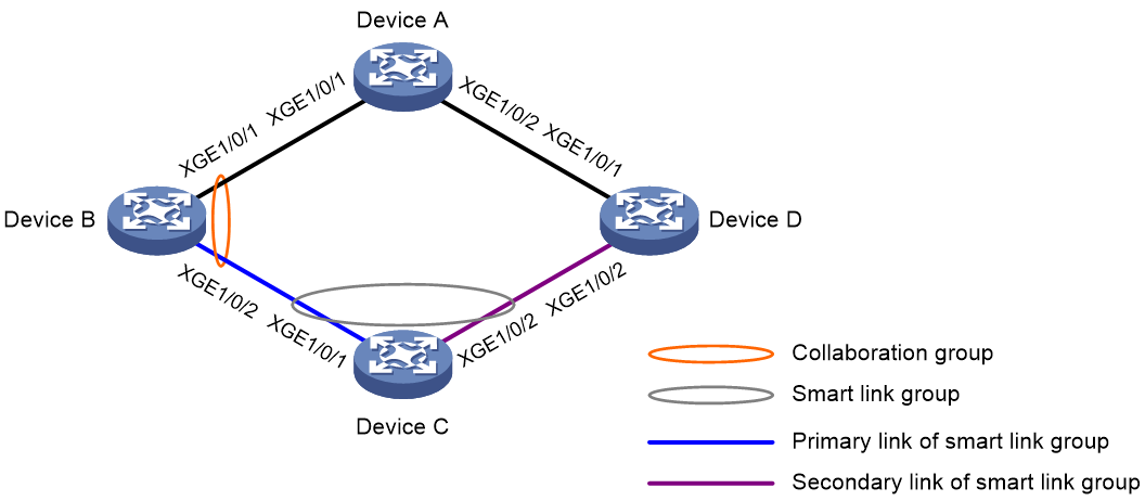

Example: Configuring interface collaboration for Layer 3 interfaces
As shown in Figure 2, configure interface collaboration on Device B. When Ten-GigabitEthernet 1/0/1 on Device B goes down, Device B brings down Ten-GigabitEthernet 1/0/2. When Ten-GigabitEthernet 1/0/2 on Device B goes down, Device B brings down Ten-GigabitEthernet 1/0/1.
Figure 2 Network diagram

Example: Configuring interface collaboration for Layer 2 interfaces
As shown in Figure 3, Device C is a Smart Link device, and Device A cannot receive flush messages.
Configure interface collaboration on Device B. When Ten-GigabitEthernet 1/0/1 on Device B goes down, Device B brings down Ten-GigabitEthernet 1/0/2. When Ten-GigabitEthernet 1/0/2 on Device B goes down, Device B brings down Ten-GigabitEthernet 1/0/1.
Figure 3 Network diagram

[DeviceB-collaboration-group1] port ten-gigabitethernet 1/0/1
[DeviceB-collaboration-group1] port ten-gigabitethernet 1/0/2
1.     Verify that the state of the uplink interface affects the state of the downlink interface.
# Display information about smart link group 1 on Device C.
[DeviceC] display smart-link group 1
Smart link group 1 information:
  Device ID       : 2007-6f03-0700
  Preemption mode : None
  Preemption delay: 1(s)
  Control VLAN    : 1
  Protected VLAN  : Reference Instance 1
  Member                  Role      State   Flush-count     Last-flush-time
  XGE1/0/1                PRIMARY   ACTIVE  2               20:19:28 2017/04/05
  XGE1/0/2                SECONDARY STANDBY 0               NA
The output shows that the primary port of smart link group 1 is Ten-GigabitEthernet 1/0/1, and the traffic is sent out of Ten-GigabitEthernet 1/0/1.
# Shut down Ten-GigabitEthernet 1/0/1 on Device B, and display information about collaboration group 1.
[DeviceB] display collaboration-group 1 verbose
Collaboration group protocol status: Enabled
Collaboration group 1 information:
  Group status     : DOWN
  Member up delay  : 0 seconds
  Last up time     : 20:19:58 2017/04/05
  Last down time   : 20:27:02 2017/04/05
  Member                    Status
  XGE1/0/1                  DOWN
  XGE1/0/2                  Collaboration-down
The output shows that collaboration group 1 is in DOWN state, Ten-GigabitEthernet 1/0/1 is in DOWN state, and Ten-GigabitEthernet 1/0/2 is in Collaboration-down state.
  Control VLAN    : 1
  XGE1/0/1                PRIMARY   DOWN    2               20:19:28 2017/04/05
  XGE1/0/2                SECONDARY ACTIVE  1               20:26:35 2017/04/05
The output shows that Ten-GigabitEthernet 1/0/2 becomes the primary port of smart link group 1, and the traffic is sent out of Ten-GigabitEthernet 1/0/2.
2.     Verify that the state of the downlink interface affects the state of the uplink interface.
# Display information about Ten-GigabitEthernet 1/0/1 on Device A.
[DeviceA] display interface ten-gigabitethernet 1/0/1 brief
Brief information on interfaces in bridge mode:
Link: ADM - administratively down; Stby - standby
Speed: (a) - auto
Duplex: (a)/A - auto; H - half; F - full
Type: A - access; T - trunk; H - hybrid
Interface            Link Speed     Duplex Type PVID Description
XGE1/0/1             UP   1G(a)     F(a)   A    1
The output shows that Ten-GigabitEthernet 1/0/1 is in UP state.
# Shut down Ten-GigabitEthernet 1/0/2 on Device B, and display information about collaboration group 1.
  Group status     : DOWN
  Member                    Status
  XGE1/0/1                  Collaboration-down
  XGE1/0/2                  DOWN
The output shows that collaboration group 1 is in DOWN state, Ten-GigabitEthernet 1/0/1 is in Collaboration-down state, and Ten-GigabitEthernet 1/0/2 is in DOWN state.
Speed: (a) - auto
XGE1/0/1             DOWN auto      A      A    1
The output shows that Ten-GigabitEthernet 1/0/1 is in DOWN state.
