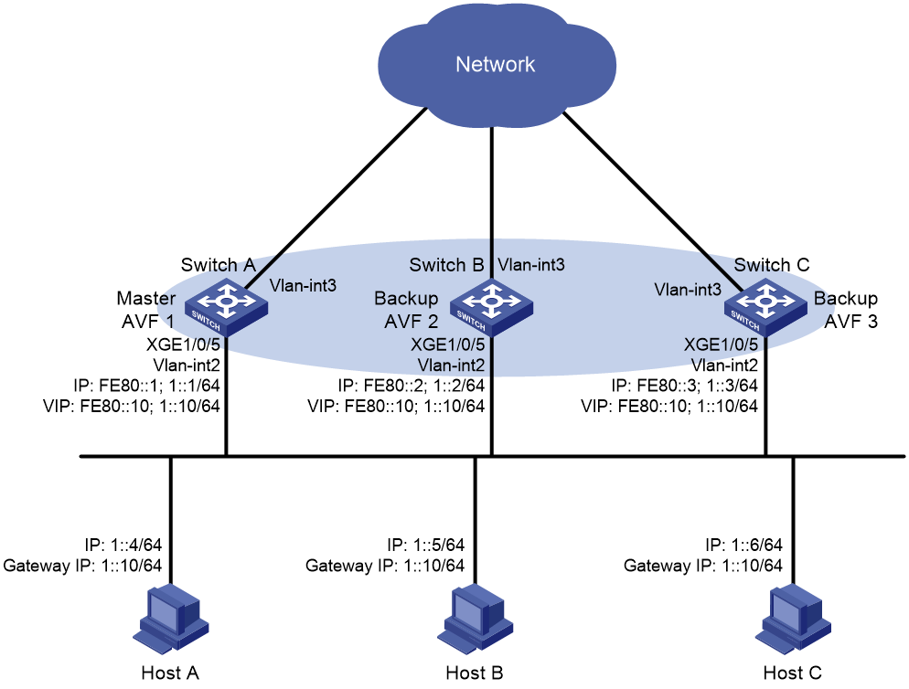

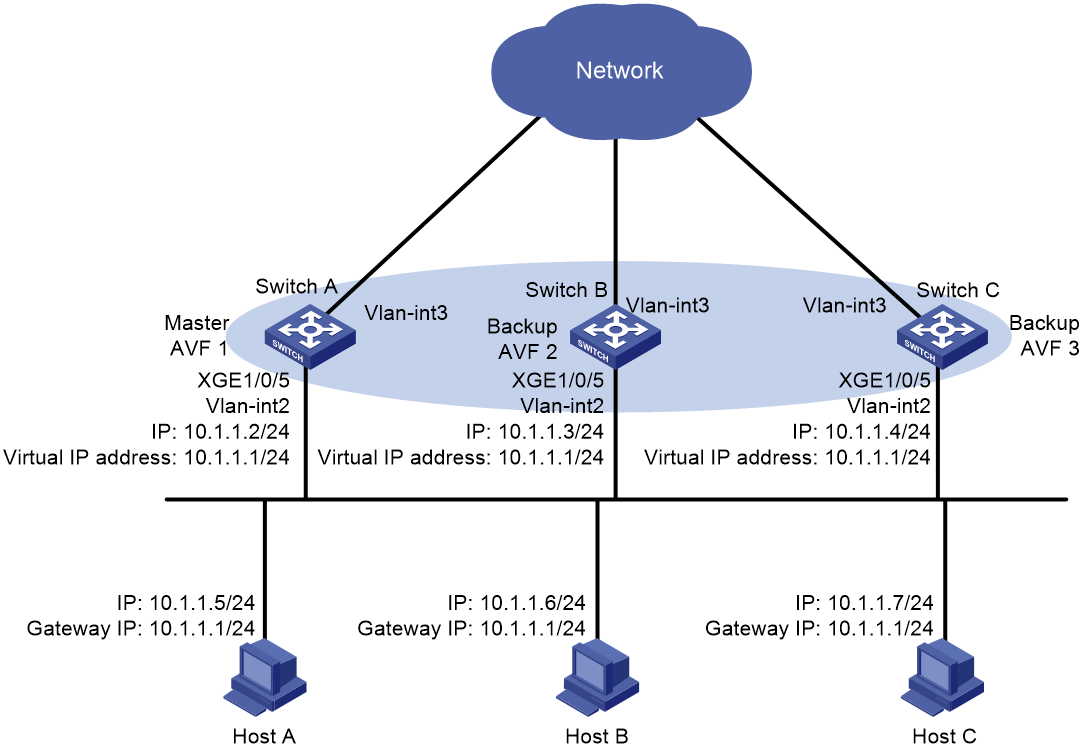

The VFs corresponding to a virtual MAC address on different routers in the VRRP group back up one another.
Figure 8 VF information
Figure 8 shows the VF table on each router in the VRRP group and how the VFs back up one another. The master, Router A, assigns virtual MAC addresses 000f-e2ff-0011, 000f-e2ff-0012, and 000f-e2ff-0013 to itself, Router B, and Router C, respectively. Each router creates VF 1, VF 2, and VF 3 for virtual MAC addresses 000f-e2ff-0011, 000f-e2ff-0012, and 000f-e2ff-0013, respectively. The VFs for the same virtual MAC address on different routers back up one another. For example, the VF 1 instances on Router A, Router B, and Router C back up one another.
·     The VF 1 instance on Router A (the VF 1 owner) has priority 255. It acts as the AVF to forward packets sent to virtual MAC address 000f-e2ff-0011.
·     The VF 1 instances on Router B and Router C have a priority of 255/(1 + 1), or 127. Because their priorities are lower than the priority of the VF 1 instance on Router A, they act as LVFs. These LVFs listen to the state of the VF 1 instance on Router A.
·     When the VF 1 instance on Router A fails, the VF 1 instances on Router B and Router C elect the one with higher priority as the new AVF. This AVF forwards packets destined for virtual MAC address 000f-e2ff-0011. If the two LVFs' priorities are the same, the LVF with a greater device MAC address becomes the new AVF.

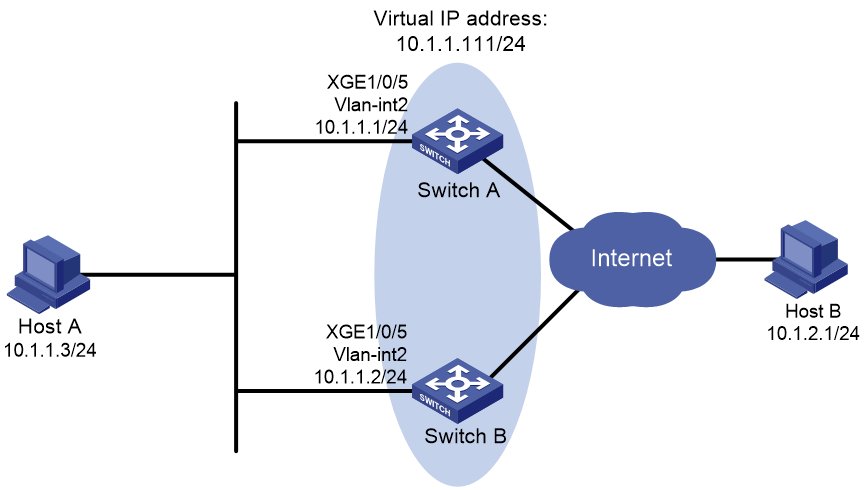

As shown in Figure 9, Switch A and Switch B form a VRRP group. They use the virtual IP address 10.1.1.111/24 to provide gateway service for the subnet where Host A resides.
Switch A operates as the master to forward packets from Host A to Host B. When Switch A fails, Switch B takes over to forward packets for Host A.
Figure 9 Network diagram

The output shows that Switch A is operating as the master in VRRP group 1 to forward packets from Host A to Host B.

The output shows that when Switch A fails, Switch B takes over to forward packets from Host A to Host B.

Example: Configuring multiple VRRP groups
As shown in Figure 10, Switch A and Switch B form two VRRP groups. VRRP group 1 uses the virtual IP address 10.1.1.100/25 to provide gateway service for hosts in VLAN 2, and VRRP group 2 uses the virtual IP address 10.1.1.200/25 to provide gateway service for hosts in VLAN 3.
Assign a higher priority to Switch A than Switch B in VRRP group 1, but a lower priority in VRRP group 2. Traffic from VLAN 2 and VLAN 3 can then be distributed between the two switches. When one of the switches fails, the healthy switch provides gateway service for both VLANs.
Figure 10 Network diagram

# Display detailed information about the VRRP groups on Switch A.
[SwitchA-Vlan-interface3] display vrrp verbose
IPv4 Virtual Router Information:
 Running Mode      : Standard
 Total number of virtual routers : 2
   Interface Vlan-interface2
     VRID             : 1                    Adver Timer  : 100
     Admin Status     : Up                   State        : Master
     Config Pri       : 110                  Running Pri  : 110
     Preempt Mode     : Yes                  Delay Time   : 0
     Auth Type        : Not supported
     Version          : 3
     Virtual IP       : 10.1.1.100
     Virtual MAC      : 0000-5e00-0101
     Master IP        : 10.1.1.1
     First connection : 2023/03/11 16:29:42:111
     Last status change : 2023/03/11 16:30:42:111
   Interface Vlan-interface3
     VRID             : 2                    Adver Timer  : 100
     Admin Status     : Up                   State        : Backup
     Config Pri       : 100                  Running Pri  : 100
     Become Master    : 203ms left
     Version          : 3
     Virtual IP       : 10.1.1.200
     Master IP        : 10.1.1.131
# Display detailed information about the VRRP groups on Switch B.
[SwitchB-Vlan-interface3] display vrrp verbose
     Become Master    : 211ms left
     Version          : 3
     Version          : 3
     Virtual MAC      : 0000-5e00-0102
The output shows the following information:
·     Switch A is operating as the master in VRRP group 1 to forward Internet traffic for hosts that use the default gateway 10.1.1.100/25.
·     Switch B is operating as the master in VRRP group 2 to forward Internet traffic for hosts that use the default gateway 10.1.1.200/25.
Example: Configuring VRRP load balancing
As shown in Figure 11, Switch A, Switch B, and Switch C form a load-balanced VRRP group. They use the virtual IP address 10.1.1.1/24 to provide gateway service for subnet 10.1.1.0/24.
Configure VFs on Switch A, Switch B, and Switch C to monitor their respective VLAN-interface 3. When the interface on any one of them fails, the weights of the VFs on the problematic switch decrease so another AVF can take over.
Figure 11 Network diagram

# Verify that Host A can ping the external network. (Details not shown.)
# Display detailed information about VRRP group 1 on Switch A.
[SwitchA-Vlan-interface2] display vrrp verbose
 Running Mode      : Load Balance
 Total number of virtual routers : 1
     Config Pri       : 120                  Running Pri  : 120
     Preempt Mode     : Yes                  Delay Time   : 5000
     Version          : 3
     Member IP List   : 10.1.1.2 (Local, Master)
                        10.1.1.3 (Backup)
                        10.1.1.4 (Backup)
   Forwarder Information: 3 Forwarders 1 Active
     Config Weight  : 255
     Running Weight : 255
    Forwarder 01
     State          : Active
     Virtual MAC    : 000f-e2ff-0011 (Owner)
     Owner ID       : 0000-5e01-1101
     Priority       : 255
     Active         : local
    Forwarder 02
     State          : Listening
     Virtual MAC    : 000f-e2ff-0012 (Learnt)
     Owner ID       : 0000-5e01-1103
     Priority       : 127
     Active         : 10.1.1.3
    Forwarder 03
     State          : Listening
     Virtual MAC    : 000f-e2ff-0013 (Learnt)
     Owner ID       : 0000-5e01-1105
     Priority       : 127
     Active         : 10.1.1.4
   Forwarder Weight Track Information:
     Track Object   : 1          State : Positive   Weight Reduced : 250
# Display detailed information about VRRP group 1 on Switch B.
[SwitchB-Vlan-interface2] display vrrp verbose
     Become Master    : 410ms left
     Version          : 3
     Member IP List   : 10.1.1.3 (Local, Backup)
                        10.1.1.2 (Master)
                        10.1.1.4 (Backup)
     Config Weight  : 255
    Forwarder 01
     State          : Listening
     Virtual MAC    : 000f-e2ff-0011 (Learnt)
     Priority       : 127
     Active         : 10.1.1.2
    Forwarder 02
     State          : Active
     Virtual MAC    : 000f-e2ff-0012 (Owner)
     Priority       : 255
     Active         : local
    Forwarder 03
     State          : Listening
     Priority       : 127
     Active         : 10.1.1.4
# Display detailed information about VRRP group 1 on Switch C.
[SwitchC-Vlan-interface2] display vrrp verbose
     Become Master    : 401ms left
     Version          : 3
     Member IP List   : 10.1.1.4 (Local, Backup)
                        10.1.1.2 (Master)
                        10.1.1.3 (Backup)
     Config Weight  : 255
    Forwarder 01
     State          : Listening
     Priority       : 127
     Active         : 10.1.1.2
    Forwarder 02
     State          : Listening
     Priority       : 127
     Active         : 10.1.1.3
    Forwarder 03
     State          : Active
     Virtual MAC    : 000f-e2ff-0013 (Owner)
     Priority       : 255
     Active         : local

As shown in Figure 12, Switch A and Switch B form a VRRP group. They use the virtual IP addresses 1::10/64 and FE80::10 to provide gateway service for the subnet where Host A resides.
Host A learns 1::10/64 as its default gateway from RA messages sent by the switches.
Figure 12 Network diagram
# Disconnect the link between Host A and Switch A, and verify that Host A can still ping Host B. (Details not shown.)

The output shows that after Switch A resumes normal operation, it becomes the master to forward packets from Host A to Host B.
As shown in Figure 14, Switch A, Switch B, and Switch C form a load balanced VRRP group. They use the virtual IPv6 addresses FE80::10 and 1::10 to provide gateway service for subnet 1::/64.
Hosts on subnet 1::/64 learn 1::10 as their default gateway from RA messages sent by the switches.
Configure VFs on Switch A, Switch B, or Switch C to monitor their respective VLAN-interface 3. When the interface on any of them fails, the weights of the VFs on the problematic switch decrease so another AVF can take over.
Figure 14 Network diagram
The output shows that Switch A is the master in VRRP group 1, and each of the three switches has one AVF and two LVFs.
# Disconnect the link of VLAN-interface 3 on Switch A and display detailed information about VRRP group 1 on Switch A.
[SwitchA-Vlan-interface2] display vrrp ipv6 verbose
IPv6 Virtual Router Information:
     Virtual IP       : FE80::10
                        1::10
     Member IP List   : FE80::1 (Local, Master)
                        FE80::2 (Backup)
                        FE80::3 (Backup)
   Forwarder Information: 3 Forwarders 0 Active
     Config Weight  : 255
     Running Weight : 5
    Forwarder 01
     State          : Initialize
     Virtual MAC    : 000f-e2ff-4011 (Owner)
     Priority       : 0
     Active         : FE80::3
    Forwarder 02
     State          : Initialize
     Virtual MAC    : 000f-e2ff-4012 (Learnt)
     Priority       : 0
     Active         : FE80::2
    Forwarder 03
     State          : Initialize
     Virtual MAC    : 000f-e2ff-4013 (Learnt)
     Priority       : 0
     Active         : FE80::3
     Track Object   : 1          State : Negative   Weight Reduced : 250
[SwitchC-Vlan-interface2] display vrrp ipv6 verbose
                        1::10
     Member IP List   : FE80::3 (Local, Backup)
                        FE80::1 (Master)
                        FE80::2 (Backup)
   Forwarder Information: 3 Forwarders 2 Active
     Config Weight  : 255
    Forwarder 01
     State          : Active
     Virtual MAC    : 000f-e2ff-4011 (Take Over)
     Priority       : 85
     Active         : local
    Forwarder 02
     State          : Listening
     Priority       : 85
     Active         : FE80::2
    Forwarder 03
     State          : Active
     Virtual MAC    : 000f-e2ff-4013 (Owner)
     Priority       : 255
     Active         : local
The output shows that when VLAN-interface 3 on Switch A fails, the weights of the VFs on Switch A drop below the lower limit of failure. All VFs on Switch A transit to the Initialize state and cannot forward traffic. The VF for MAC address 000f-e2ff-4011 on Switch C becomes the AVF to forward traffic.
# When the timeout timer (about 1800 seconds) expires, display detailed information about VRRP group 1 on Switch C.
     Become Master    : 400ms left
                        1::10
                        FE80::1 (Master)
                        FE80::2 (Backup)
   Forwarder Information: 2 Forwarders 1 Active
     Config Weight  : 255
    Forwarder 02
     State          : Listening
     Priority       : 127
     Active         : FE80::2
    Forwarder 03
     State          : Active
     Priority       : 255
     Active         : local
The output shows that when the timeout timer expires, the VF for virtual MAC address 000f-e2ff-4011 is removed. The VF no longer forwards the packets destined for the MAC address.
# When Switch A fails, display detailed information about VRRP group 1 on Switch B.
[SwitchB-Vlan-interface2] display vrrp ipv6 verbose
                        1::10
     Member IP List   : FE80::2 (Local, Master)
                        FE80::3 (Backup)
     Config Weight  : 255
    Forwarder 02
     State          : Active
     Virtual MAC    : 000f-e2ff-4012 (Owner)
     Priority       : 255
     Active         : local
    Forwarder 03
     State          : Listening
     Priority       : 127
     Active         : FE80::3
·     When Switch A fails, Switch B becomes the master because it has a higher priority than Switch C.
·     The VF for virtual MAC address 000f-e2ff-4011 is removed.
