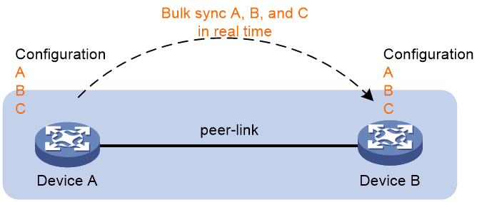

Real-time configuration sync
As shown in Figure 1, settings in multichassis configuration sync view of a member device are synchronized to its peer device in real time.

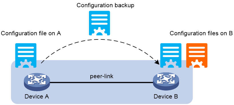

Configuration backup
If you are to update an M-LAG member device, for example, update the software version or replace the device, back up its configuration file to the M-LAG peer in advance as shown in Figure 3. After the update is completed, you can retrieve the previously saved configuration file from the peer device.
