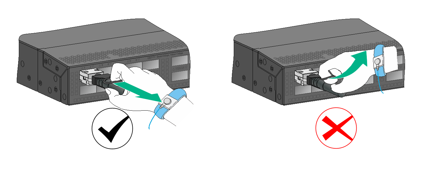

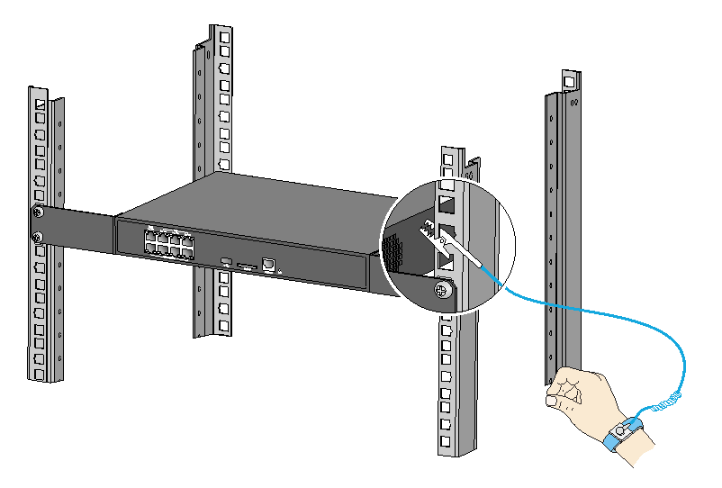

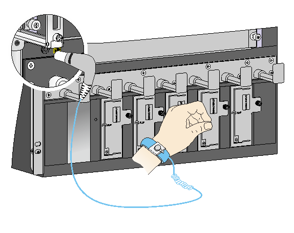

To attach an ESD wrist strap:
1.     Wear the strap on your wrist and fasten it securely. Make sure the strap makes good skin contact.
2.     Ground the strap reliably.
¡     If the device has an ESD jack, connect the grounding terminal of the strap to the ESD jack, as shown in Figure 1.
¡     If the device does not have an ESD jack, clip the grounding terminal of the strap to a rack post as shown in Figure 2, or take other measures to ground the strap reliably.
Figure 1 Attaching an ESD wrist strap (1)
Figure 2 Attaching an ESD wrist strap (2)

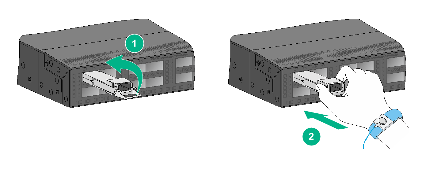

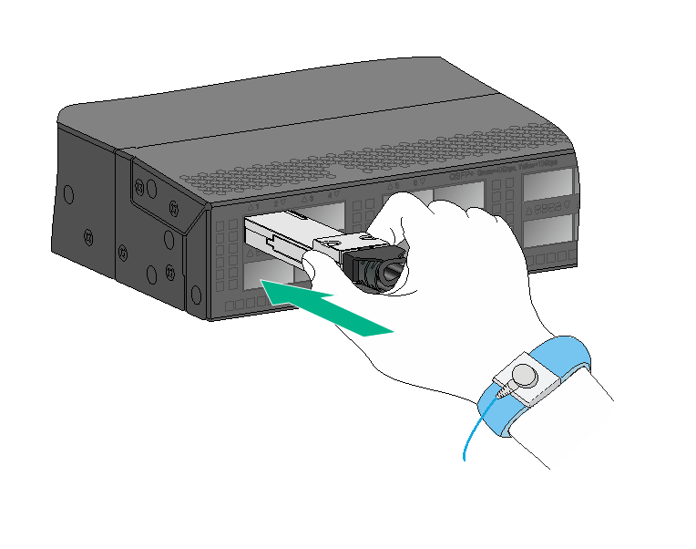

Installation procedure
1.     Remove the dust plug from the target fiber port.
2.     As shown by callout 1 in Figure 3, close the bail latch upward to catch the knob on the top of the transceiver module.
3.     Grasp the transceiver module between your thumb and index finger and correctly orient it. Align it with the fiber port and push it gently into the port until you feel it snaps into place. See callout 2 in Figure 3.
Transceiver modules and fiber ports have disorientation rejection designs. If you cannot insert a transceiver module easily into a port, the orientation might be wrong. Remove and reorient the transceiver module.
In case of limited space, you can gently push against the front face of the transceiver module instead of the two sides.
Figure 3 Installing a bail latch transceiver module (QSFP+)
4.     Grasping the fiber connector between your thumb and index finger, align it with the transceiver module optical bore and push it into the bore.
Transceiver module optical bores and fiber connectors have disorientation rejection designs. If you cannot insert a fiber connector easily into a transceiver module optical bore, the orientation might be wrong. Remove and reorient the connector.
5.     If you are not to install an optical fiber, insert a dust plug into the transceiver module bore.
The triangular pin on a transceiver module and the hole in a fiber port function together to prevent the module from disengaging from the port.

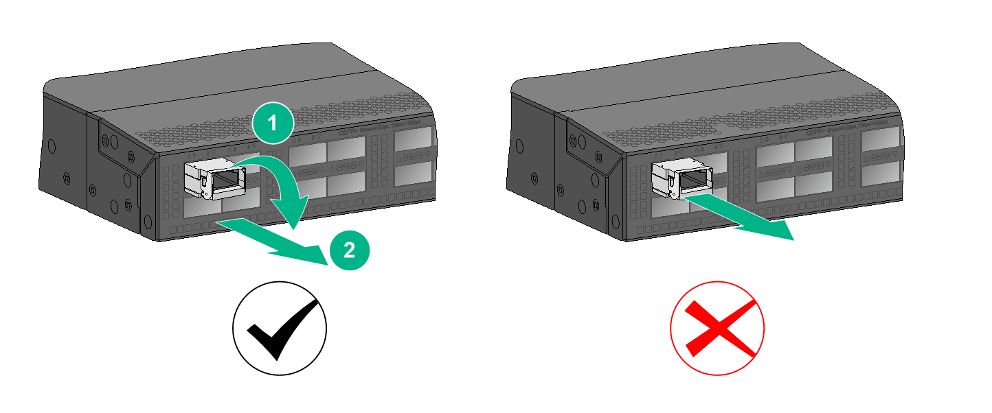

Removal procedure
1.     Remove the optical fiber from the transceiver module.
There is a latching mechanism between a fiber connector and transceiver module port to prevent connector disengagement. Release the latching mechanism before removing the optical fiber. To avoid damages, do not use excessive force.
2.     Pivot the bail latch down until it stops, as shown by callout 1 in Figure 4.
3.     Holding the bail latch, carefully pull the transceiver module straight out of the fiber port.
If you use force at an angle as shown in Figure 6, you can hardly pull the transceiver module out and the transceiver module or fiber port might be damaged. If you forcibly pull out of the transceiver module without pivoting the bail latch down, the triangular pin of the transceiver module and the fiber port might be damaged.
To avoid damaging the bail latch, use event force to pull the transceiver module out.
Figure 4 Correct and wrong removal practices (QSFP+ transceiver module)
4.     Insert the dust plug into the fiber port.

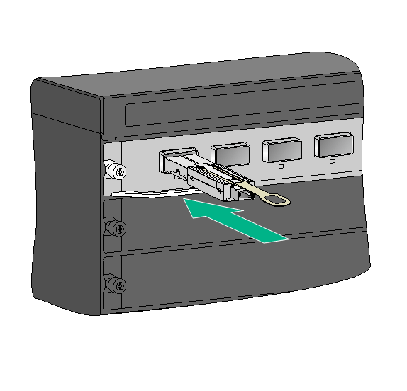

2.     As shown in Figure 5, correctly orient the transceiver module and align it with the fiber port. Push it gently into the port until you feel it snap into place.
Figure 5 Installing a CXP transceiver module
3.     Grasping the fiber connector between your thumb and index finger, align it with the transceiver module optical bore and push it into the optical bore.
Transceiver module optical bores and fiber connectors have disorientation rejection designs. If you cannot insert a fiber connector easily into a transceiver module bore, the orientation might be wrong. Remove and reorient the connector.
4.     If you are not to install an optical fiber, insert a dust plug into the transceiver module bore.

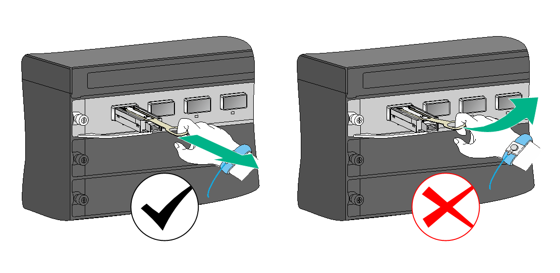

Removal procedure
There is a latching mechanism between a fiber connector and transceiver module. Release the latching before removing the optical fiber. To avoid damages, do not use excessive force.
2.     Putting your forefinger into the pull ring, carefully pull the transceiver module straight out of the fiber port.
As shown in Figure 6, if you use force at an angle, you can hardly pull the transceiver module out and the transceiver module or fiber port might be damaged.
To avoid damaging the pull latch, use event force to pull the transceiver module out.
Figure 6 Correct and wrong removal practices (CXP transceiver module)
3.     Insert the dust plug into the fiber port.

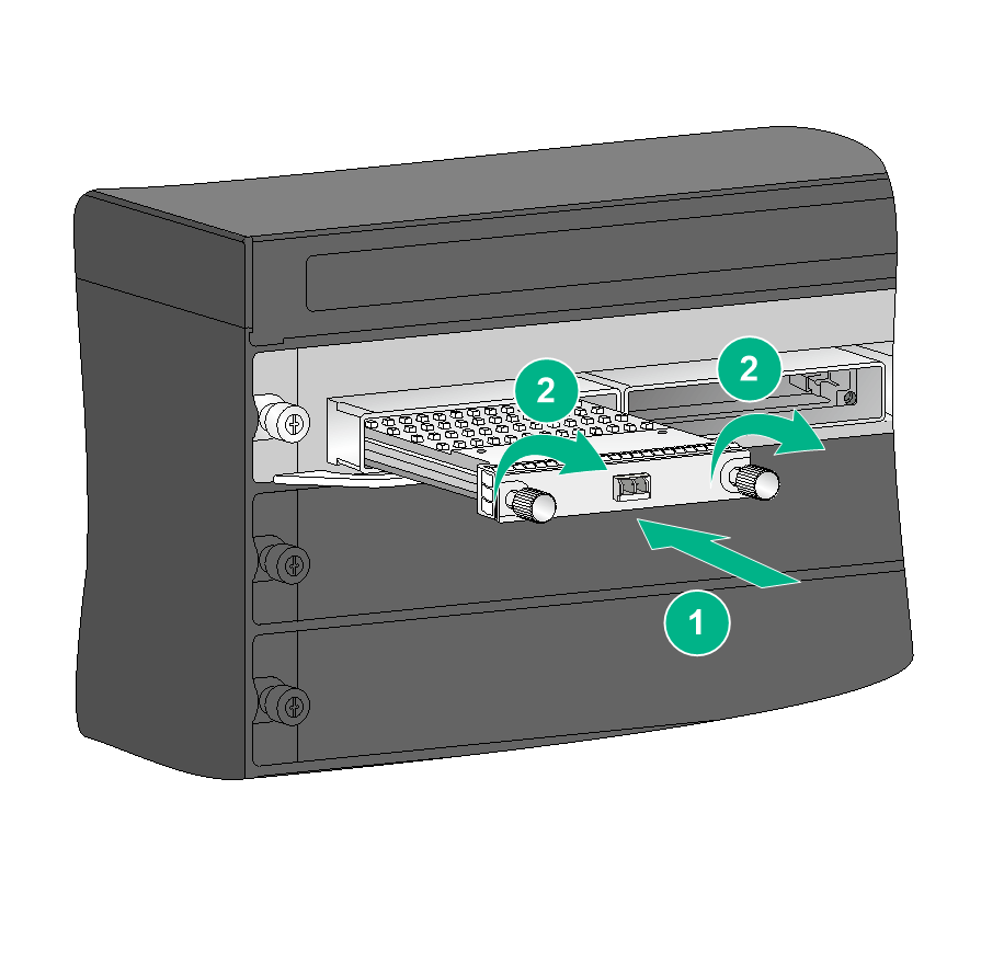

2.     As shown in Figure 3, correctly orient the transceiver module and align it with the fiber port. Push it gently into the port until you feel it snaps into place.
3.     Fasten the captive screws on the transceiver module to secure it in place.
Figure 7 Installing a CFP transceiver module

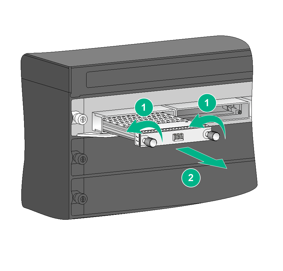

Removal procedure
There is a latching mechanism between a fiber connector and transceiver module port to prevent connector disengagement. Release the latching before removing the optical fiber. To avoid damages, do not use excessive force.
2.     Loosen the captive screws on the transceiver module.
3.     Carefully pull the transceiver module straight out of the fiber port.
If you use force at an angle, you can hardly pull the transceiver module out and the transceiver module or fiber port might be damaged.
Figure 8 Removing a CFP transceiver module

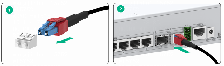

To connect a fiber PoE patch cord to a PoE optical transceiver module:
1.     Install a PoE optical transceiver module. The installation procedure is the same for PoE optical transceiver modules and bail latch transceiver modules. For more information, see "Installation procedure."
2.     As shown by callout 1 in Figure 11, remove the dust caps from the fiber PoE patch cord.
3.     As shown by callout 2 in Figure 11, insert one end of the fiber PoE patch cord into the PoE optical transceiver module.
Figure 11 Connecting a fiber PoE patch cord to a PoE optical transceiver module
