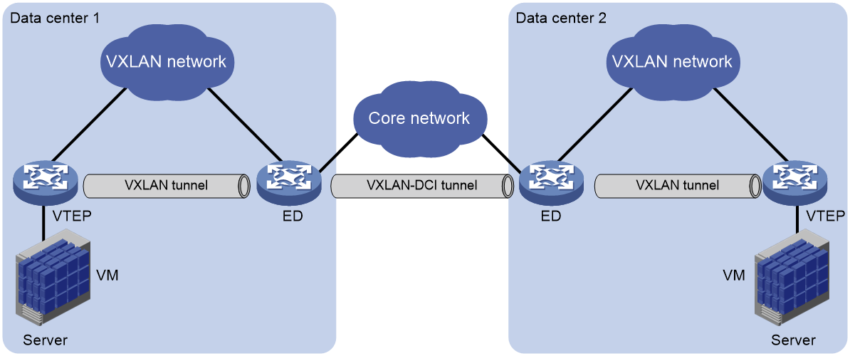

EVPN-DCI network model
As shown in Figure 1, the EVPN-DCI network contains VTEPs and edge devices (EDs) located at the edge of the transport network. A VXLAN tunnel is established between a VTEP and an ED, and a VXLAN-DCI tunnel is established between two EDs. VXLAN-DCI tunnels use VXLAN encapsulation. Each ED de-encapsulates incoming VXLAN packets and re-encapsulates them based on the destination before forwarding the packets through a VXLAN or VXLAN-DCI tunnel.
Figure 1 EVPN-DCI network model
Working mechanisms
In an EVPN-DCI network, BGP EVPN peer relationships are established between EDs and between EDs and VTEPs. When advertising routes to a VTEP or another ED, an ED replaces the routes' nexthop IP address and router MAC address with its IP address and router MAC address.
In an EVPN-DCI network, a VTEP and an ED use a VXLAN tunnel to send traffic, and two EDs use a VXLAN-DCI tunnel to send traffic. An ED de-encapsulates incoming VXLAN packets and re-encapsulates them before forwarding the packets through a VXLAN or VXLAN-DCI tunnel.

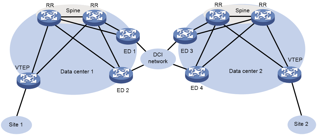

EVPN-DCI dual-homing
As shown in Figure 2, EVPN-DCI dual-homing allows you to deploy two EDs at a data center for high availability and load sharing. To virtualize the redundant EDs into one device, a virtual ED address is configured on them. The redundant EDs use the virtual ED address to establish tunnels with VTEPs and remote EDs.
Figure 2 EVPN-DCI dual-homing
The redundant EDs use their respective IP addresses as the BGP peer addresses to establish BGP EVPN neighbor relationships with VTEPs and remote EDs. The VTEPs and remote EDs send traffic destined for the virtual ED address to both of the redundant EDs through the ECMP routes provided by the underlay network.
The redundant EDs communicate with remote data centers through the transport network. Devices in the dual-homed data center are unaware of the transport network. When the transport-side link fails on one of the redundant EDs, traffic destined for remote data centers is still sent to that ED. To resolve this issue, Monitor Link is used together with EVPN-DCI dual-homing.
On each redundant ED, the transport-facing physical interface is associated with the following loopback interfaces: The loopback interface that provides the IP address used for establishing BGP EVPN neighbor relationships and the loopback interface that provides the virtual ED address. If the transport-side link fails on a redundant ED, the loopback interfaces are placed in down state, and all traffic is forwarded by the other redundant ED. For more information about Monitor Link, see High Availability Configuration Guide.
For link redundancy, deploy multiple RRs on the spine nodes in a data center, and connect each redundant ED to the transport network through multiple links.

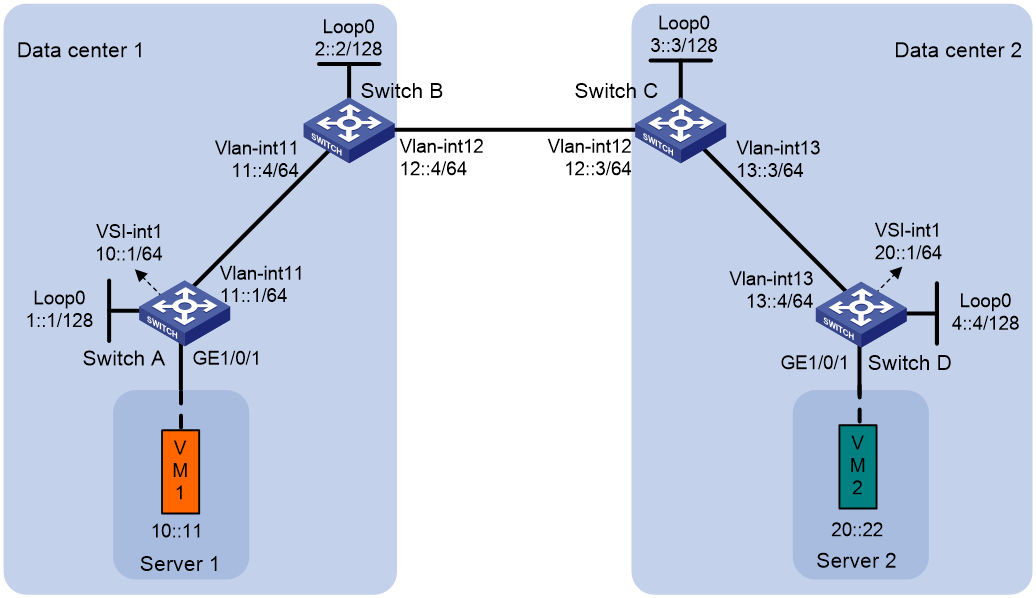

Example: Configuring EVPN-DCI Layer 3 communication (IPv4 underlay network)
As shown in Figure 4:
·     Configure VXLAN 10 for data center 1, and configure VXLAN 20 for data center 2.
·     Configure Switch A and Switch D as distributed EVPN gateways to perform Layer 3 forwarding between VXLAN 10 and VXLAN 20.
·     Configure Switch B and Switch C as EDs.
This example provides configuration of IPv4 sites. The configuration procedure does not differ between IPv4 and IPv6 sites.
Figure 4 Network diagram

Example: Configuring EVPN-DCI Layer 3 communication (IPv6 underlay network)
As shown in Figure 5:
This example provides configuration of IPv6 sites. The configuration procedure does not differ between IPv4 and IPv6 sites.
Figure 5 Network diagram
1.     Set the VXLAN hardware resource mode on Switches A through D and reboot the switches for the mode to take effect. This step uses Switch A as an example.
<SwitchA> system-view
[SwitchA] switch-mode 1
Reboot device to make the configuration take effect.
[SwitchA] quit
<SwitchA> reboot
Start to check configuration with next startup configuration file, please wait..
.......DONE!
Current configuration may be lost after the reboot, save current configuration?
[Y/N]:y
This command will reboot the device. Continue? [Y/N]:y
2.     Configure IPv6 addresses and unicast routing settings:
# On VM 1, specify 10::1 as the gateway address. On VM 2, specify 20::1 as the gateway address. (Details not shown.)
# Assign IPv6 addresses to interfaces, as shown in Figure 5. (Details not shown.)
# Configure OSPFv3 on the transport network for the switches to reach one another. (Details not shown.)
3.     Configure Switch A:
# Enable L2VPN.
[SwitchA] l2vpn enable
# Disable remote MAC address learning and remote ND learning.
[SwitchA] vxlan tunnel mac-learning disable
[SwitchA] vxlan tunnel nd-learning disable
# Create VXLAN 10 on VSI vpna.
[SwitchA] vsi vpna
[SwitchA-vsi-vpna] vxlan 10
[SwitchA-vsi-vpna-vxlan-10] quit
# Create an EVPN instance on VSI vpna. Configure the switch to automatically generate an RD and a route target for the EVPN instance.
[SwitchA-vsi-vpna] evpn encapsulation vxlan
[SwitchA-vsi-vpna-evpn-vxlan] route-distinguisher auto
[SwitchA-vsi-vpna-evpn-vxlan] vpn-target auto
[SwitchA-vsi-vpna-evpn-vxlan] quit
[SwitchA-vsi-vpna] quit
# Configure BGP to advertise BGP EVPN routes.
[SwitchA] bgp 100
[SwitchA-bgp-default] router-id 1.1.1.1
[SwitchA-bgp-default] peer 2::2 as-number 100
[SwitchA-bgp-default] peer 2::2 connect-interface loopback 0
[SwitchA-bgp-default] address-family l2vpn evpn
[SwitchA-bgp-default-evpn] peer 2::2 enable
[SwitchA-bgp-default-evpn] quit
[SwitchA-bgp-default] quit
# On GigabitEthernet 1/0/1, create Ethernet service instance 1000 to match VLAN 100.
[SwitchA] interface gigabitethernet 1/0/1
[SwitchA-GigabitEthernet1/0/1] port link-type trunk
[SwitchA-GigabitEthernet1/0/1] port trunk permit vlan 100
[SwitchA-GigabitEthernet1/0/1] service-instance 1000
[SwitchA-GigabitEthernet1/0/1-srv1000] encapsulation s-vid 100
# Map Ethernet service instance 1000 to VSI vpna.
[SwitchA-GigabitEthernet1/0/1-srv1000] xconnect vsi vpna
[SwitchA-GigabitEthernet1/0/1-srv1000] quit
# Configure RD and route target settings for VPN instance vpn1.
[SwitchA] ip vpn-instance vpn1
[SwitchA-vpn-instance-vpn1] route-distinguisher 1:1
[SwitchA-vpn-instance-vpn1] address-family ipv6
[SwitchA-vpn-ipv6-vpn1] vpn-target 2:2
[SwitchA-vpn-ipv6-vpn1] quit
[SwitchA-vpn-instance-vpn1] address-family evpn
[SwitchA-vpn-evpn-vpn1] vpn-target 1:1
[SwitchA-vpn-evpn-vpn1] quit
[SwitchA-vpn-instance-vpn1] quit
# Configure VSI-interface 1 as a distributed gateway.
[SwitchA] interface vsi-interface 1
[SwitchA-Vsi-interface1] ip binding vpn-instance vpn1
[SwitchA-Vsi-interface1] ipv6 address 10::1 64
[SwitchA-Vsi-interface1] mac-address 1-1-1
[SwitchA-Vsi-interface1] distributed-gateway local
[SwitchA-Vsi-interface1] quit
# Create VSI-interface 2. Associate VSI-interface 2 with VPN instance vpn1, and configure the L3 VXLAN ID as 1000 for the VPN instance.
[SwitchA] interface vsi-interface 2
[SwitchA-Vsi-interface2] ip binding vpn-instance vpn1
[SwitchA-Vsi-interface2] ipv6 address auto link-local
[SwitchA-Vsi-interface2] l3-vni 1000
[SwitchA-Vsi-interface2] quit
# Specify VSI-interface 1 as the gateway interface for VSI vpna.
[SwitchA] vsi vpna
[SwitchA-vsi-vpna] gateway vsi-interface 1
4.     Configure Switch B:
# Enable L2VPN.
<SwitchB> system-view
[SwitchB] l2vpn enable
[SwitchB] vxlan tunnel mac-learning disable
[SwitchB] vxlan tunnel nd-learning disable
# Enable DCI on the Layer 3 interface that connects Switch B to Switch C for the switches to establish a VXLAN-DCI tunnel.
[SwitchB] interface vlan-interface 12
[SwitchB-Vlan-interface12] dci enable
[SwitchB-Vlan-interface12] quit
# Configure BGP to advertise BGP EVPN routes. Enable nexthop replacement for routes advertised to Switch A, and enable router MAC replacement for routes advertised to and received from Switch C.
[SwitchB] bgp 100
[SwitchB-bgp-default] router-id 2.2.2.2
[SwitchB-bgp-default] peer 3::3 as-number 200
[SwitchB-bgp-default] peer 3::3 connect-interface loopback 0
[SwitchB-bgp-default] peer 3::3 ebgp-max-hop 64
[SwitchB-bgp-default] peer 1::1 as-number 100
[SwitchB-bgp-default] peer 1::1 connect-interface loopback 0
[SwitchB-bgp-default] address-family l2vpn evpn
[SwitchB-bgp-default-evpn] peer 3::3 enable
[SwitchB-bgp-default-evpn] peer 3::3 router-mac-local
[SwitchB-bgp-default-evpn] peer 1::1 enable
[SwitchB-bgp-default-evpn] peer 1::1 next-hop-local
[SwitchB-bgp-default-evpn] quit
[SwitchB-bgp-default] quit
[SwitchB] ip vpn-instance vpn1
[SwitchB-vpn-instance-vpn1] route-distinguisher 1:2
[SwitchB-vpn-instance-vpn1] address-family ipv6
[SwitchB-vpn-ipv6-vpn1] vpn-target 2:2
[SwitchB-vpn-ipv6-vpn1] quit
[SwitchB-vpn-instance-vpn1] address-family evpn
[SwitchB-vpn-evpn-vpn1] vpn-target 1:1
[SwitchB-vpn-evpn-vpn1] quit
[SwitchB-vpn-instance-vpn1] quit
[SwitchB] interface vsi-interface 2
[SwitchB-Vsi-interface2] ip binding vpn-instance vpn1
[SwitchB-Vsi-interface2] ipv6 address auto link-local
[SwitchB-Vsi-interface2] l3-vni 1000
[SwitchB-Vsi-interface2] quit
5.     Configure Switch C:
# Enable L2VPN.
<SwitchC> system-view
[SwitchC] l2vpn enable
[SwitchC] vxlan tunnel mac-learning disable
[SwitchC] vxlan tunnel nd-learning disable
# Enable DCI on the Layer 3 interface that connects Switch C to Switch B for the switches to establish a VXLAN-DCI tunnel.
[SwitchC] interface vlan-interface 12
[SwitchC-Vlan-interface12] dci enable
[SwitchC-Vlan-interface12] quit
# Configure BGP to advertise BGP EVPN routes. Enable nexthop replacement for routes advertised to Switch D, and enable router MAC replacement for routes advertised to and received from Switch B.
[SwitchC] bgp 200
[SwitchC-bgp-default] router-id 3.3.3.3
[SwitchC-bgp-default] peer 2::2 as-number 100
[SwitchC-bgp-default] peer 2::2 connect-interface Loopback 0
[SwitchC-bgp-default] peer 2::2 ebgp-max-hop 64
[SwitchC-bgp-default] peer 4::4 as-number 200
[SwitchC-bgp-default] peer 4::4 connect-interface Loopback 0
[SwitchC-bgp-default] address-family l2vpn evpn
[SwitchC-bgp-default-evpn] peer 2::2 enable
[SwitchC-bgp-default-evpn] peer 2::2 router-mac-local
[SwitchC-bgp-default-evpn] peer 4::4 enable
[SwitchC-bgp-default-evpn] peer 4::4 next-hop-local
[SwitchC-bgp-default-evpn] quit
[SwitchC-bgp-default] quit
[SwitchC] ip vpn-instance vpn1
[SwitchC-vpn-instance-vpn1] route-distinguisher 1:3
[SwitchC-vpn-instance-vpn1] address-family ipv6
[SwitchC-vpn-ipv6-vpn1] vpn-target 2:2
[SwitchC-vpn-ipv6-vpn1] quit
[SwitchC-vpn-instance-vpn1] address-family evpn
[SwitchC-vpn-evpn-vpn1] vpn-target 1:1
[SwitchC-vpn-evpn-vpn1] quit
[SwitchC-vpn-instance-vpn1] quit
[SwitchC] interface vsi-interface 2
[SwitchC-Vsi-interface2] ip binding vpn-instance vpn1
[SwitchC-Vsi-interface2] ipv6 address auto link-local
[SwitchC-Vsi-interface2] l3-vni 1000
[SwitchC-Vsi-interface2] quit
6.     Configure Switch D:
# Enable L2VPN.
<SwitchD> system-view
[SwitchD] l2vpn enable
[SwitchD] vxlan tunnel mac-learning disable
[SwitchD] vxlan tunnel nd-learning disable
# Create an EVPN instance on VSI vpnb. Configure the switch to automatically generate an RD and a route target for the EVPN instance.
[SwitchD] vsi vpnb
[SwitchD-vsi-vpnb] evpn encapsulation vxlan
[SwitchD-vsi-vpnb-evpn-vxlan] route-distinguisher auto
[SwitchD-vsi-vpnb-evpn-vxlan] vpn-target auto
[SwitchD-vsi-vpnb-evpn-vxlan] quit
# Create VXLAN 20 on VSI vpnb.
[SwitchD-vsi-vpnb] vxlan 20
[SwitchD-vsi-vpnb-vxlan-20] quit
[SwitchD-vsi-vpnb] quit
[SwitchD] bgp 200
[SwitchD-bgp-default] router-id 4.4.4.4
[SwitchD-bgp-default] peer 3::3 as-number 200
[SwitchD-bgp-default] peer 3::3 connect-interface Loopback 0
[SwitchD-bgp-default] address-family l2vpn evpn
[SwitchD-bgp-default-evpn] peer 3::3 enable
[SwitchD-bgp-default-evpn] quit
[SwitchD-bgp-default] quit
# On GigabitEthernet 1/0/1, create Ethernet service instance 3000 to match VLAN 3.
[SwitchD] interface gigabitethernet 1/0/1
[SwitchD-GigabitEthernet1/0/1] port link-type trunk
[SwitchD-GigabitEthernet1/0/1] port trunk permit vlan 3
[SwitchD-GigabitEthernet1/0/1] service-instance 3000
[SwitchD-GigabitEthernet1/0/1-srv3000] encapsulation s-vid 3
# Map Ethernet service instance 3000 to VSI vpnb.
[SwitchD-GigabitEthernet1/0/1-srv3000] xconnect vsi vpnb
[SwitchD-GigabitEthernet1/0/1-srv3000] quit
[SwitchD] ip vpn-instance vpn1
[SwitchD-vpn-instance-vpn1] route-distinguisher 1:4
[SwitchD-vpn-instance-vpn1] address-family ipv6
[SwitchD-vpn-ipv6-vpn1] vpn-target 2:2
[SwitchD-vpn-ipv6-vpn1] quit
[SwitchD-vpn-instance-vpn1] address-family evpn
[SwitchD-vpn-evpn-vpn1] vpn-target 1:1
[SwitchD-vpn-evpn-vpn1] quit
[SwitchD-vpn-instance-vpn1] quit
[SwitchD] interface vsi-interface 1
[SwitchD-Vsi-interface1] ip binding vpn-instance vpn1
[SwitchD-Vsi-interface1] ipv6 address 20::1 64
[SwitchD-Vsi-interface1] mac-address 1-2-1
[SwitchD-Vsi-interface1] distributed-gateway local
[SwitchD-Vsi-interface1] quit
[SwitchD] interface vsi-interface 2
[SwitchD-Vsi-interface2] ip binding vpn-instance vpn1
[SwitchD-Vsi-interface2] ipv6 address auto link-local
[SwitchD-Vsi-interface2] l3-vni 1000
[SwitchD-Vsi-interface2] quit
# Specify VSI-interface 1 as the gateway interface for VSI vpnb.
[SwitchD] vsi vpnb
[SwitchD-vsi-vpnb] gateway vsi-interface 1
1.     Verify the configuration on EDs. (This example uses Switch B.)
# Verify that the ED has discovered Switch A and Switch C through MAC/IP advertisement routes and IP prefix advertisement routes, and has established VXLAN and VXLAN-DCI tunnels to the switches.
[SwitchB] display evpn ipv6 auto-discovery macip-prefix
Destination IP : 1::1
Source IP      : 2::2
L3VNI          : 1000
Tunnel mode    : VXLAN
OutInterface   : Vsi-interface2
Destination IP : 3::3
Source IP      : 2::2
L3VNI          : 1000
Tunnel mode    : VXLAN-DCI
# Verify that the VXLAN and VXLAN-DCI tunnels on the ED are up.
[SwitchB] display interface tunnel
Tunnel0
Current state: UP
Line protocol state: UP
Description: Tunnel1 Interface
Bandwidth: 64 kbps
Maximum transmission unit: 1464
Internet protocol processing: Disabled
Last clearing of counters: Never
Tunnel source 2::2, destination 1::1
Tunnel protocol/transport UDP_VXLAN/IPv6
Last 300 seconds input rate: 0 bytes/sec, 0 bits/sec, 0 packets/sec
Last 300 seconds output rate: 0 bytes/sec, 0 bits/sec, 0 packets/sec
Input: 0 packets, 0 bytes, 0 drops
Output: 0 packets, 0 bytes, 0 drops
Tunnel1
Current state: UP
Description: Tunnel2 Interface
Bandwidth: 64 kbps
Tunnel source 2::2, destination 3::3
Tunnel protocol/transport UDP_VXLAN-DCI/IPv6
# Verify that the ED has routes for the VMs.
[SwitchB] display ipv6 routing-table vpn-instance vpn1
Destinations : 7        Routes : 7
Destination: ::1/128                                     Protocol  : Direct
NextHop    : ::1                                         Preference: 0
Interface  : InLoop0                                     Cost      : 0
Destination: 10::/64                                     Protocol  : BGP4+
NextHop    : 1::1                                        Preference: 255
Interface  : Vsi2                                        Cost      : 0
Destination: 10::11/128                                   Protocol  : BGP4+
Destination: 20::/64                                     Protocol  : BGP4+
NextHop    : 3::3                                        Preference: 255
Destination: 20::22/128                                   Protocol  : BGP4+
Destination: FE80::/10                                   Protocol  : Direct
NextHop    : ::                                          Preference: 0
Destination: FF00::/8                                    Protocol  : Direct
Interface  : NULL0
2.     Verify that VM 1 and VM 2 can communicate. (Details not shown.)
