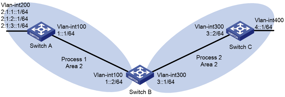

An OSPFv3 process ID has only local significance. Process 1 on a router can exchange packets with process 2 on another router.
OSPFv3 requires you to manually specify a router ID for each router in an AS. Make sure all assigned router IDs in the AS are unique.
Restrictions and guideline
If a router runs multiple OSPFv3 processes, you must specify a unique router ID for each process.

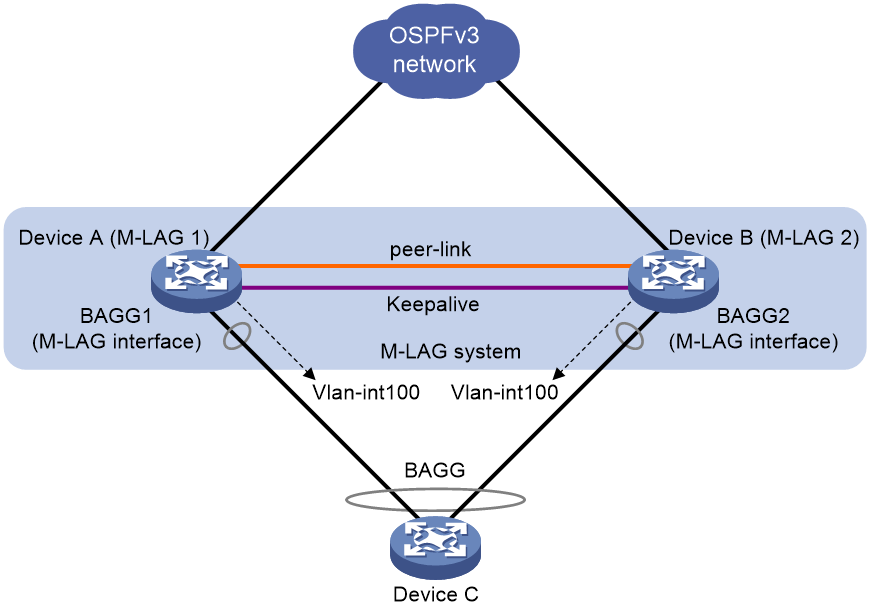

Establishing OSPFv3 neighbor relationships on an M-LAG network
When a customer-side device accesses the OSPFv3 network through both M-LAG member devices in an M-LAG system, the M-LAG member devices provide Layer 3 gateway services. The gateway interfaces (such as VLAN interfaces) on different M-LAG member devices might generate the same link-local address because they have the same IP address and MAC address. In this case, the M-LAG member devices cannot establish OSPFv3 neighbor relationships with the customer-side device.
To resolve this issue, configure the gateway interfaces to use M-LAG virtual IPv6 addresses for OSPFv3 neighbor relationship establishment. The M-LAG virtual IPv6 address configured for a gateway interface must be a link-local address because OSPFv3 uses link-local addresses for OSPFv3 neighbor relationship establishment. For more information about M-LAG, see M-LAG configuration in Layer 2—LAN Switching Configuration Guide.
As shown in Figure 1, Device C accesses the OSPFv3 network through the M-LAG system that consists of Device A and Device B. Device A and Device B provide Layer 3 gateway services. The gateway interface VLAN-interface 100 on Device A and the gateway interface VLAN-interface 100 on Device B have the same IP address and the same MAC address. To ensure that both Device A and Device B can establish an OSPFv3 neighbor relationship with Device C, configure different M-LAG virtual IPv6 addresses for the VLAN interfaces on Device A and Device B.
Figure 1 OSPFv3 neighbor relationship establishment on an M-LAG network
2.     Enter interface view.
3.     Specify a link-local address as the M-LAG virtual IPv6 address to be assigned to the interface.
port m-lag ipv6 virtual-ip ipv6-address link-local
By default, no M-LAG virtual IPv6 address is assigned to an interface.
For more information about this command, see M-LAG commands in Layer 2—LAN Switching Ethernet Command Reference.

Example: Configuring OSPFv3 route summarization
As shown in Figure 9:
·     Switch A, Switch B, and Switch C are in Area 2.
·     OSPFv3 process 1 and OSPFv3 process 2 run on Switch B. Switch B communicates with Switch A and Switch C through OSPFv3 process 1 and OSPFv3 process 2, respectively.
·     On Switch A, configure IPv6 addresses 2:1:1::1/64, 2:1:2::1/64, and 2:1:3::1/64 for VLAN-interface 200.
·     On Switch B, configure OSPFv3 process 2 to redistribute direct routes and the routes from OSPFv3 process 1. Switch C can then learn the routes destined for 2::/64, 2:1:1::/64, 2:1:2::/64, and 2:1:3::/64.
·     On Switch B, configure route summarization to advertise only summary route 2::/16 to Switch C.
Figure 9 Network diagram
1.     Configure IPv6 addresses for interfaces. (Details not shown.)
2.     Configure OSPFv3:
# Enable OSPFv3 process 1 on Switch A.
<SwitchA> system-view
[SwitchA] ospfv3 1
[SwitchA-ospfv3-1] router-id 1.1.1.1
[SwitchA-ospfv3-1] quit
[SwitchA-Vlan-interface100] ospfv3 1 area 2
[SwitchA] interface vlan-interface 200
[SwitchA-Vlan-interface200] ipv6 address 2:1:1::1 64
[SwitchA-Vlan-interface200] ipv6 address 2:1:2::1 64
[SwitchA-Vlan-interface200] ipv6 address 2:1:3::1 64
[SwitchA-Vlan-interface200] ospfv3 1 area 2
[SwitchA-Vlan-interface200] quit
# Enable OSPFv3 process 1 and OSPFv3 process 2 on Switch B.
<SwitchB> system-view
[SwitchB] ospfv3 1
[SwitchB-ospfv3-1] router-id 2.2.2.2
[SwitchB-ospfv3-1] quit
[SwitchB-Vlan-interface100] ospfv3 1 area 2
[SwitchB] ospfv3 2
[SwitchB-ospfv3-2] router-id 3.3.3.3
[SwitchB-ospfv3-2] quit
[SwitchB] interface vlan-interface 300
[SwitchB-Vlan-interface300] ospfv3 2 area 2
[SwitchB-Vlan-interface300] quit
# Enable OSPFv3 process 2 on Switch C.
<SwitchC> system-view
[SwitchC] ospfv3 2
[SwitchC-ospfv3-2] router-id 4.4.4.4
[SwitchC-ospfv3-2] quit
[SwitchC] interface vlan-interface 300
[SwitchC-Vlan-interface300] ospfv3 2 area 2
[SwitchC-Vlan-interface300] quit
[SwitchC] interface vlan-interface 400
[SwitchC-Vlan-interface400] ospfv3 2 area 2
[SwitchC-Vlan-interface400] quit
3.     Configure OSPFv3 route redistribution:
# Configure OSPFv3 process 2 to redistribute direct routes and the routes from OSPFv3 process 1 on Switch B.
[SwitchB] ospfv3 2
[SwitchB-ospfv3-2] import-route ospfv3 1
[SwitchB-ospfv3-2] import-route direct
# Display the routing table on Switch C.
[SwitchC] display ipv6 routing-table
Destinations : 12 Routes : 12
Destination: ::1/128                                     Protocol  : Direct
NextHop    : ::1                                         Preference: 0
Interface  : InLoop0                                     Cost      : 0
Destination: 1::/64                                      Protocol  : O_ASE2
NextHop    : FE80::200:CFF:FE01:1C03                     Preference: 150
Interface  : Vlan300                                     Cost      : 1
Destination: 2::/64                                      Protocol  : O_ASE2
Destination: 2:1:1::/64                                  Protocol  : O_ASE2
Destination: 2:1:2::/64                                  Protocol  : O_ASE2
Destination: 2:1:3::/64                                  Protocol  : O_ASE2
Destination: 3::/64                                      Protocol  : Direct
NextHop    : 3::2                                        Preference: 0
Interface  : Vlan300                                     Cost      : 0
Destination: 3::2/128                                    Protocol  : Direct
Destination: 4::/64                                      Protocol  : Direct
NextHop    : 4::1                                        Preference: 0
Interface  : Vlan400                                     Cost      : 0
Destination: 4::1/128                                    Protocol  : Direct
Destination: FE80::/10                                   Protocol  : Direct
NextHop    : ::                                          Preference: 0
Interface  : NULL0                                       Cost      : 0
Destination: FF00::/8                                    Protocol  : Direct
4.     Configure ASBR route summarization:
# On Switch B, configure OSPFv3 process 2 to advertise a single route 2::/16.
[SwitchB] ospfv3 2
[SwitchB-ospfv3-2] asbr-summary 2:: 16
Destinations : 9 Routes : 9
