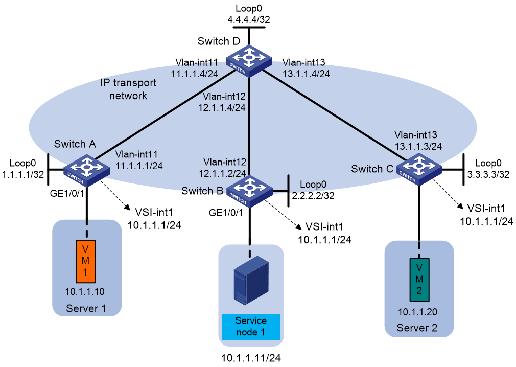

Example: Configuring EVPN-based service chain PBR
As shown in Figure 4, Switch A, Switch B, and Switch C are distributed EVPN gateway devices. Switch D acts as a route reflector to reflect BGP routes for the other switches.
Configure PBR to direct packets sent by Server 1 to Service node 1. After being processed, the packets are forwarded to Server 2.
Figure 4 Network diagram
1.     Configure IP addresses and subnet masks for interfaces, as shown in Figure 4. (Details not shown.)
2.     Configure Switch A:
# Enable L2VPN.
<SwitchA> system-view
[SwitchA] l2vpn enable
# Disable remote-MAC address learning and remote ARP learning.
[SwitchA] vxlan tunnel mac-learning disable
[SwitchA] vxlan tunnel arp-learning disable
# Create an EVPN instance in VSI instance view, and configure the system to automatically generate an RT and RD.
[SwitchA] vsi vpna
[SwitchA-vsi-vpna] evpn encapsulation vxlan
[SwitchA-vsi-vpna-evpn-vxlan] route-distinguisher auto
[SwitchA-vsi-vpna-evpn-vxlan] vpn-target auto
[SwitchA-vsi-vpna-evpn-vxlan] quit
# Create VXLAN 10.
[SwitchA-vsi-vpna] vxlan 10
[SwitchA-vsi-vpna-vxlan-10] quit
[SwitchA-vsi-vpna] quit
# Configure BGP to advertise EVPN routes.
[SwitchA] bgp 200
[SwitchA-bgp-default] peer 4.4.4.4 as-number 200
[SwitchA-bgp-default] peer 4.4.4.4 connect-interface loopback 0
[SwitchA-bgp-default] address-family l2vpn evpn
[SwitchA-bgp-default-evpn] peer 4.4.4.4 enable
[SwitchA-bgp-default-evpn] quit
[SwitchA-bgp-default] quit
# Create VPN instance vpna.
[SwitchA] ip vpn-instance vpna
[SwitchA-vpn-instance-vpna] route-distinguisher 1:1
[SwitchA-vpn-instance-vpna] address-family ipv4
[SwitchA-vpn-ipv4-vpna] vpn-target 2:2
[SwitchA-vpn-ipv4-vpna] quit
[SwitchA-vpn-instance-vpna] address-family evpn
[SwitchA-vpn-evpn-vpna] vpn-target 1:1
[SwitchA-vpn-evpn-vpna] quit
[SwitchA-vpn-instance-vpna] quit
# Configure VSI-interface 1.
[SwitchA] interface vsi-interface 1
[SwitchA-Vsi-interface1] ip binding vpn-instance vpna
[SwitchA-Vsi-interface1] ip address 10.1.1.1 255.255.255.0
[SwitchA-Vsi-interface1] mac-address 0001-0001-0001
[SwitchA-Vsi-interface1] local-proxy-arp enable
[SwitchA-Vsi-interface1] distributed-gateway local
[SwitchA-Vsi-interface1] quit
# Configure VSI-interface 3, associate the interface with VPN instance vpna, and set the L3 VXLAN ID to 1000.
[SwitchA] interface vsi-interface 3
[SwitchA-Vsi-interface3] ip binding vpn-instance vpna
[SwitchA-Vsi-interface3] l3-vni 1000
[SwitchA-Vsi-interface3] quit
# Associate VSI instance vpna with VSI-interface 1.
[SwitchA] vsi vpna
[SwitchA-vsi-vpna] gateway vsi-interface 1
# Configure VLAN-interface 11.
[SwitchA] interface vlan-interface 11
[SwitchA-Vlan-interface11] ip address 11.1.1.1 255.255.255.0
[SwitchA-Vlan-interface11] ospf 1 area 0.0.0.0
[SwitchA-Vlan-interface11] quit
# Associate Ethernet service instance 1000 with VSI instance vpna.
[SwitchA] interface gigabitethernet 1/0/1
[SwitchA-GigabitEthernet1/0/1] port link-mode bridge
[SwitchA-GigabitEthernet1/0/1] service-instance 1000
[SwitchA-GigabitEthernet1/0/1-srv1000] encapsulation s-vid 2
[SwitchA-GigabitEthernet1/0/1-srv1000] xconnect vsi vpna
# Create ACL 3000 to permit packets with source IP address 10.1.1.10 and destination IP address 10.1.1.20.
[SwitchA] acl advanced 3000
[SwitchA-acl-ipv4-adv-3000] rule 0 permit ip source 10.1.1.10 0 destination 10.1.1.20
# Create node 0 that uses ACL 3000 to filter packets. Apply next hop 10.1.1.11 and service chain path ID 1 to packets with source IP address 10.1.1.10 and destination IP address 10.1.1.20.
[SwitchA] policy-based-route aa permit node 0
[SwitchA-pbr-aa-0] if-match acl 3000
[SwitchA-pbr-aa-0] apply service-chain path-id 1
[SwitchA-pbr-aa-0] apply next-hop vpn-instance vpna 10.1.1.11
# Apply policy aa to VSI-interface 1.
[SwitchA-Vsi-interface1] ip policy-based-route aa

5.     Configure Switch D:
# Configure Switch D to establish BGP connections with the other switches.
<SwitchD> system-view
[SwitchD] bgp 200
[SwitchD-bgp-default] group evpn
[SwitchD-bgp-default] peer 1.1.1.1 group evpn
[SwitchD-bgp-default] peer 2.2.2.2 group evpn
[SwitchD-bgp-default] peer 3.3.3.3 group evpn
[SwitchD-bgp-default] peer evpn as-number 200
[SwitchD-bgp-default] peer evpn connect-interface loopback 0
# Configure BGP to advertise EVPN routes, and disable route target filtering for BGP EVPN routes.
[SwitchD-bgp-default] address-family l2vpn evpn
[SwitchD-bgp-default-evpn] peer evpn enable
[SwitchD-bgp-default-evpn] undo policy vpn-target
# Configure Switch D as a route reflector.
[SwitchD-bgp-default-evpn] peer evpn reflect-client
[SwitchD-bgp-default-evpn] quit
[SwitchD-bgp-default] quit
[SwitchD] interface vlan-interface 11
[SwitchD-Vlan-interface11] ip address 11.1.1.4 255.255.255.0
[SwitchD-Vlan-interface11] ospf 1 area 0.0.0.0
[SwitchD-Vlan-interface11] quit
# Configure VLAN-interface 12.
[SwitchD] interface vlan-interface 12
[SwitchD-Vlan-interface12] ip address 12.1.1.4 255.255.255.0
[SwitchD-Vlan-interface12] ospf 1 area 0.0.0.0
[SwitchD-Vlan-interface12] quit
# Configure VLAN-interface 13.
[SwitchD] interface Vlan-interface 13
[SwitchD-Vlan-interface13] ip address 13.1.1.4 255.255.255.0
[SwitchD-Vlan-interface13] ospf 1 area 0.0.0.0
[SwitchD-Vlan-interface13] quit
# Capture packets sent from Server 1 to Server 2 in Ethernet service instance 1000. (Details not shown.)
The packets are processed by Service node 1 before they are delivered to Server 2.
