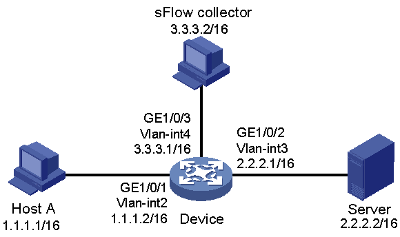

As shown in Figure 2, perform the following tasks:
·     Configure flow sampling in random mode and counter sampling on GigabitEthernet 1/0/1 of the device to monitor traffic on the port.
·     Configure the device to send sampled information in sFlow packets through GigabitEthernet 1/0/3 to the sFlow collector.
Figure 2 Network diagram
1.     Configure VLANs, assign Ethernet interfaces to VLANs, and configure IP addresses and subnet masks for VLAN interfaces, as shown in Figure 2. (Details not shown.)
